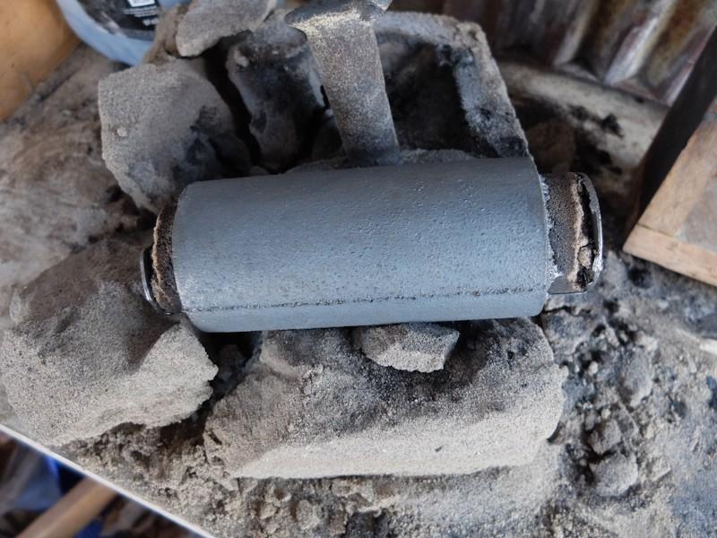

  • Posts: 6941
Re: Sawdust as Facing Ingredient
« Reply #14 on: March 03, 2022, 04:15:47 PM »
Cylinder casting, poured 3 hours ago, as broken out:

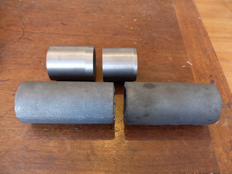

  • Posts: 6941
« Reply #16 on: March 03, 2022, 05:59:46 PM »
Here are all of the cylinder and piston castings for the Rider engine. All using sawdust facing sand.

Offline ironman
  • Posts: 157
« Reply #18 on: March 03, 2022, 07:53:24 PM »
The surface finish looks great to me so the sawdust does work.
