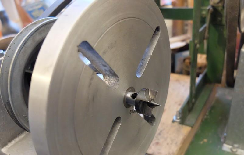

The one I'm modifying has a 7" faceplate cast onto it. The other day that spindle was mounted and I wanted to turn a wooden pattern blank on my lathe, I hunted up a wood turning spur center I'd bought at Sears years ago, but found it had a #1 Morse taper for attachment. Since this couldn't be gripped in a chuck and I didn't have any spindles with a morse taper, I wasn't able to use it.
Instead I mounted my 3 jaw chuck and turned the pattern with that and the tailstock center -- though it wasn't ideal for the purpose because both ends of the wooden piece needed to be turned down to a smaller diameter than the center section. I got it done by turning the piece around after turning the tail end first, but decided I really needed to add a morse taper spindle to my lathe. Besides the spur center I could also mount other types of center and even collets.

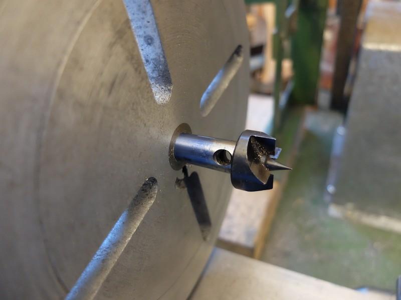

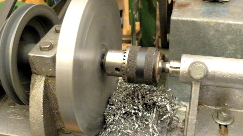

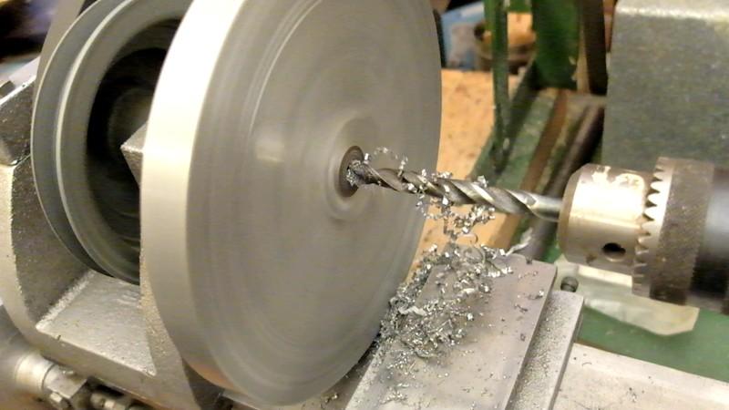

A lookup in Machinery's Handbook showed a Morse taper #1 starts at 0.475" and tapers down to 0.369". So, it seemed  I'd need a 5/16" bit to start the hole, yet stay under 0.369". Ideally it would be a through hole for the length of the spindle, but that's 8" and I don't have a 5/16" drill that long.
Since most of the through bore would mainly be there to accommodate a knockout bar, or collet retainer bar, it doesn't have to be absolutely precise. I could drill from both ends of the spindle, but even then, I think the holes would be about an inch short of meeting. Well we'll cross the bridge when we come to it, at least I had a jobbers bit, and it will drill deep enough for the taper. On with the show!

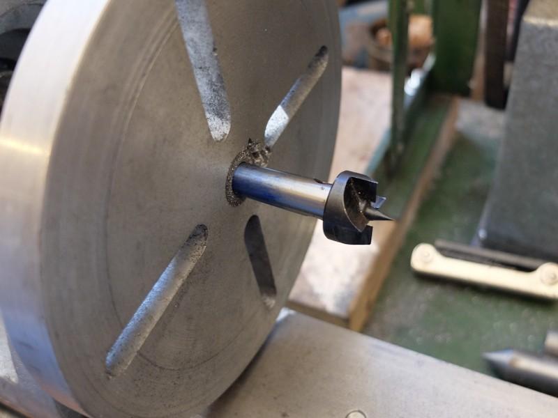

« Reply #1 on: February 04, 2022, 06:58:37 PM »
About as deep as I could get it!

« Reply #2 on: February 05, 2022, 02:38:58 AM »
Steve, it is relatively easy to extend the length of a drill bit by welding or silver soldering an extension on, I have several in the cupboard that I’ve done in the past.
As drill shanks are left soft at the chuck end, I mount the drill in the three jaw with this end outwards, and face it off and drill a hole about half the diameter of the target drill. Then I turn up the extension with a spigot of this diameter and press them together for welding.
If you are careful they end up pretty concentric, but I always start deep holes with a shorter drill anyway so when swapping to the extended one it is well guided.

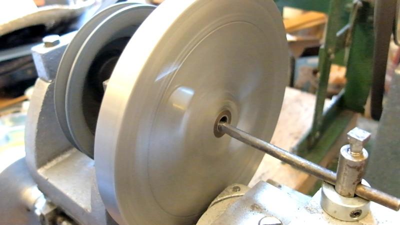

Boring the taper with a simple homemade boring bar -- similar actually to a D-bit.

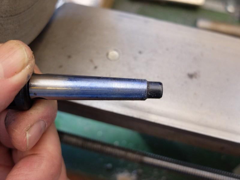

Using the spur center as a test plug. The center's taper is blued and offered up to the beginning bore taper.
  • Posts: 6941
Re: Machining a Morse Taper in the Gingery Lathe Spindle
« Reply #8 on: February 05, 2022, 03:33:54 PM »
Hitting a little towards the back of the bore. So adjust the topslide angle to slightly more, in relation to the turning axis.

And here is the #1 Morse taper bored, and the spur center mounted in the lathe spindle. This required no measurement and no special tools. Total time to do (minus taking photos and writing it up) was about an hour and a half.

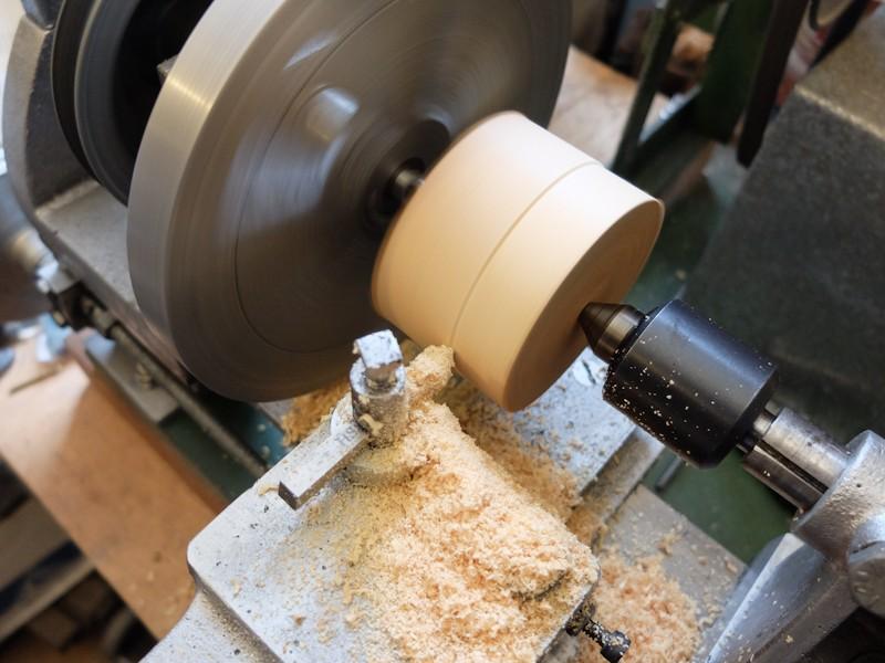

« Reply #14 on: February 07, 2022, 08:50:38 PM »
The spur center doing some work:
