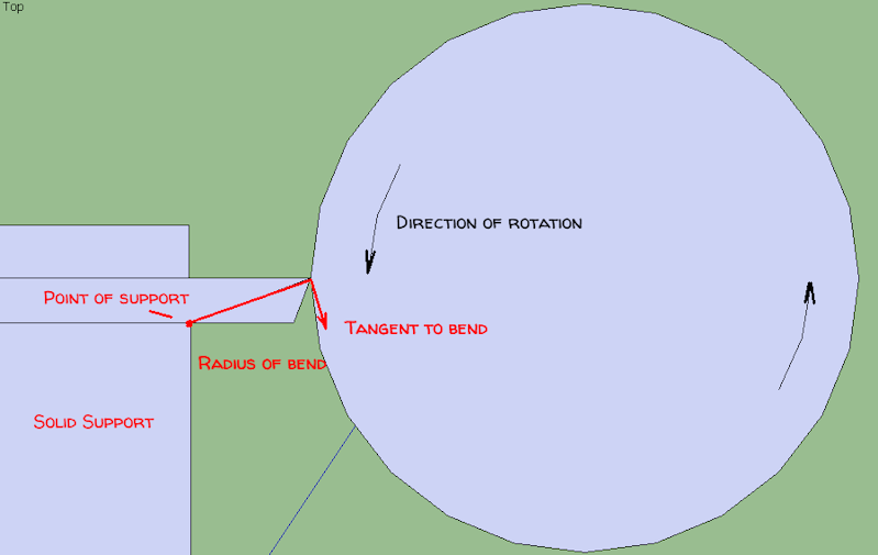

Why?  you are imagining a case where the center of the radius of flex is horizontal and parallel with the tool bit. But with the rest of the system flexible, that radius will effectively be much lower. In that case the tool will tend to dig in.
When it digs in the tool may break, or in a less severe case, you get chatter. The max amplitude of chatter, a harmonic vibration, is much greater then the normal tool cutting force, so once it starts It is hard to stop, and it has the power to flex many of the lathe components, including the carriage attachment to the ways.

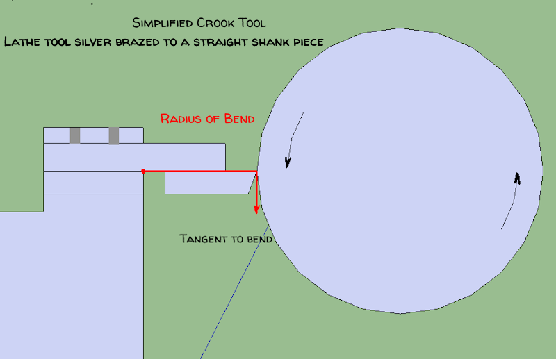

A rear toolpost also has flexible connections to the ways, BUT, with the center of that bend radius low and the direction of rotation now upwards instead of downwards, the tendency is to push the tool away from the work.
And this set of behaviors is all borne out by the fact that big solid lathes tend to part material easier than small hobbyist lathes. They are simply more rigid. And they act as you have been imagining. That's why a rear tool bit is more often recommended to cure parting problems with small lathes. But there is one other advantage for either -- a rear tool holder can carry one tool while the front toolholder can carry another. Thus two different operations can carried out without changing tools.

Appletree, if my memory serves, and it may not !, the late and much lamented John Stevenson from you home town of Nottingham (well  Long Eaton) wrote quite an extensive treatise on this subject on this very forum some years ago.Worth searching for iirc

« Reply #13 on: January 16, 2022, 06:14:28 PM »
Here ya go:
(not John Stevenson)

Here ya go:
Hi Vstream thanks for the image, I guess that answers the question, I was just interested, I think even so a lot of the issues for most people will be the lack of rigidity working from the front. I shall continue using my front mounted tool post as I don’t have much difficulty and my lathe does not have an extended T slotted cross slide.
Just being devil’s advocate, when parting from the front and looking at the drawing, increasing the tool extension towards infinity would reduce the bending radius towards 0 deg, just saw crazy thought. Phil

Phil, I only provided the answer and dwg because you asked for an explanation of the "why" of a rear toolpost, not as a recommendation of what to do with your lathe.
Although, parting isn't always easy for even a rigid lathe system -- particularly for thin or springy stock, and very particularly for turning crankshaft journals for a model. If you've ever tried to do this from the solid, you know what I'm talking about. And here's another reason:
A lathe tool which is flexible, even when mounted on a heavy rigid base, still has an effective center of bend radius below the center of the turned piece. See the first dwg below. Thus it may chatter or dig in. This is because the top surface of the tool bit is the point of contact on the workpiece, while the support resisting the cutting force is at the tool's lower surface.
Interestingly, the deeper a tool is the worse this situation, and parting tools are often very deep to resist bending. As a result they don't bend, which is good up to a point, on a heavy stiff machine. But on a more flexible small lathe they do dig in and either break or spring the carriage and connections -- possibly causing damage. They are the worst possible shape for that kind of lathe.
A crookneck bit (seldom seen any more) raises the the bend radius above the workpiece center. It hinges above. Therefore the tool bends away from the cut rather than digging in. It was used for older and less stiff lathes, and often had to be made up by blacksmithing.
It just occurred to me that one way to get around the problem of a conventional lathe bit being pointed on the upper surface, yet resting on its lower surface, would be to braze a short length of tool to another, as shown in the second drawing below. This would put the cutting support in line with the cutting edge, and the tool would tend to bend away from the cut rather than dig in. It also would likely be more rigid than a crookneck cutter, being shorter and more in line, and a lot easier to come by. This could definitely be shop made with a torch and solder, and doesn't require a blacksmith.

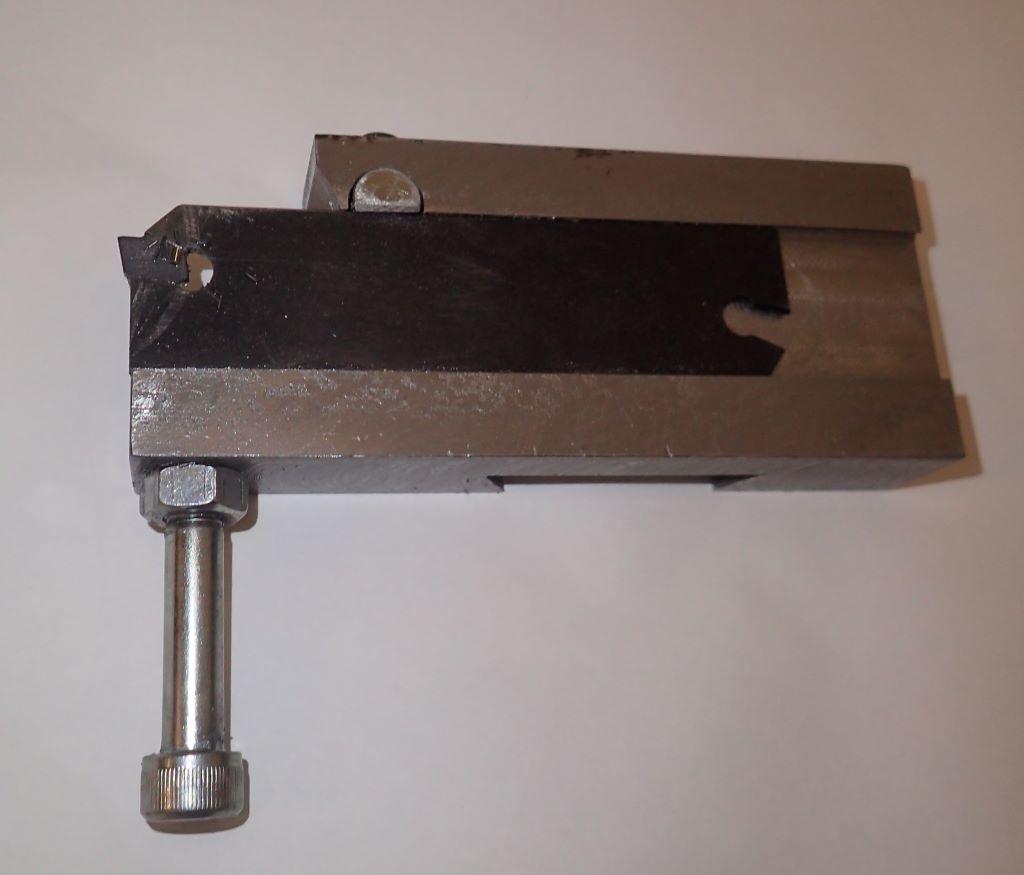

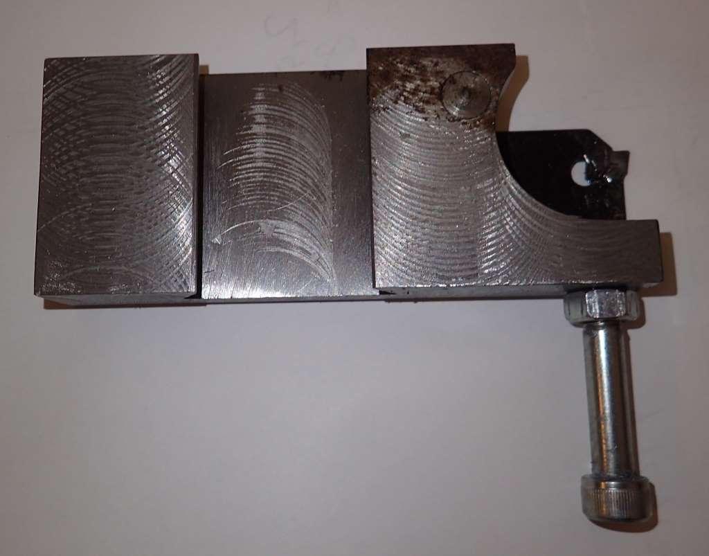

« Reply #24 on: March 02, 2022, 06:14:20 AM »
I made this vertical parting tool to try to avoid the lack of rigidity and flex of either a front or rear parting tool due to the cantilevered projection of the cutting tool. It works well. A front mounted version could be made similar to your supported tool.
Alan
