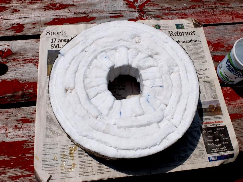

The hard part of lining with insulating blanket in the past was in trying to find a substitute for the Zircon hot face compound Ironman uses -- apparently only available in Australia. Afew years ago I had called a couple of manufacturers of similar compounds but they wouldn't sell to non-trade individuals. But since then ITC 100HT has been become openly available and is used here in the States by gas forge hobbyists. So I decided to try some.
The stuff is not cheap....$500+ a gallon. But it is sold in pint sizes at an affordable price on ebay. So a year ago I ordered that and some 2" Ceroblanket insulation for my furnace. I figured a pint would probably coat the furnace.
Last week, a year after I had ordered the materials, I installed and coated the new insulating lining, and today with temps of 14 degrees F by noon (not ideal :loco: ), I decided to bake the lining. That is supposed to be done below maximum heat for the first 6 hours. That's a lot of fuel! Instead of propane or oil (which would require the compressor and blower to be set up) I decided to do it the low tech way I did all my other linings; build a small kindling wood fire in the barrel, then let the charcoal embers heat soak the furnace for a few hours.

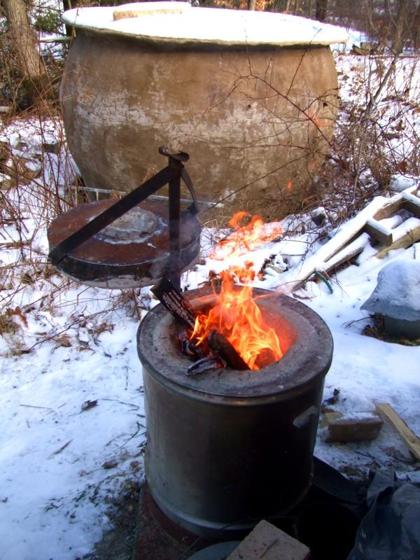

So, I loaded the barrel with some crumpled newspaper, and 8 small sticks of kindling. The fire caught easily, probably the insulation and hot face compound helped focus the heat.

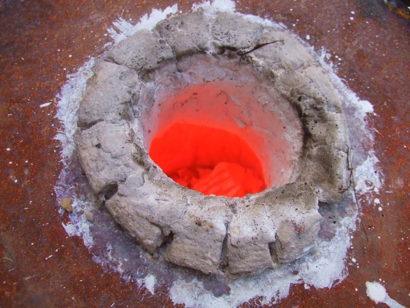

When the kindling sticks dropped below the top of the furnace, I swung the insulated lid over it to heat that as well. I didn't close it right away, so the whole lid face would get some heat including the sealing edge. After about 15 minutes I lowered the lid.
What surprised me after that was that the whole interior of the furnace gradually took on a bright orange glow. Just from a small amount of kindling charcoal in the bottom. There was no blast, mind you, this was all just from an inch and a quarter burner hole at the bottom as a vent and natural draft with the lid closed. The burner had been removed.
This really illustrated the reflective and insulative qualities of the blanket and coating. To have a 10 inch bore furnace walls glowing orange from just a few pieces of charcoal, and no blast is really surprising.  :med:

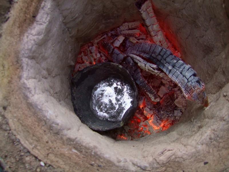

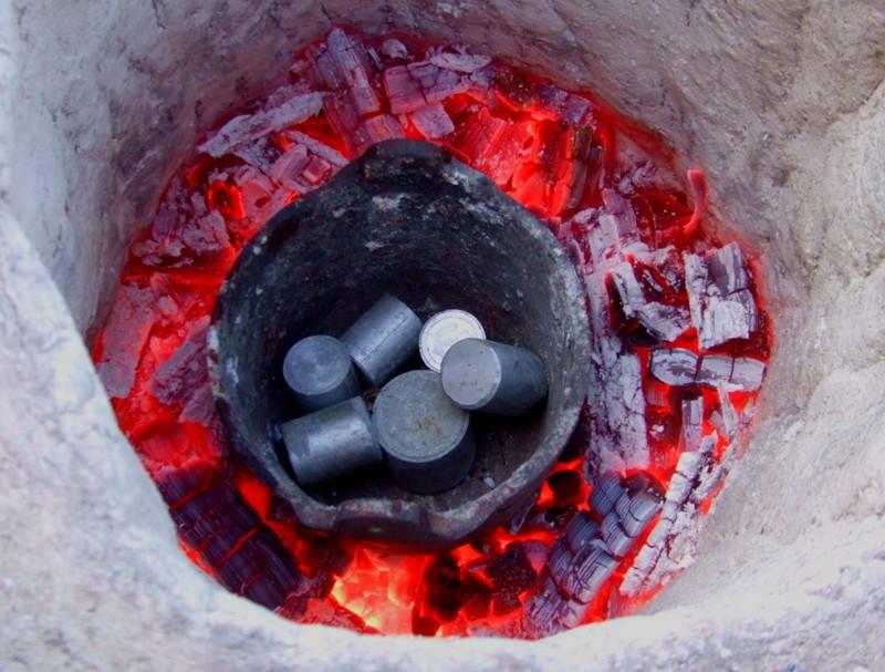

I'm thinking to myself, cherry red, that's aluminum melting heat.  :scratch:

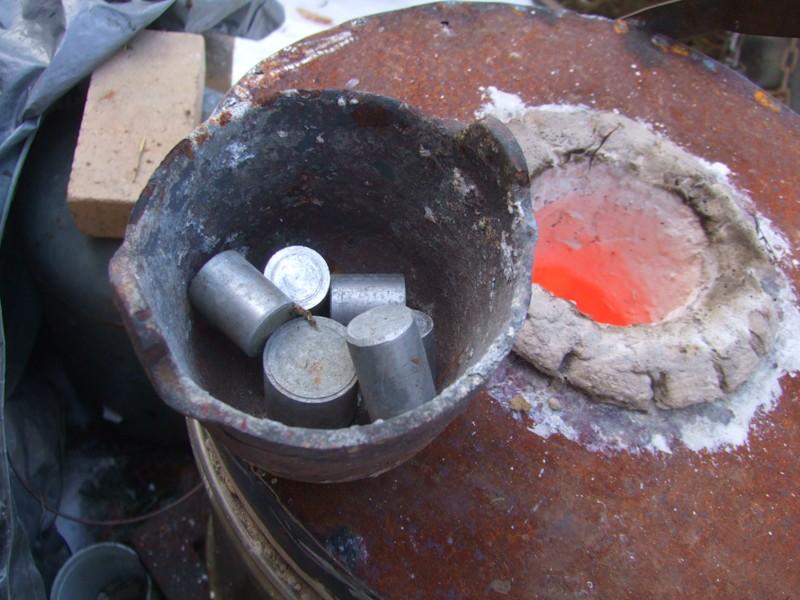

So naturally, I start looking around for my casting stuff, a crucible, spoon tongs, etc. I don't have a mold -- all my greensand is frozen anyway, but just for the heck of it, let's see if we can melt some Al.
I find some scrap aluminum bar cutoffs and pop them into the crucible:
  • Posts: 6855
Re: New lining for the iron furnace
« Reply #3 on: January 12, 2022, 02:20:01 PM »
I set them into the furnace. There's some snap crackle popping going on from the somewhat dirty cast iron plumber's pot I'm using as a crucible. Well I just set a crucible and aluminum at 14F (-10C) into a hot furnace, so you might expect a little complaint from the items in question...  :hammer:
The walls cool quickly, since they have little thermal mass, but the charcoal is still glowing. I swing the lid back into place:
  • Posts: 6855
« Reply #4 on: January 12, 2022, 02:26:08 PM »
I drop a couple more small sticks in, just to get the fire going again. But in only 5 more minutes I'm seeing a pot of the shiny stuff under a small skim of dross, ready to pour:
  • Posts: 6855
« Reply #5 on: January 12, 2022, 02:38:12 PM »

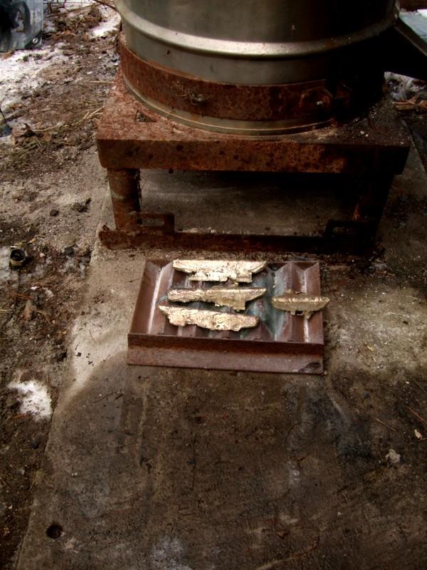

And there you have it. A fast 10" aluminum foundry melt. Fueled by the dregs of a very small wood fire. On a cold winter day. With no blast, and only a small port inlet.
I'm going to be interested to see what it does with an oil burner and furnace blast.  :bugeye:
My only concern is that the lining seems so physically fragile. But we'll see what we see........  :dremel:

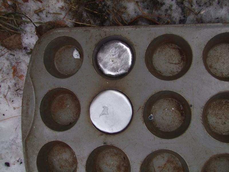

Today I tried the furnace on propane. As a test I loaded a small clay lined crucible with scrap glass-cutting diamond holesaws, which are basically a nut shaped heavy brass collar with a thin stainless steel ring. The burner was the atmospheric propane torch I made in another thread here. There was no blast -- just the torch.
Brass melted in about 20 minutes, and I fished out the rings before pouring into an ingot mold. The melt was a success, though it could have been hotter and better skimmed. But I was beginning to get zinc fuming out of the melt, and I didn't want to lose too much, so hurried it a little.
A larger blown burner will probably melt much faster, and also reduce zinc loss, while pouring hotter. I'd probably also cover the crucible and maybe add charcoal to the pot to protect the melt if I was going to pour a mould. But it was fun today to at least melt brass in mid winter.  :dremel:

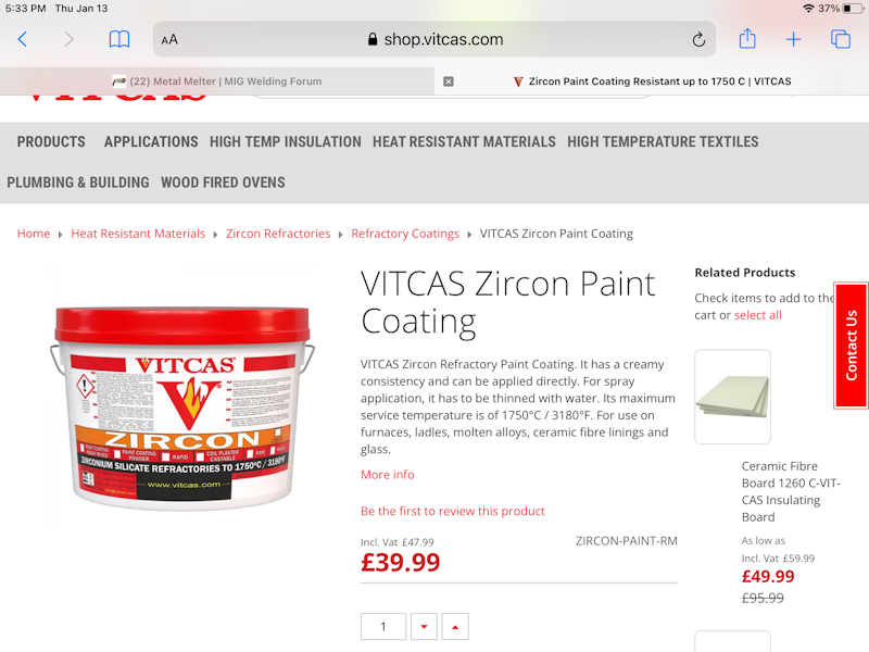

Regarding the Zircon paint I just came across this at:  https://shop.vitcas.com/vitcas-zircon-paint-coating.HTML  Sorry about the screen size specs to the right.

Nice, Tom.  :thumbup: Now have the Mfr name. It seems very reasonably priced, too -- not sure of the container size but it seems more than a pint like the ITC 100HT. The net weight appears to be 5kg which I think might be a liter. Unfortunately for me it doesn't seem available in the States.  :(
One thing I'm wondering about -- it says the color is beige. But Ironman's liquid is violet in color, until fired. Well anyway, nice find!

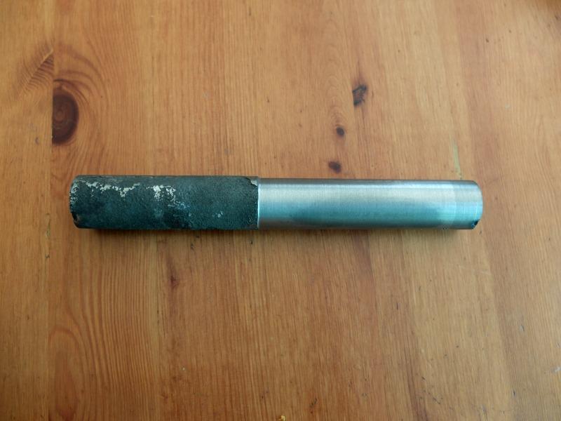

Steve I used to use the Zircon as a foundry tool dip years back. Things like stirrers and degassing plungers. It was a white thin paste that I diluted with water. May still have a dried out tub!
It set hard with heat but was liable to flake off and not very durable so I’m surprised it’s suggested as a liner on the Kaowool. Sodium silicate syrup will I’m sure slightly soak in and set rock hard and be more suitable.
I’ve got the sodium silicate but not sure if I’ve any bits of Kaowool left over, if I have I’ll do an experiment.

Andrew it's unclear which exact product Ironman uses for his furnaces - there appear to be many different products with the generic title "Zircon" -- they appear also to have a variety of formulations, and have widely different uses from pottery glazes to furnace linings.
If you watch Ironman (aka Luckygen 1001) building his small furnace in the YouTube video I posted about 8 posts ago, at minute 1:22 you will see him applying it to the ceramic blanket of his furnace. It's a violet colored, and thick enough for a good surface coverage rate. It heat cures to a white color. It would be nice to know what that particular formulation is because he has long term proven use of that product in his style furnace for melting iron.

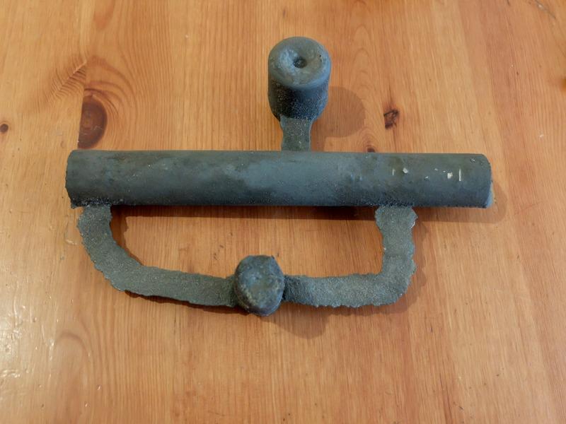

I think the first casting I'd like to pour will just be a 2" solid cylinder of cast iron. That would come in handy for making pistons in the sizes I'm interested in. I'm thinking it may work to just pour that vertically with an open top. In which case it also doesn't need much of a flask -- I've done that before in a stainless kitchen canister with just some greensand packed around the pattern.
I did much the same thing with the Tee slot bars for the carriage on my new lathe.

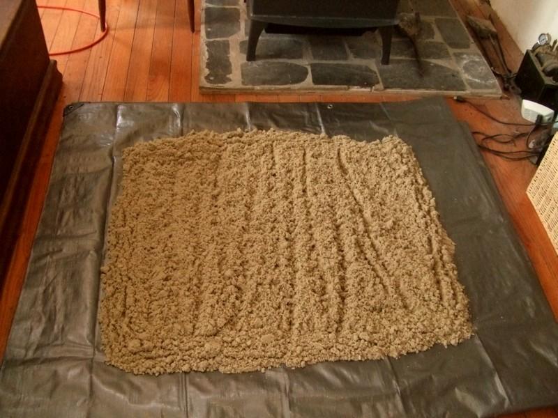

I spread out a new tarp in front of our home woodstove (with permission!) and have been drying the greensand that way, but it is still very slow going!

I cleared up the tarp and sand by evening.
When I first started drying, I did a moisture check by heating a 100 gram sample of the greensand in our toaster oven, spread out on a scrap of aluminum foil. I brought the whole above 100C for 15 minutes. Weight loss was 10 grams to start.
At the end of the drying session, a second heated sample showed a 7 gram loss, so after a full day we went from 10% moisture content down to 7%.
To cast iron, I need to drop it to 4%. To me the sand still feels quite wet in the hand.

Spread it out today for another few hours, turning it every once in awhile. Down to 6% now. Starting to feel a little better in the hand, but still too damp, yet.

The sand has finally dried to a good molding feel. It's been 2 weeks in a low indoor humidity of 30%!
What's even more surprising to me is that I dried 100 grams of it in the oven, and it looks like it's now at a moisture of 2%.
That's amazing. Unless I'm doing something wrong, but yes 2% and it has very good feel, compacts in the hand nicely without sticking, and a squeezed clump of it breaks clean. That's just how I like it. But 2% seems numerically, at least, very low. I was expecting 4% to be about right, but it was too wet at that level.
Well, not complaining -- that's actually really good in terms of casting without steam gassing problems.

The day was predicted to reach 40F and was clear with little wind so I decided to try to cast the new piston pattern in iron. i got most everything set up. It seemed like there was just a huge amount of gear to collect together for an iron melt -- mainly because I haven't done one in several years. Tongs, shanks, skimmer, flasks, leather protective gear, face shield, molding tools, oil fuel, vacuum cleaner, hoses, iron, greensand, ferrosilicon, riddle, ingot mold, plumbago, paring dust, and.....wait a minute, where's my compressor? Oh yeah, next town over, half an hour away......and a half hour back at my in law's garage.  :doh:
I Did the drive, well that killed things until after 2;30, with only a couple hours of good light left, but tomorrow was predicted to snow/rain, so I thought I'd give it a try. I set an A6 crucible with 5-1/2 lbs of iron in the furnace. Hooked up vacuum, compressor, diesel oil fuel, set comp pressure at 60 psi, soaked a small piece of rag in fuel, stuck it in the furnace, lit it with a torch, and then cracked open the oil valve. Whoosh! That familiar big yellow flare up on oil start. Always gets the adrenalin up. The outside temp was now 38F, but that didn't seem to stop the atomized oil from an instant startup. This furnace does not need propane to warm the walls before feeding oil.
I started the vacuum cleaner and then she roared - a little sooty smoky, so I eased the oil valve down until the smoke just disappeared. The furnace walls lit up almost immediately. That's the reflective face of the compound at work. It's a very fast heat up. So fast I started to wonder if I'd have time to make up a mold -- I used to have an hour and a half, more or less, but within 5 minutes the iron and crucible were now bright orange.
Unfortunately I was seeing some black smoke and soot flowing back around the burner pipe where it was attached. That meant the seal wasn't good around the burner pipe, and the pressure of the vacuum cleaner was apparently blowing some air fuel mix back out. The last lining was solid firebrick and clay ganister, so the burner was effectively cemented in for a 4" thickness. Now with this new blanket insulation, it's much easier to have a leak. The hot face coating has absolutely no strength -- It's like a thick paint layer over a cotton ball, so it doesn't hold tight to anything. I probably had just not pushed in enough insulation blanket around the burner hole when I installed it.
I kept going for a couple more minutes, but I started to see small flames licking out around the burner, so I reluctantly made the decision to abort. I shut off the fuel, the blast and the compressor. With everything shut down, the furnace was still brilliant orange hot, as were the crucible and the iron pieces. It took about a half hour to get the furnace unloaded and cool enough to patch more blanket in around the burner. I sealed it with hot face compound.
So no metal poured, but I was very pleased with the performance of the new lining so far, and I do have everything now collected for a melt as soon as the weather cooperates. I hope that can happen this weekend.  :dremel:

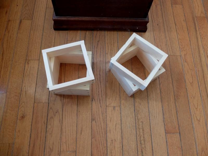

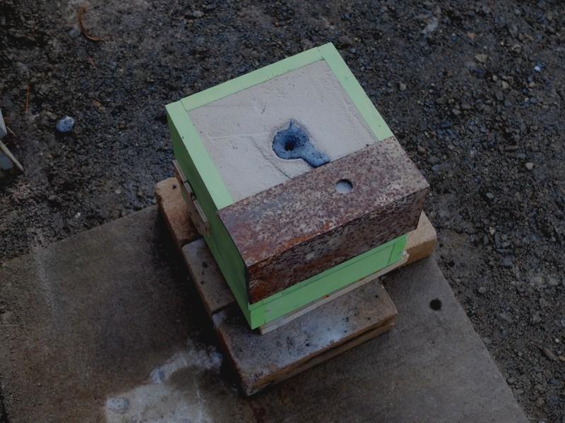

I made up some new small molding boxes to do a piston casting. Smaller boxes are easier to roll, and use less sand, so I can mold two at once from the same pattern with the 50 pounds of sand I have.
  • Posts: 6855
« Reply #47 on: February 11, 2022, 05:13:36 PM »
Wooden flasks don't last long when pouring iron. Generally it happens when there's an overflow from the sprue basin that reaches an edge, or a spill at the edge, or often just touching the crucible to the edge of the flask while pouring. Generally the rest of the box suffers less. It's mainly the top edge where the crucible is being poured from.
I do have some steel flasks that I built years ago. They are heavy and, as in this case, they aren't always ideal for the shape of the pattern you want to pour. So it's easy to quickly put some wooden boxes togetherfor a special need, but it would be nice if they lasted longer. Their light weight makes molding easier, particularly if the pattern is tall or large and you have to roll a few times.
I've thought about keeping the lightt weight of wood but adding more heat resistance by inlaying a flat metal edge. Better would be a channel shape, Though that would need to be flush with the wood on all three edges. So, it's impractical.
Then this morning I thought, why does the metal protector have to be attached to the flask? Just use a piece of heavy  angle iron,cut to size and lay it on top of the pouring edge after the mold is made up. That will protect the edge the side, and also stop any sprue overflow. Adds weight, too when it's needed, Simple!!  :doh:
And that's just what I did.
btw. poured iron today........

I was going to mention that to protect the wood. I’ve never painted my boxes but do have places on the sides to bolt both sides together in case of separation on larger pours.

I did a third iron melt in a week today. I timed it at 15 minutes from start to melting 6 lbs of iron in an A6 crucible, and with slagging and ferrosilicon addition, plus bringing it up to pouring heat, it was 21 minutes total from lighting the furnace.to pouring iron.
I used about a gallon of diesel fuel for that, now in winter, when heavier oils would not flow or atomize as well. I'm guessing there's enough heat  in the furnace after to probably do a zinc melt with no more fuel, or an aluminum or brass melt within a few minutes of lighting up again. I imagine a second iron melt might be 10 minutes more.
This same furnace and same burner, with 4" of firebrick and ganister insulation took 1-1/2 to 2 hours to pour iron 9 years ago, and those were borderline hot enough sometimes.
The only problem I've had so far is that a small piece of the lid blanket, (which was pieced together from leftovers of the main furnace lining), has come loose twice. That didn't happen during a melt, but after cooling. The blanket tends to shrink a litlle after an initial melt, and where once it was packed in place at the edges, it loosens. I did cement all edges with sodium silicate, per Ironman's video, and covered the joints with the hot face compound, but the blanket still shrank and loosened.
Today I put positive retaining in by screwing with self tapping metal roofing screws from the sides of the lid into the looser blanket pieces. I hope that holds better.

Today after some delay I attacked the lid. Well I guess attack isn't the word -- I trashed it and started again.
New (scrap) metal welded together. new insulation blanket installed. The philosophy this time WAS to do only vertical piecing. Horizontal layers don't work, because there is no reliable way to laminate layers together. Vertical piecing means that every individula section of blanket is in contact with the top of the lid and is cemented there with a generous amount of sodium silicate.
I started out trying to do the vertical half-width slice-of-pie method, as shown in the above video, but pretty quickly that showed it wouldn't work. My furnace lid is about 17" in diameter, while the oil can in the video is about 12" Maybe you can cram the inner ends together in a 12" circle, while the outer ends expand enough to fill the spaces, but not on a wider lid.
So I ended up doing a sort of roll-up method, with strips and pieces attached concentrically, except at the center. The final 3" around the exhaust hole was done in the pie wedge method -- and it made sense there -- especially because I wanted to have a leg of each piece extend up through the hole -- similar to the way Iron Man did it in the video above.
Here is the new lid packed with insulation:

 I finally did cast something from radiator scrap this evening, just to see if there was any difference in melt times. Definitely was -- exactly half, 30 minutes to pour, compared to an hour for disk rotor scrap for the Westinghouse Twin. Melts were the same size, 7 pounds each. Both got 11 grams of ferrosilicon. This time I just cast a rod of iron, using a pipe 10" long as a pattern to try to get some 1-1/4" stock. I just plugged the ends of the pipe with sand. The pipe was 1.335" actual dia. so some machining allowance was available.
I figured it would be a handy piece of stock to have around. It poured uneventfully, though lots of slag was skimmed off. Losses were high -- about 20%. It poured just a tad short because of that -- the sprue and riser didn't completely fill -- lost maybe a half inch of head height. It was a shallow flask - 2" each, cope and drag.
There was a little shrinkage towards the ends -- I probably didn't place riser and sprue in ideal positions, but it was just a quick judgement call. I'm very interested to see if there are any internal casting flaws, and how hard it is. I had big problems with both blow holes and slag inclusions in my early days of iron when using radiator scrap. But maybe things will be different this time around.
Here's a photo of this quick casting attempt -- just before dinner!
ps....after dinner -- the runners sawed off with a hacksaw, which generally indicates it's going to be nice gray cast iron for machining.  Also the worst shrunk spot calipered to 1.28" thickness, so I can probably get 1.25" dia for almost if not the whole bar. Not that I have an immediate need for it, but both my lathes and all my QC tool holders fit on a 1.25" posts, so it's a useful size for me. Also it can be used for small engine cylinder liners and piston rings.
« Last Edit: May 24, 2022, 08:40:20 PM by vtsteam »

It looks great on the outside it will be interesting to see if it’s inclusion free when you get around to it.
  • Posts: 6855
« Reply #67 on: May 25, 2022, 05:12:07 PM »
Tom, I machined half of it down to true 1.25"  to look for flaws and there weren't any. It's very nice machining iron.
