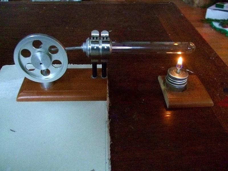

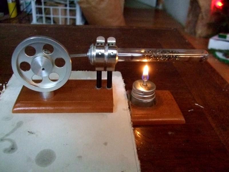

Maybe ten years ago I sent away overseas for a $30 Ebay Lamina type "test tube" hot air engine. This was early on, before there were dozens to choose from all over the net. The engine in the pic looked decent, but 5 weeks later, when it arrived it turned out to be somewhat smaller than imagined.  :palm:  Kinda like those offers in the back of comic books (before they became graphic novels)
Worse, it didn't run.
I messed around with it, changing out the regenerator material, repositioning it, etc, etc, but it never did run. I put several days into trying to get it to go, but finally put it on a bookshelf to gather dust.
For some reason I have just taken it down again today, and started fiddling around with it, just in case I was wrong in what I tried the first time around, and missed something. But nope. Another few hours killed today.
I mean I know I can build a working hot air engine from scratch. I have in the past. And in fact I have a much larger one in mind (and have had that one in mind ever since I started building my (and still unfinished) "new lathe". In fact that was the reason for the lathe....but that topic might best be ignored for the present)
BUT (another but), ye see, some of the questions I have about my long-planned much larger engine, might be answered by trying to figure out what I can do to get this little bit of a contraption to function as it should. I mean in fact it SHOULD work it has all the bits and pieces an engine of this type should have. Which is the reason I keep coming back to it. Because it doesn't run.
So, why, that three letter word, is the reason I'm starting this thread.
Here's the little bug:

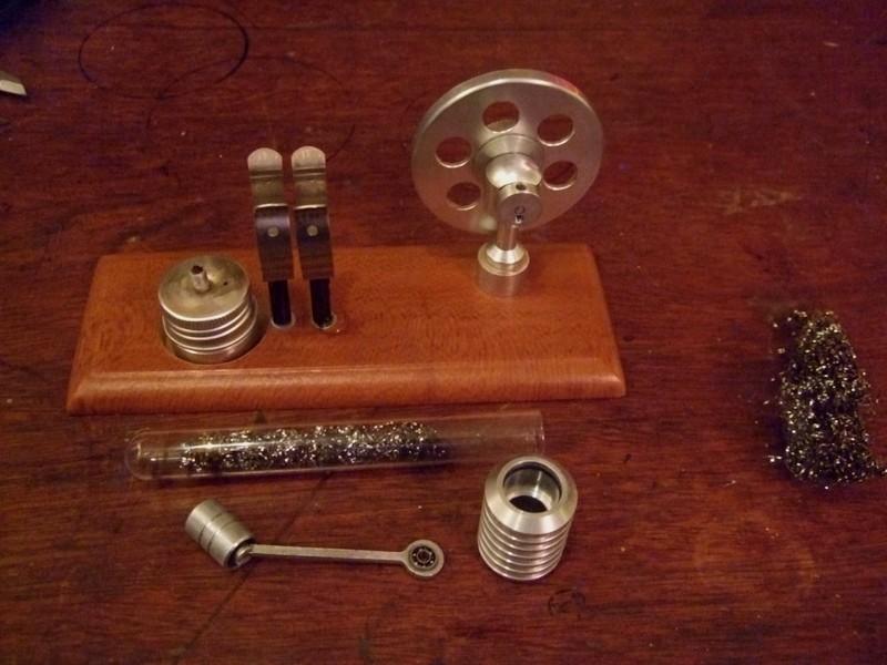

Well, Andrew, there is technically no displacer in this type of engine, just a piston.
re Friction:
The flywheel and big end of the con rod have ball bearings. I believe the small end is just pinned. When apart, I can give the flywheel a spin by hand and it sustains for quite awhile considering its tiny size and mass, and it even stops and rocks a few times because the balance is off by a tiny amount. So that seems to be pretty low bearing friction overall.
Now for the piston itself, it's 12mm dia, x 17mm L, hollowed aluminum.
Piston + con rod + bearings :  complete assembly weighs 5 grams.
Piston cylinder fit: It takes 7 seconds for the piston and conrod to drop ~ 7mm under their own weight if I hold the cylinder vertically with my thumb over the bottom end.
Here's a pic of the bits:

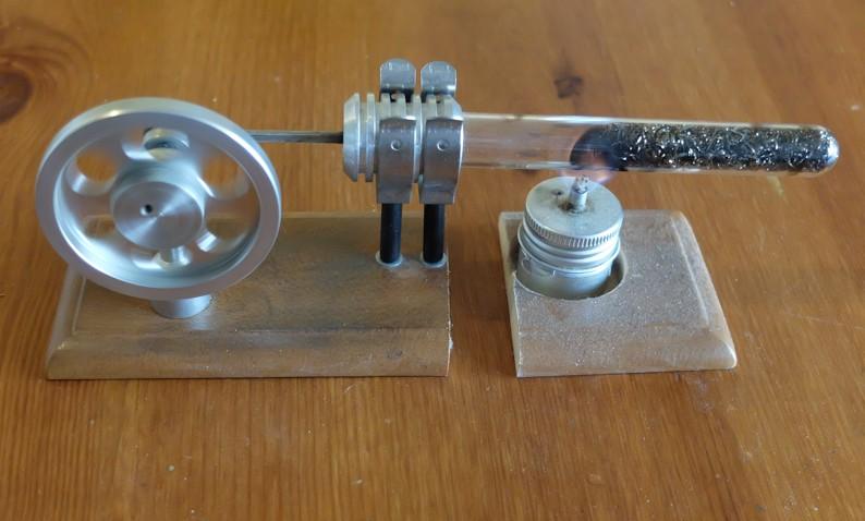

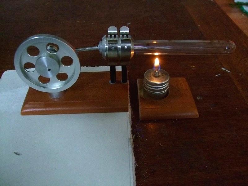

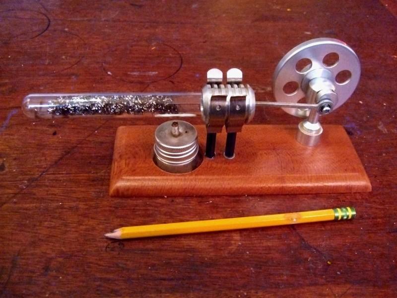

Hermetic, happy wine and chocolates! :beer:
1.) I've used light oil on the piston and all bearings. Compression is slightly improved.
2.)I've sawed off the end of the base so I can now move the lamp. I also raised the engine 1/2' on a piece of wallboard. This makes the flame pointed instead of squashed out around the test tube.
3.)I've tried the engine without any regenerator material. I tried several different flame locations for that case.
4.)I've tried the engine with about an inch plug of regenerator material. I've moved that regenerator to several positions along the length of the tube.  I tried several different flame locations for that case.
5.) I've tried the engine with about an 3 inch plug of loosely packed regenerator material. I've moved that regenerator to several positions along the length of the tube.  I tried several different flame locations for that case.
6.) I haven't tried more tightly packed regen material yet.
Best action seemed to be exactly as pictured in other engines, with regen material about half the total length of the test tube, located a little more than a quarter length away from the aluminum cylinder. And with a small space open at the far end. Flame located right about where the regen starts. When I did that and flipped the flywheel, the engine took longer to slow to a stop, and seemed to want to continue toward the end.
Yes, the glass tube is socketed into the aluminum cylinder with an O-ring.
Here are some pix of a few of the various setups:

Almost a year later.....got it running!
It's doing about 180 RPM here, The main changes were separating the base so the lamp could be moved, packing half the test tube tightly with regenerator wool right to the end, and using graphite as a lubricant in the cylinder. Ideally, as Andrew remarked earlier, a graphite piston would be better than aluminum, but I didn't want to do that for this small purchase, just getting it running for now and trying different regenerator and lamp configurations was all I wanted.
It's not a very awe inspiring runner, but at least it does what it is supposed to, and it helps me work out a couple of the problems with regard to the engine I want to build. Happy with that after all this time!  :ddb:
