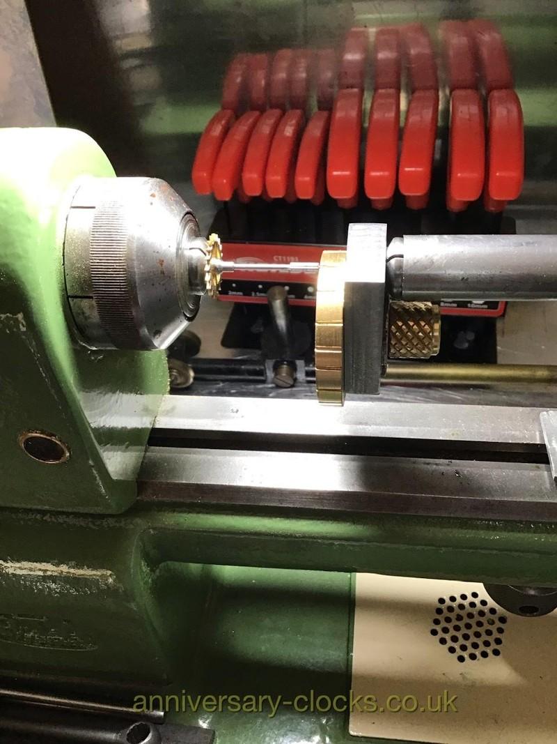

I forgot to add pictures of my Pultra 17/70 finished and being used also very accurate.
Dell

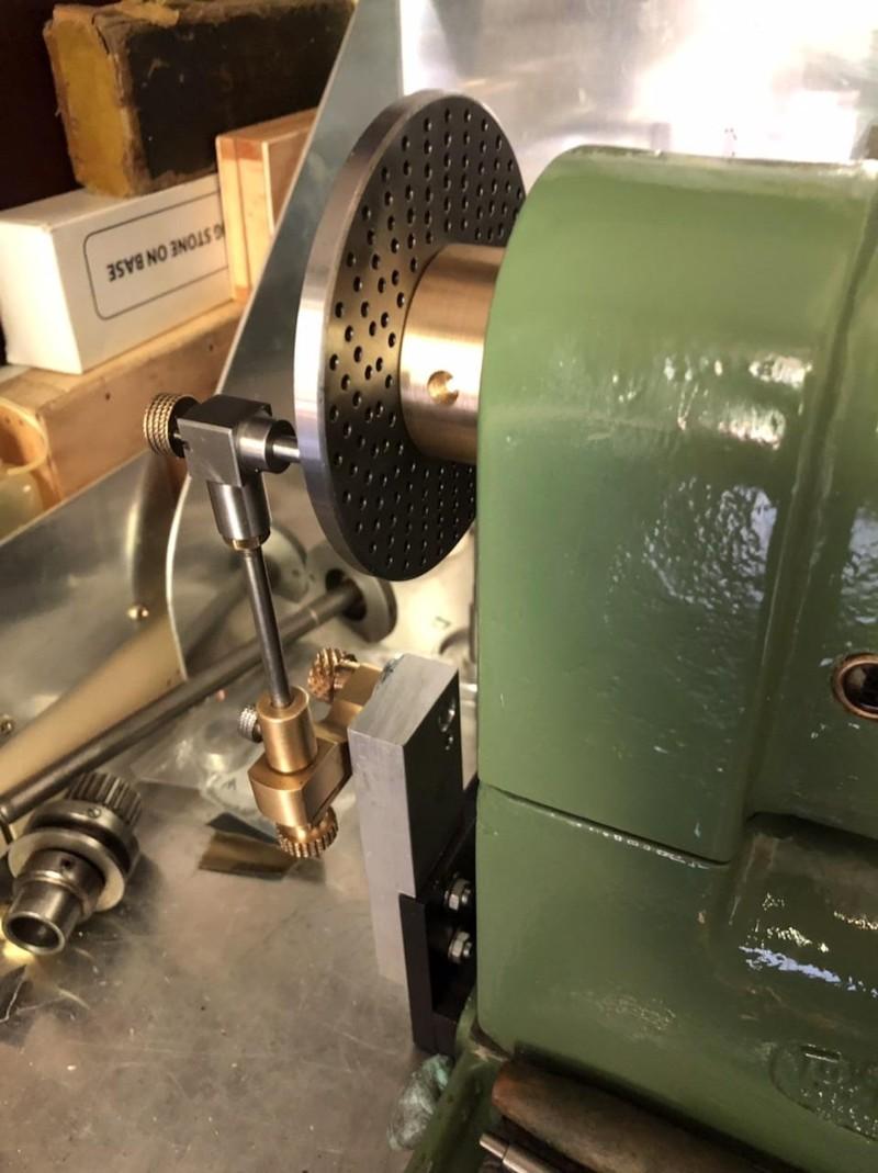

Here is a few more anyway, I am going to remove the bearings as since I have been using it I haven’t seen the oil drop on the sight glass so I am wondering if the wick’s have go hard or worse still missing altogether the bronze bearings were the only part  I didn’t remove  because there was no play I have also added an indexing plate with the mounting modified to fit my rotary table plates.

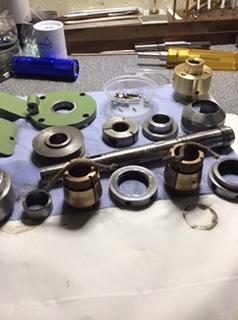

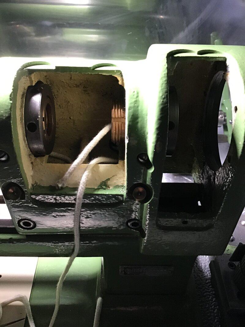

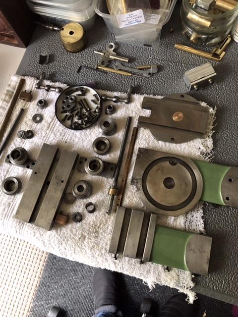

Headstock apart because I thought the wicks may be past there best  because it didn’t seem as though it was using any oil , but Sod’s law they were fine and oil all round bearings and spindle, so it must be it doesn’t use much oil because no wear on bearings and very slight marks on spindle I can see them but not feel them, new wicks going in anyway.
Dell

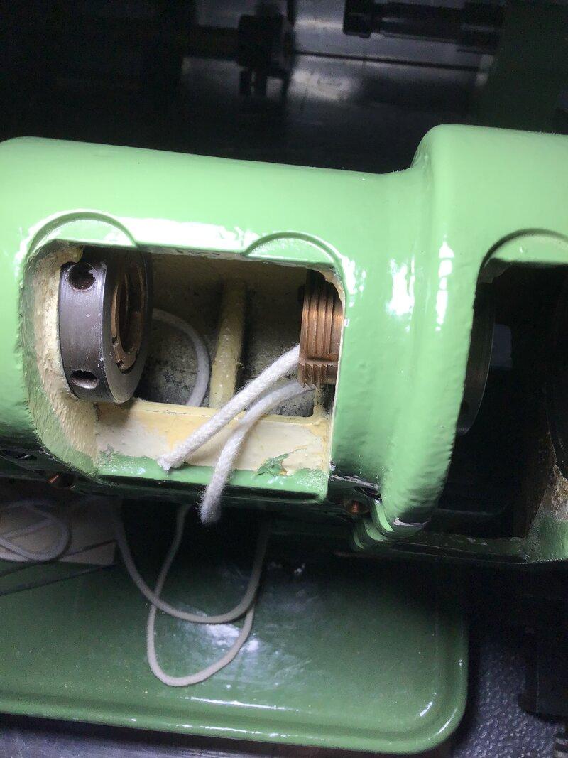

What a fiddly job fitting new wicks but got there in the end.

I don't really understand how the wicks work/are fitted. I assume they wick oil? Or are they seals?

« Reply #14 on: November 08, 2022, 03:19:09 AM »
The wicks sit in high speed spindle oil and there is only about.5mm stuck out into the bearings so I presume it must be something to do with the spindle rotation that causes centrifugal force to suck a small amount of oil into the bearings ( just my best guess though), but it’s running nicely and it’s quiet.

So is there a hole in the side of the bearing or bearing housing that the wick goes into? Tough to tell from the photos -- it just looks like a spaghetti spill.  :poke:

The picture is after I had fitted the wicks but before I trimmed them off , yes there is a 2mm hole in the bearings and about 1/2mm of the wick sticks out into the bearings and the other end of the wick just sits in the oil well, I am not sure how it works either but it must do because Pultra used that method of oiling for all there lathes even the 15/90 that looks identical to my lathe but about 4  times bigger.

Thanks Dell. I'm sure it works I was just curious how it's routed.  :beer:
