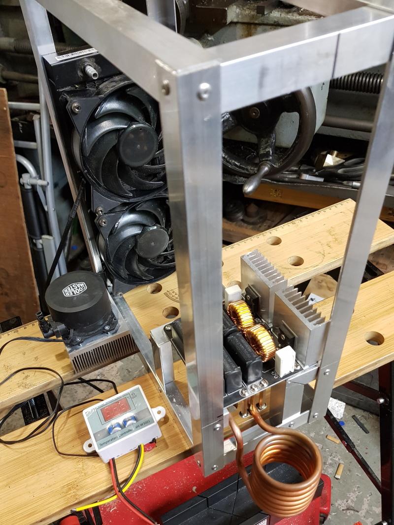

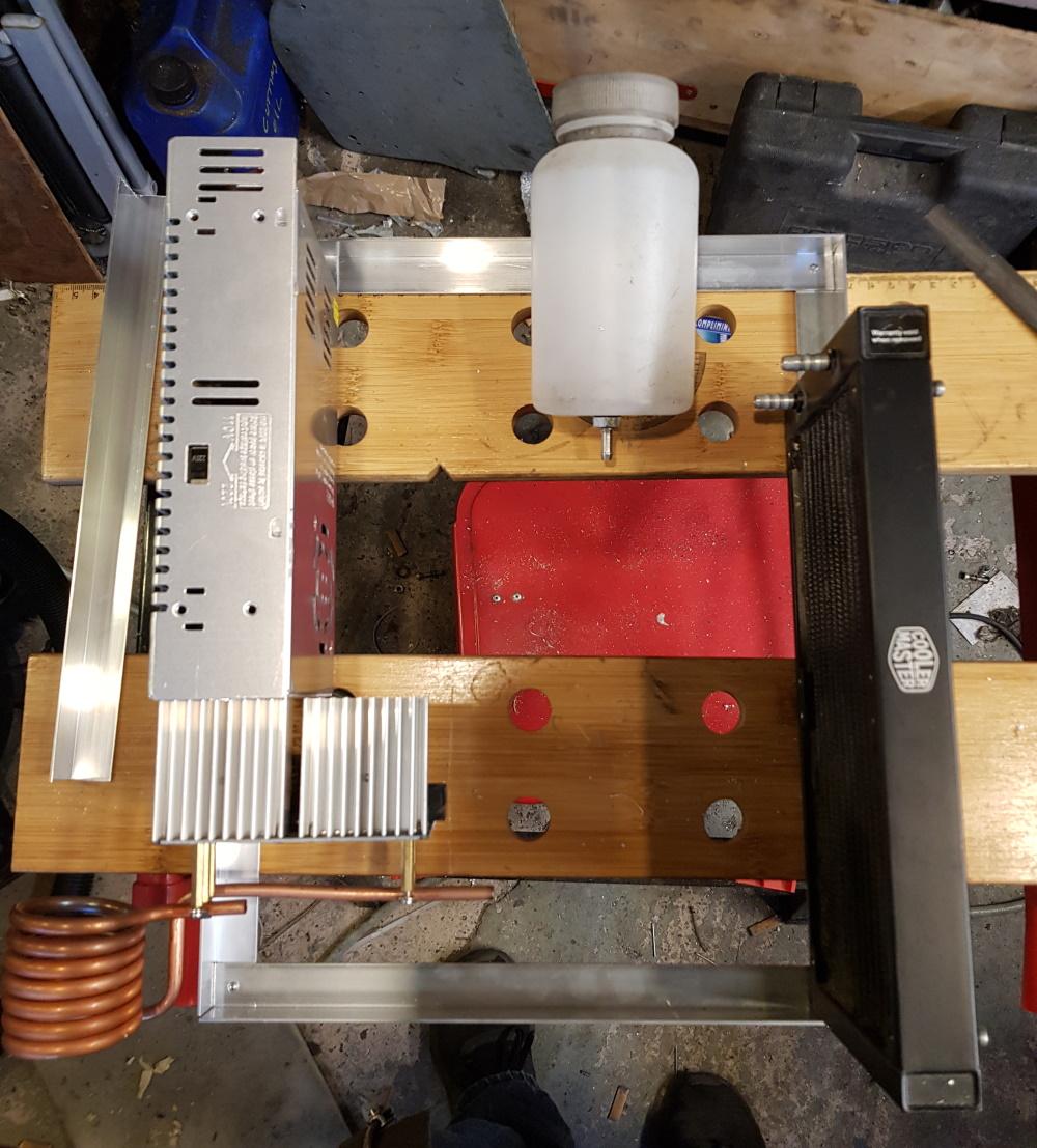

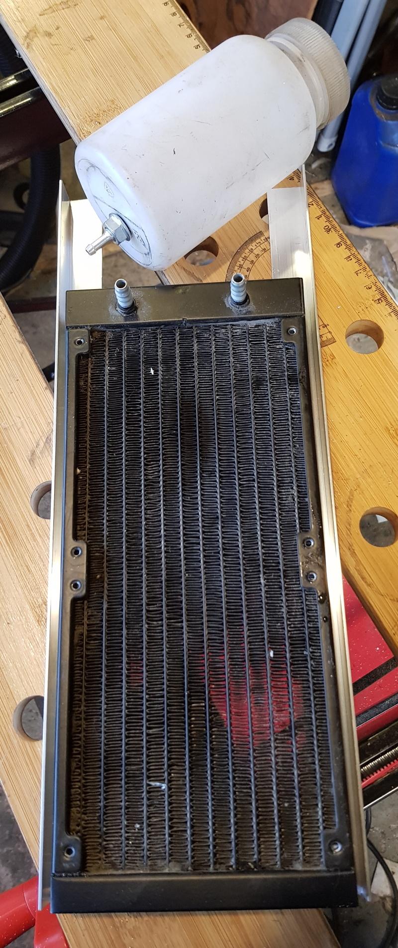

I brought an induction heater which I have been using to oil blacken some diehead parts but as I didn't have any cooling I have been doing 4-5 then switching it off to allow it to cool. So now I am working on housing it properly (not on a brick  :lol:) and adding cooling.
As luck would have it my daughter replaced her "broken" CPU cooler which when I stripped it apart I found had somehow leaked all the fluid out and was just pumping air around the system, seems daft that they dont give you some way to fill it?
So to start with I swapped the coil on the induction heater from the top to the bottom of the board and cut some aluminium angle to mount to the radiator to get me started. The filler bottle will be fixed at an angle because I plan to be able to use it in two orientations.

After a little thinking about I currently have the setup in the picture but I am now thinking I may modify it a little and make the power supply sit at a slight angle but I am out of aluminium for now so will have to look at it tomorrow.
I am still trying to decide if I should include some kind of timer and auto shut off, I guess I will have to see how it runs once piped up.

It'll help, but depending on the size of your heater you're probably going to need more cooling than that radiator can supply.  The induction heaters I've worked on needed a LOT of cooling but they were a little bigger than yours.  If you want to use the induction heater for any length of time, you'll probably need more cooling capacity.  A CPU cooler is probably good for a couple of hundred watts - if that much.
I would imagine that this set-up would be similar to the coolers used on some of the CO2 lasers.  I think those guys start with a bucket of ice-water and shut down when the water gets warm.  On a closed cooling system think BIG and cold, the more thermal mass you have, and the colder it is, the longer you can run.

Thats food for thought but the radiator does have two large fans mounted on it and the pump itself I was going to just mount on the side somewhere but I have a rather large heatsink I could mount it on instead. Might also be worth mounting a temp readout too, not sure how high the ones I have go up to will have to check that tomorrow.

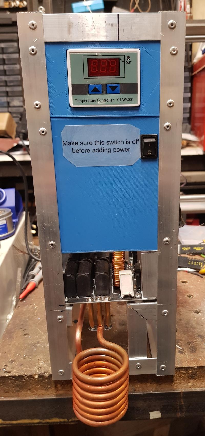

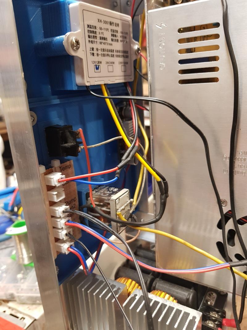

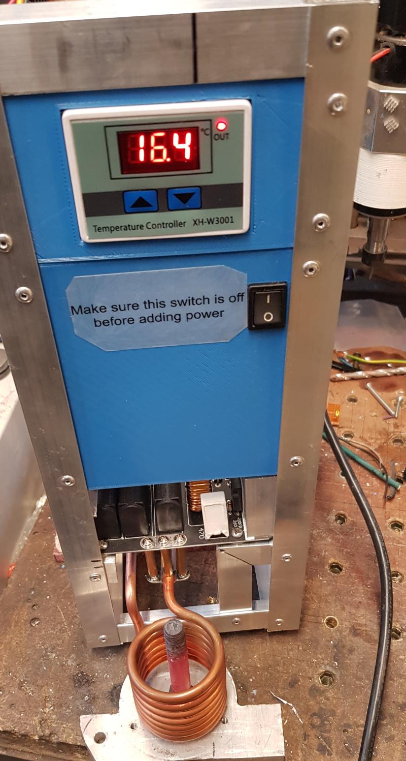

So despite the cold and my shed heater packing up I still managed a bit of progress. All the bits are fitted and wired up which wasn't hard.
The output from the temperature controller is wired via the main switch so if it gets too high it will switch off automatically and not start again until its cooled to the lower setting, all pretty standard.
I am still undecided about using the plastic bottle as the header tank because fitting it will be awkward and I might make/Aquire something that fits better.

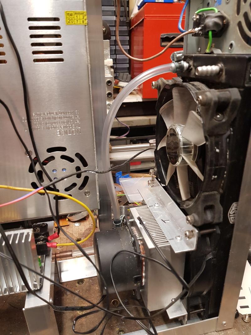

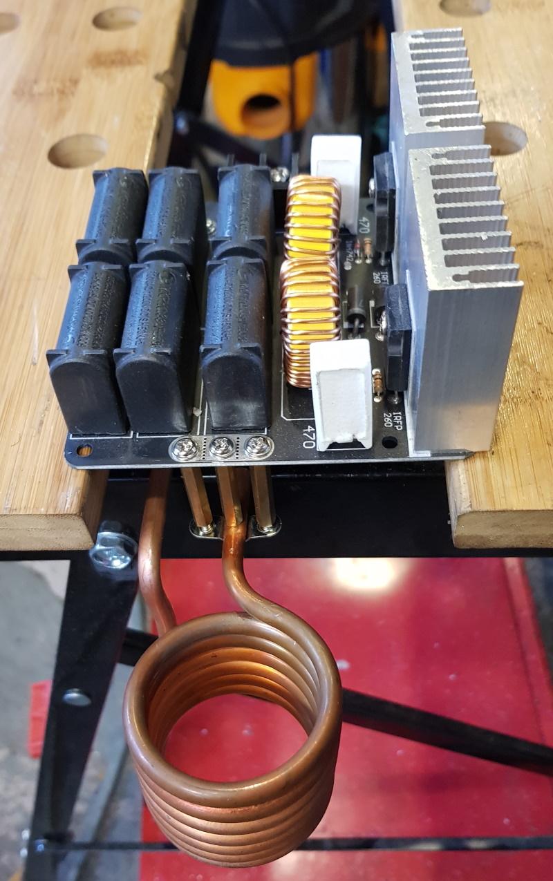

So because I couldn't wait I hooked it up to test it and I am quite happy I ran it for a good while and the temperature never exceeded 17.2C although its not running at anywhere near full power.
I think that in the future I will get a power supply that will run it better, currently its on a 24volt 15amp and even though I haven't checked the amps its drawing it doesn't seem to be putting the power supply under any strain so I think (size permitting) I will get hold of a 36 or 48 volt supply.
There is very little heat in the caps and only a tad more on the mosfets but its providing enough heat to the part to do what I want it for which is mostly going to be oil blackening parts but if I could get enough heat for hardening parts that would be a bonus.
One thing I will do is rotate the pump so the inlet and outlet are at the top to prevent any air lock in the pump, I should have thought of that before actually.

I'd expect a converter like that, driving the coil directly, would be around 90% efficient and most of the switching losses are in the air cooled FETs. Even if you lost 50% of the resulting HF power in the copper coil, that would still be a fairly modest loss. And given that the power supply is rated at less than 400W, you are not going to challenge the radiator and fan no matter what you do.
Does it say what supply voltage you need to get it up to the claimed 1000W?
Modern processors only take around 30-40W whereas the graphics cards are in the 200-400W region, so I'd hope a water cooling system would be good for 500W or so. That would fit with the tpical PSU rating required these days, given that the output power all ends up as heat.

I think 48volts is the maximum they suggest for running this unit but I did hook my meter to it and the unit was drawing 13 amps which goes down to around 7.5 when the part (a M12 bolt) gets as hot as it will go.
