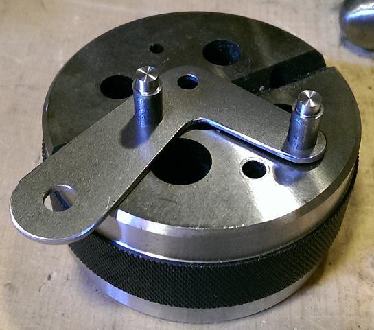

I'm making a pair of Kant Twist clamps.  I'm not using threaded fasteners to hold the plates together; according to the plans I have, I've made pins and am peening the ends.  The trouble is that the slop that I thought would go away hasn't.  My pin shoulders wound up about 2-3 thou smaller than the holes, and they're about 102 thou long going into 16 gauge (62 thou) thick arm plates.  After a few minutes of peening with a small ball pein hammer I have the pin staying in and not falling out, but the 2-3 thou slop is still there and the extra 40 thou that I thought was needed for peening hasn't reduced that much.  So, there's slop in both directions.
I'm wondering if: 1) My hammer is too big?...it's 8 oz and on the scale of the 3/16" pins maybe the end is too flat?  B) The extra 40 thou beyond the plate thickness is too much?  The plans were calling for 60 thou, though.  And iii) I just need to spend much more time hammering?
Any tips for peeing would be appreciated.

You are peening round the edge of the pin not just hitting it square on aren’t you?
Offline Mike K
  • Posts: 114
Re: Peening tips?
« Reply #2 on: October 28, 2021, 09:05:33 AM »
Well, no...I was hitting it square, but with the round nose end of the hammer.  I guess this is an obvious mistake.
Offline Mike K
  • Posts: 114
Re: Peening tips?
« Reply #3 on: October 28, 2021, 09:45:38 AM »
Actually, I was hitting every spot on the face, square on as well as the edge.  I think I need a smaller nosed tool, like maybe a small drift with the nose rounded?  The pin face is only 3/16".

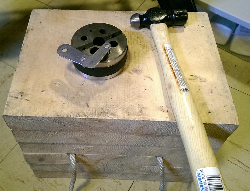

Okay, I finished up one side of the pin and did another pin very quickly.  First pin literally took about ten minutes.  Second pin under a minute.  Both pins are nice and tight.  I changed up a few things.  I was using the "drill block" directly on the vinyl floor (concrete slab underneath).  I moved that onto a wood block that I use as a car jack stand.  I also took bigger swings, I think.  And I was angrier this time. :)
Thanks, guys.  I've literally never done peening before.  I think I should still get an anvil for future use.

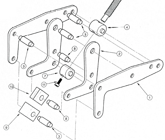

The elbow hole of that harm holds a pivot piece that the leadscrew fastens to...It'll turn as the clamp opens and closes.  I have a rod of bearing bronze that I was thinking of using for it.  Will that peen well?  Or will it distort too much and leave me with a bad pivot?  It's part #7 in the diagram.

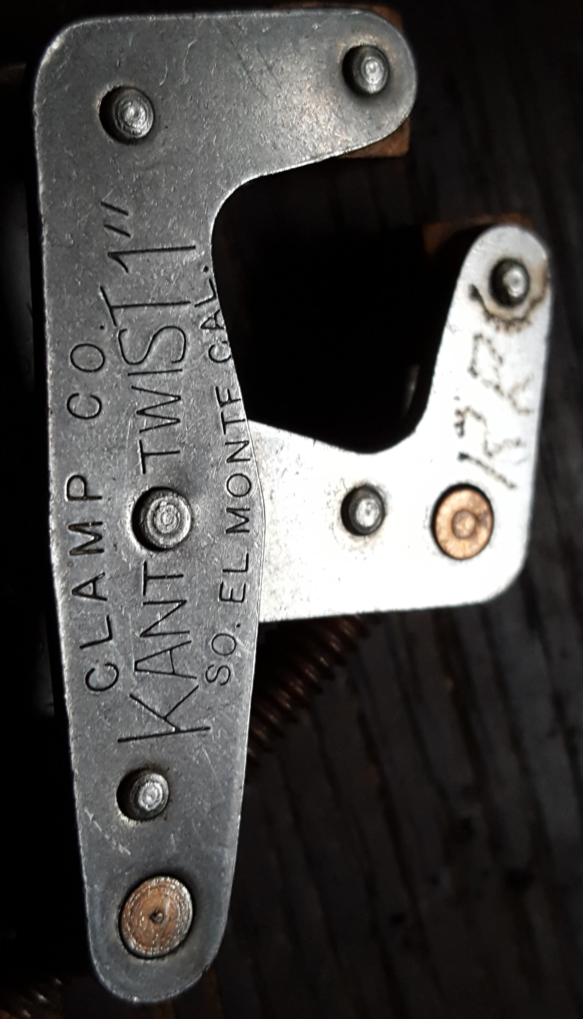

#7 and #4 are not peened on the real thing.
p.s. One of the #3's is not peened.

« Reply #13 on: October 29, 2021, 06:14:11 PM »
Now that I think about it, it makes sense...the pivots don't need to be peened as the plates are already bound by the other pins that *are* peened.  And that explains why there is a #3 so close to that pivot.  Thanks.
