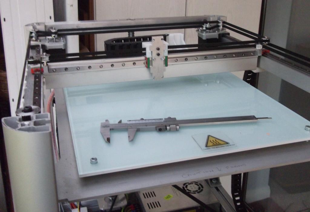

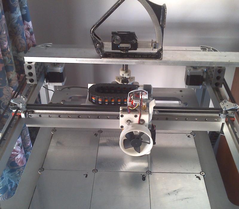

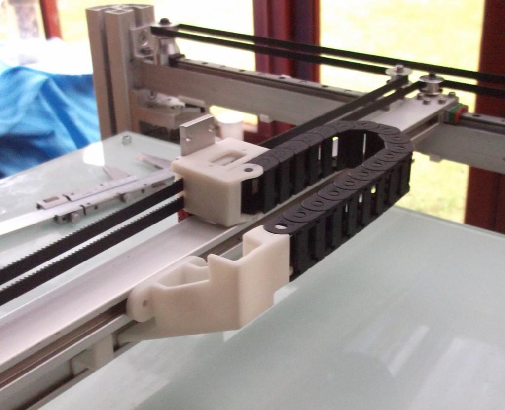

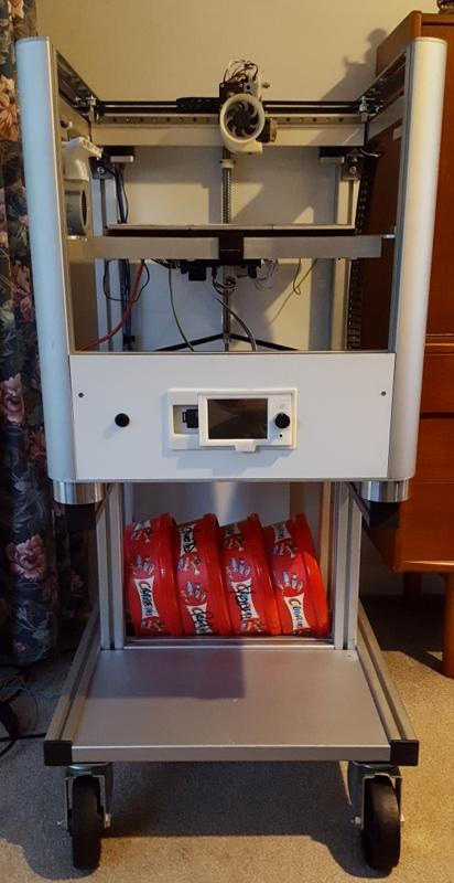

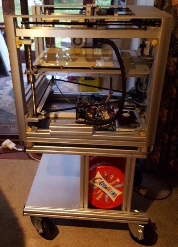

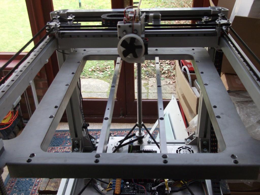

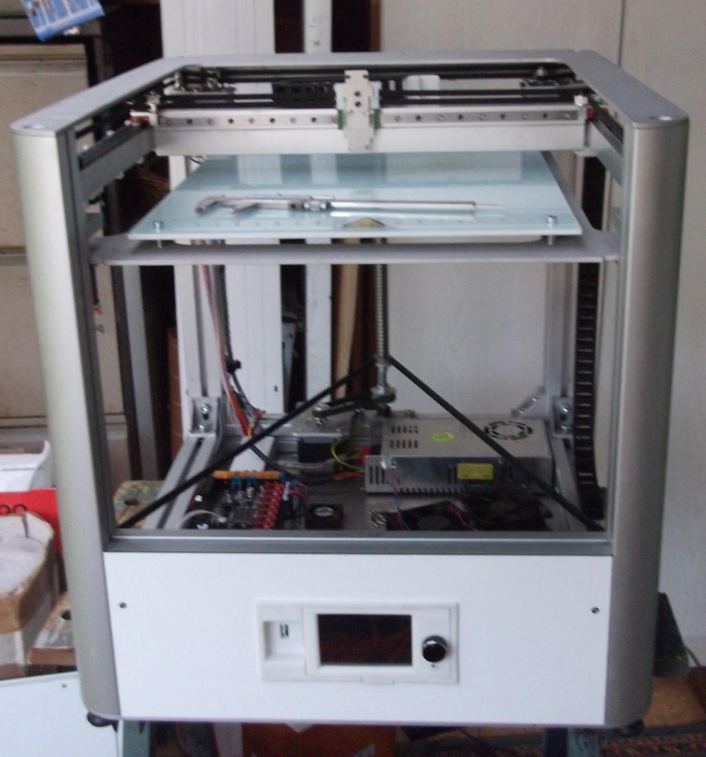

Finally remembered to take some pictures ...

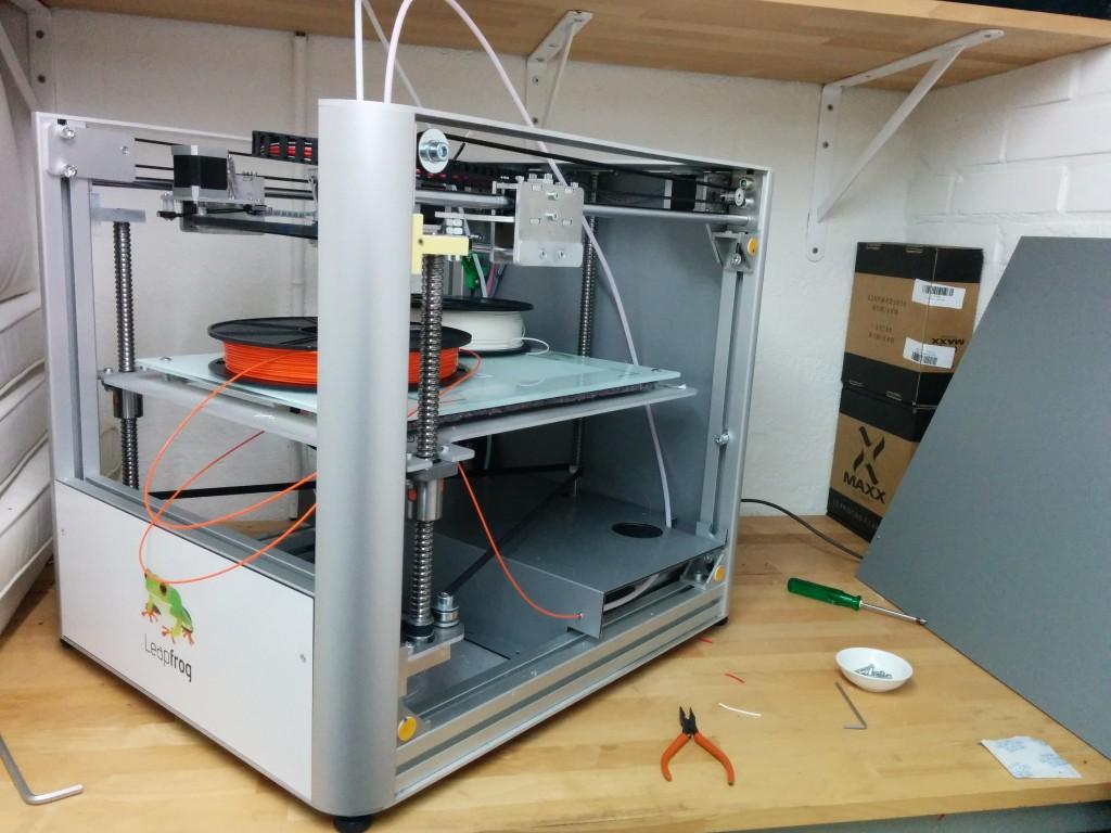

I'm converting an old Leapfrog Creatr 3d printer to a Core XY design (core xy  is an arrangement of belts that allow the motors to be mounted on the frame)
The creatr is a stout design from a few years ago. The rod linear rails used are unfortunately rather wobbly and the leapfrog dual extruders are rather crude so replacing them with cheap hywin clones seemed the best option .

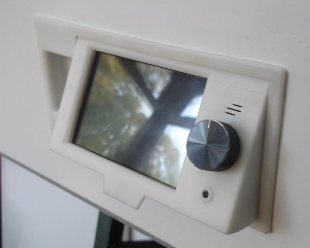

I'm using a Bigtreetech Octopus board , with tmc2209 drivers, and their 3.5 inch touch screen.
The Saturn resin printer has found a good use printing various part.
It's still a work in progress , and I have still to decide exactly what to do with the hot-end/extruder , other than I want it to be easily removable and swapable with other work heads (hence what you see in the pictures are just place holders for the yet-to-be-designed parts).

Hey Bill
That's cool! I did not know Leapfrog even made a 3D printer. I like the core XY design... I hopefully I will be on my way to building one soon as well.

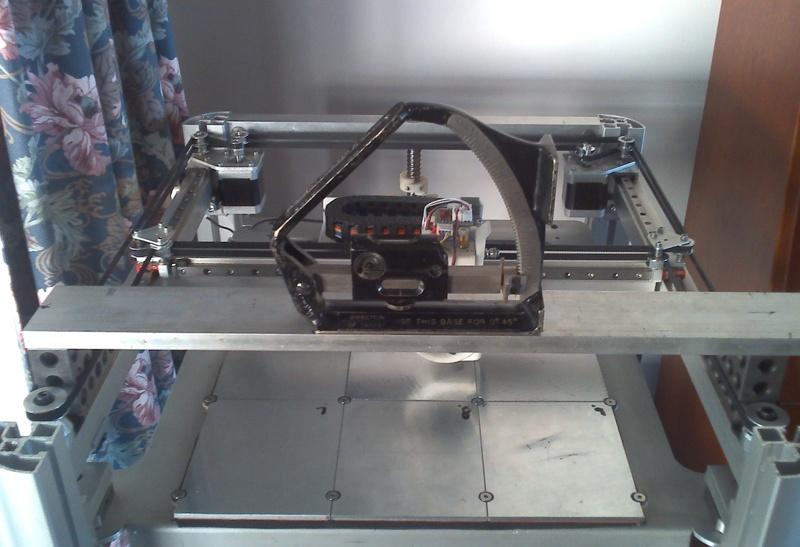

Having fun with some extreme belt resonance ATM.
Not sure if I should add tension or let it off   - seems OK at slow speeds but much above G0 F15000 starts it honking like a mule  and then it quietens down at 20000 again (both way too fast to print but rapid moves are at this speed)
More tuning required

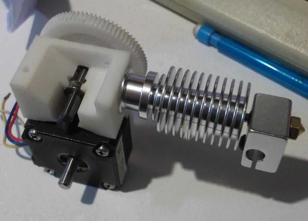

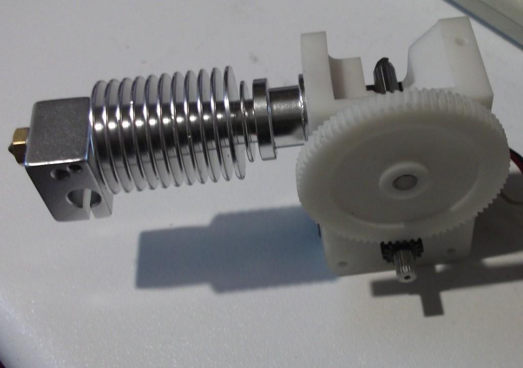

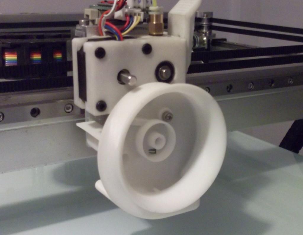

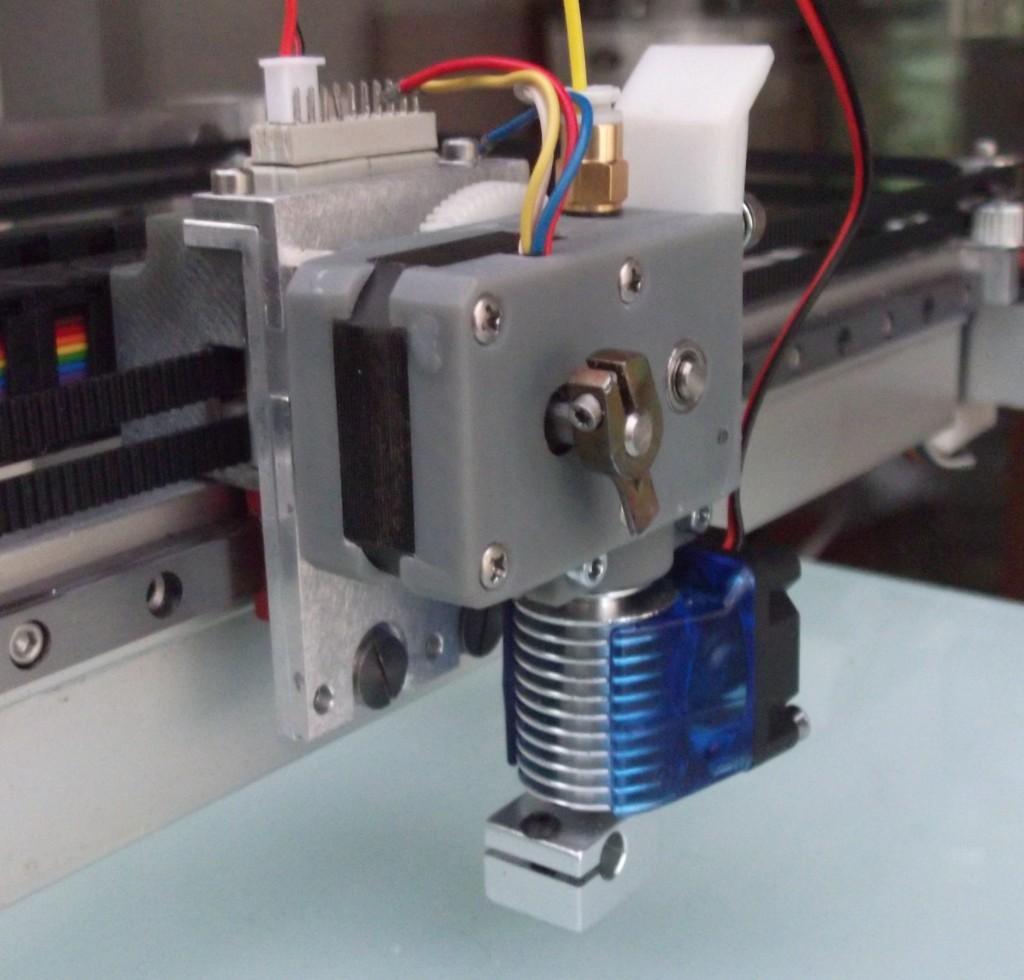

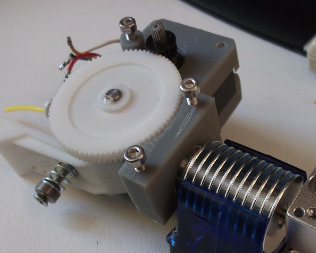

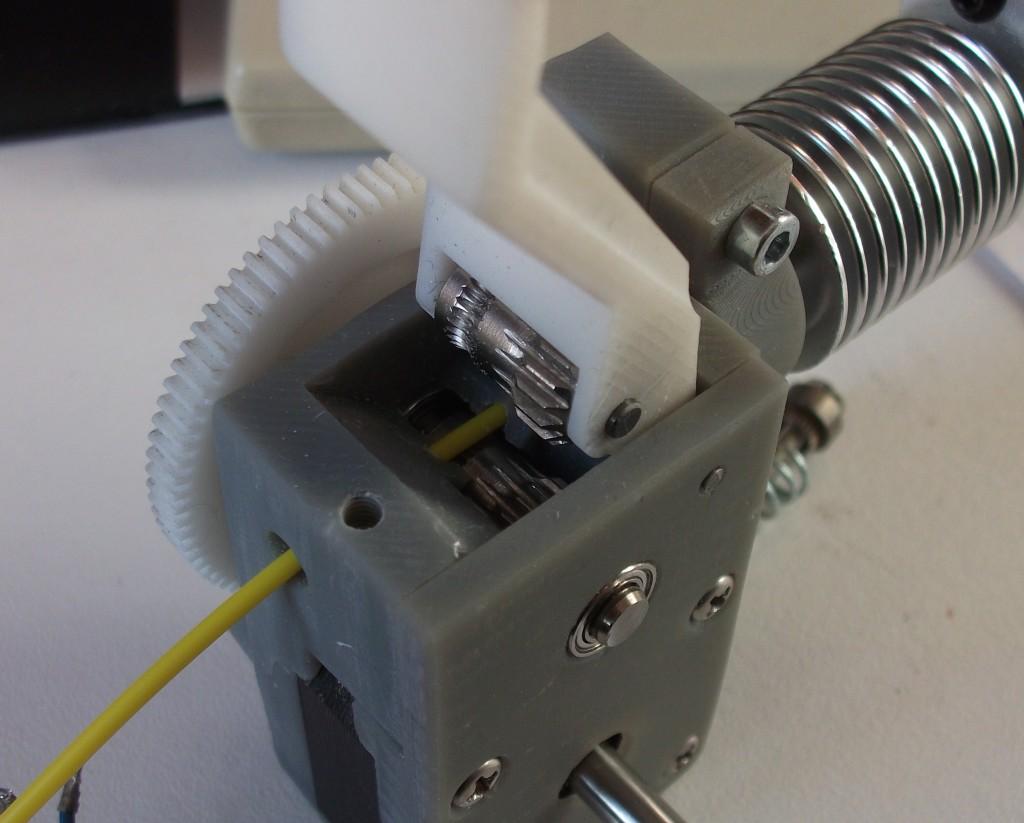

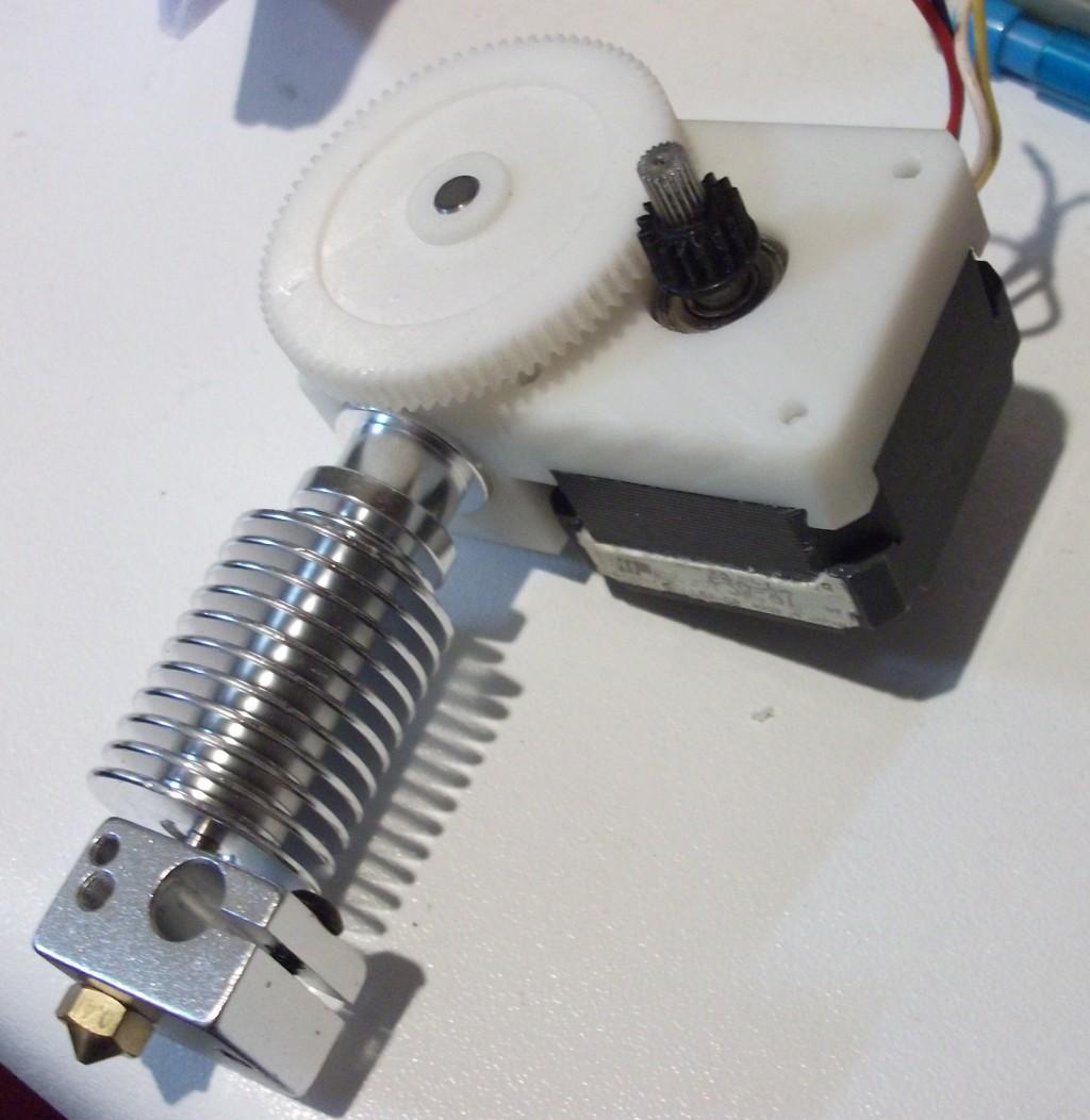

I really did not think this would work as an MLSA part, so just  printed the one half of the aluminium parts as is.
So what we have here, is a geared extruder  (5:1) using a tiny 35mm stepper from a 8" disk-drive . I have replace one end cap with a 3d printed part (with the intension of replacing both end caps). It'll have a couple of bond-tech type grippers and a sprung lever to pinch the filament
The large gear (80T) is printed while the small gear , 16T, is a nylon(?) part from some random printer scrap . I have a 3d printed 16T gear with works but is a tight fit .
It required a little hand finishing to fit the stator exactly centred (the print was a little tight) and the bearing fits always require a slight clean-up.

Tadpole 2
Aligning two plastic stepper motor halves is somewhat more challenging , but with a little kinetic adjustment , it does work.
Now I have to finish the rest of the printer to try it out

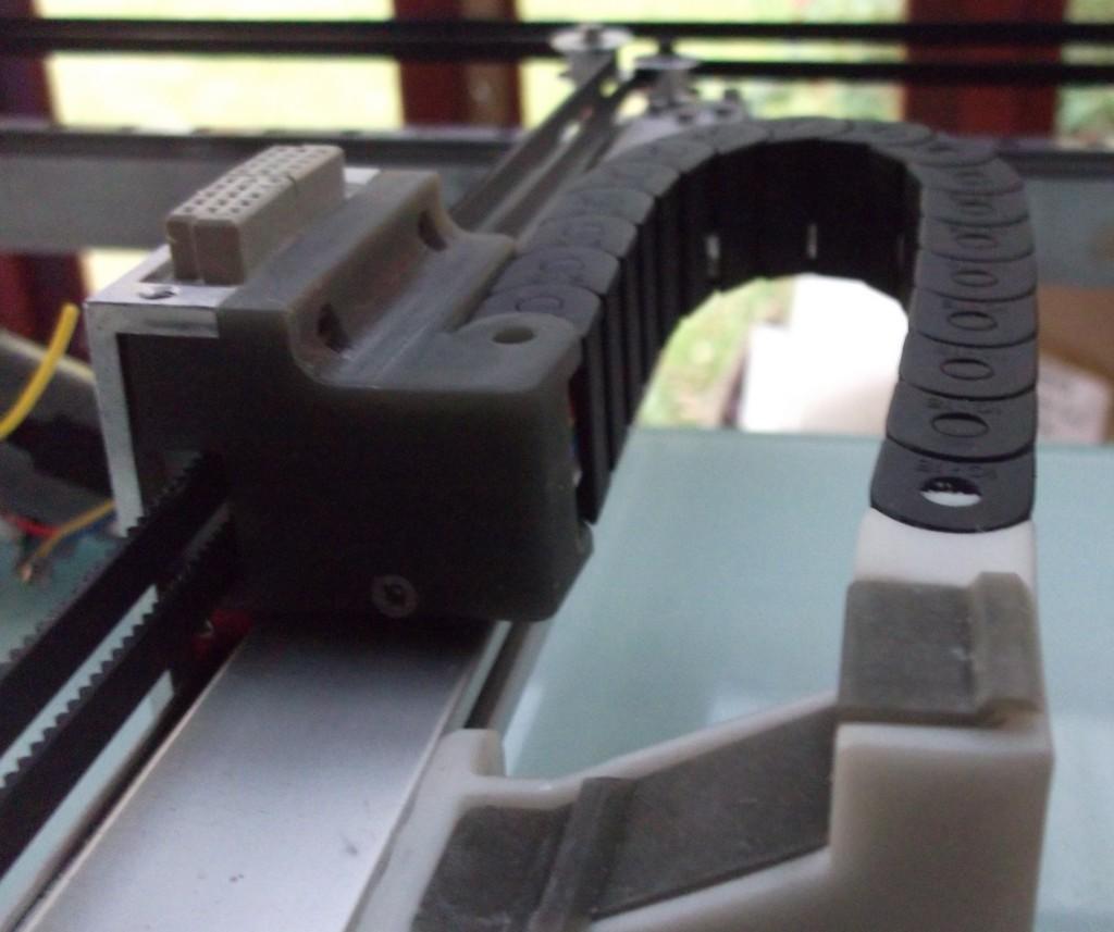

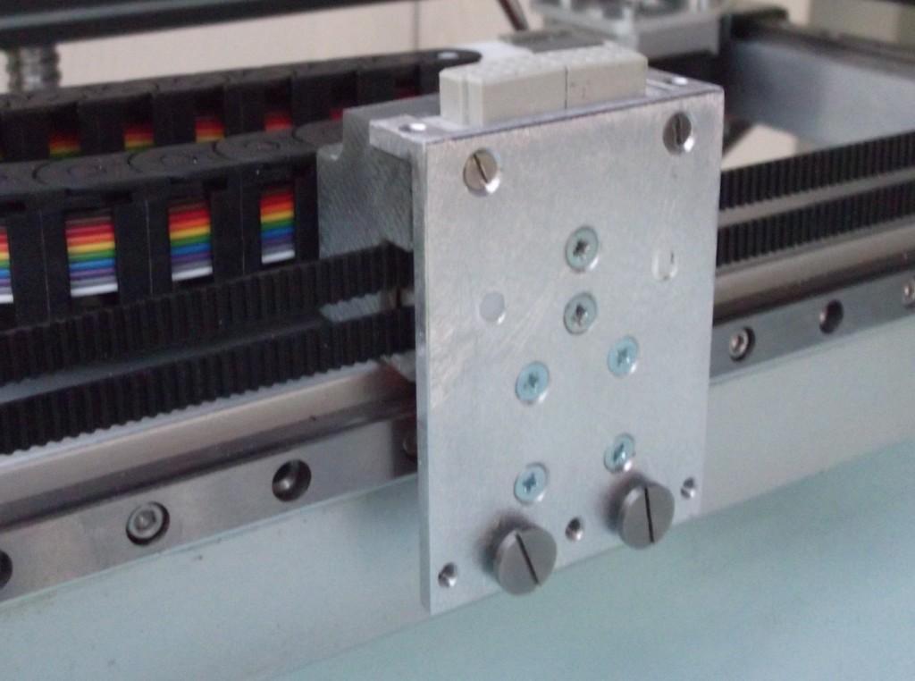

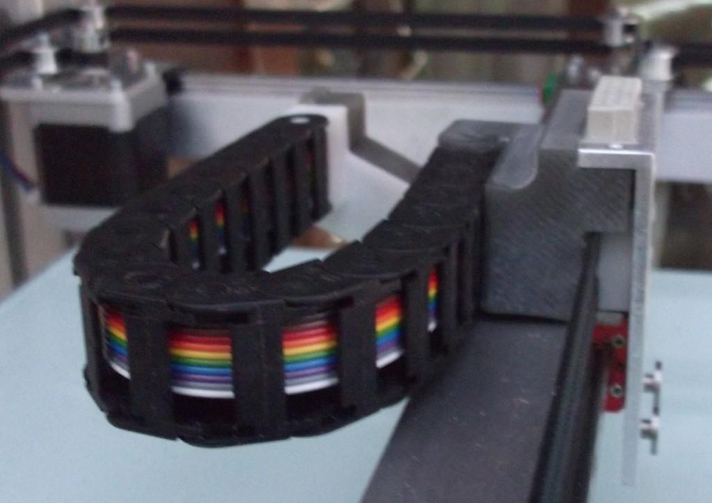

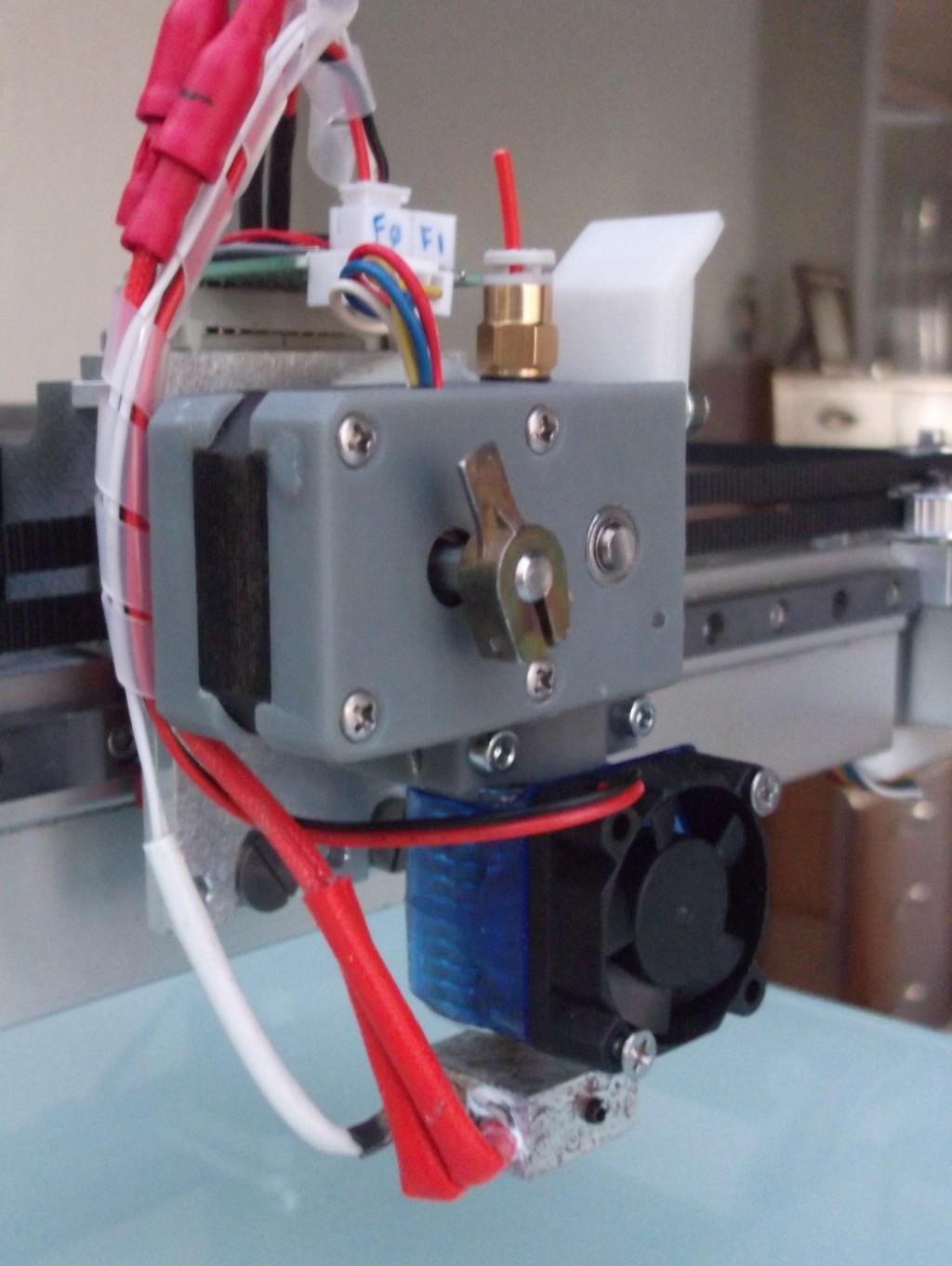

Finally got around to wiring and  the extruder mount.
The connector is a 41612/3 but I didn't have one in stock (and Farnell wanted £18 quid for one or £250 for a 100) so had to make one from two bits of a full size 96way one .
There's wiring for dual extruders, 3 fans and a few spares for whatever comes up
Re: 3d printer - Leapfrog creatr conversion
« Reply #9 on: November 05, 2021, 12:41:55 PM »
Neat  :thumbup:
Offline WeldingRod
  • Posts: 401
« Reply #10 on: November 06, 2021, 11:42:28 AM »
That is some proper ship-shape wire tendering!  It's going to pay off in reliability!

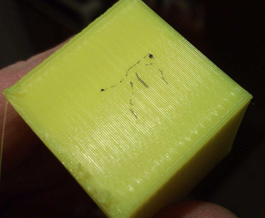

I'm interested in how the resin printed parts will hold up over time.  It is surprising how the material changes : It comes out of the vat quite soft and sticky. After a half-hour or so exposed to a few watts of violet/blue light (405nm not really Ultraviolet) it hardens and dries. It can be filed , sanded, drilled, tapped easily.
After a few days , in normal light , it is noticeably harder and , in the case of white resin, changes colour from a ivory to a brilliant white (the hard resin is very fluorescent so I suspect the colour is the result of the final stages of polymerisation ). It also becomes noticeably more brittle, less flexible.

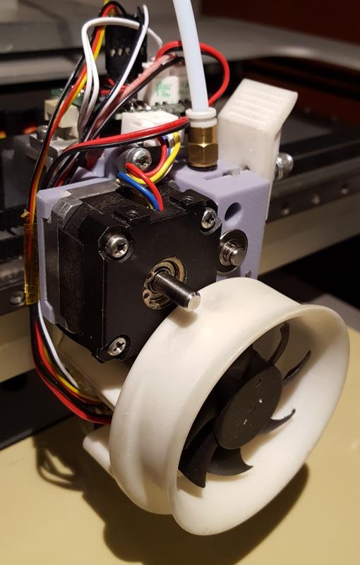

I've got the extruder mounted and wired. Heater block and fan are working , but the motor is not being driven (it's wired ok so must be a config issue).
I managed to squirt some filament by hand
My Z axis home switch mount and cam prints failed  ( almost certainly) because of the low temperature as the resin gets very viscous below about 20'C. I'll have to revisit my cupboard heater tomorrow to get them printed.
  • Posts: 1179
« Reply #13 on: November 07, 2021, 11:17:37 AM »
Fixed the extruder motor problem : it seems that by default the forth motor is used as a second Z axis , so a simple matter of shifting the driver and plugs along to the next slot .
The Tadpole extruder seems to work well  motor runs cool at 300mA .

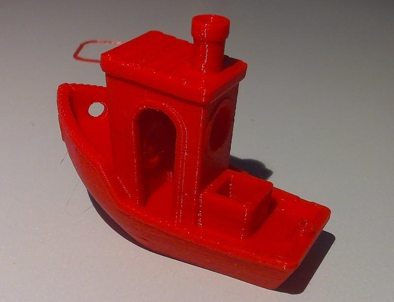

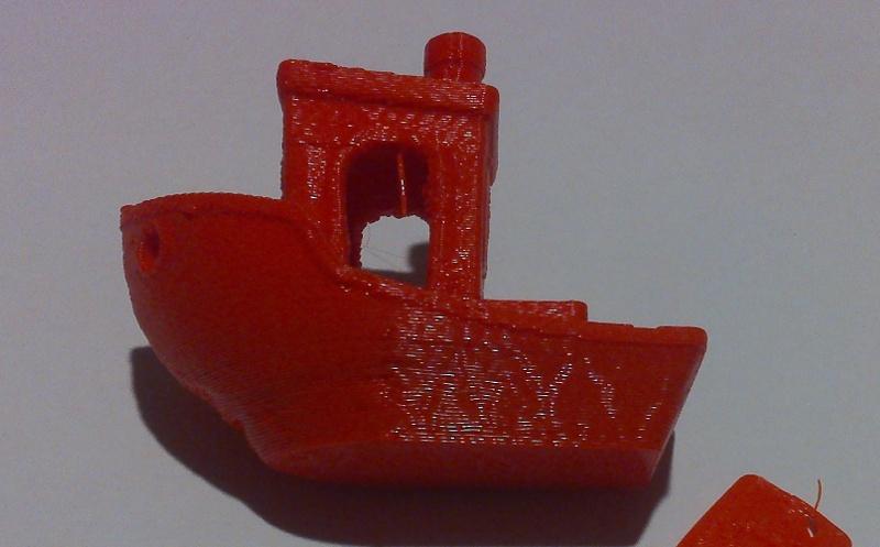

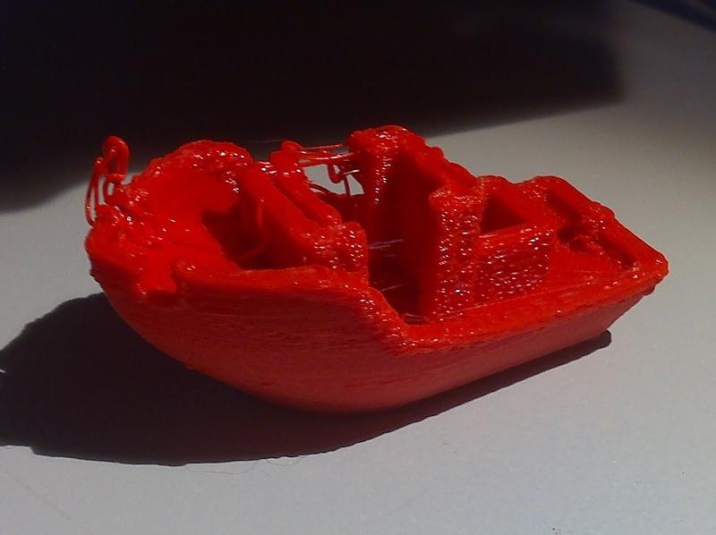

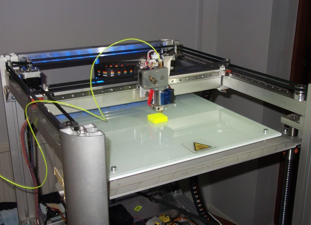

well, we have a print ... of sorts

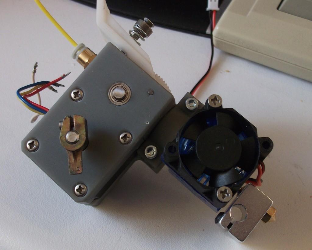

I'm beginning to think the Tadpole may have been an extruder too far...
It seems to work fine then randomly miss steps as if something was jamming inside.  I kept upping the motor current to compensate until it overheated and seized (plastic warping in the heat)
Print quality is OK though (without cooling fan ATM)
Not sure what to do now: make the tadpole out of aluminium as unoriginally intended or try to find the source of the random jams.

« Reply #15 on: November 11, 2021, 07:08:39 AM »
Noticed you said you had used resin parts. On the Voron printer forum they advise against resin parts, especially if the print chamber is going to be heated. The reason given was that the resin parts are prone to "creep" over time so you begin to see fit and tolerance issues.
Just something to bear in mind if you start having any issues that are not easily identified.

Yes thanks Sean,
The extruder is very much an experiment, it was intended to be made in aluminium.
I've had experience with resin parts and heat , they do odd things  like cracking apart at modest temperatures , while at the same time being almost immune to the soldering iron!
I might investigate some higher temperature resins.
In the meantime, I have rebuilt the extruder with a number of fixes which should hopefully  stop it jamming .
« Last Edit: November 11, 2021, 11:20:55 AM by BillTodd »

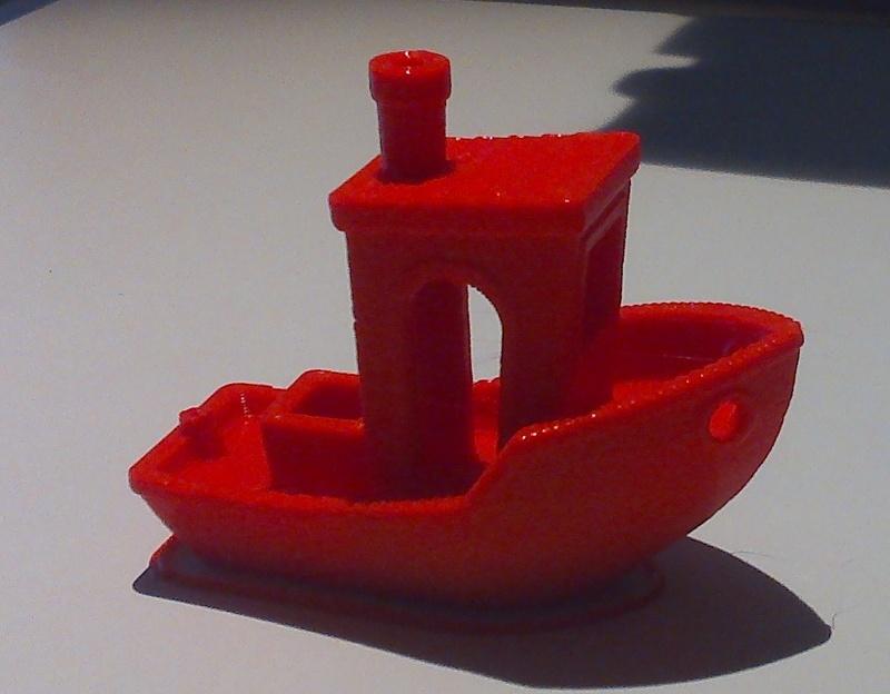

Well I finally have a finish print
Lots of modifications to the tadpole prototype : Better spacing for the gears (it was a little too tight) ,Captive nut instead of threading into the plastic  and machining the bearing and stator fit to reduce the amount of 'fitting' required  etc. etc.
While I was at it I increased the side of the extruder gear bearing so I can get it out without disassembling the motor .
Still no part cooling.
  • Posts: 1179
« Reply #18 on: November 13, 2021, 03:33:18 PM »

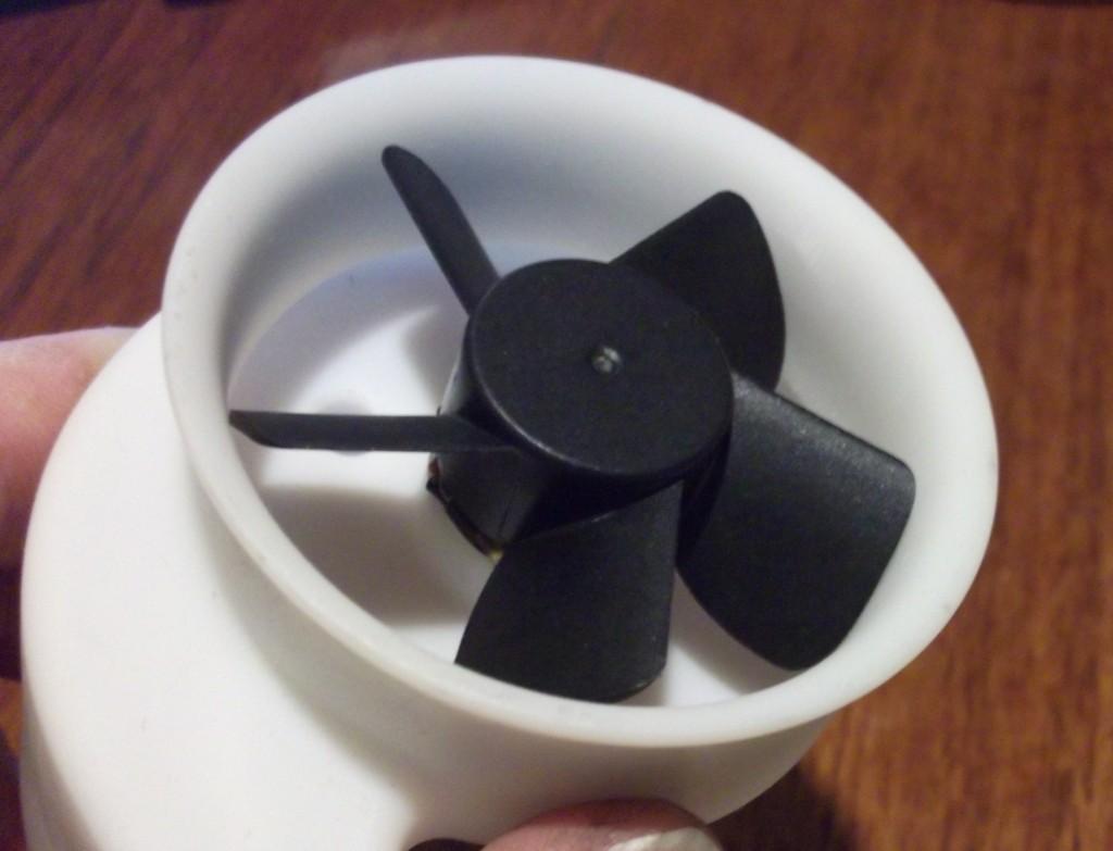

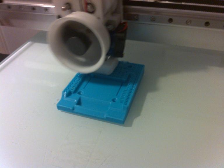

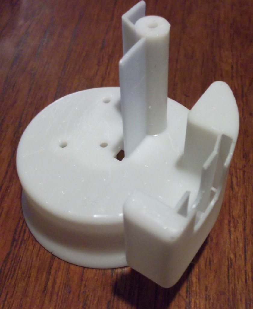

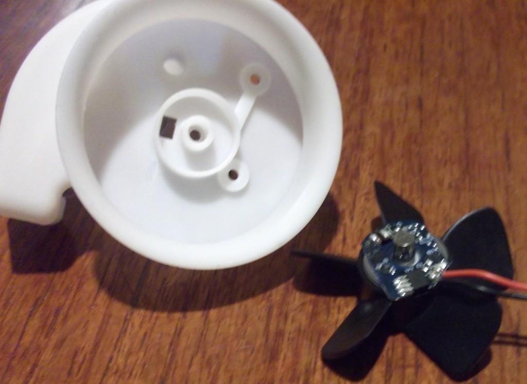

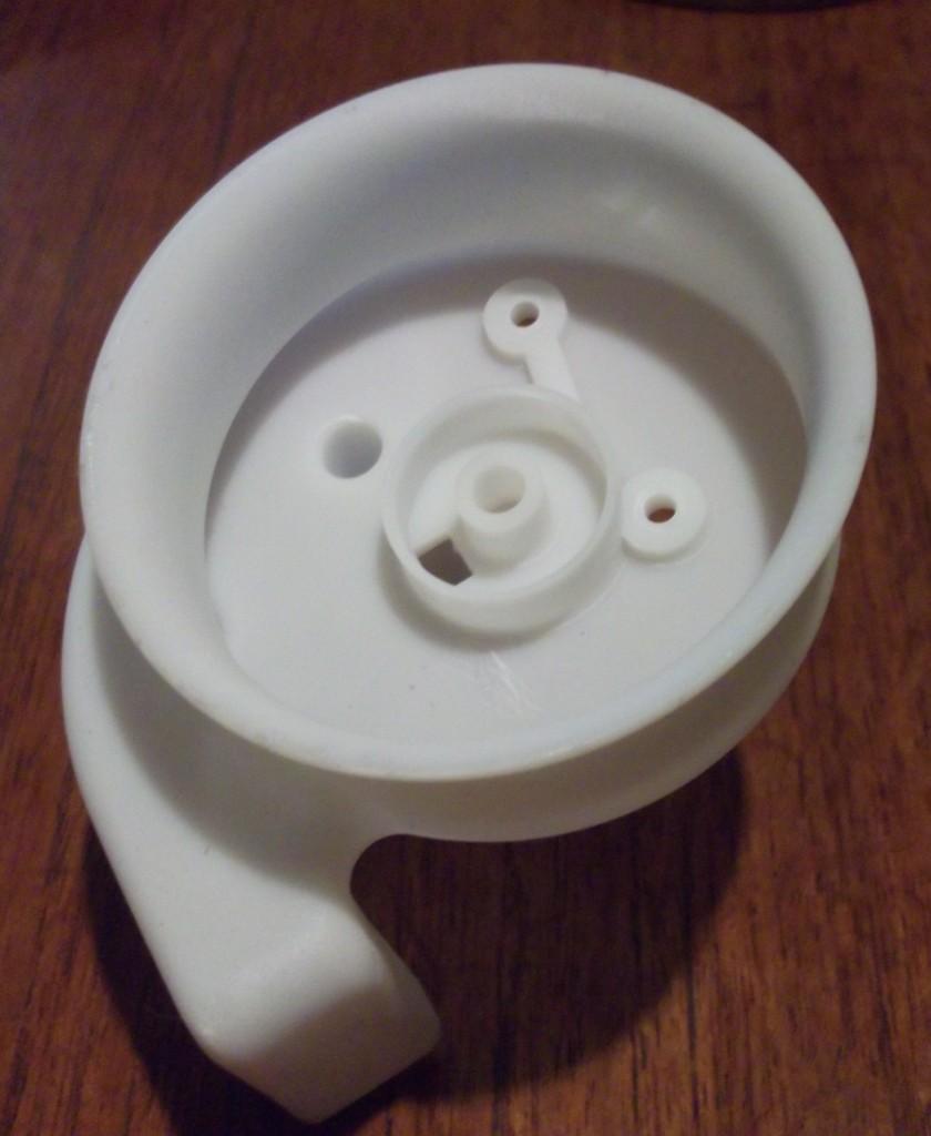

This is what I like about resin printing...
This fan duct would be nearly impossible to make in one piece with any other method.
  • Posts: 1179
« Reply #19 on: November 19, 2021, 04:43:43 PM »

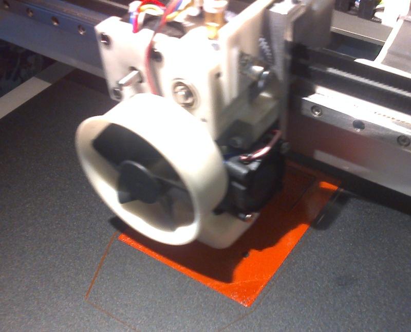

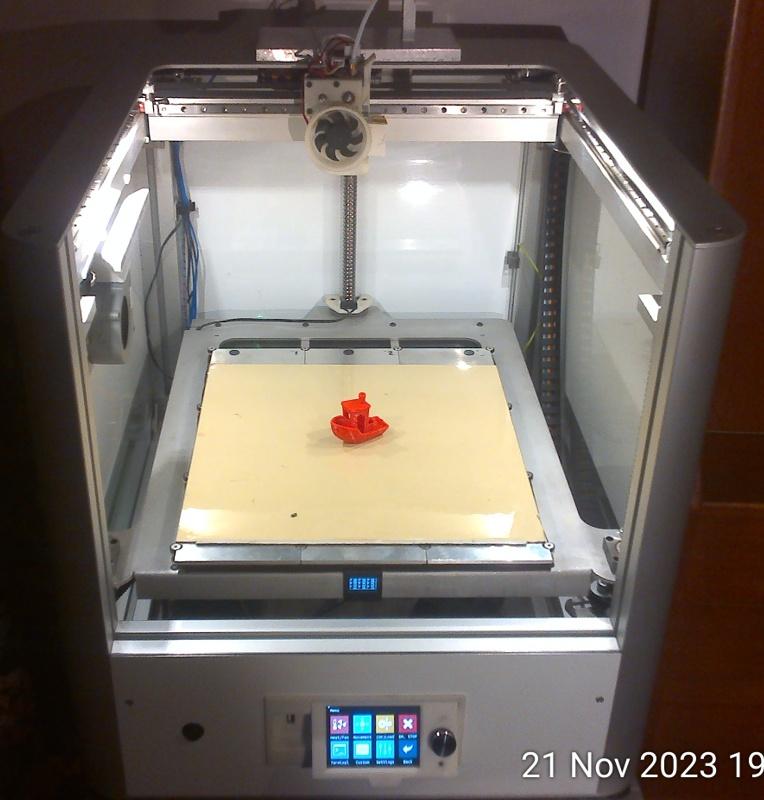

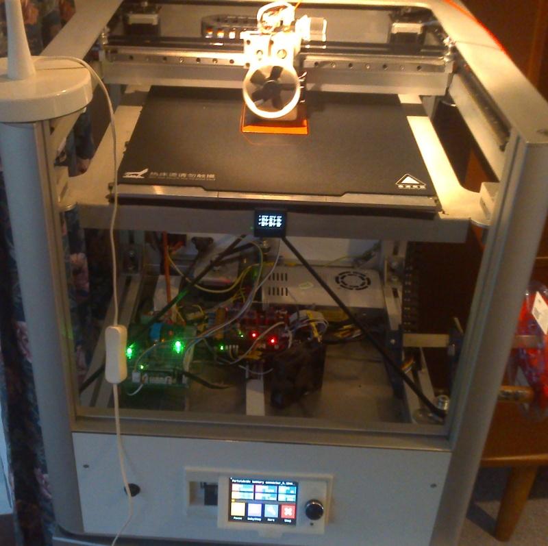

Quick update.
Printer is working. This is its forth print in progress.
The extruder is working well when it works but is still being unreliable at times.
The resonance is fixed (for now) by switching off the tmc stelthchop mode, which is a pity because it's not as quiet now. I've tried to get Marlin's hybrid mode to work but it doesn't seem to want to disable stelthchop ever ???? (Expert advice welcome)
Speed is still being limited by acceleration, again marlin advice welcome!

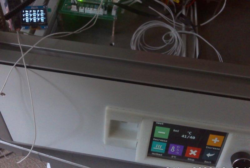

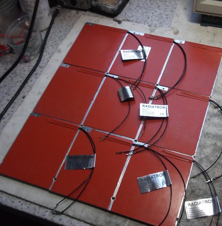

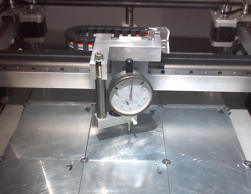

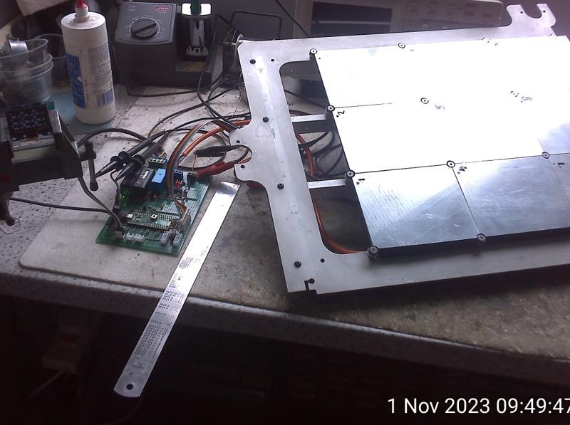

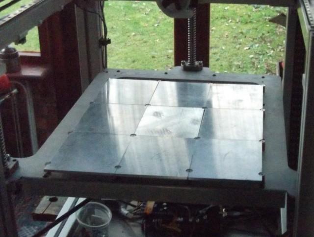

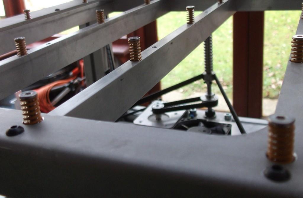

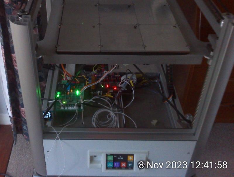

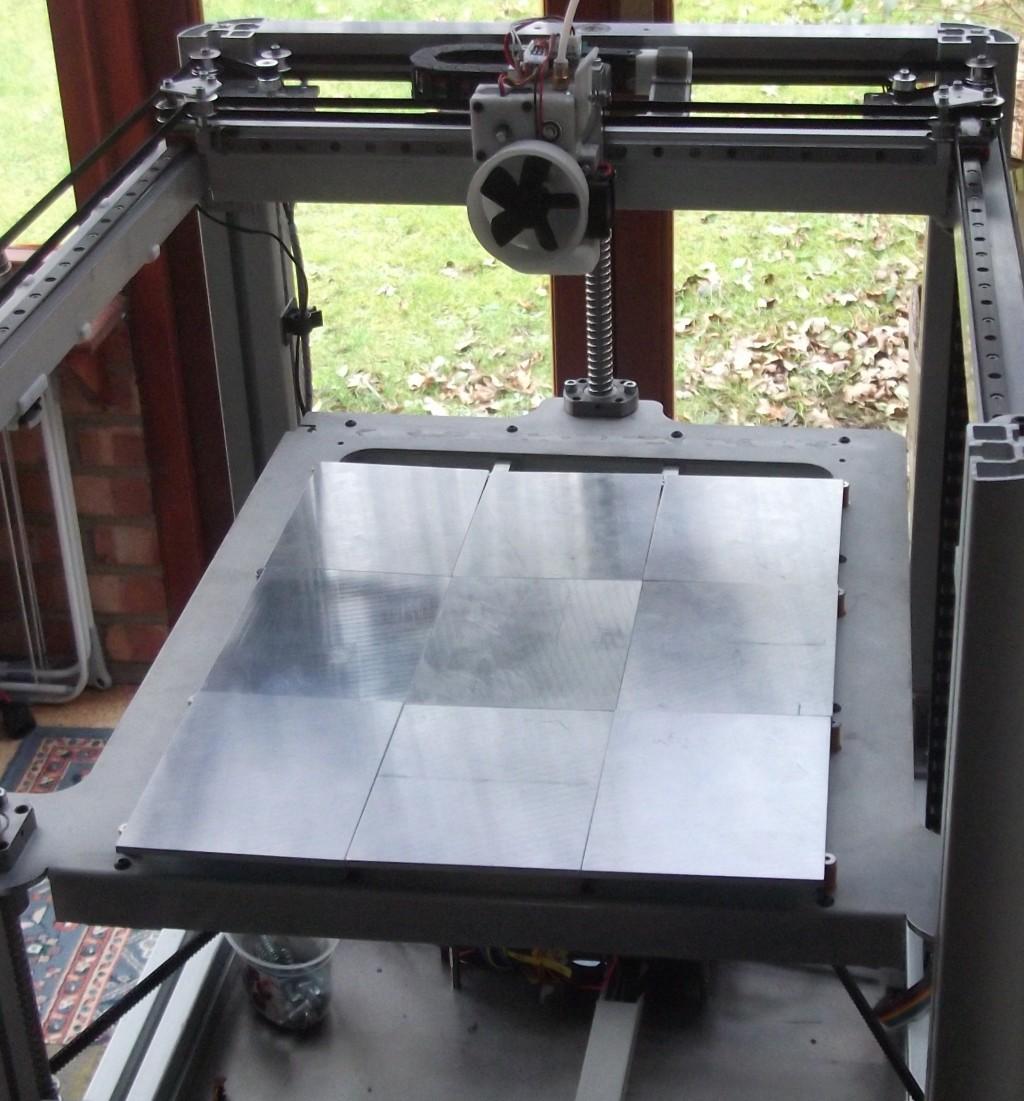

I was not happy with the glass bed , I could not get things to stick to it and it took an age to heat to even 50'C, its 240w heat way too small for such a large piece of glass.
While watching the Prusa XL launch , I was taken by the idea of a segmented bed , so decided to build one for the FrogSpawn. While sourcing a suitable piece of cast tooling plate from the 'works' my friend overheard what I wanted it for and promptly donated ten 120x100 heater pads  - :-) perfect.
The mod involves bending the front of the existing Z plate , to remove a nice little 'finger-shear'  between the plate and the front of the frame. and mounting it below the ball-screw nuts to increase Z range. Four rectangular bars fixed to the underside of the Z-plate and a rear support , stiffen the Z-plate and provide mounting points for the Kastal 300 bed-plates

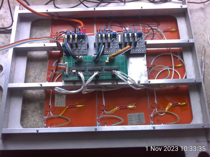

The heated bed-plates will mount on springs at each corner , with screws for adjustment.  Once properly adjusted the bed should stay trammed and level.

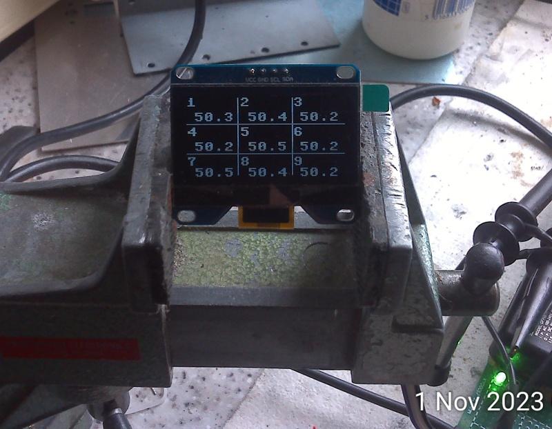

The nine 240vac 120w heaters will be controlled from a RaspberryPi Pico with a 9 way PID written in microPython  .
The problem I have yet to solve is how to control the bed temperature from Marlin or, via g-code, from the BTT display controller.
Ideally, Marlin would be able to talk to the Pico via a spare serial port and report temperatures back to the display. However, I found no way to do this in Marlin :-(
My work around plan , is to intercept or monitor the serial data between the BTT LCD and the BTT Octopus board and intercept the appropriate M-codes .
Interception , means breaking the like between the two boards and inserting the Pico , but now the Pico would have to handle all the traffic and could be a potential bottleneck.
Monitoring means just sniffing the data going to the Octopus board and picking up the bed control M-codes as they pass by. In order to let Marlin know the bed temperature , the centre plate's thermistor would have to be paralleled with both the Pico and the Octopus  . Any thoughts?
Offline WeldingRod
  • Posts: 401
« Reply #21 on: January 23, 2022, 08:49:45 PM »
3 point mounts are your friend on this stuff...  much easier to adjust.
  • Posts: 1179
« Reply #22 on: January 24, 2022, 06:28:47 AM »
Yes, I did look at 3point mounts, but decided that corner mounts were simpler to implement . Hopefully, itll be just the one PITA adjustment session.

« Reply #23 on: March 01, 2022, 08:42:57 AM »
Progress is slow here ATM  -I'm  lacking motivation and easily distracted

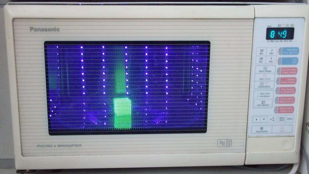

Such as converting a microwave oven to a UV curing device for the resin printer.
And now, the oven's transformer is pulling me towards making a small spot-welder .
And Stefan Gotteswinter's new grinder has me thinking about a surface grinder project
 :proj:

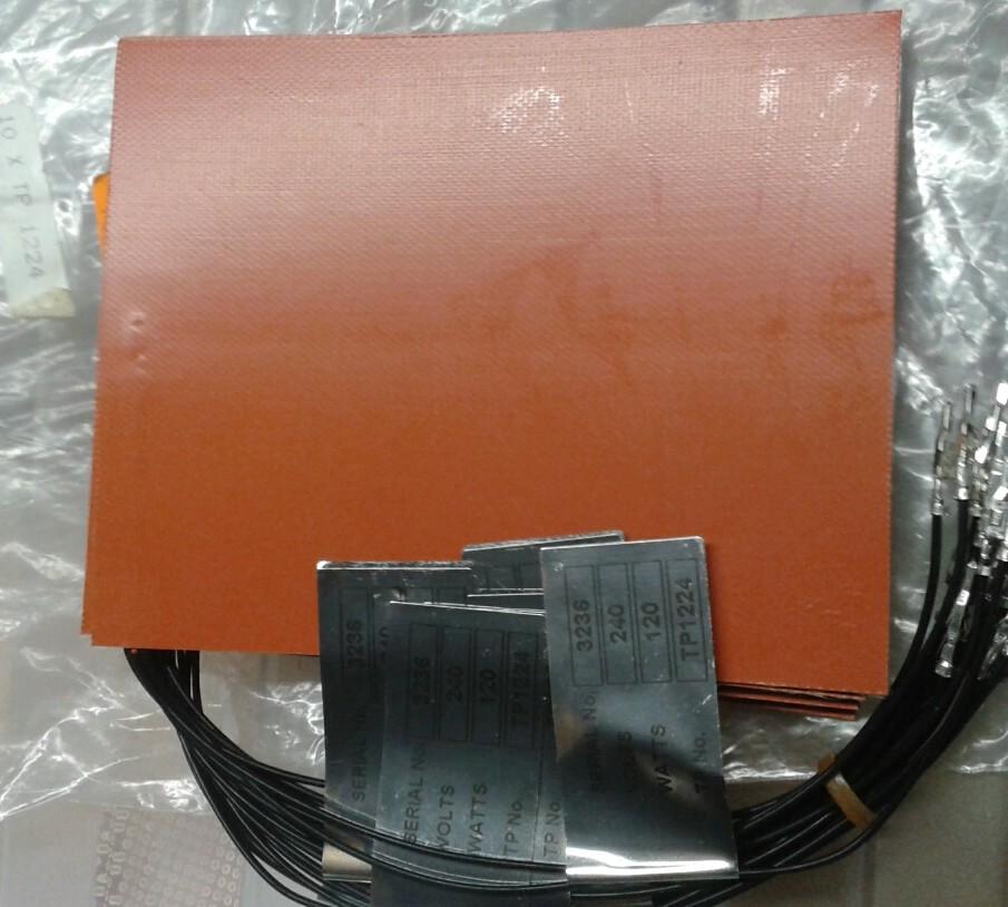

Anyway back to the segmented bed  - which I'm calling the Lillipad ( just to maintain the aquatic theme :-))
I've got the bed plates mounted and, as predicted above, levelling is a PITA but do-able.
I've bonded the nine heater pads to the plates and (since the photo) connected earth leads an thermistors to each.
All I have to do is complete the software to control it  - ( zero motivation )
Wire it  - (majorly conflicted as to where to put the controller   -i.e. put the SSRs on the Z plate to  reduce the number of wires  or drop a multicore cable down to a nice, and easily constructed, box on the base plate ?  - I'm almost certainly over thinking it.

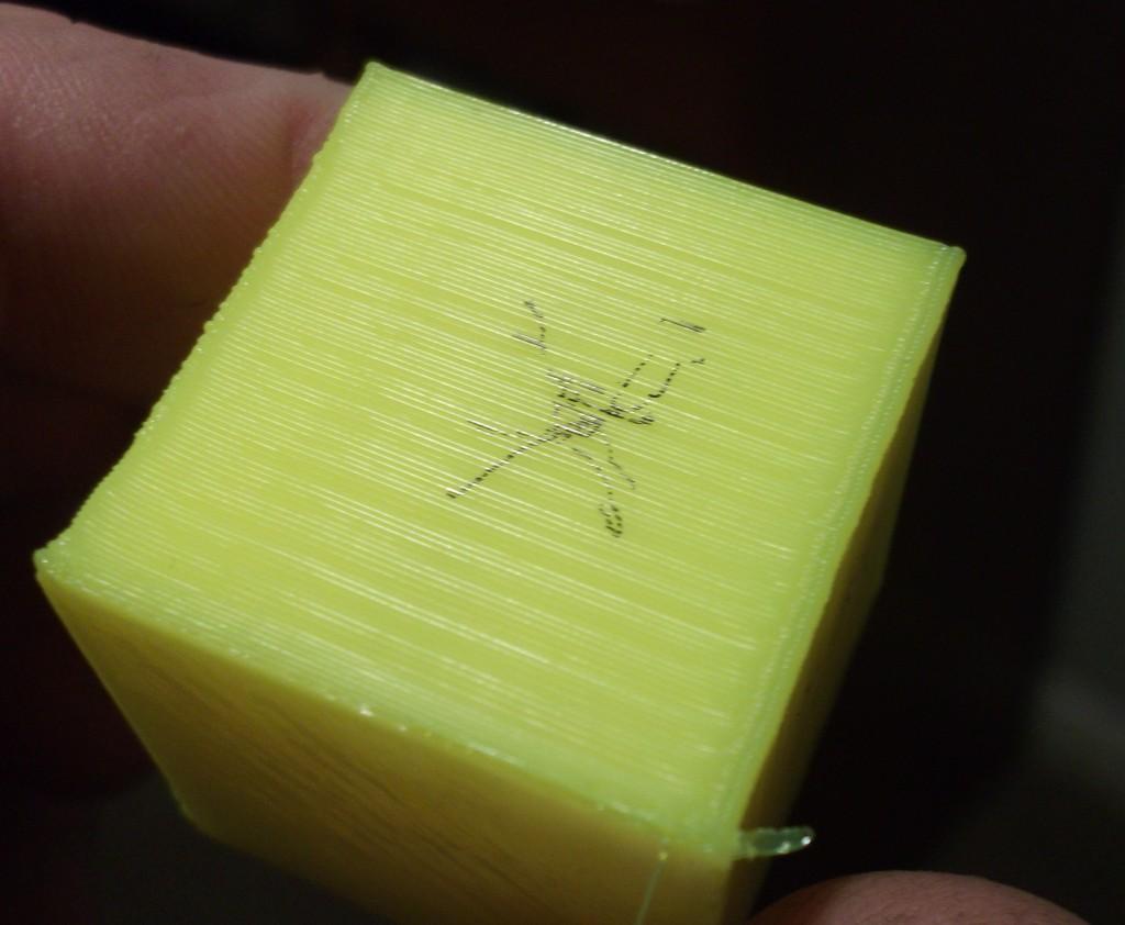

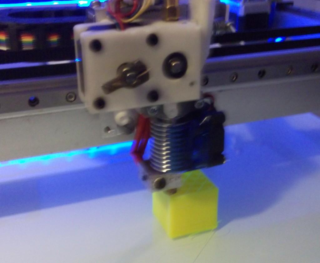

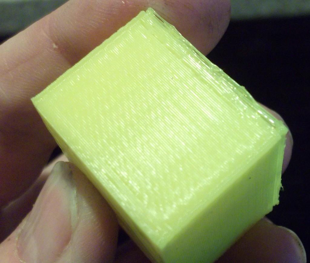

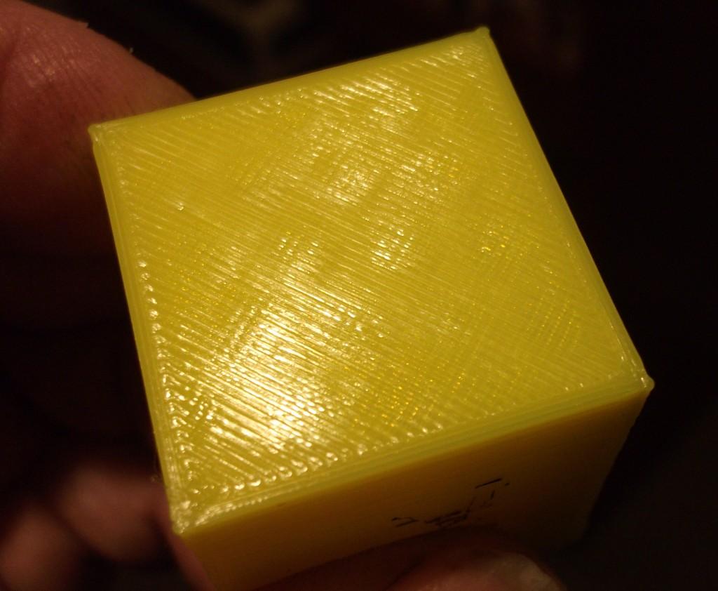

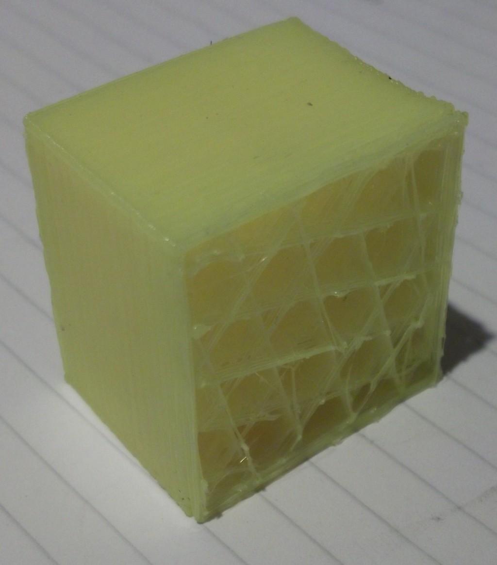

Microwave oven curing station:
The cube in the centre is the yellow  PLA one printed above  - it fluoresces intensely in the 405nm blue light

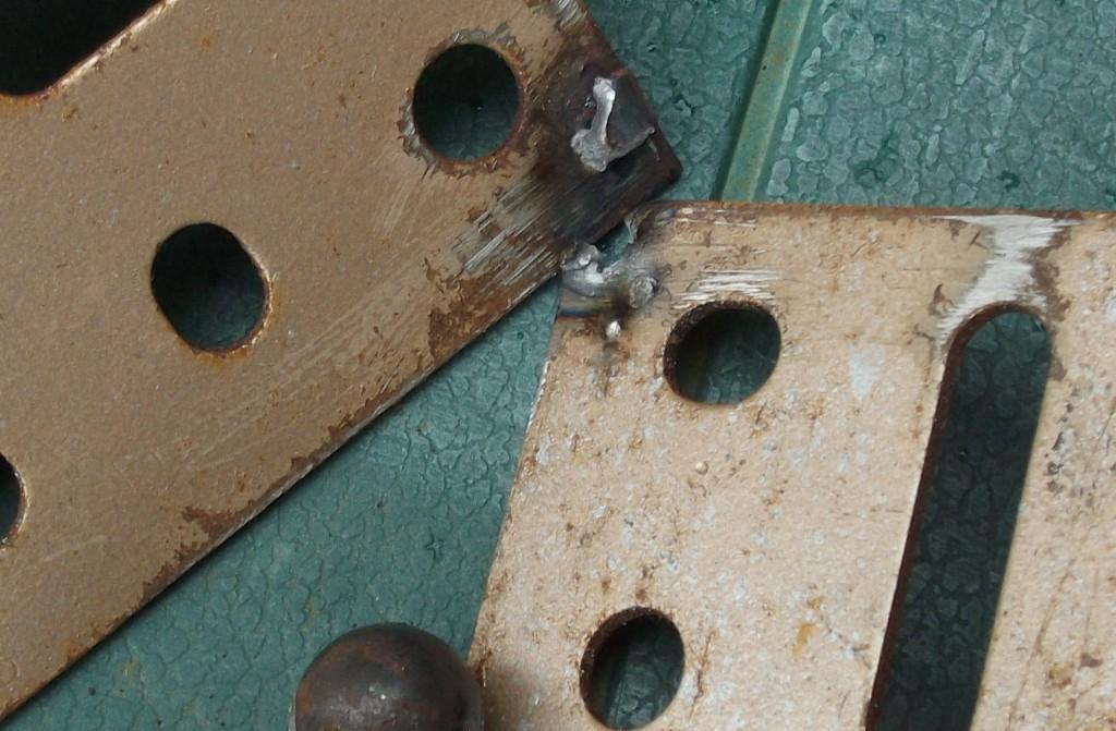

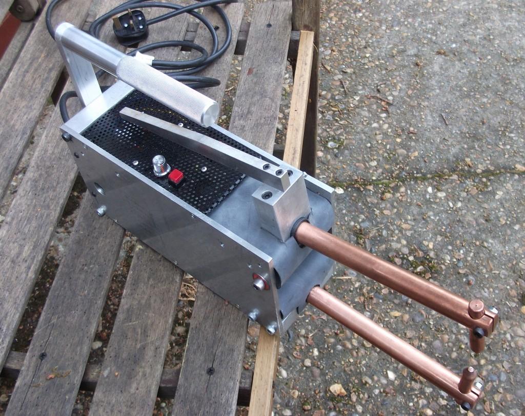

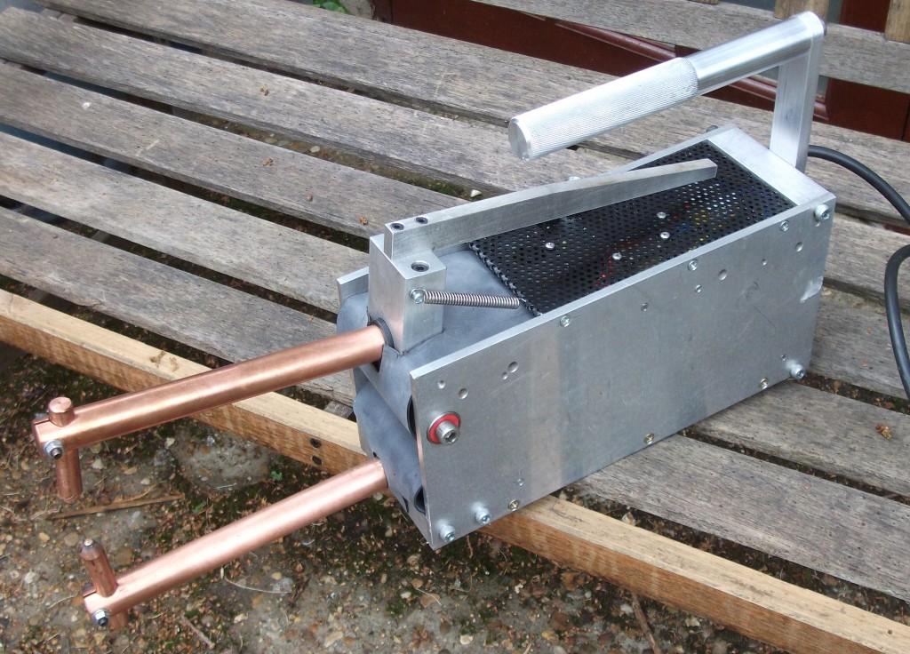

Distraction 2:

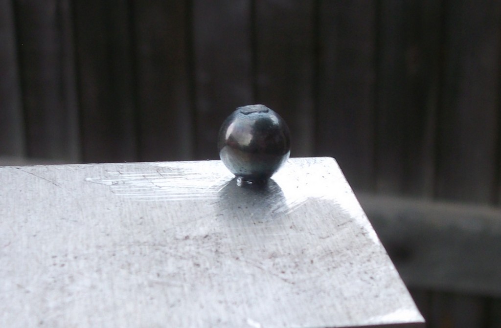

microwave oven transformer based spot welder  -
works better than expected :-)   - happily welds 2x 2mm dexion angles, 15mm ball to steel and , most surprisingly , a steel ball to an aluminium plate

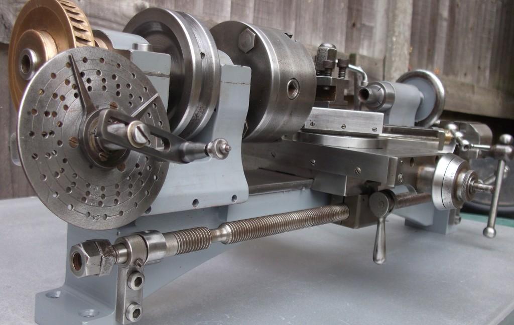

Distraction 3:

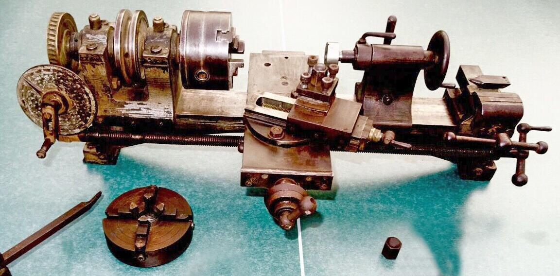

One day I will get back to this project.....
Unknown 164  http://www.lathes.co.uk/unknown164/  a rusty shop made lathe with a intriguing vice , acquired and cleaned.
« Last Edit: October 16, 2022, 05:28:25 AM by BillTodd »
« Reply #29 on: October 15, 2022, 04:47:09 PM »
That’s looking a whole lot more wholesome Bill  :thumbup:

It's a real enigma, it is well made but not well finished. Everything that needs to be good is good, but it's like they didn't have the time to add the finishing touches.
The tail stock lock clamp for instance: it is a neat design clamping rather than squeezing a casting, but i had the draw file and polish it to make it look nice.
The little vice's anvil is beautifully carved from the main body,  But they didn't remove the shaper marks before hardening.
If it weren't for the allen screws I would think this is 'war finish '  - the cross slide appears to be a hardinge cataract pre 1920 (or perhaps a copy).
I have a few bits to make for it like new clamp bolts for the topslide and a new cross-slide handle.
And  I have been wondering about a mechanical variable speed drive as well

Wow two nice projects! I hadn't seen the spot welder earlier. I have a Harbor Freight type that looks so similar, but obviously not built from scratch, and probably not as high quality for it.
The lathe is really intriguing. I really like the pleasing base shapes of the tailstock and headstock, which re-finishing has brought out. I wonder what the waisted section of the leadscrew is for? I guess it's a carriage release, but is there a reason for the thread continuation after the break?
The vise/anvil is totally unique and gives it great character, but I'd really hesitate to hammer or bend metal on a lathe ways. On the other hand, it's a wonderful unexpected gadget, and really sets this lathe apart so as a complete homemade object it's very cool.  :thumbup: :clap: :beer:

The waist on the leadscrew was for belt clearance, the previous owner had it mounted on an old sewing machine treadle base .
Unfortunately I don't know much about the lathe's history. I know the previous owner got it from Davall's (who made flight data recorders ) when he left the firm . He had several patents in his name related to wire handling mechanisms , but I don't think he had anything to do with the lathe's initial construction.I thought it might be an apprentice project, but it seems to have had too much use to be a long term project (and again one would expect apprentices to finish parts).  So, perhaps best guess would be a special project for in-house work when availablity of small lathes was tight.

I've built the main control board with a  pi pico and relays to switch the main 24v and 240vac heater power, monitor the power button, mains fail and printer shutdown . A bank of supercaps will store enough energy to park the axes and write position to the SD card.
The pico will monitor the gcode data passing from the front panel lcd to the octopus printer board and extract gcodes for bed temperature setting .
More to follow when my brain recovers a bit.

« Reply #41 on: November 01, 2023, 05:56:50 AM »
My aim is to get the printer running again in November.
I now have the bed debugged and the 9 way pid controller working
The solid state relays are mounted on the underside of the bed. Three max335 spi controlled switches multiplex the thermistors back to the Pico ADC and switch the SSRs.
« Last Edit: November 01, 2023, 06:38:06 AM by BillTodd »

Not a big update but at least posting here helps to keep me focused...
Pico is now telling Marlin the bed temperature by faking a thermistor (using a PWM pin ) and reading the target temperature from the status report. The LCD asks for an update every second or so,  Marlin responds with temperature and targets  . The pico sniffs  the rx and tx lines and parses the data to Extract the bed temperature.
Still work to do. The solid state relay that was supposed to power on the main 24v smpsu went pop immediately, too much surge current.  The fake thermistor needs better filtering .
Overnight thought... The fake thermistor is faking the wrong type of thermistor . I remembered that the leadfrog bed uses a different thermistor. On close inspection, the SSR didn't pop , I had wired the PSU to the heater out relay so what I thought was a pop was just the relay momentarily engaging as the power was cycled. Long story short, it's working fine.
« Last Edit: November 07, 2023, 04:17:36 AM by BillTodd »

Bed now controlled from Marlin on the printer

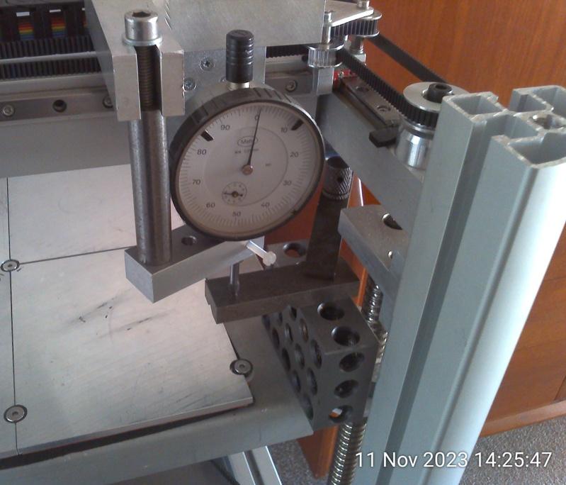

The bed control software is working well , I've a couple of incidental hardware issues to fix .
Today i decided to align the bed : first the rails were trammed using a inclinometer  (aka gunners quadrant) - these super accurate adjustable levels , it can easily detect a piece of paper (3 thou") inserted under one end of the bar shown , I'm confident I got the two rails planar to better than 50um.
Tramming the bed-frame was a fiddle , I could level the two front ball-screws using the toolhead mounted DTI , I had to use the Inclinometer for the rear one.
leveling the bed segments was (as mentioned above) a right PITA .  I had to trim the tabs of a couple of panels to get them to sit flat with the meeting panels before I could adjust it. Once all the panels were close to zero , so there was a little less interaction between the adjusters ,it was possible to get it flat to better than +/-50um .
If I were to do this again , I'd make the plate from a single sheet and just cut thermal relief slots between segments.
  • Posts: 1179
« Reply #45 on: November 13, 2023, 01:00:11 PM »
This is going well... (probably should not have said that)
I had to rewire the mains connector because the wires were an inch too short. Interestingly the  'as used in the school from where I bought it' , wiring  was arse-about-face !    :zap:
  I'd had a couple of minor buzzes from the thing while it was switched off and was a little puzzled as to why. The live and neutral was swapped on the IEC connector so that the switch was in the neutral side !

After a fight with Marlin's config and a string of adhesion issues , I have almost managed to print something  :D
A typical  Benchy
The bottom third looks ok-ish Then , after adjusting the cooling , the hot-end faulted with a 'runaway' error (the original cooling fan broke so i was running a bodged up thing )
It resumed the print but reset the 100% flow until I noticed. Unfortunately, I tweaked the speed down to 95% instead of the flow and scratched my head until I noticed  . By then it was a complete mess so I wound the speed up to 200% ...
and spat it off the bed .

« Reply #48 on: November 16, 2023, 06:01:04 PM »
I have a benchy, it's crap  - no cooling - but it was started from cold without intervention and it completed  .

With cooling (I just glued in a new fan to the old duct) , the benchy is a lot more wholesome . Still some shrinkage at the bow and overhangs are poor (needs more cooling )  . There's a bit of stringing - temperature?. Maybe a bit of under extrusion too (might be cooling , it is worse at the back side of the extruder) .   Corners are a bit bulgy I may have to pick your brains about pressure advance etc.  If you squint, you can just about make out something, something, benchy on the stern . base shows a little bit of curling, but the painted surface is not great for adhesion.

I've seen worse prints that people were REALLY proud of.  As in thinking this is a high quality print when it had a terrible finish.  What material are you printing, and what's your layer thickness?

I may be premature but, this is as done as I can get it, until the touch sensor arrives.

 I left it at the end of the last year working OK ,but, when I returned to the other day my resin printed stepper motor end-plates had distorted and jammed due to creep.
So, as a quick fix ,I redesigned it to use the stepper motor with its metal end-plates. After several failures, involving temperature resin selection and weak supports,  i finally have it vack together
Next is to design a new extruder with a different (lighter) motor with a mechanism to allow the hot-end / filament guide to be swapped out (with the long-term aim to have a tool changer)

I made some frog-legs (a stand for the printer) and modified the Lilly-Pad controller.
By adding M117 Ext:{first_layer_print_min[0]},{first_layer_print_min[1]},{first_layer_print_max[0]},{first_layer_print_max[1]}  to the custom gcode in Prusa slicer , I can automatically select which heaters to use on the segmented bed

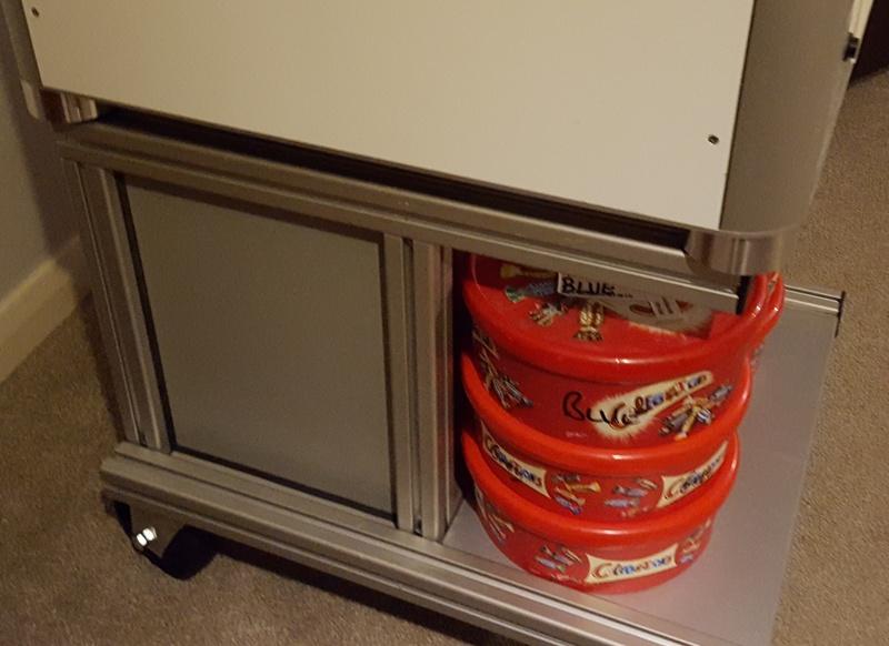

Just to finish up this year's printer mods...

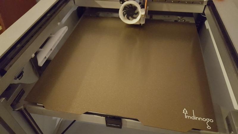

I bought a cheap spring steel textured printer plate for a prusa xl , which conveniently fits without cutting. I can't use all the prints space but it'll do nicely.
I added a plastic separator between the electronics and the cabinet to tidy up the wiring.
Extended the box on the stand so it would be large enough for my sweety collection ( the boxes make ideal spool containers).
