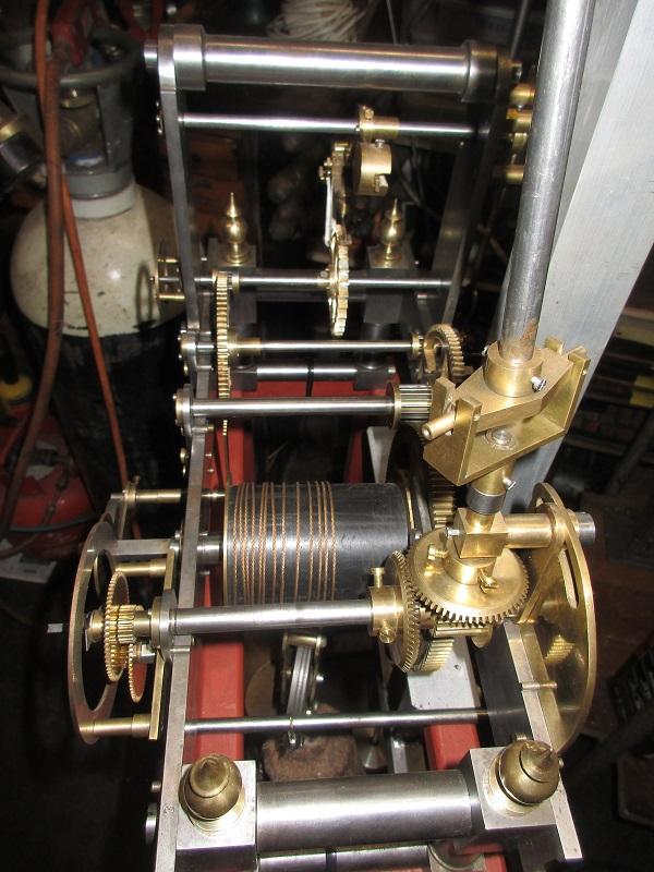

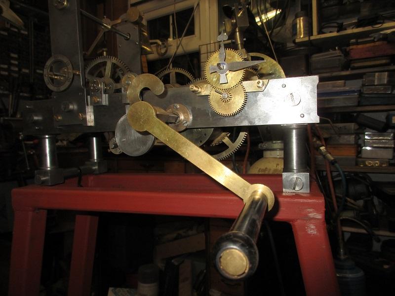

Some years ago I started to build a turret clock as described  by J Wilding in one of his books .
This was interrupted by a house move and all manor of other things . So I thought it was about time that I finished it .
The work still be done was to make the pendulum and suspension and the right angle drive and motion work for the remote clock .
The clock is fairly small being about 16 inches by 8 inches and would drive a clock of 2 feet in diameter.

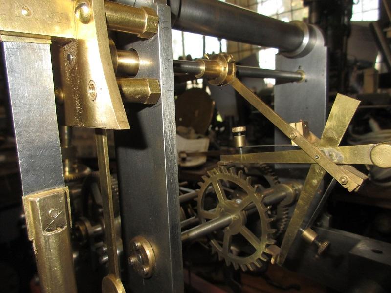

The clock is of straight forward construction using a combination of pinions on the as the driving gears and lantern pinions as the driven gears
I have fitted a Grasshopper escarpment
The maintaining work is by bolt and shutter

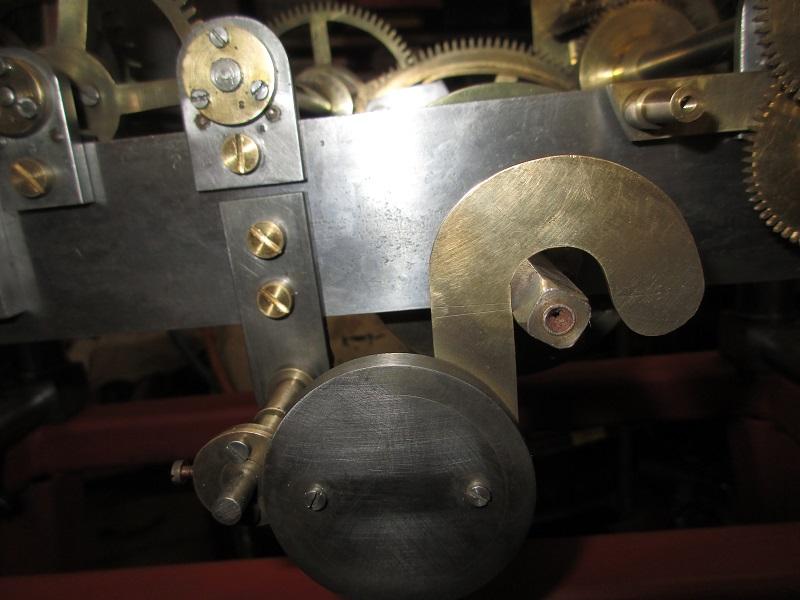

To place the winding handle on the winding shaft you first have to lift a interlock which has a small weight on it to drive the clock while power is removed due to the winding the main weight up
As the interlock is moved a short section of gear engages with the intermediate and provides power to the going train
This is enough to drive the clock for about 1 minuet

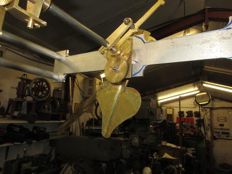

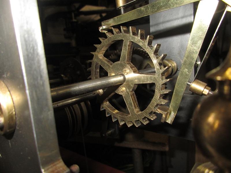

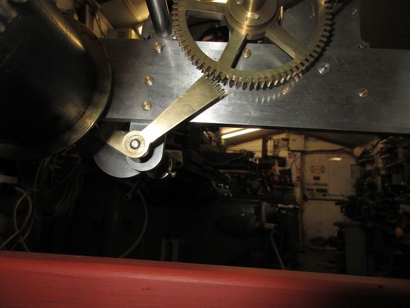

The Grasshopper escarpment

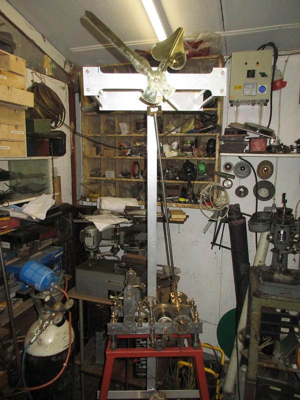

« Reply #3 on: April 12, 2020, 05:14:17 PM »

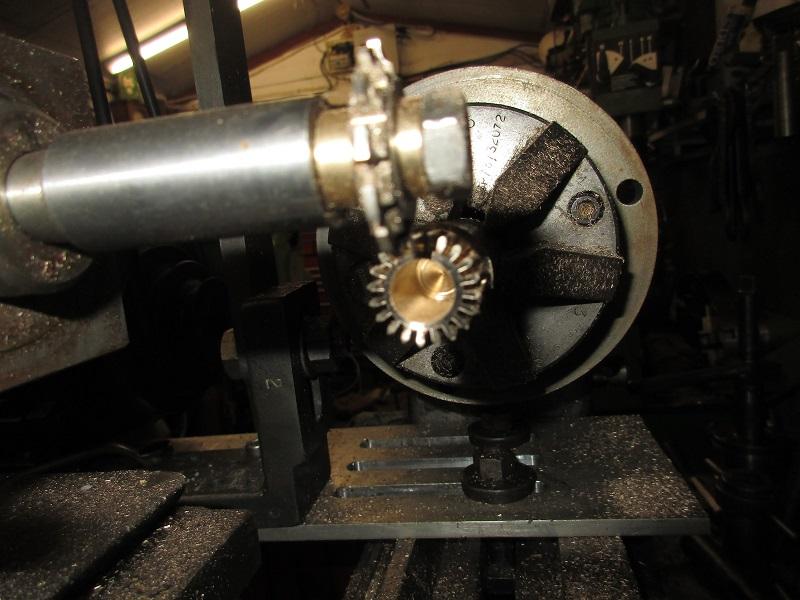

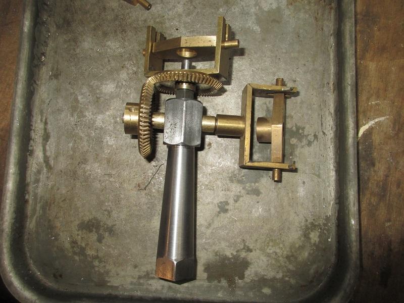

The main work still to do is the gear drive and motion work for the remote dial .
 In most cases the main clock face would not be visible from the clock so there is a small clock face on the movement that is set the same as the main clock.
 This has a square drive on the input shaft which so can be turned to set both the small clock and main clock at the same time'
So there is no need to climb up to the main clock to set the time'
The drive  leaves the clock via adjustable bevel gears and a universal joint to another set of bevel gears which in turn drive the main clock .
I have made most of the clock parts and started cutting the motion work pinions and associated parts
 I cut what I can with a piecing saw a file to shape
                                                                         Mike

« Reply #4 on: April 15, 2020, 05:41:03 PM »

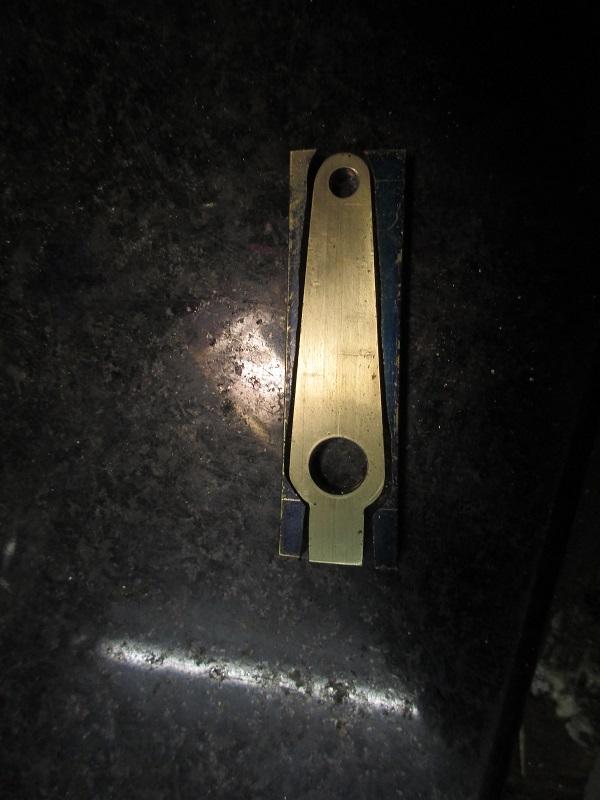

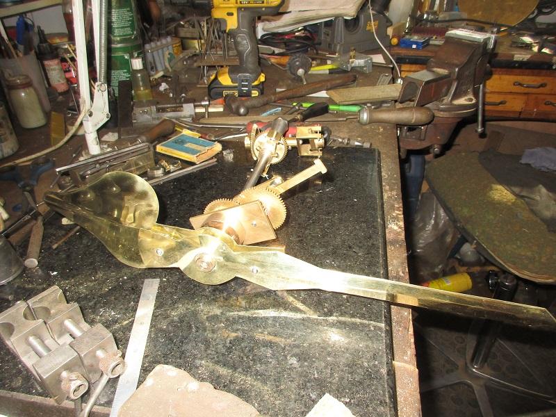

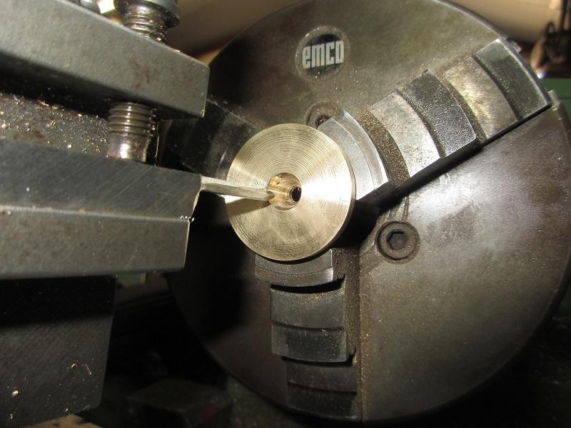

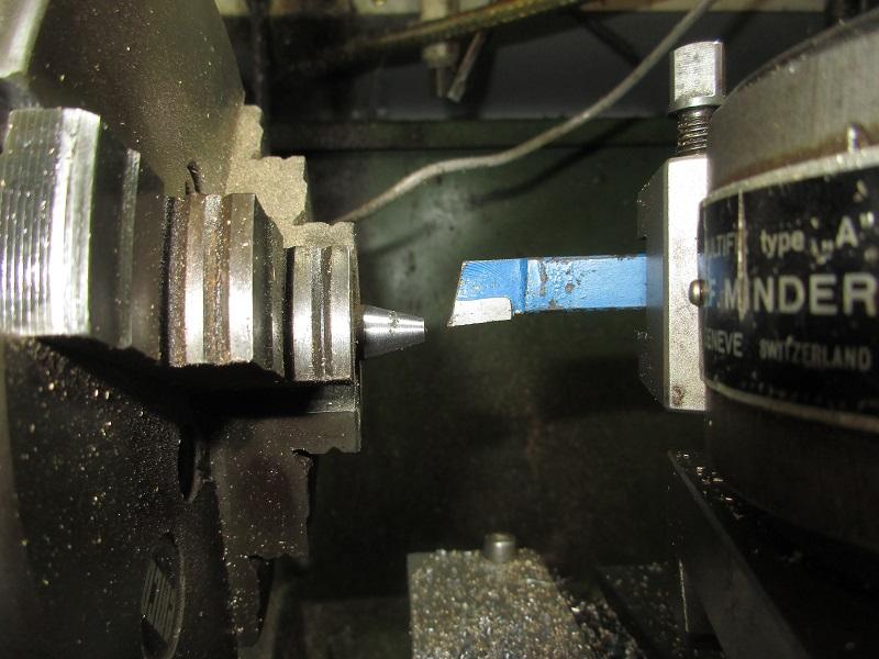

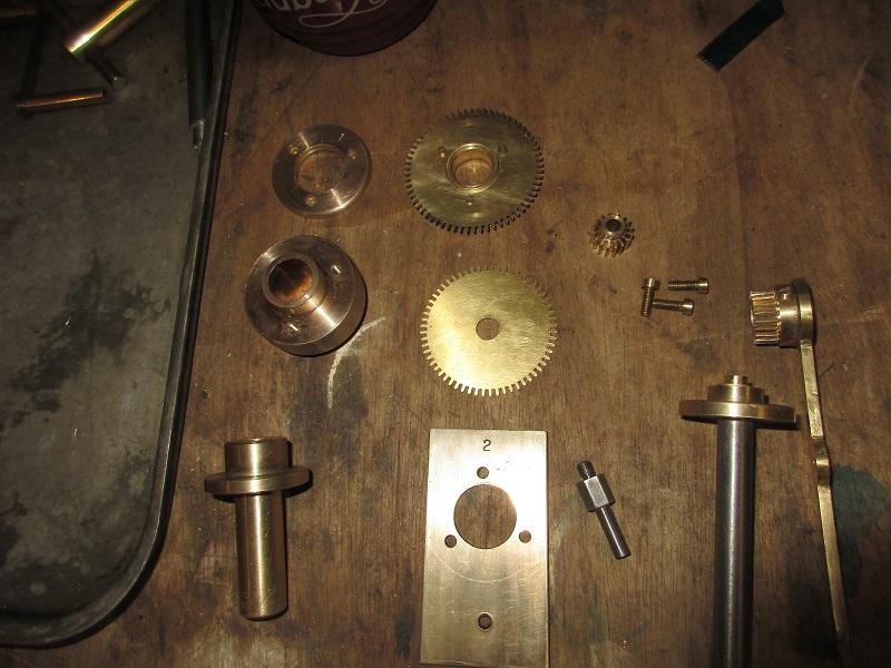

Made some progress with the motion work for the main clock face .Except for the hands most of the machining work is now done.
All the small parts are very time consuming as except for the turned parts I cut and file by hand all the other parts .
The end of the minuet shaft has a 30 degree inclusive taper turned on it on to which the minuet hand flange is fitted
To save a lot of faffing about resetting the top slide for each part I bore the hole in the flange then to turn the shaft place the turning tool upside down and running the lathe in the same direction but with the tool behind the centre line .
This gives perfectly matching tapers  .
                                                   Mike

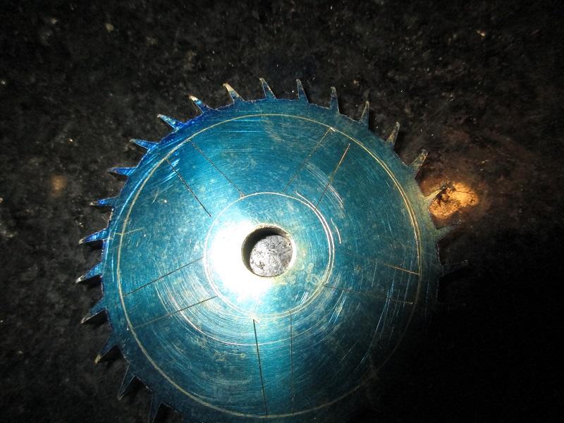

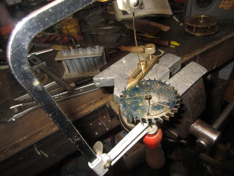

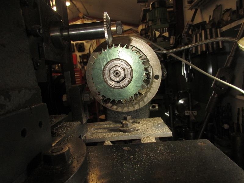

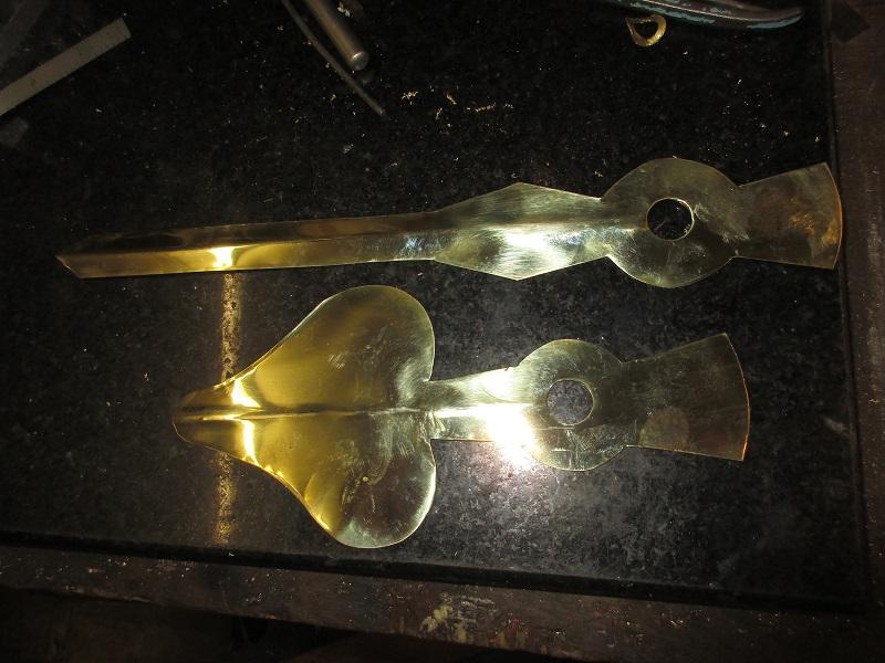

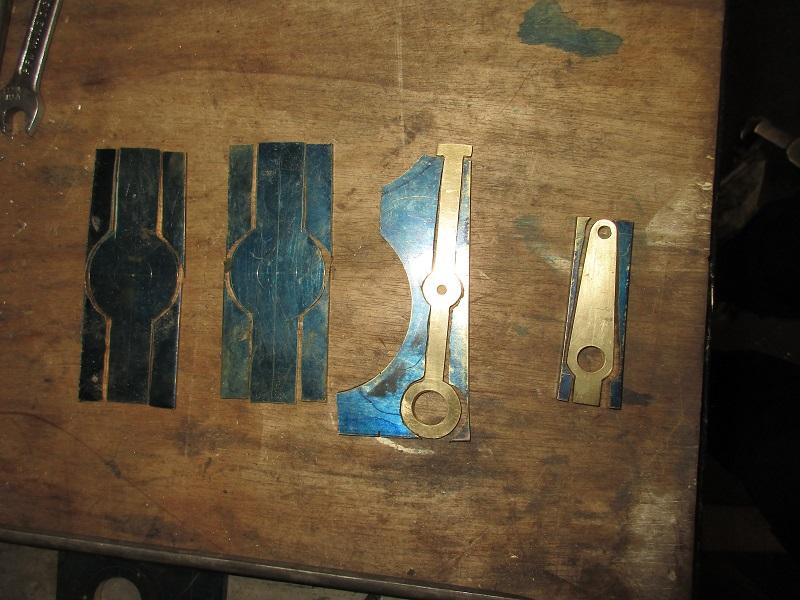

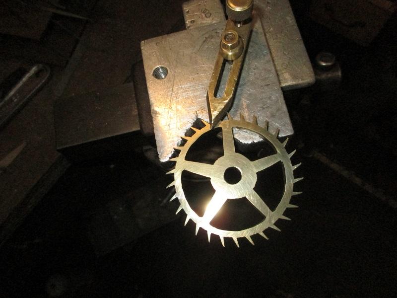

I was not happy with the escapement wheel so cut a new one and increased the the under cut from 10 to 15 degrees to make the lower pallet sit better onto the tooth
I do all the crossing out with a piercing saw and finish with a file which is very time consuming . I could do with a filing machine .
If I ever run out of projects I might make one but I do find hand filing very therapeutic.

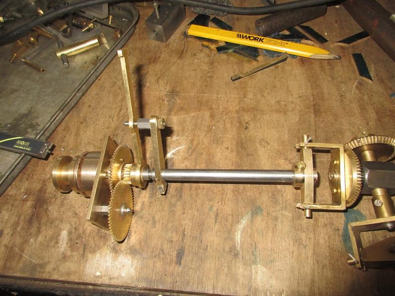

I have also cut the main hands and finished the motion work . Just need to make a dial .
The clock is nearly finished and then I will have too find somewhere to put it ,maybe another shed as the house is full.
Offline smiffy
  • Posts: 174
Re: Turret clock
« Reply #7 on: April 19, 2020, 06:00:57 PM »
The motion work and drive gear is all in place . Tomorrow I will take some different pictures of the complete clock as the ones I took tonight did not come out too well .

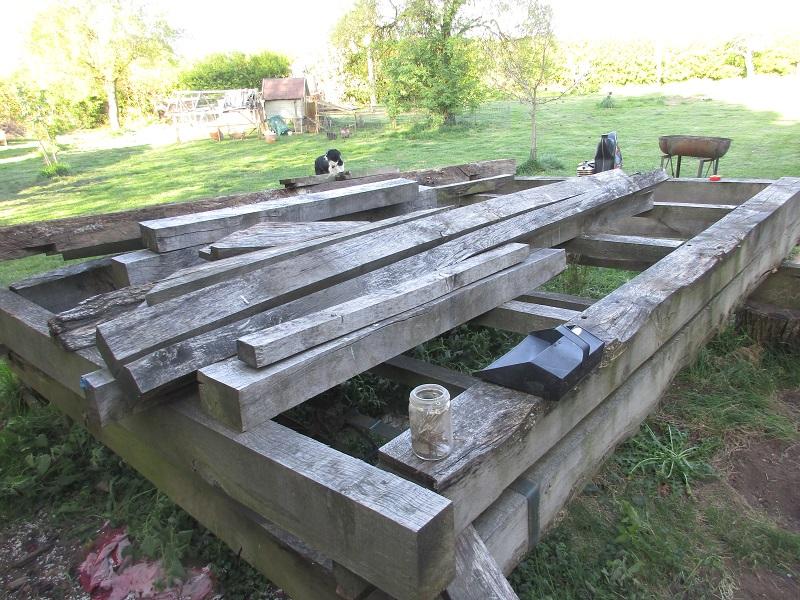

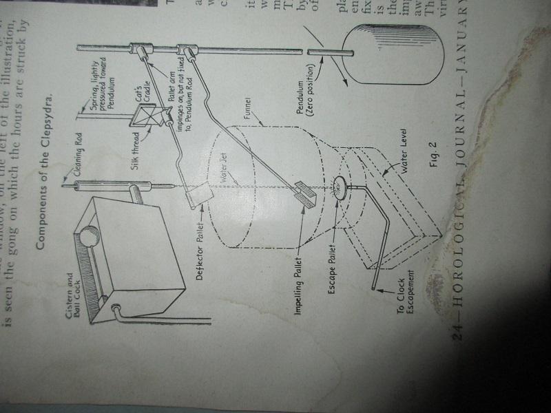

Some years ago I obtained some oak to build a tower for a Clepsydra    https://madmodder.net/index.php/topic,11522.0.html
This is still an ongoing project .I did most of the frame but it has sat around waiting for me to pull my finger out.
The frame will be 8 feet square and 12 feet to the eaves and about 16 feet to the ridge
The main upright are 8 inch sq all the joints are mortise and tenon and held with oak pegs . The frame is 90 % finished .
The oak is not the best but it was cheap
I need to pour some concrete footings but due to the current situation the quarry where I usually buy ballast is closed as are most of our builders merchants.
I also have a full size turret clock which I originally intended to put in the tower so i might end up with 2 clocks

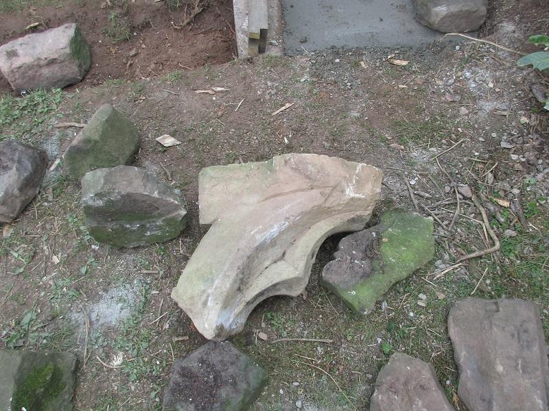

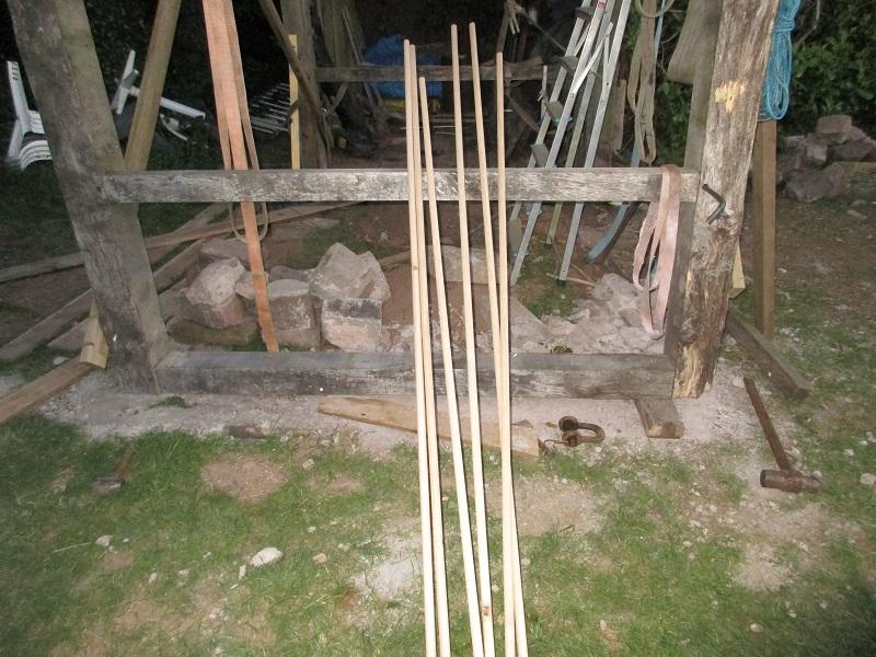

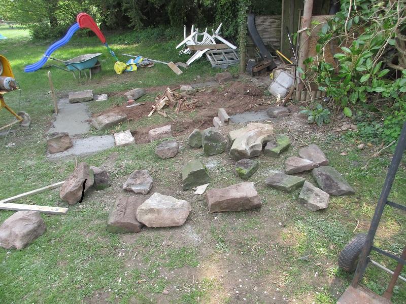

The local quarry is open again so collected 2tons of ballast and dug out and made 4 small footing for the clock tower.
Started to get the frame ready .I started this about 4 years ago and due to many other project it has sat around..
I have quite a lot of stone so I will try and build a small wall at the base of the tower .Some of the stone is carved and looks like part of a window frame

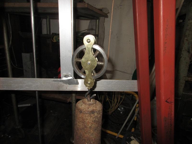

I was given a length of bronze line so fitted it to the clock and made a pulley from a old cast iron handle from a water valve and a bit of scrap brass

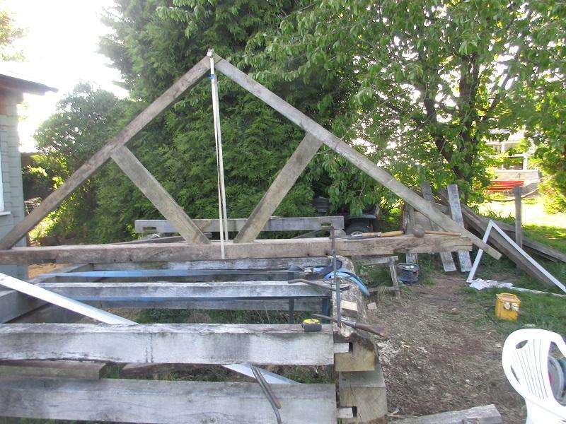

I have made one of the roof trusses today
All the wood that I have used to build the main frame was rejected  by the saw mill and I brought it as fire wood ,some of the quality  is not good but it is fine for this job . Tomorrow I hope to get the main frame up .but will need to find some more wood to finishes the  other roof truss and make some purlins .

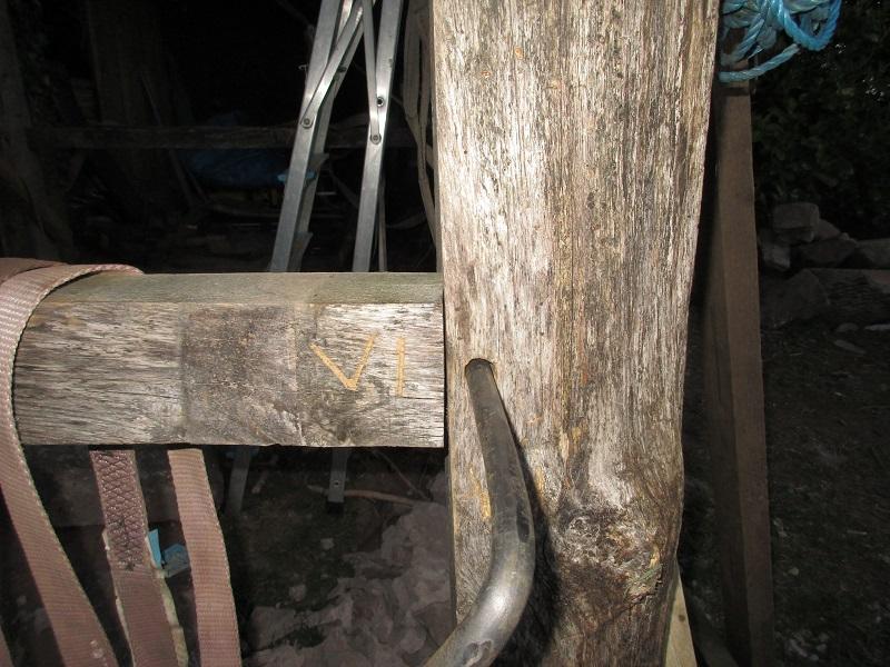

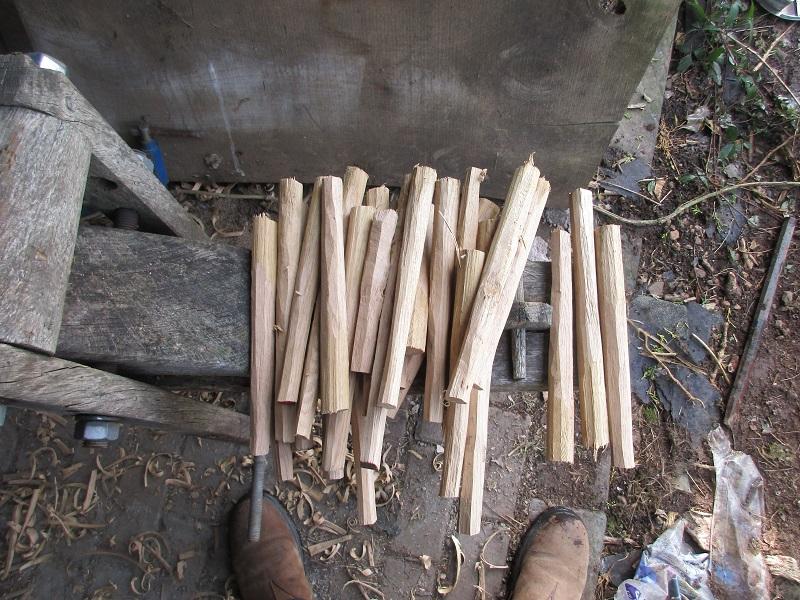

I cut some oak dowels to hold the mortise and tenon joints together . These will be cut to length and tapered . I bore the hole in the tenon about 5mm towards the shoulder so when the dowel is hammered home it pulls the joint tight . As all the wood is only rough sawn all the joints are scribed   when all the dowels are in it should become a very ridge structure .
All the timber framed houses were built like this . No metal nails or fixings are used

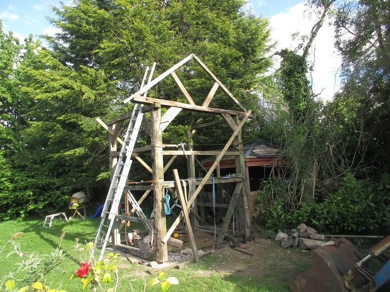

« Reply #18 on: July 09, 2020, 03:38:11 PM »

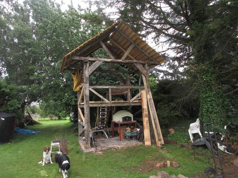

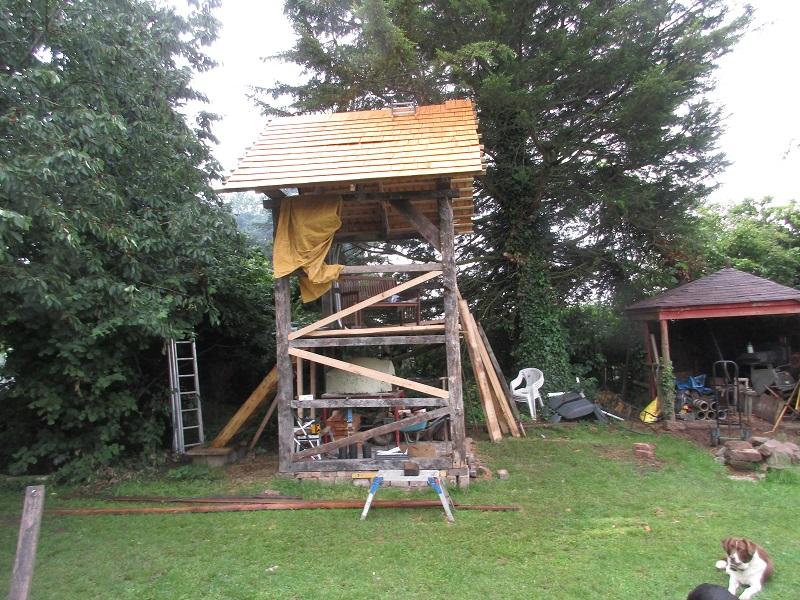

I did not like the tower where I first built it as it looked odd so moved it about 15 feet to a place where it fits in with some trees .
The main work is nearly finished I need to clad the walls .
 The 2 rear most walls I shall weather board as its cheap and quick to do . The infill for one side I will try and do in cleft chestnut
but I am having a problem to find suitable wood that is straight enough grained and long enough . The front I shall leave open at the moment .

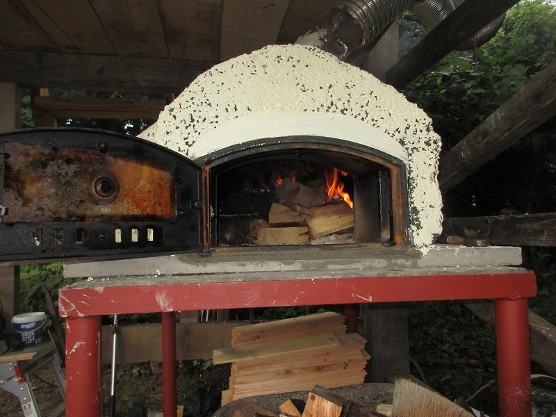

The bread oven is in place and today  I fired it for the first time .
 The roof is western red cedar shingles

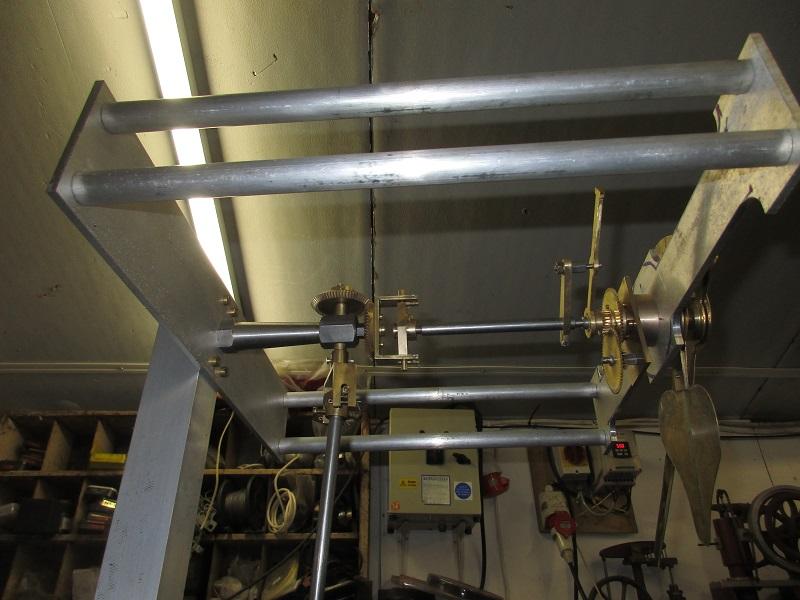

The next part will be to  install the clock . I am still going for a water implused free pendulum design similar to the one made by the Earl of Meath in 1906

« Reply #20 on: July 10, 2020, 05:13:17 PM »
Thanks Andrew but I think your undertakings are quiet a bit more complex than mine .
I tried to keep the construction of the frame as traditional as possible .It is all assembled with mortise and tenon joint and wooden pegs . The only steel fixings are 3 timberlok screws used in each roof truss.
The only problem with building a wooden frame that way is if you forget a piece it is impossible to add it later, and I should have fitted more braces
