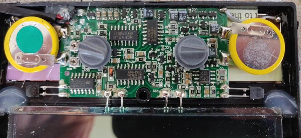

« Reply #4 on: May 22, 2021, 11:07:45 AM »
The batteries are soldered to the PCB on mine as well. They won't be for much longer though...
The left battery measures 1.1V and the right is measuring -0.5 (both in circuit) so I'm guessing they are dead as door nails. I assume they are CR2032, the first part of the designation is covered by the welded on tab - I can't imagine they are LIR2032 though which is the only rechargeable version with an R in it's code.

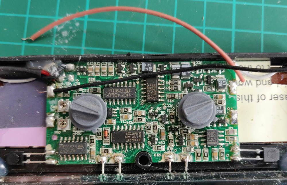

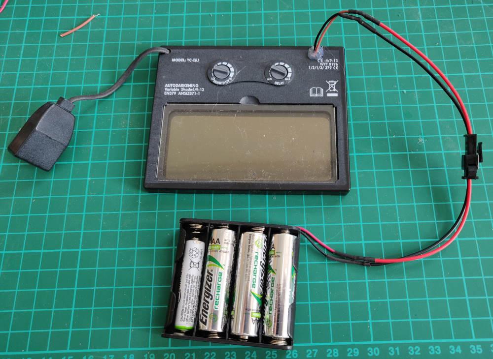

So it turns out it's actually quite easy to bodge in a new battery pack.
It took me a while to figure out how the batteries were wired up as I wasn't going to risk prying the circuit board out and the power traces are on the back I think (it's all hot glued in). Eventually I figured out the batteries are in series and the top two connections provide power - my knowledge of electronics is only marginally greater than my knowledge of welding.
A little hole in the case, some bodge wires, a battery carrier and connector later and we have the frankenshade. It works better than new.
After some experimentation I've noticed that when powered by batteries the shade comes in much much faster. I was testing it against an old halogen lamp and under battery power there's no perceptible flash when the light switches on. Under solar power you get a blinding flash and then the shade cuts in, presumably this is the circuits powering up / booting as there's a surprising number of chips on this thing.
I don't know for sure but I strongly suspect the shade wasn't coming in with the old batteries present because they were forming a circuit which causes the solar panel to be disabled. I noticed when I had it hooked up to my bench power supply that the shade wouldn't come in on solar even if the power supply was off - today I also learnt that there's a path through the bench power supply, presumably through the transformer.
