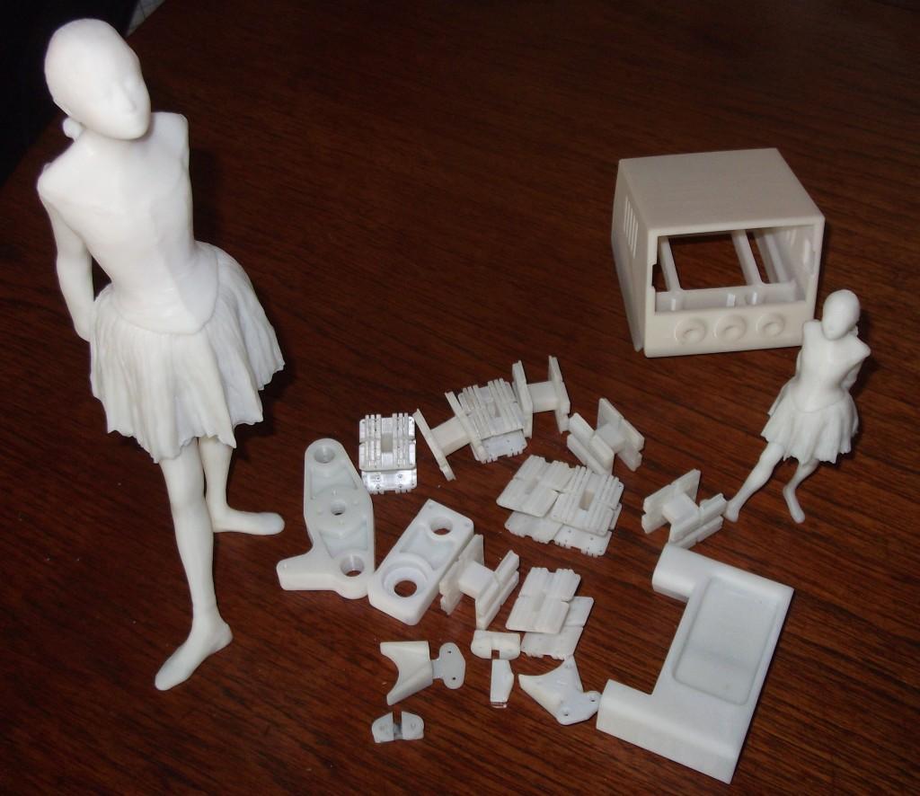

After months of waiting , my  new Elegoo Saturn finally arrived . All nicely packaged and wrapped.
It seems well made, rigid and worth the money*
The first print failed – because I hadn’t level the bed correctly

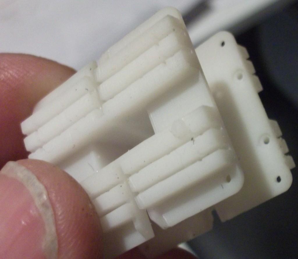

The second print came out nicely although had a minor and inconsequential warp (which I now know is caused by droop)
The third print , a miniature ‘little dancer’ (Degas) was so good I printed a second copy as large as I could squeeze in to the build volume : she came out just over 250mm tall and near as perfect my imperfect support allowed (droop is a real problem!)
One week playing and  I’ve burned through the first kilogram of resin.
The result is :
538g of useable prints  - all very nice :-)
at the cost of
1kg Anycubic  sensitive basic  White
~1l IPA  with another 1.5l in tubs and jars , contaminated with resin
1/2  a roll of  blue industrial paper wipe
about 1/4- 1/2 box of gloves
1/2 of my two brain cells...

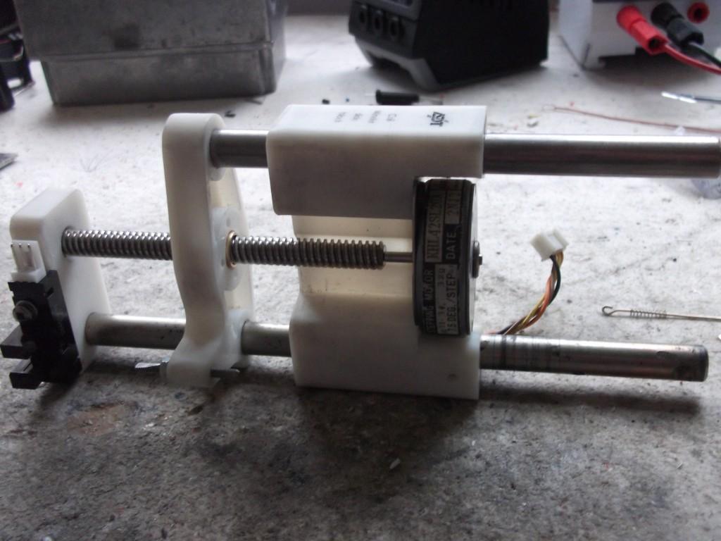

By the way...
I've decided to make my coil winder project open source* (and 3d printed) , in the hope that someone else will find it useful ;-).  It's currently in use winding microphone transformers so it does kinda work.
The software in in my 'stanwegian'  flavour of Python  and is design to run on a RPi  (it was developed in Windows an Linux and can run on those platforms just as well)  . Motor control is handled by a couple of PIC 12F1572s.
Let me know if anyone is interested and I'll share some more info.
*if anyone knows the more about publishing open source designs ,  please let me know.

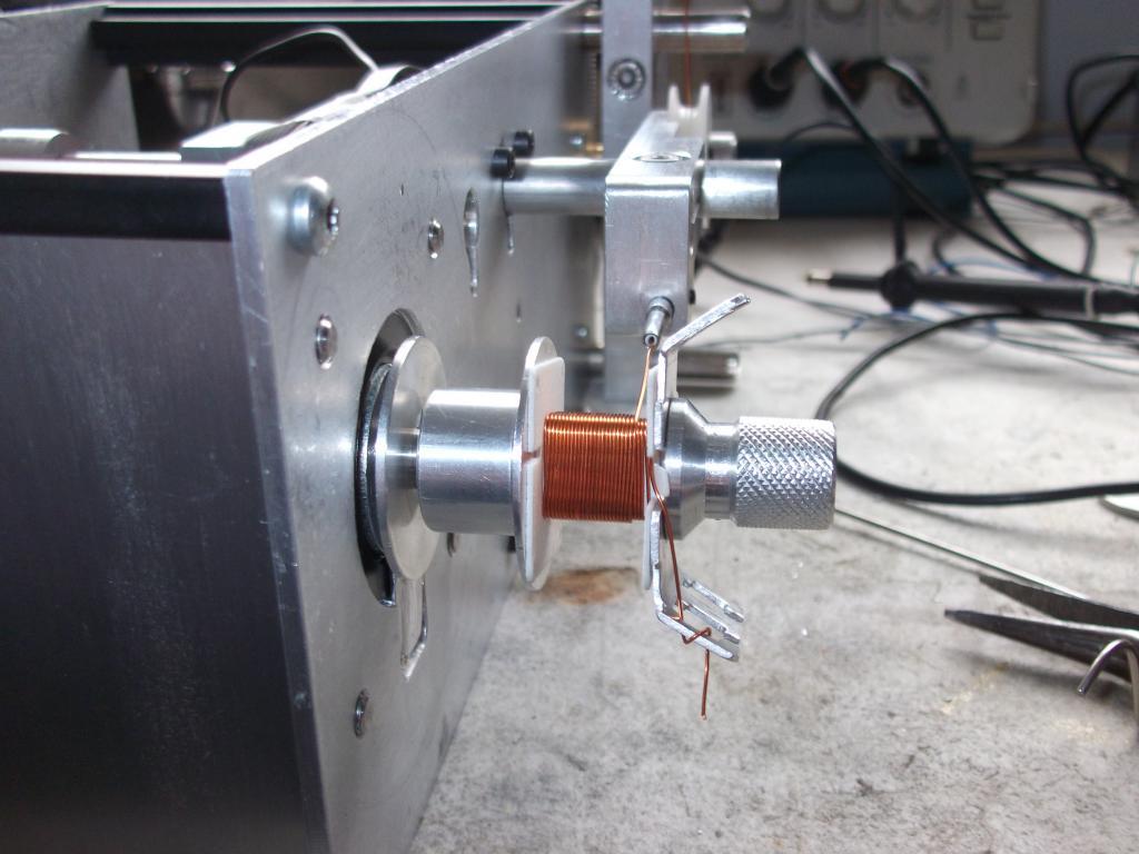

Yeah ,the bobbins are the result of trying to squeeze too many connections into a can  .

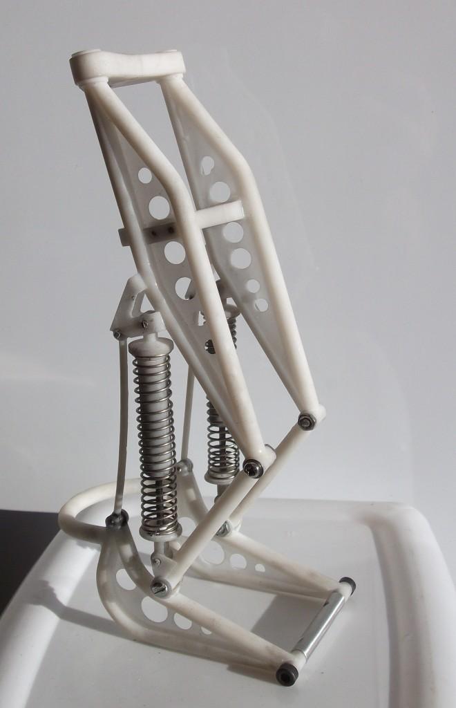

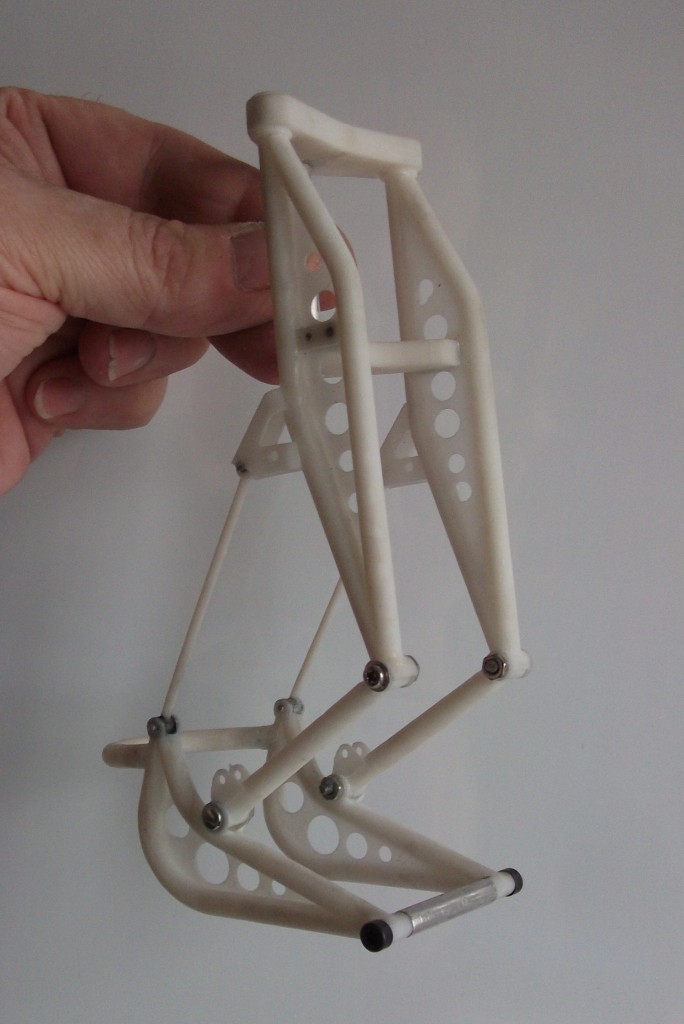

Interesting about the abs like resins. I've watched afew YouTube videos from cnc kitchen and tom salamandererer  , both suggest increased strength, but i  have wondered if this is just  a sensitive resin and is better cured by the initial exposure?
I'll have to try the water washable stuff , it might be the best way to avoid excessive ipa exposure which is , i think , the worst problem.  I know from experience that solvent exposure is nasty and non obvious ( blood pressure increases etc.)  I noticed that a number of yt modellers have been using water based washing solutions (surfactants) instead of ipa . A hot wash in a big bath of percil might be worth a try8-)
Hi Joe,
You're right,  correct orientation, is not obvious  , and slightly counter intuitive ,  i.e , it seems, the best way to print flat is to mount the part at a compound angle  !

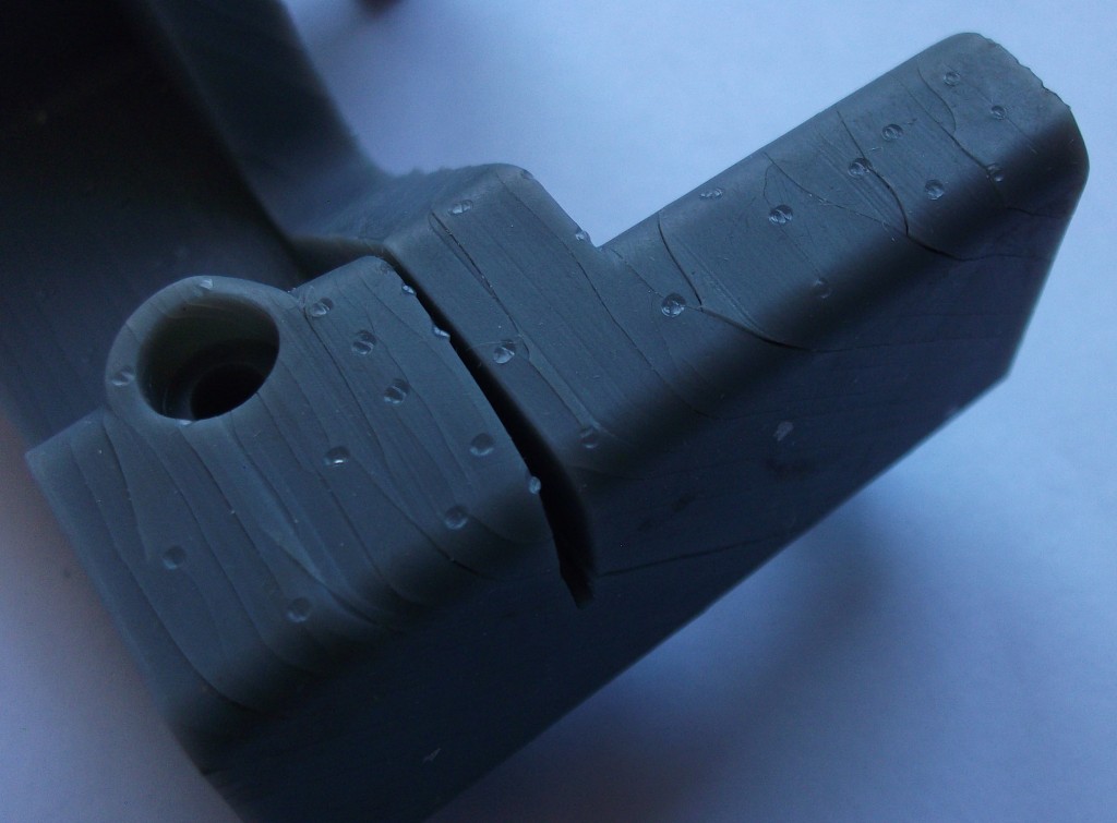

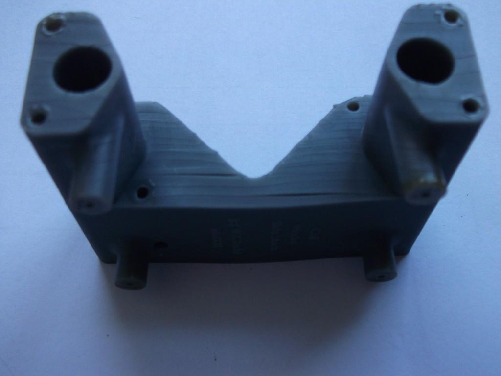

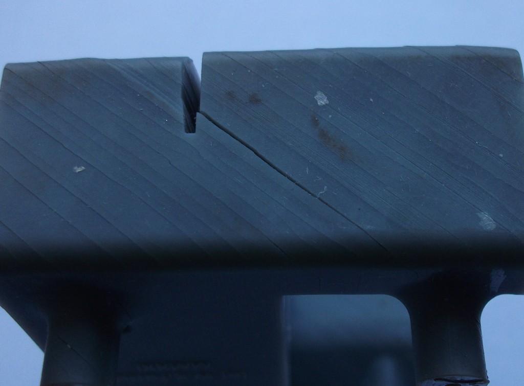

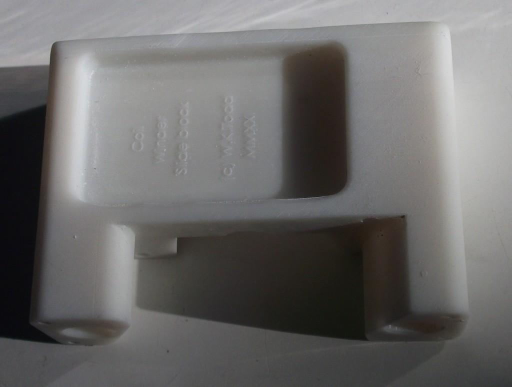

With the FEP film replaced and -  after a week of failed prints -  tightened like a drum-skin, I've been printing a few small parts for a model  (my brother is making a full size set of Ribi-Decoster front-forks for a motorcycle he is building and I thought it'd be fun to use the cad model I created to make a physical model too)
Yesterday I modelled another part for the coil winder to make it (I thought) 3d friendly  - turns out I got the design completely wrong for MLSA printing
Stresses in the part during printing (the polymerisation causes the material to shrink) buckled the print into something unusable . So I thought I'd experiment to see it I could straighten the part with heat.
I put it into an oven at ~120'C and it softened nicely but had a few surface cracks . I clamped it into a vice to hold it roughly square and returned next morning.
The cooled part has retained its corrected shape but the fractures now cover the part as every few hundred layers have tried to separate.
