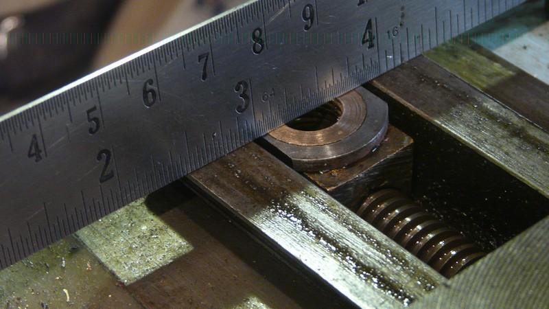

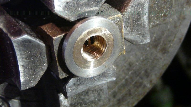

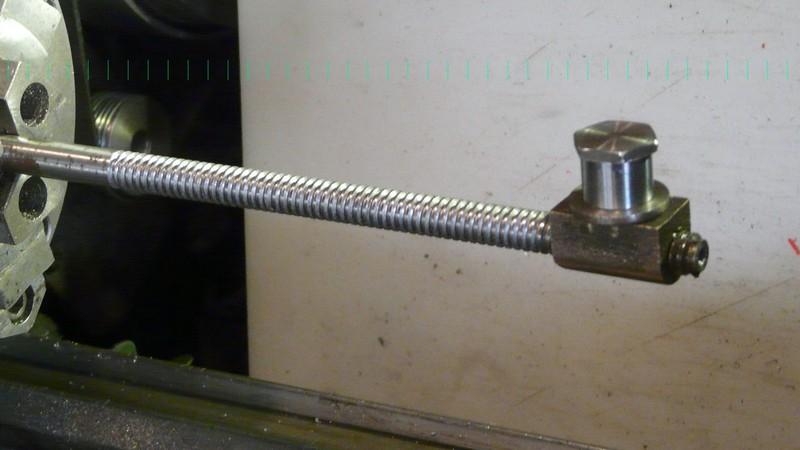

I bought a Boxford model C cross slide lead screw at auction , and checking if it would fit my South Bend model A , noticed that the nut for taper tuning was in two parts , after measuring the height made a spacer and chopped off the top of the nut drilled and taped it , then turned a bolt to fit when I make my taper turning attachment remove the bolt and use the compound to feed in .

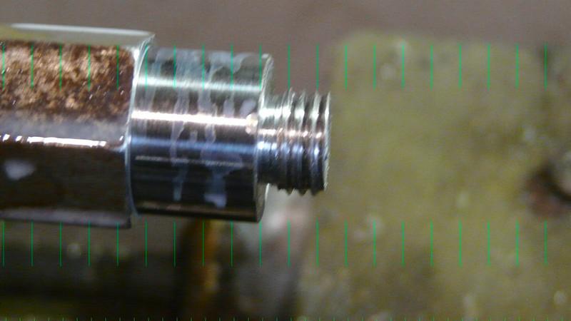

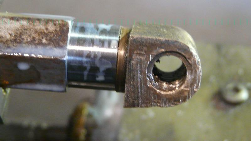

Trimmed the spacer this morning and fitted the nut to the cross slide , in the most worn part of the leadscrew I had 12 thou backlash , compared to over 50 thou previously but hears the thing the old nut is tight on the Boxford leadscrew , I have cut a thread to fit the Boxford nut from silver steel but the South Bend nut doesn't fit , is there a difference in the specification for acme thread in Brittan and America ?

« Reply #3 on: April 03, 2021, 09:21:58 AM »
They are both imperial 10 tpi and 7/16" diameter , the Boxford was converted to metric hence  the spare leadscrew , the tool I cut the tread with fits both threads but not enough to judge accurately , but I am pleased with 10 tou backlash and a spare .
