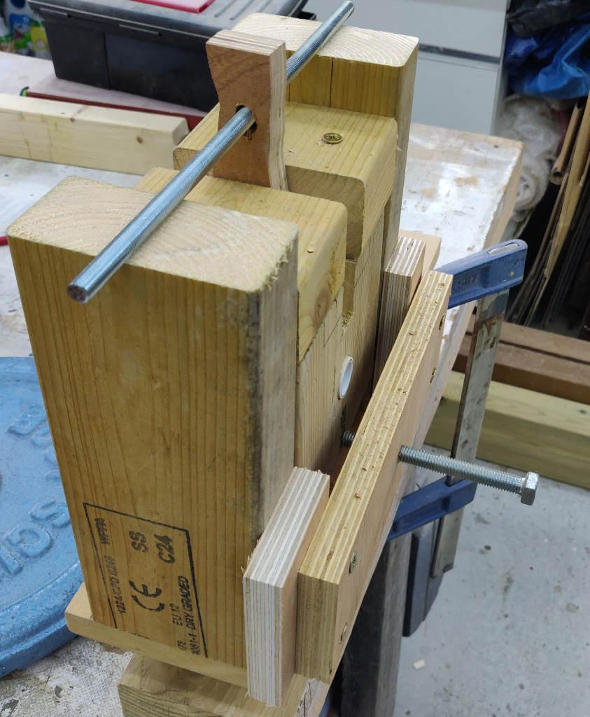

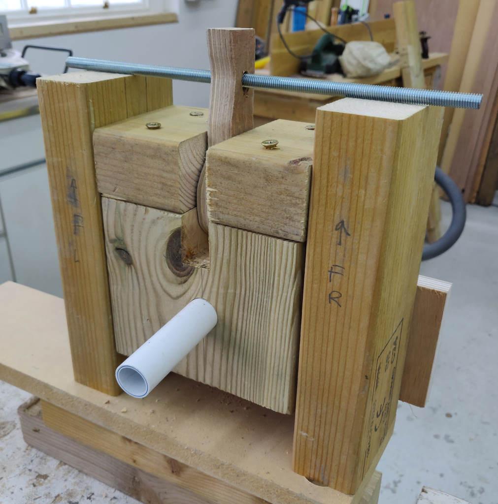

I've literally just finished in the workshop building a mock up of the tensioning and tracking mechanism for the upper wheel, there should be a couple of pictures attached. The thing sticking up is supposed to be a lifting bolt with a long shank rather than some badly butchered piece of scrap ply. There's bar running in tracks in the uprights which lifts the centre section and then there's a bolt on the back for tracking adjustment. Even this monstrosity built from scrap timber and plumbing pipe held a 10kg plate and tracked it just fine.

You need to think how you are going to track the wheels, or at least one of them, to get the blade running true and where you want it on the wheel tyre. Just needs to be able to tilt a bit in a controlled fashion.

I've watched all the Wandel videos and several others, I've borrowed ideas from a few different builts. I've not seen the tracking and tensioning mechanism I'm planning on using anywhere which is why I've built a mock up.
The top wheel will be have both tracking and tensioning. In the images a couple of posts back the bolt on the back pivots the large block with the axle sticking out which should provide the tracking. The wheels will be crowned as well. You can't see it in the picture but there's a shaft running through the large central block that locates in uprights and acts as a pivot point.
