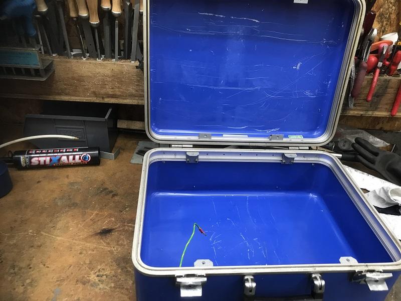

Then there were three - one for each Analoy 1401 and a spare.

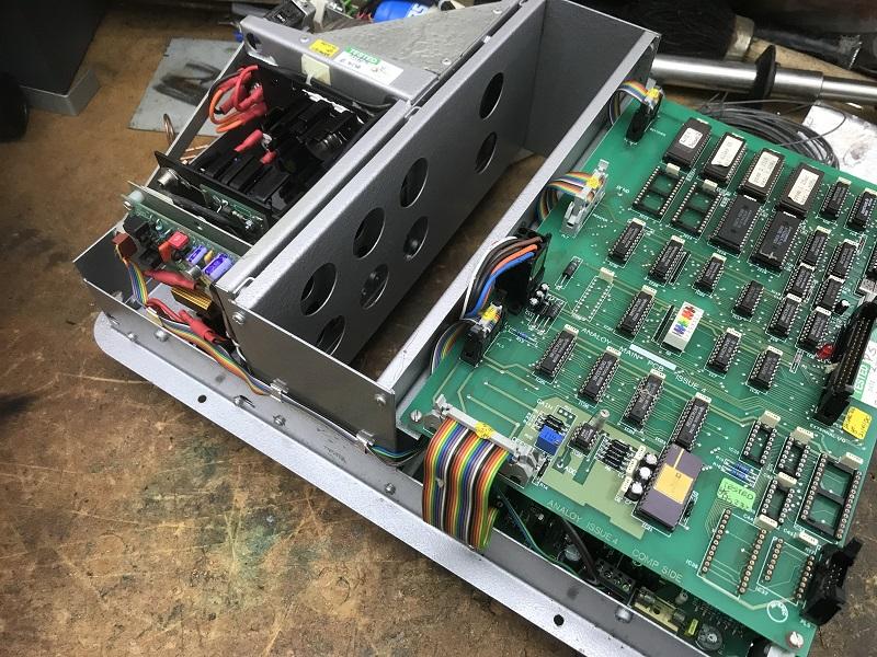

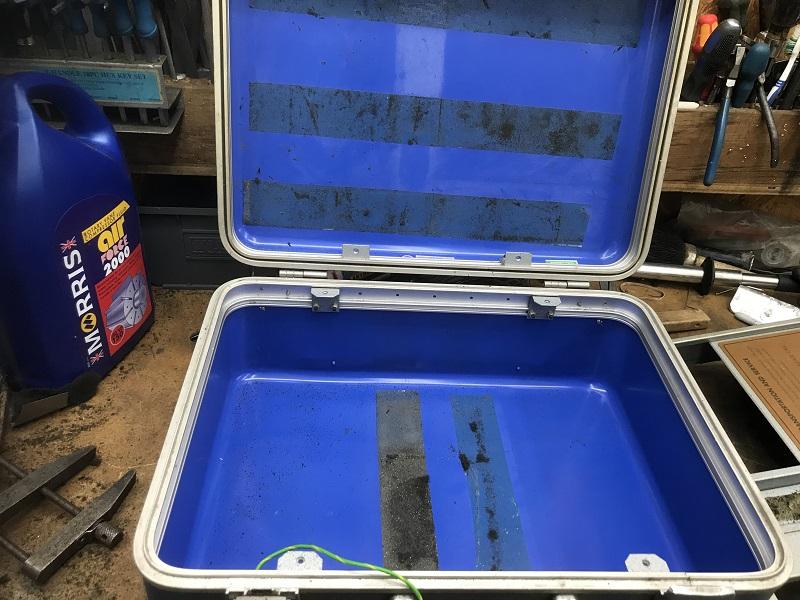

I finished the (very) sticky task of removing the crumbling foam and associated double sided tape from the second analyser. Very much the same as the other one. This has 1990 stickers inside so is slightly later, but contrary to my recollection the firmware is the same according to the labels on the EPROMs.
One difference that I did notice is that the main body of the instrument is directly fixed to the case whereas the other one used anti-vibration stand offs.
Not started fixing the neoprene replacement foam yet, I need to let my head clear of the spirit / solvent fumes getting the double sided tape off. I'll tackle the new foam tomorrow when I get back from my Covid jab (Amusingly scheduled for  09:31 - not 09:30 or 09:25 but 09:31 PROMPT - remember the army are in attendance marshalling and doing some of the jabbing presumably with military precision  :clap:)

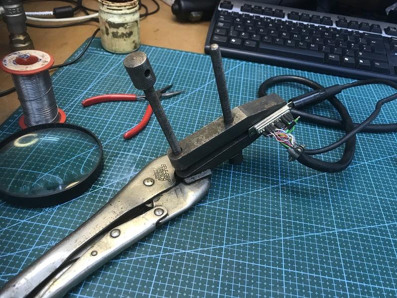

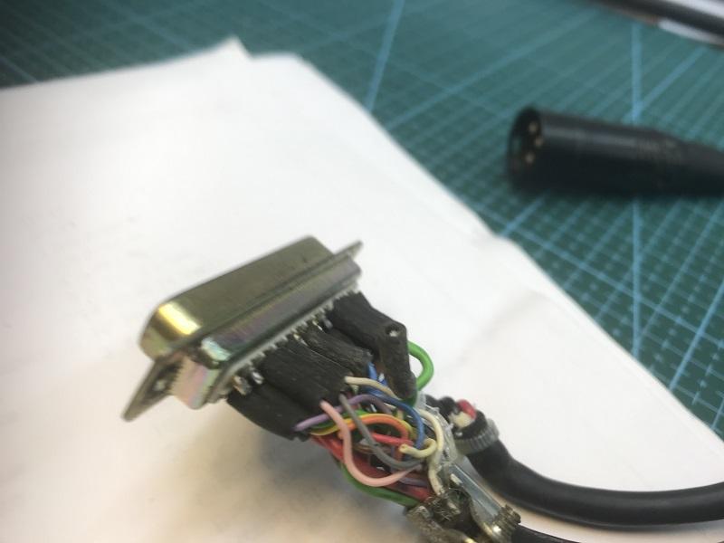

So the new foam got glued in and I put it all together but it doesn't work now  :bang:
Almost certainly broken cores in the umbilical cord - I found three and re-soldered them but I find fine work like 25 way D plugs hard going these days. I've put it to one side for the moment.
So I moved on to gas plumbing the Ceramic Chip Forge to cheer myself up  :ddb:

I must remember that holding method...
I found crimping was easier but still fiddly.
I find myself dreaming of a stereo microscope more and more...
-russ
