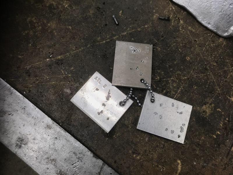

Pleasingly I did a test on some zinc billets today that I had from some previous work and it reported 100% zinc - of course it should, but this is the first test on a non aluminium based sample that I've done.

One of my two instruments has a group of test samples (about 1.5" square) of different alloys for comparisons.

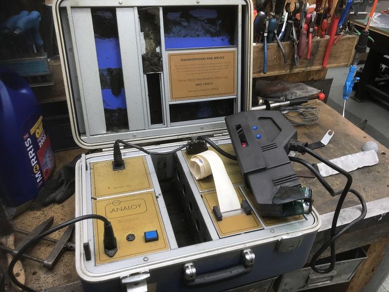

You are all too kind - I imagine you all snoring in front of your PC's  :lol:

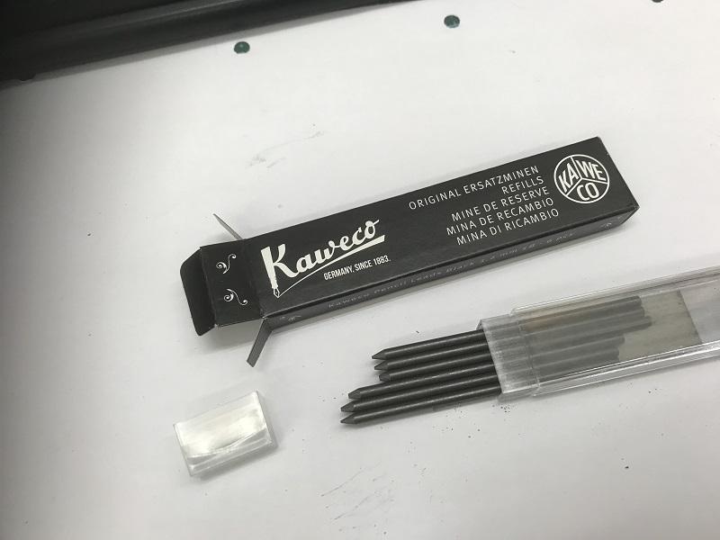

I dug out the second Analoy 1401 - I know that it has worked in the last few years but when I plugged it in, although I could strike an arc I got no indication on the LED bargraph of signal (rather charmingly they refer to these led bars as 'candles')
A bit of poking around showed that some of the decomposing foam had got into the 25 pin D connector for the probe - a quick blow out with compressed air and not only was it now working, but giving identical results to #1  on my ingot of LM2 alloy. This is good news and gives me the confindence to pull it apart and give it the same treatment the analyser #1 got last week.
My purchase of pencil leads to potentially make some graphite points turned up. These are 3.2 mm 5B leads intended for a propelling pencil . Quickly cutting off the end of one to make an electrode and trying it I immediately saw that the arc was burning significantly more fiercely. the electrode itself starts to glow and is much more fragile.
The test results differed greatly from the correct electrodes with the proportion of silicon showing higher at 23 % and iron also higher at 6.1% Now there are are presumably all sorts of binders added to the leads, but another variable is where the electrode sits in the chuck. Due to the engineering of the collet a 3 mm electrode sits more deeply than these leads at 3.2 mm. Now I know electrode height affects things. When I've tried to re-insert a used electrode and held it so that it sits a bit higher (to make up for burn back) and over egged it so too much sticks out some elements disappear from the print out.  Presumably the part of the CCD device devoted to those elements isn't receiving light.

I have some 2B true 3.0 mm leads on order so they will at least fit the collet better but I expect they also will contribute elements to the analysis. As Steve says the clay binder is sure to have at least Silicon in it.
I'd hoped that if I could find pencil leads of the same hardness and blackness rating I'd be home and dry but thinking about it different manufacturers will achieve the same rating suitable for artistic use and indistinguishable BUT using differing constituent elements  :bang:
Ideally I need to find somewhere / someone that can analyse / grade / identify what the proper electrodes are made of - I'm keeping the used ones  on the off chance I find someone.

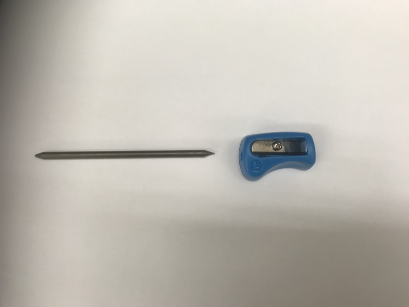

The postman brought two things for this project:
Firstly a 3 mm pencil sharpener - I'd never even considered that there were such things, but not only does it sharpen the graphite rods to a very suitable point, it, like me is left handed ! (there was the choice) and at £2.45 not worth mucking about with making something. Just need the right graphite now !

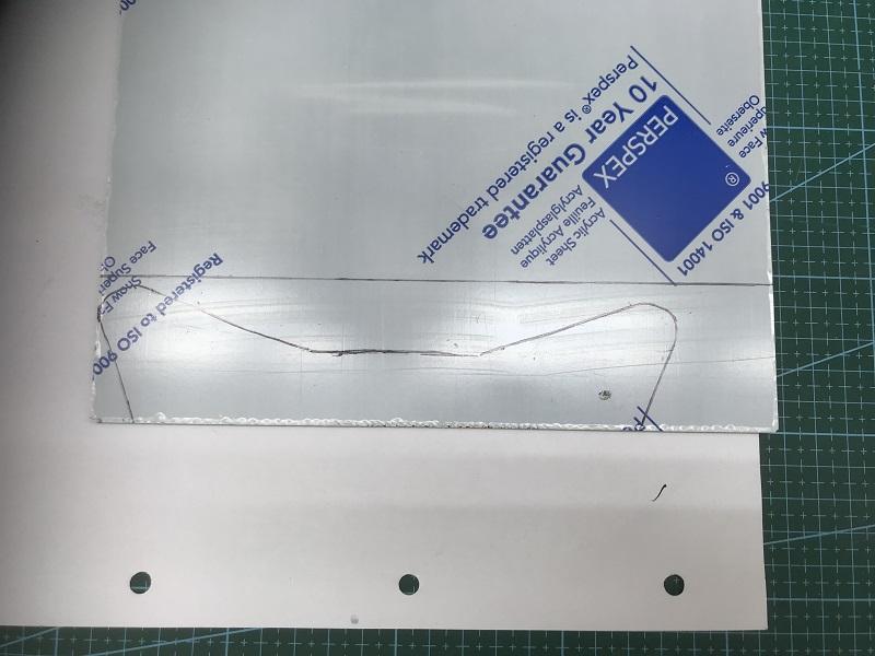

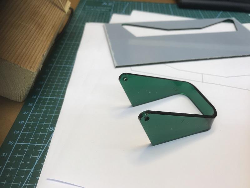

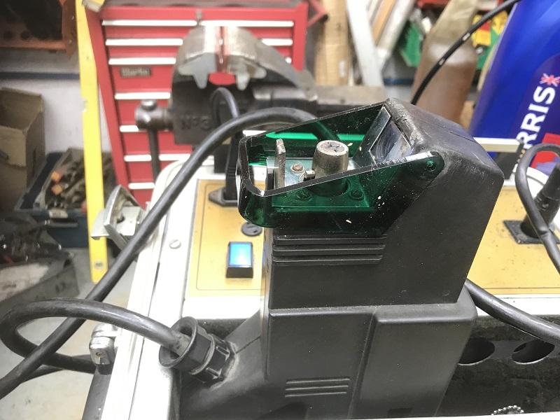

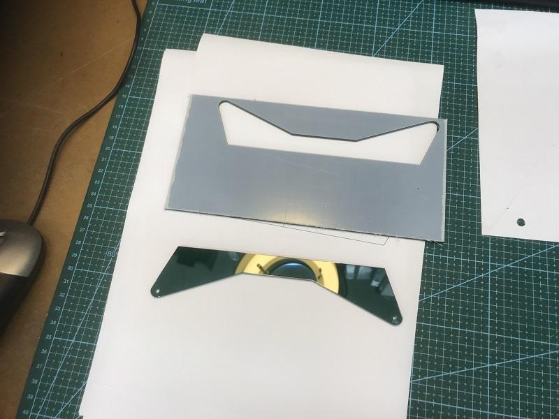

Secondly some scraps of green perspex to make a replacement UV screen for the arc discharge. The one I'd glued had broken again.

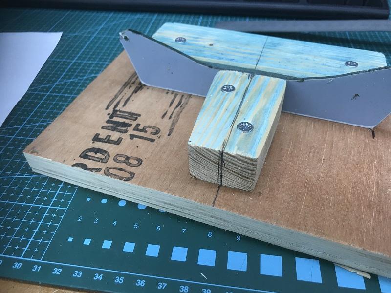

My first attempt was by tracing one of the original shields onto the perspex by hand, and with a combination of band saw, sanding disk and drill make a flat blank ready for bending. I made up a simple wooden jig as the bends have to be more than 90 degrees so that the shield grips the body. The shield is located by two pins projecting from the probe and it pivots on them as well, so the holes for these need to be aligned.

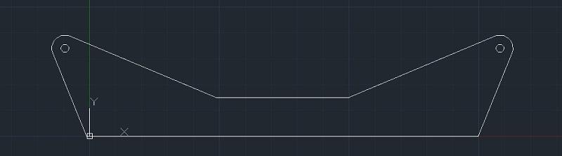

It didn't come out too well, and it was a this point I realised that the 'originals' were both hand made copies that not only differed from each other but either side of them was not a mirror image of the other!
OK draw it up in AutoCAD - I ported it to the laser cutter and cut a template from a sheet of gasket material to prove it fitted - it did :thumbup: So putting a bit of perspex in the laser cutter I set it going. The cut was SO smooth and even compared to my hand made effort. So into the bending jig having been heated with an electric paint stripper, and out came a very acceptable UV shield  :ddb:
I will make two more while everything is set up, so both machines can have a decent shield and I'll also have a spare.
