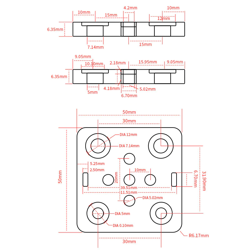

These are the V slot guides I am using.

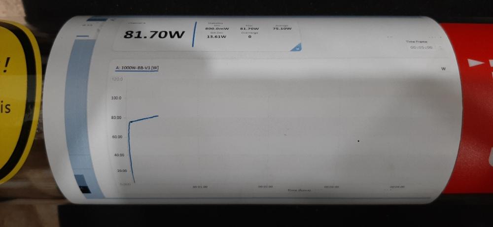

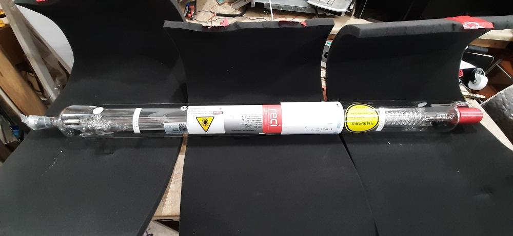

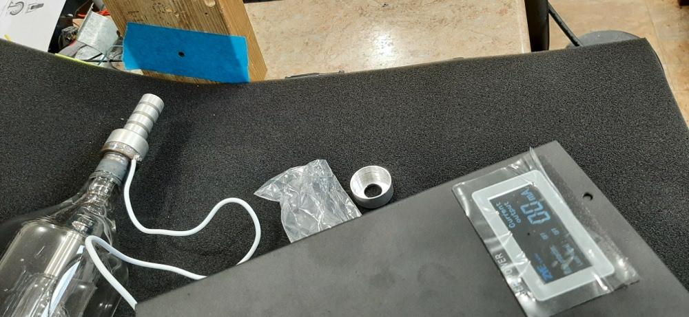

My Laser tube finally arrived  :thumbup:. Its a Leci W1 tube. Scanning the barcode takes you to the leci site which says it checks out as genuine part. It has a performance graph on the tube and you can see that anything above 75W is optimistic
Did a functional test and it burnt a 5mm spot in some blue tape and wood. Nice round spot, so it all looks good.
Working out the layout I'm definitely going for the driven shaft method for the Y axis. It means I can reposition the motor to get more useable depth.
Just need somewhere to store it safe until I'm ready to fit it now. Looks very delicate !!
