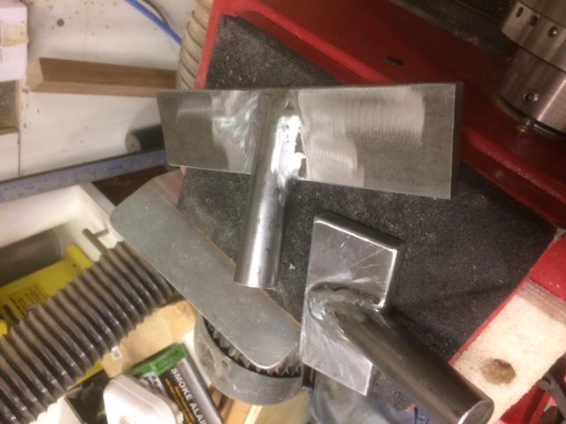

Steve and as it’s a birthday present it don’t count Good luck
learned that one years ago.
Happy Mew Year, let us know how much fun it is please?
I’ve just been playing with my cheap MIG making a couple of new rests for the wood lathe. I won’t win any prizes for the welding but not had any practice this year and penetration was good ( read that as scorched the bench underneath)

howsitwork, I think those will probably hold up a lathe tool.  :beer:
