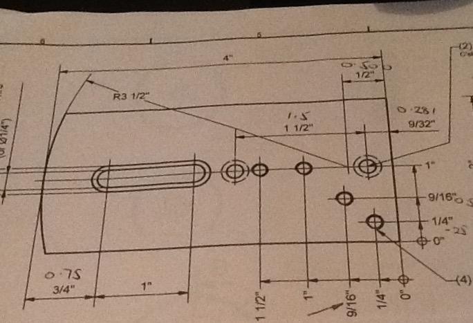

  [ You are not allowed to view attachments ]  Gents,
Opinions needed.....
Study the drawing attached and tell me what you think......
The tapped M5 holesare located as shown, but is the second one located 1/4" + 9/16" or is it located 9/16" from 0" on the bottom right corner?
Then is the 3rd one similar? 1/4"+9/16"+1.0" from 0" from the right hand edge? Or is it 1.0" from the right edge?
Finally the 4th, 1/4"+9/16+1.0"+1-1/2" or is it 1-1/2" from the right?
Thanks from Confused....

John, 9/16" from 0 on the second one, and similarly 1" from right for 3rd and 1-1/2" from right edge for 4th.
Look for the second arrowhead termination on the dimension lines. If there is one, then it's to that base point. If there isn't then it's to the first base point for all. At least in this dwg.
You'll notice that on the other two circular locations (not mentioned) there is a mix. The first dimension (9/32") is from the right edge, the second (1-1/2") is from the center of the first. Check the arrowheads.

Steve,
So to clarify,
All measurements are based on the 0 datum?
i.e  9/16 from 0 rather than the 1/4"?  That would make that hole location 5/16 from the first? ...then the fourth hole would be 1-1/2" from 0?

 The drawing looks like it has the datum 0/0 at the bottom right hand corner, and the other measurements are from that point.

« Reply #5 on: January 08, 2021, 01:07:02 PM »
John,
Particularly as you have a DRO, dimensioning with co-ordinates from a corner datum makes life much easier. CNC works this way after all.
Why the drawing has a mix of co-ordinate and chained dimensions (9/32" and 1 1/2")is a bit odd. The 1 1/2" dimension might be critical but if it is it should be toleranced accordingly.

I looked at the drawing and surmised that the dimensions were cumulative from 0,0 due to there being no right facing arrow heads between the dimensions. Adding to the confusion I think is that  above the dimensions queried there is a mix of single and double arrow head dimensions.
Anyway, reading further if found that vtsteam offered the solution in the very next post.

I know this is a few days old and you have your answer, but it is possible to use a measuring device on the drawing to confirm or deny your suppositions.
A piece of paper laid over the 3/4" dimension on the left side and marked both ends, then folded in two and marked again will give you 1 1/2". Lay the 1 1/2" over the supposed 1 1/2" on the right side and see if it lines up.
No paper? Use your thumb over the 1" + 3/4" on the left. Same thumb on the right would be slightly longer than zero to 1 1/2" and massively longer than 1 1/2" to 1".
If your supposition of adding the dimensions were correct, the total would be 3 5/16", putting the last hole well over to the left of a part that is only 4" overall long.
Look at the vertical dimensions of the first three holes. They are identical to the horizontal ones.  The third one appears to be in line with the centreline of the material. A straightedge along the three hole centres would show they align, meaning vertical and horizontal  dimensions are identical.
This is not to make excuses for a drawing whose dimensioning leaves a bit to be desired but you can use other features of the drawing you have to sanity check or infer or clarify things as necessary.
