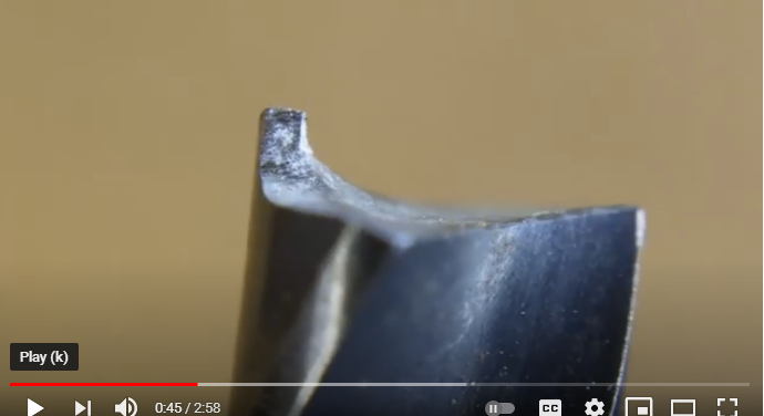

YouTuber AndyDaviesByTheSea did it by grinding a broken 1/4" drill bit.  I went that route, but it grabbed too much for my liking.  And since I've made D bits in the past that worked well, I thought I could do similar for this.

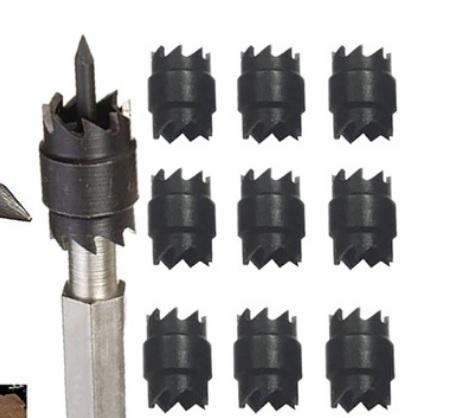

Could you use a spot weld removing tool without the centering bit?

Yes, I know teeth, but I wasn't sure how best to do that.  That EEVBLOG thread helps.  Had considered a spot weld cutter, but OD and ID aren't what I want.

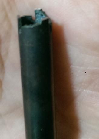

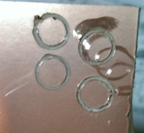

I made this:
Three teeth.  Done with a Dremel.  Heated, quenched, tempered, briefly honed.

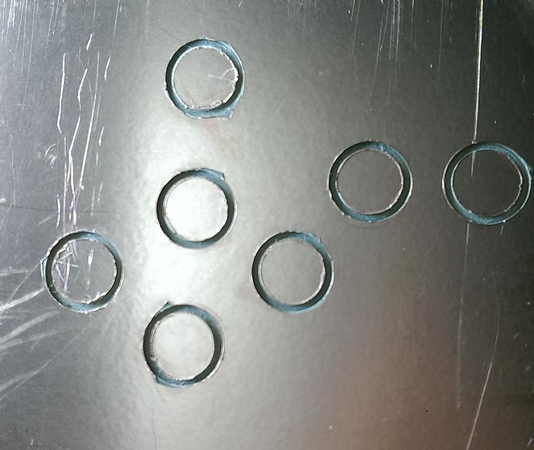

Not terrible, but more tearing than I had hoped:
I drilled with my mini-mill at low RPM.  Didn't grab at all.
  • Posts: 6823
Re: PCB pad cutter
« Reply #10 on: January 07, 2021, 10:39:22 PM »
Why low rpm?
Also, are you clamping the board down?
  • Posts: 6823
Re: PCB pad cutter
« Reply #11 on: January 07, 2021, 10:51:53 PM »
Pretty hard to tell what shape those teeth are or the angles in that photo. Looks like there's no clearance and finish is rough.
Try forming the teeth with a triangular file, smoothing the ID with a round file, and 1500 rpm. Tooth depth only needs to be a little more than copper thickness. Try 5 degrees end clearance.

« Reply #12 on: January 07, 2021, 10:54:02 PM »
Low RPM so that I could just remove the copper without chewing down through the board in the blink of an eye.  Didn't need to clamp it down, the cutter didn't grab at all.

The teeth have no front rake and just a little clearance, probably a couple degrees.  Finish isn't rough, but not great.  I stoned the OD edge, diamond honed the top of the teeth briefly, and didn't have anything to clean up the ID edge.

« Reply #14 on: January 07, 2021, 11:22:20 PM »
From the appearance of the board, looks like it wandered one attempt, then grabbed the copper foil in the others, indicating feed too fast for the rpm and or board moving. Set a depth stop if over drilling is a problem, or add a collar as the user did in the post referenced earlier. 1500 rpm would be 100 sfpm on .25" which would be right for copper.
That obvious one doesn't count; I didn't have the board resting flat.  The tearout one in the upper-left was never felt, it really tore easily...possibly due to being cheap board from China.

By the way, the guy who's image is shown in post #1 used a sharpened broken drill bit with one tooth and got no tearout whatsoever.  Magnified images of his cuts look great.
His bit:
Maybe I should revisit my drill bit grind attempt.  Or maybe he's using better quality boards.

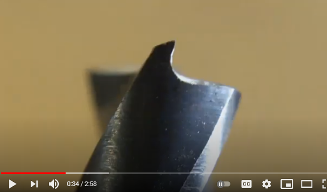

He ground proper tooth shape with flat rake and adequate end clearance angle, and likely proper radial angle (not visible). The same can be done on a homemade bit.

Other view of his bit:
  • Posts: 6823
Re: PCB pad cutter
« Reply #21 on: January 08, 2021, 09:02:55 AM »
That doesn't show any of the angles. An end view would show the radial angle.

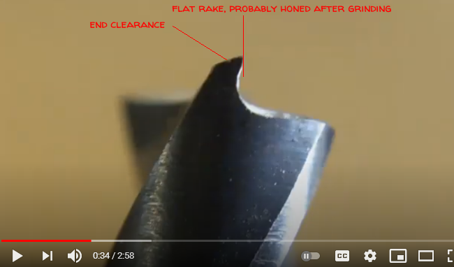

« Reply #22 on: January 08, 2021, 09:12:33 AM »
Here's what I'm talking about. The end clearance angle is exaggerated because it recedes in the photo. The honed  flatting of the cutting edge is also normally done to conventional drill bits when drilling copper based metals.

I honed the cutter some more and made a board.  Still getting some tearout and raised burr edges.
Couldn't get a good closeup of the cutter.  I'll try again with a small tripod and better lighting.  Am now very impressed with AndyDaviesByTheSea results.
