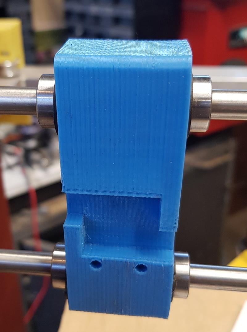

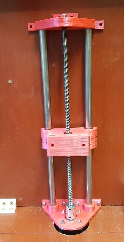

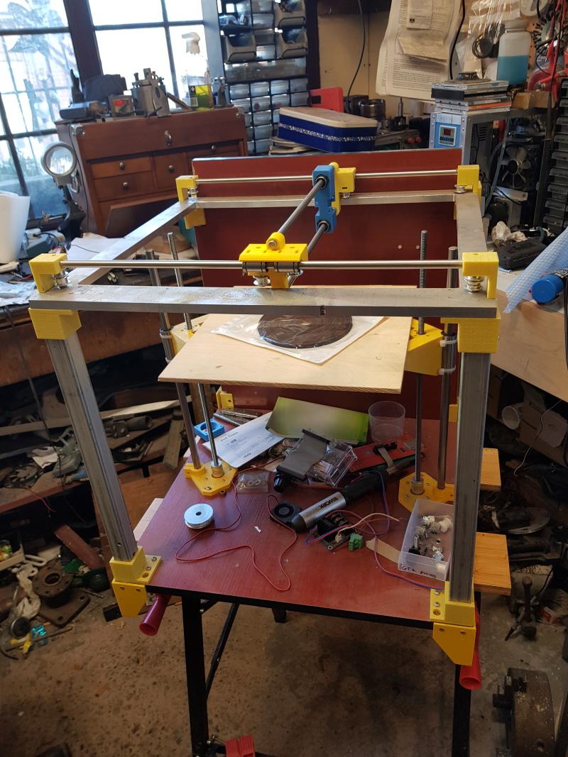

As I have had a bit of spare time recently I have started to do a bit more on this project, I had to find the thread to see how far I had taken it and realised that I had not even kept up to date with the thread. So there is a big chunk missing from this.
First pic is where I am currently at:
The latest part I have designed is the blue "Y" axis bit which will include the adjustment to tension the belts (pic2) I notice theres a bit of distortion in it but it looks far worse on the picture than it really is. I am trying to decide if I should 3d print the adjusters or make them from aluminium at the moment they are quite simple and will just have a pin to fold the belt around and a M3 adjuster screw.

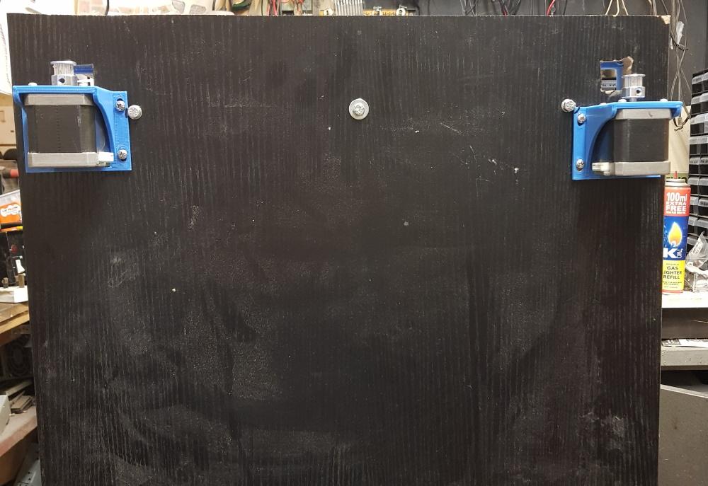

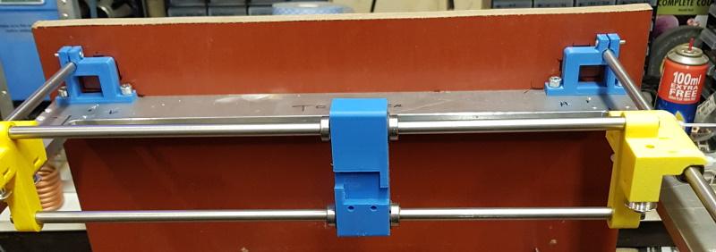

I have made a bit of progress despite my kids seeming to think that dad can do without that free time nonsense  :lol:
I printed new mounts for the X/Y steppers and mounted them and have slight redesigned the belt ends/adjusters, still need to drill and tap the adjusters for some M3 bolts but I might wait until my friend comes back for that his Hobbymat is much better suited for such small stuff than my Harrison is.

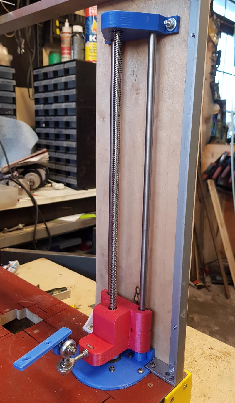

So there I was happily designing and printing stuff to build the printer with the intention of using the ramps board I have had for ages, when I got a message from a mate "I saw your making a printer, I have a BTT SKR2 board with the touch screen and TMC2208 drivers. Are you interested"  :doh: Its only the board I had in mind for future upgrade. So after berating him for costing me more money I took it off him  :lol:.
Now however I have decided to skip straight to another future upgrade I had in mind and make the printer with triple Z screws and self levelling which of course means I need to order an expansion board to allow 3 independant Z screws. The back centre screw is worked out and in place.

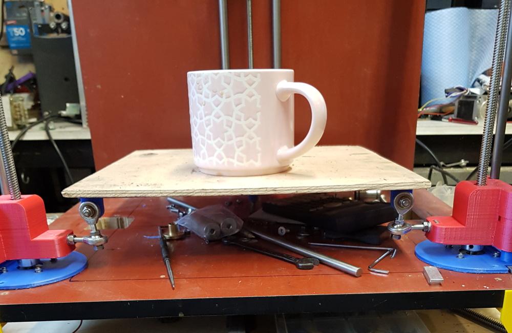

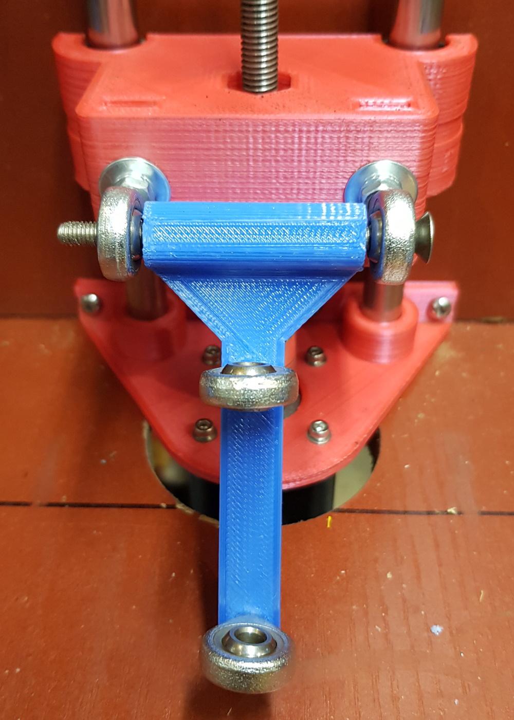

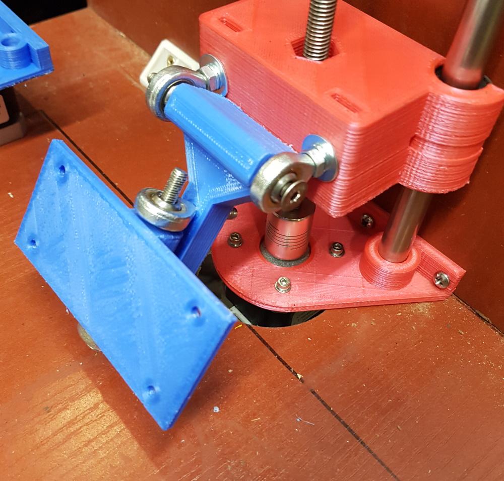

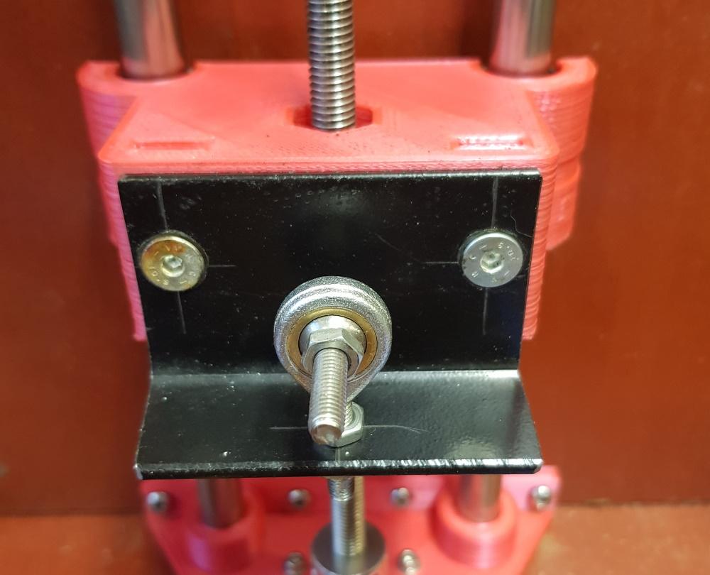

Looking for some advice here, I had planned to use rod ends to allow the freedom of movement with just one on the back and 2 on each of the front corners but now I am thinking that will allow too much freedom as there will be nothing stopping the bed from moving side to side pivotted on the single rear rod end.
Edit: Never mind I have solved it, it just so happens that the bracket is held on by two M5 bolts which is the same thread as the rod ends so I dont even need to modify anything.

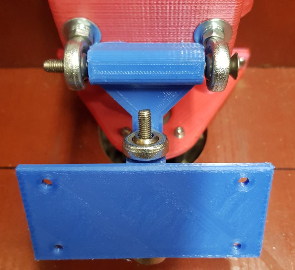

« Reply #11 on: February 14, 2022, 04:19:49 PM »
So here we have my solution to the problem, this will allow the bed the freedom to move but keep the centre lined up.

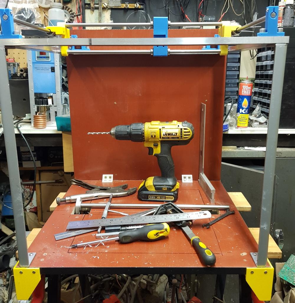

Started to work out the panels which will be cheap plywood until I get them finished at which point I will replace them with some clear plastic.
The sides will be made of one fixed panel which will serve triple duties of keeping heat in, securing the front Z axis and also keeping the frame square while the rear will be a hinged door in case I need to get in from the side for any reason.

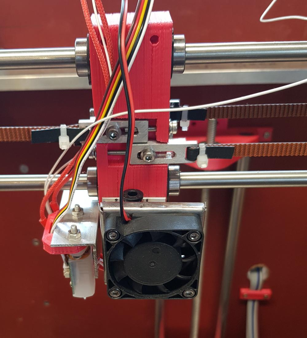

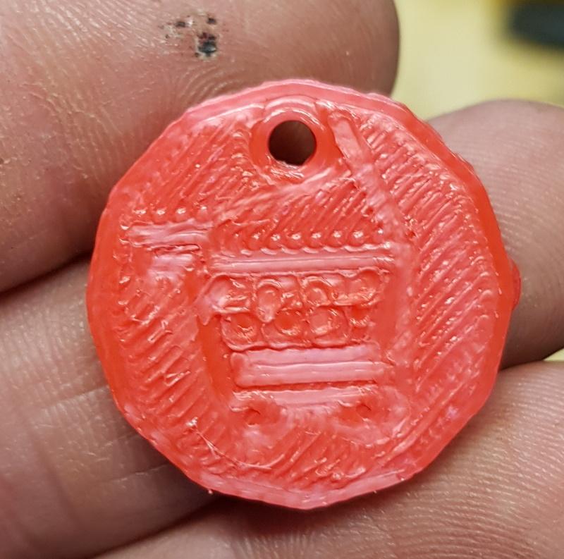

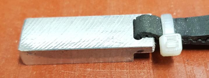

« Reply #15 on: February 28, 2022, 01:50:14 PM »

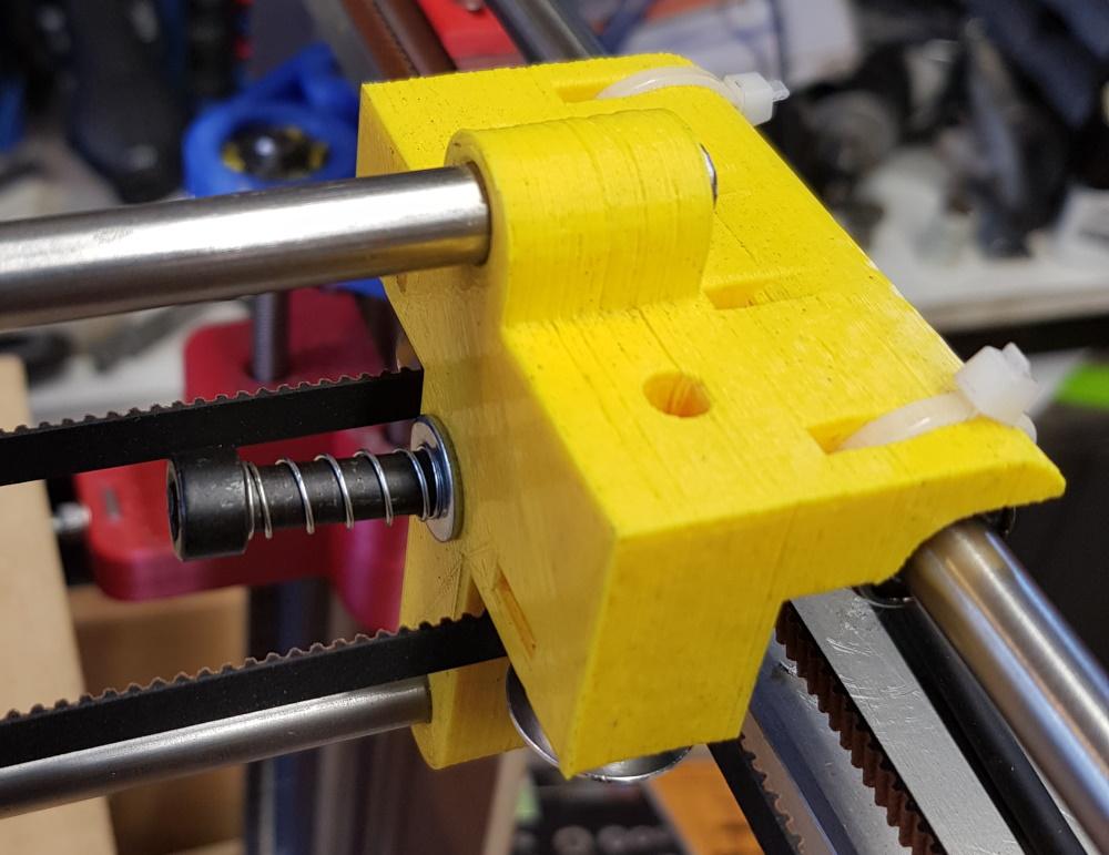

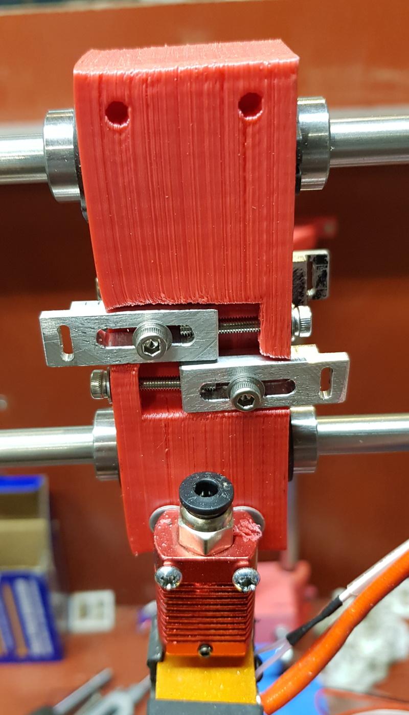

Belt adjusters are fitted but the picture makes the print look far worse than it is to my eyes so will probably reprint that in the future. Picture also showed me one of the inserts wasn't in straight so I have sorted that.
Anyway its the same both sides so I will have ample adjustment for the belts.
Offline jiihoo
  • Posts: 71
  • Finland - Northern Europe
Re: Printer Enclosure.
« Reply #16 on: March 01, 2022, 09:03:55 AM »
It is a functional and fully functioning part so no need to re-print; it will work fine for the intended purpose. Just move on to the next part  :thumbup:
Did the corners lift from the build surface during print cause that's what it looks like? If my parts are big or very small or tall and narrow then I take all the help I can get and use an adhesive on the print surface. It also helps to lessen the frustration at the beginning when the 3D printer is not set up perfectly yet (print head temperature, print surface temperature and initial layer distance from print surface) or when first starting with new or harder materials. I had a bit of a "learning experience" when first starting with PETG after having used PLA before. My frustrations went away with starting to use an adhesive and slightly increasing the bed temperature.
My 3D printer is the Anycubic I3 Mega with the Ultrabase print surface. Decent quality budget printer in my opinion. The adhesive I use - and the only one that i have experience with - is Magigoo (the original multi-material one).
Jari (following your project with interest)

« Reply #17 on: March 03, 2022, 04:57:43 PM »
I fully intend to leave it as it is for now but will improve it sometime in th... lets face it once its working I'll probably never get around to it  :lol:

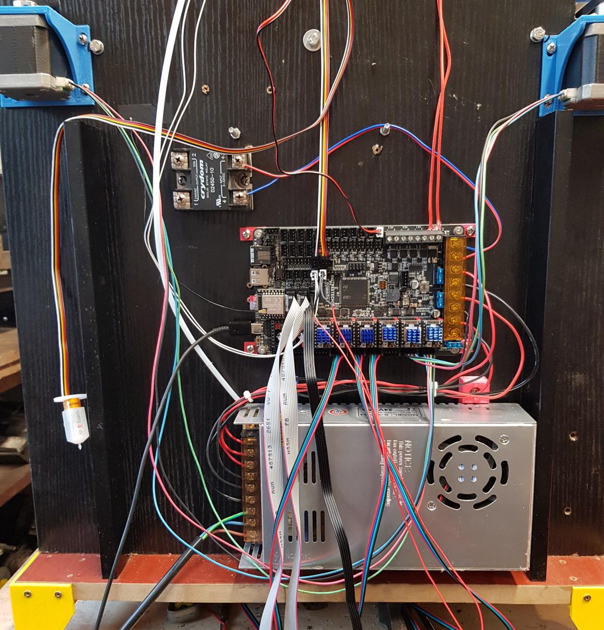

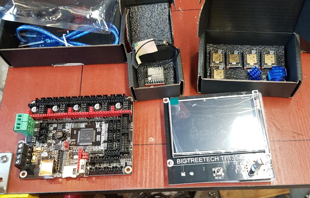

« Reply #22 on: April 08, 2022, 03:47:07 PM »
Found the problem and it wasn't firmware. I connected the board to the pc and used repetier to get it to tell me about a "error all low" msg I was getting and it was from some of the steppers after a little swapping and changing I figured out it was the extra steppers I had ordered to fill the expansion board. The ones that came with the board already had the jumper connected to turn them to uart mode but the new ones didn't  :doh:
However then a disaster happened I connected one and did a test and it wasn't showing the "all low" error any more so I proceeded to do the next one (they are a bloody fiddly little jumper to solder) and made the mistake of plugging it in without powering down the board and immediatly noticed the psu fan speed increase then slow down again.
Now when I power the board the processor starts to get hot really quickly and I think I have fried it  :bang: :bang: :bang: :bang:
As I dont have time (or the skill probably) to see if I can fix it I have decided to get a octopus instead which has the option for 8 steppers on board so there will be no need for the expansion board.
What an expensive mistake.

I'm not entirely sure why it would do it, at first I thought I had messed up the connection but I looked at it close and it seems fine. As I have 1 spare anyway I have stowed it away to look closer at a later date.
  • Posts: 1223
« Reply #25 on: April 09, 2022, 03:36:44 AM »
There doesn't seem to be much thought gone into preventing plugging accidents with these cheap boards. They seem happy to mix voltages on bare unprotected pins 3v3 next to 5v, next to 24+
Be very careful of the octopus's fan selection pins !  5,12,24 on an array of pins just waiting to bite. Even accidentally dropped objects like nuts or washers can be expensive.

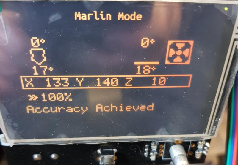

« Reply #27 on: April 18, 2022, 12:20:37 PM »
 :ddb: Now we are talking  :ddb:

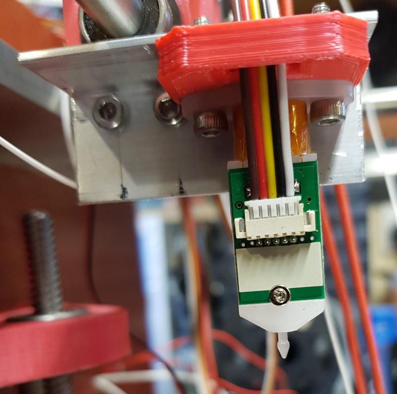

I drew up some stops and they are both working great. The X axis however can only hit the switch after the Y axis has homed so thats been done via the firmware and I hope that doesn't cause any issues in the future but I can only think it will if it skips steps?
The X axis is operated via a sprung bolt carried by the Y axis and I will have to redraw/reprint that side to include a neater hole for it.
The bit I am most pleased about is the 3dtouch probe I thought it was malfunctioning at first because it was always showing triggered which I thought was wrong but it works fine. Even the auto bed levelling is working which was a shock because afterwards I realised I had not set up the 3 steppers in the order shown on the firmware but it didn't matter it sorted itself out.

« Reply #29 on: April 18, 2022, 01:30:34 PM »
Actually scratch the bed leveling bit I switched the screen to marlin mode which told me it was getting worse after 5 tries. you would think the touch screen mode would let you know somehow  :doh:
Shouldn't be too hard to get working properly now its going through the motions though.

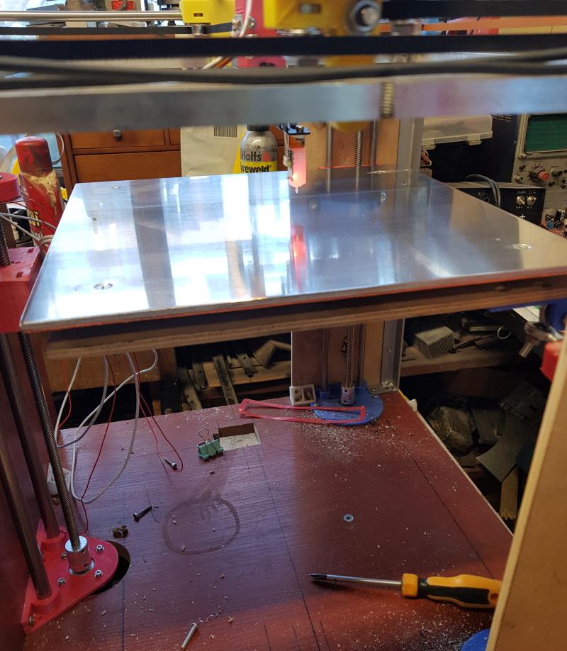

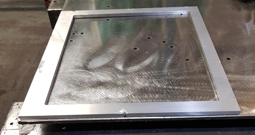

Paid a visit to my local metal suppliers today and got them to cut me some 310x310x4 aluminium and now have the silicon heat pad stuck on and the bed ready for the glass surface.

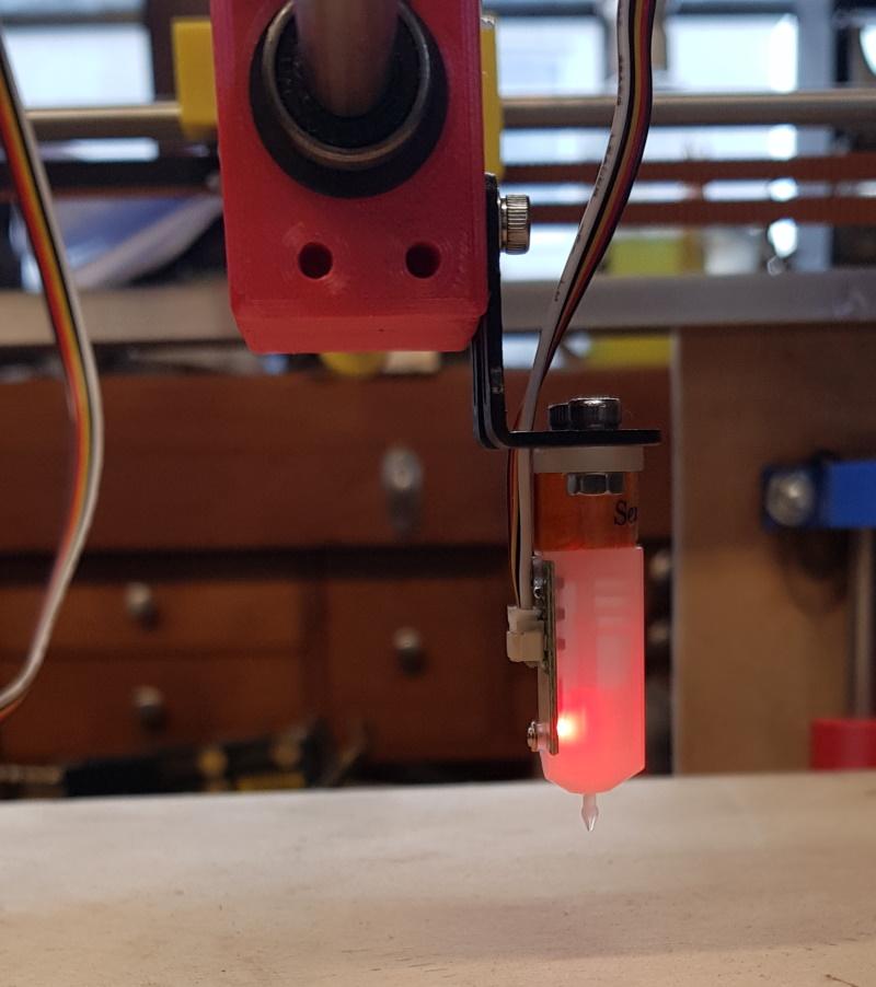

I am now looking at the hotend etc part of the build. I currently have the touch probe and the hotend in position but the cooling for the hotend and the part cooling is going to take some serious thinking. The hotend kit came with a 40mm fan but I think I will change this for a 30mm fan so I can use some really thin sheet to make the mount that will direct the air past the cooling fins and out through the back so it wont interfere with the print too much. I am hoping I can construct something that will be held in place by the two screws that hold the heater block in and the push fitting at the top.

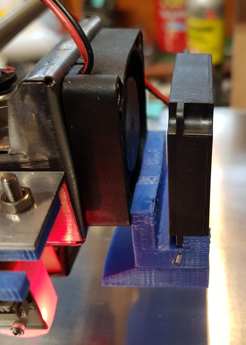

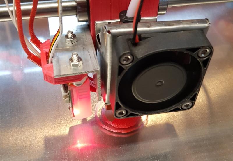

« Reply #33 on: April 30, 2022, 12:34:47 PM »

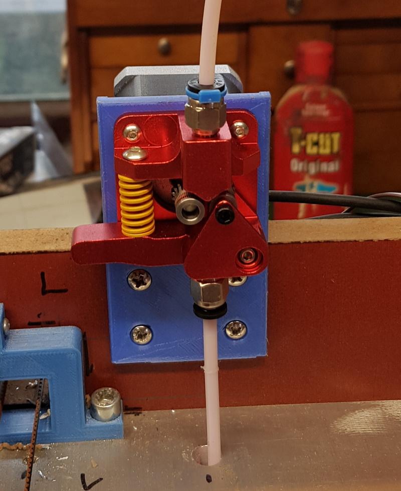

After a bit of amateurish sheet bashing I have a slightly lop sided but functional cooling fan mount. I apologize to any professional tin bashers out there but I did the best I could with the equipment to hand  :lol:

Not finished by any means but I have mounted the extruder (For some reason Marlin ignored the new steps per mm I entered so I had to enter it into the lcd and save it to eeprom) and it has laid down some filament.
I was running out of time because daughter was badgering me to take her home  :wack: so I just looked through my old files and found a trolley token, I am quite pleased with the result you can even see it is supposed to have a trolley on it which is already better than my I3 clone did.
I have to say those TMC2008 stepsticks make it so quiet that the fan seems really loud.

I have started it printing its own parts and first off to get some of the shapes I am going to print I figured it needed a part cooling fan, so I designed a simple one that I actually think with a little modification wont be a bad for a permanent solution. My filament looks like its starting to collect too much moisture so I will have to chuck it in the dryer tomorrow.
Another plus is I am slowly learning the ins and outs of Marlin firmware, Although I may end up with a bald patch from all the head scratching  :lol:
