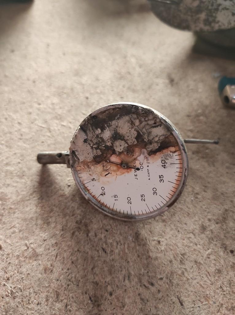

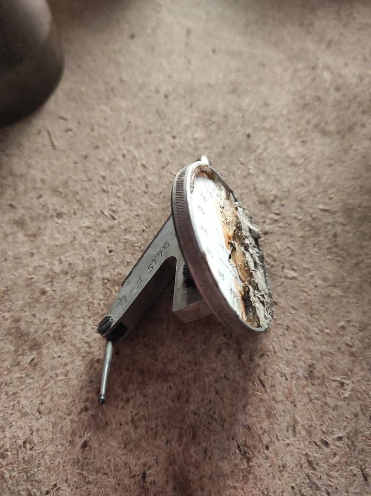

As mentioned in another thread, somewhere else, I recently unearthed an old DTI. It's been stuck in the bottom of a box, in some mystery gunk, for - well, ever as far as I can tell. I've no idea what the gunk is, but it's covering about 1/2 of the dial, looks a bit like un-diluted jelly - it's got a slightly springy but also crystallised texture. It doesn't dissolve in white spirit. Unfortunately, it's jammed the needle, and also covered up the markings that tell me what the scale is, so I don't know if it reads thousandths or tenths...
What I can tell is, it was made by A. Capp & Sons (Andy Capp??), and was inspected on the 9th June 1965.
Anyway, Bob (aka krv3000) has kindly offered to take up the challenge, although he hasn't seen the state of it yet! I think this one will be really tricky to bring back from the dead...
See pics below. I 3D-printed a nice box for it to go in, which will be its permanent home if it is rescuable!

« Reply #10 on: January 07, 2021, 06:59:34 PM »

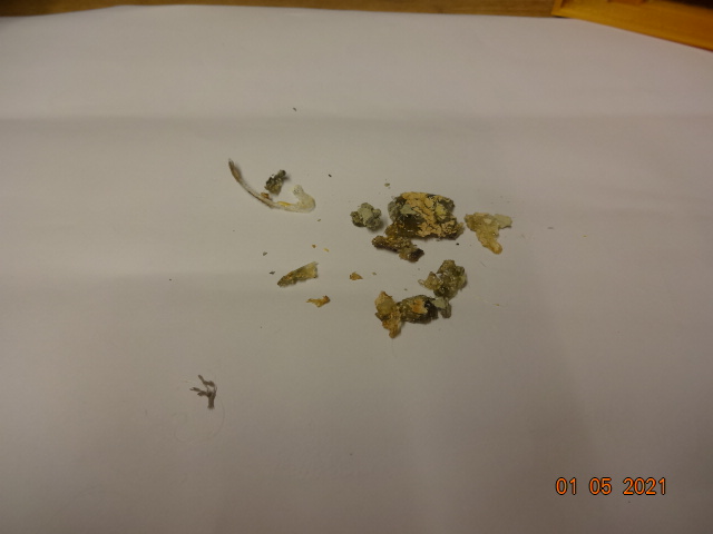

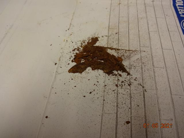

well i no one thing wat was ever stuck to the face has removed part of it  :palm:
  • Posts: 6829
Re: DTI Challenge....
« Reply #11 on: January 07, 2021, 10:40:48 PM »
kinda looked that way....  :(
« Reply #12 on: January 08, 2021, 03:04:21 AM »
Not a big surprise, Bob! Whatever it was, it looked pretty evil...

Holy cow, were they using that DTI to measure the lava lake deflection on Kilauea.  What happened to the glass or is, THAT the glass.
« Reply #14 on: January 08, 2021, 07:03:57 PM »
well i think its the remans of the glass   but its working it lives ones more  :)

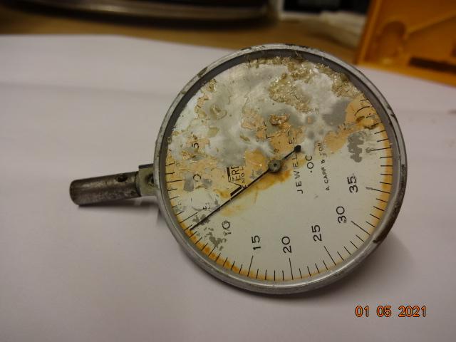

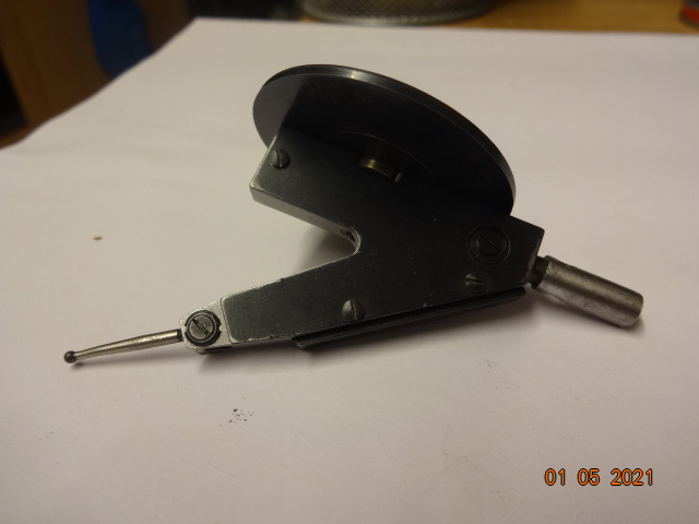

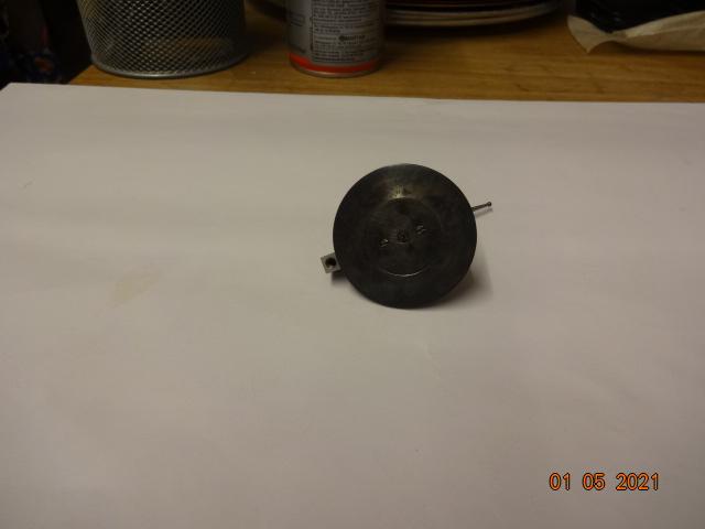

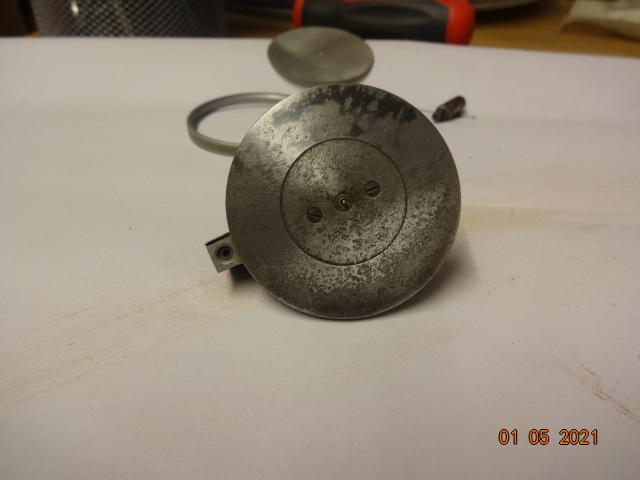

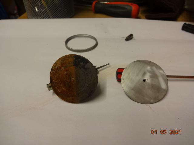

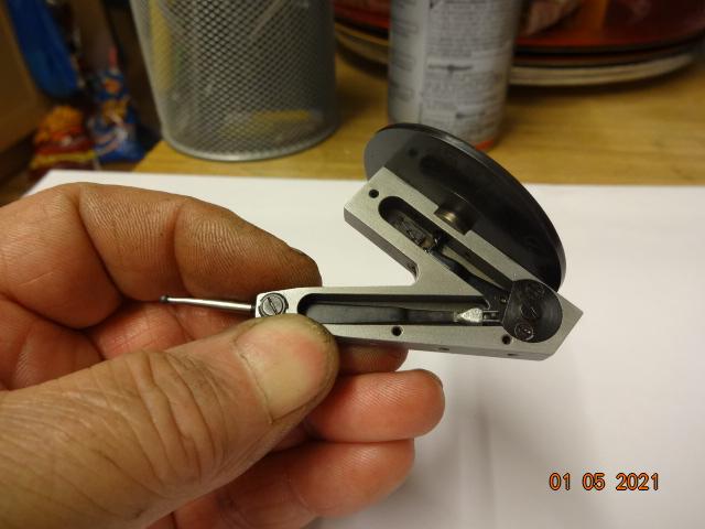

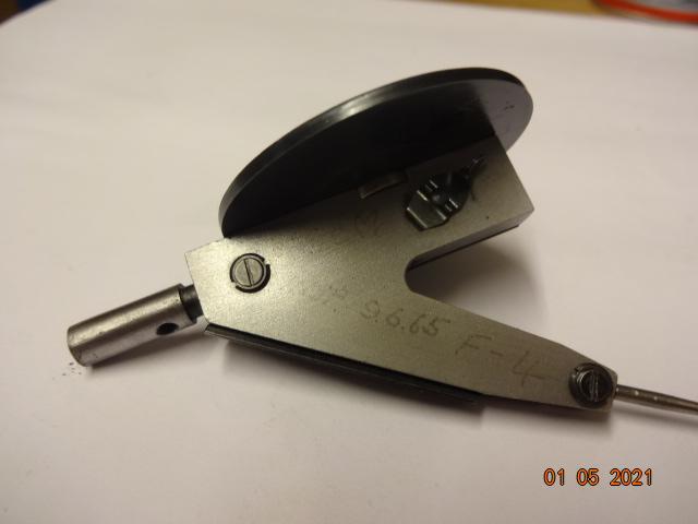

right this D.T.I has bin the worst one I have ever dune I think you will see by the pics that it was a challenge the dawn side is the diel this is one part i can not fix any way pics   [ You are not allowed to view attachments ]    [ You are not allowed to view attachments ]    [ You are not allowed to view attachments ]    [ You are not allowed to view attachments ]
« Reply #17 on: January 09, 2021, 04:11:42 PM »
more pics   [ You are not allowed to view attachments ]    [ You are not allowed to view attachments ]    [ You are not allowed to view attachments ]    [ You are not allowed to view attachments ]    [ You are not allowed to view attachments ]    [ You are not allowed to view attachments ]

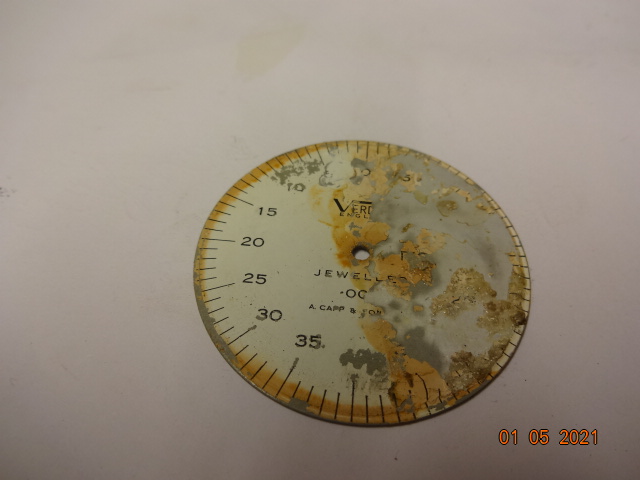

« Reply #21 on: January 10, 2021, 01:15:55 AM »

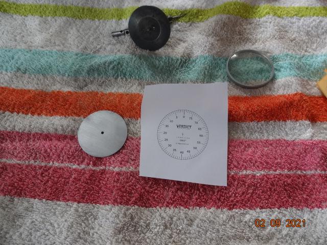

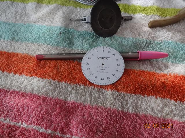

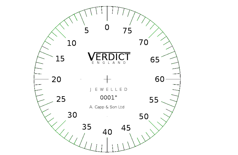

Made this up best I could. The zip contains the full size version. You'll have to scale it to actual size. Hope it helps.
« Last Edit: February 15, 2021, 06:12:06 PM by vtsteam »
  • Posts: 6829
« Reply #22 on: January 10, 2021, 08:30:03 AM »
Bob, if you want I can make a printable scale version (with better resolution) but I would need to know what the actual needed diameter is. Or pdf file version if easier to deal with. I can also make a usable paper or decal version, and mail it to you if wanted. If so, PM me with the mailing address.
Or maybe you have your own Bob-magic solution for the dial.  :beer:
« Reply #23 on: January 10, 2021, 02:53:25 PM »
hi the diel is 48mm across  thanks for the help
  • Posts: 6829
« Reply #24 on: January 10, 2021, 03:21:44 PM »
Okay Bob, here's a pdf file scaled to 48mm.
When you print it (using Acrobat Reader) just make sure that "Fit to page" is turned off, otherwise it will enlarge it. Also it sholud be printed at 100% scale. If you have any problems at all, just let me know and we'll make it work.
« Last Edit: February 15, 2021, 06:12:48 PM by vtsteam »

BTW - Bob, what does that little lever thing do, just under the dial? I've since discovered I also have a Mitutoyo DTI, along with the Tesa I bought ages ago, and neither of them have that feature on them...
There may also be some questions as to how it ended up in that condition.... short answer is, I have no idea! I don't recall buying it, so I must have acquired it in a job lot of other stuff at some point in the past. I only found it when I was moving literally everything in storage (strengthening the shelves with steel under-bars), and happened to glance in the tub it was sat in. There was some kind of oily gunk in the bottom of it, and this indicator... I don't actually recall having ever seen it before, so it's a true mystery how it came to be in my possession.  I'm just really happy to see it brought back from the dead - as Phil said, it would have been so easy to just throw it in the bin... now it gets a second life as a useful indicator once again  :nrocks:
Offline Sea.dog
  • Posts: 235
  • Up Spirits!
« Reply #28 on: January 11, 2021, 04:07:56 AM »
It reverses the direction of operation of the pointer.

One thing I was curious about was that it was 0 to 80 instead of 0 to 100, unless I got that wrong. I couldn't see for sure, but it looked like 40 was at 6 o'clock, so 0-80 is what I drew up. (if I was wrong, just let me know and I'll re-do it).
« Reply #30 on: January 11, 2021, 02:09:03 PM »
Very happy to help -- just plain fun to solve problems -- I think we all feel that way on this forum!
It's one of the things I like best about this forum!
So... I had a look at my Mitutoyo earlier, mainly because it's handy here at my desk, and it's graduated the same way- 0-40-0. However, it's a metric dial... so I wonder if this one might be metric too?
Hang on a tic... I'll go grab the Tesa, which I know is imperial... back in a moment.
Back (phew). So, that's graduated 0 - 4 - 0 (thousandths), with each tick representing a tenth.  I wonder, therefore, if this is actually a 0 - 40 - 0 gauge, each tick being 0.01mm? Unfortunately, there's not enough of the dial left to be sure either way...
Maybe the solution here is to invent a new measure; let's base it on the average size of a gnat's reproductive member.... so graduate the dial 0-4-0, where each tick represents 0.1gc (gnat's cock) - so long as I can achieve an accuracy of "within a gnat's cock", I'll be happy  :D  As a side bonus, then it doesn't matter if it's metric or imperial!
  • Posts: 6829
« Reply #31 on: January 11, 2021, 02:29:29 PM »
Well, Ade, easy enough for me to re-calibrate the dial, unless Bob has already installed the present one.
oops I think I see a "2" on the right about where 25 would be if it was a 0-40-0 --- okay I'll make a new onr for that -- hope it's not too late for Bob -- sorry, should have asked!

Here's an 0-40-0 version in 0001 inches:
« Last Edit: February 15, 2021, 06:13:57 PM by vtsteam »
  • Posts: 6829
« Reply #33 on: January 11, 2021, 03:00:21 PM »
And if you think it's mm then I can change the .0001" legend to 0.01mm. Well, work of a moment, I'll do that now, then you'll have a full selection of dials!
  • Posts: 6829
« Reply #34 on: January 11, 2021, 03:19:35 PM »
Edit -- attachment removed to avoid confusion..
Okay, here's an 0-40-0 with a 0.01mm legend.

hi on you are ok with the diel 40 is at 6 o clock the lil lever as  sea dog says It reverses the direction of operation of the pointer.  I.E with the lever in one place the probe will only move the pointer one way move the lever to the other side the probe will move the pointer in the other direction   will post pics of the diel fitted soon  regards bob

i love it when a plan works out its inch by the way still not printed it off yet  :doh: :doh:

Okay great Bob, inch....that narrows it down.
Bob, can you tell from the old face if it was 0-40-0 or 0-80? Just out of curiosity.....
My guess is 0-40-0..... only because it looked to me like there was part of a "2" on the right side, about where second "25" would be on an 0-40-0.
If it were 0-80 that would be a "5" for the beginning of a "55".
But really hard to tell in the photos.
« Reply #41 on: January 16, 2021, 07:20:17 PM »
hi its a 0 to 40

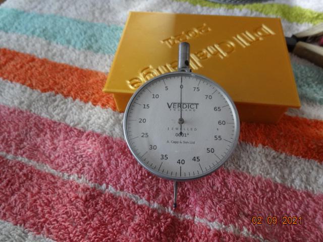

hi all just an update  got sum ink for the printer and printed out the new face for the D.T.I and its brill thanks vtsteam  all bin well will be posting pics tomorrow all back together regards bob
« Reply #46 on: February 14, 2021, 05:05:47 PM »
Hi all you will never gess wats happened :) :) :) :)  its dune  lol i must say sorry for it taking such a time to do  things that i can not control get in the way any way last pics  AdeV it will be in the post tomorrow  [ You are not allowed to view attachments ]    [ You are not allowed to view attachments ]    [ You are not allowed to view attachments ]    [ You are not allowed to view attachments ]
« Reply #47 on: February 14, 2021, 05:22:57 PM »
Absolutely brilliant Bob, great work as usual  :thumbup:
« Reply #48 on: February 14, 2021, 05:31:53 PM »
Nice work Bob. You would never guess it was the same instrument.
  • Posts: 6829
« Reply #49 on: February 14, 2021, 06:16:43 PM »
Oh, so it was an 0 to 80 then! Lucky I took careful aim with a scattergun!
Looks so different than when it started out, Bob, great work!  :bow: :bow: :clap: :clap: :beer:
