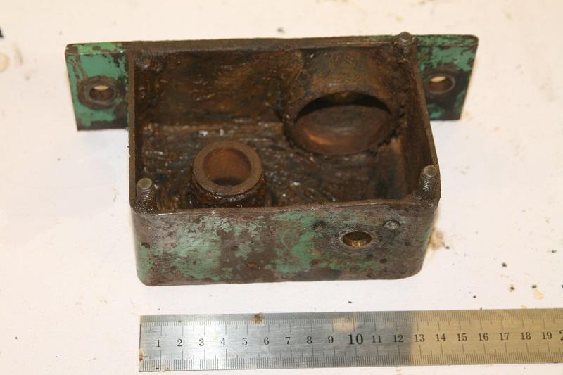

This started out as a Could-You-Just sort of job for one of my neighbours. He mashes up apples to make juice and bottles it.
The apple machine has two bearings, one on either side of a rotating drum. They are sealed ball bearings 47mm diameter x 14mm with a 20mm bore for spindle.
Two new bearing housings are required, which have to be welded to an 8mm thick backplate.
There are no instructions, nor handbook as the machine is so old.
Would anyone have any idea what sort of fit to make the housings to the bearings? I was thinking of a tight push-fit, so that they could be replaced when needed, so housing would need to be ?? diameter.
Just to make it interesting, I cannot fit the bearings to the housings then weld them up as the seals would not like the heat. Not sure if welding would distort the housings either...
Any pointers would be gratefully accepted.

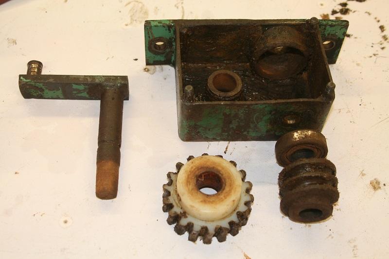

« Reply #7 on: December 22, 2020, 11:21:56 AM »
Thanks to everyone for their thoughts. I may end up having to use loctite to retain the bearings, it all depends on how accurately I make the housings, but that depends on what diameter I should aim for, as stage one.
Having read oodles of technical data from various (bearing) manufacturers, the amount of info is considerable, so I was rather hoping someone may have had a similar job to give an initial diameter to aim for. At present, choices are limited. If slightly too small and welding distorts things a little, it will never rebuild, so trying for a press-fit is beyond reach.
They say a thread is worthless without pics so, here's a some pictures to show the starting point...

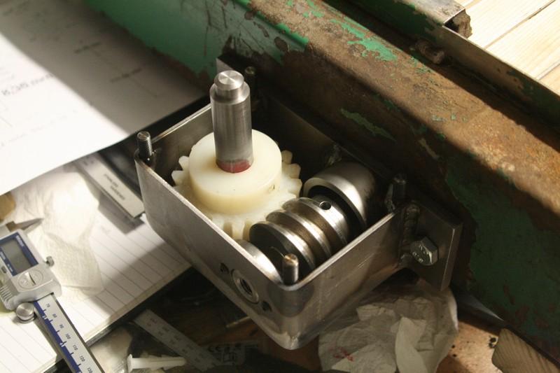

« Reply #11 on: December 22, 2020, 06:13:13 PM »

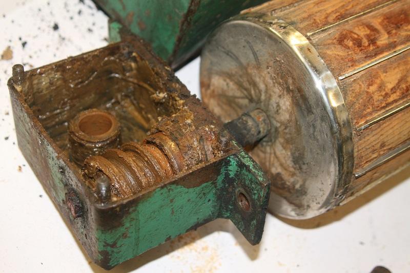

Thanks again for all the comments. The up/down play in the gearbox side bearing was 3 to 5mm. This meant that the plastic gear did not last long at all. The other shorter side was not quite so bad. The visible odd-shaped holes were caused by using the machine with really clapped out bearings, so one of my first difficulties was trying to locate the centres. All in all, I decided to start from square one, hence the question about bearing housings.
This was a slight understatement "It looks like there was a lot of "juice " around turning the grease to mud ?" Sums it up exactly! There is a photo of the contents, but to post would not be in good taste. :)
These pix show the story so far.

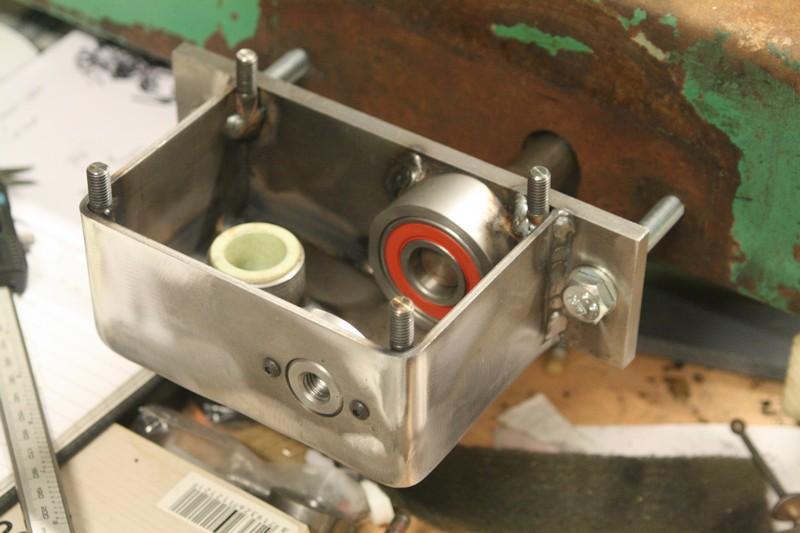

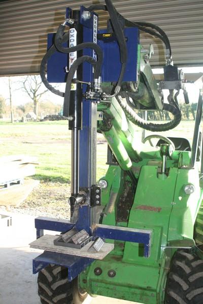

« Reply #12 on: January 26, 2021, 03:24:33 PM »
Bit of an update.

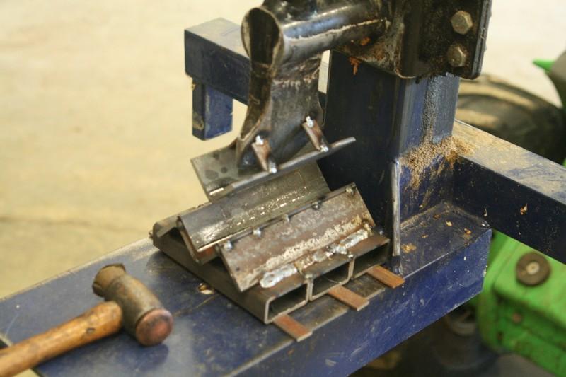

A start was made on the new case. Unfortunately my metal bender had a max capacity of 50mm, but 60mm was needed. The only thing I could find to do the job was the log splitter, so that was 'adapted'. Fortunately both of the bends ended up quite square with almost no twist. (2&3)

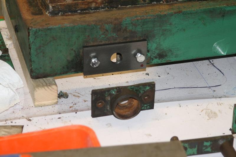

(5) Shows the bearing housing, average of 4 readings on mill DRO showed undersize by 0.001mm. The other size was 0.019mm under. If the latter caused a problem, it would easier to remake that side. Main problem is that I did not want to risk the bearing fits, as they would have to be removed before welding the housings.

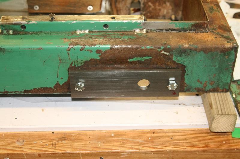

(6) Last dry fit before inserting bearing.
(7) Finally in place.
Still a few parts to sort out before completion.
