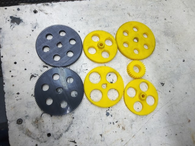

For me FreeCAD 0.18 you can download the free gear workbench
The yellow gears are printed with ABS the black ones are printed with PLA
