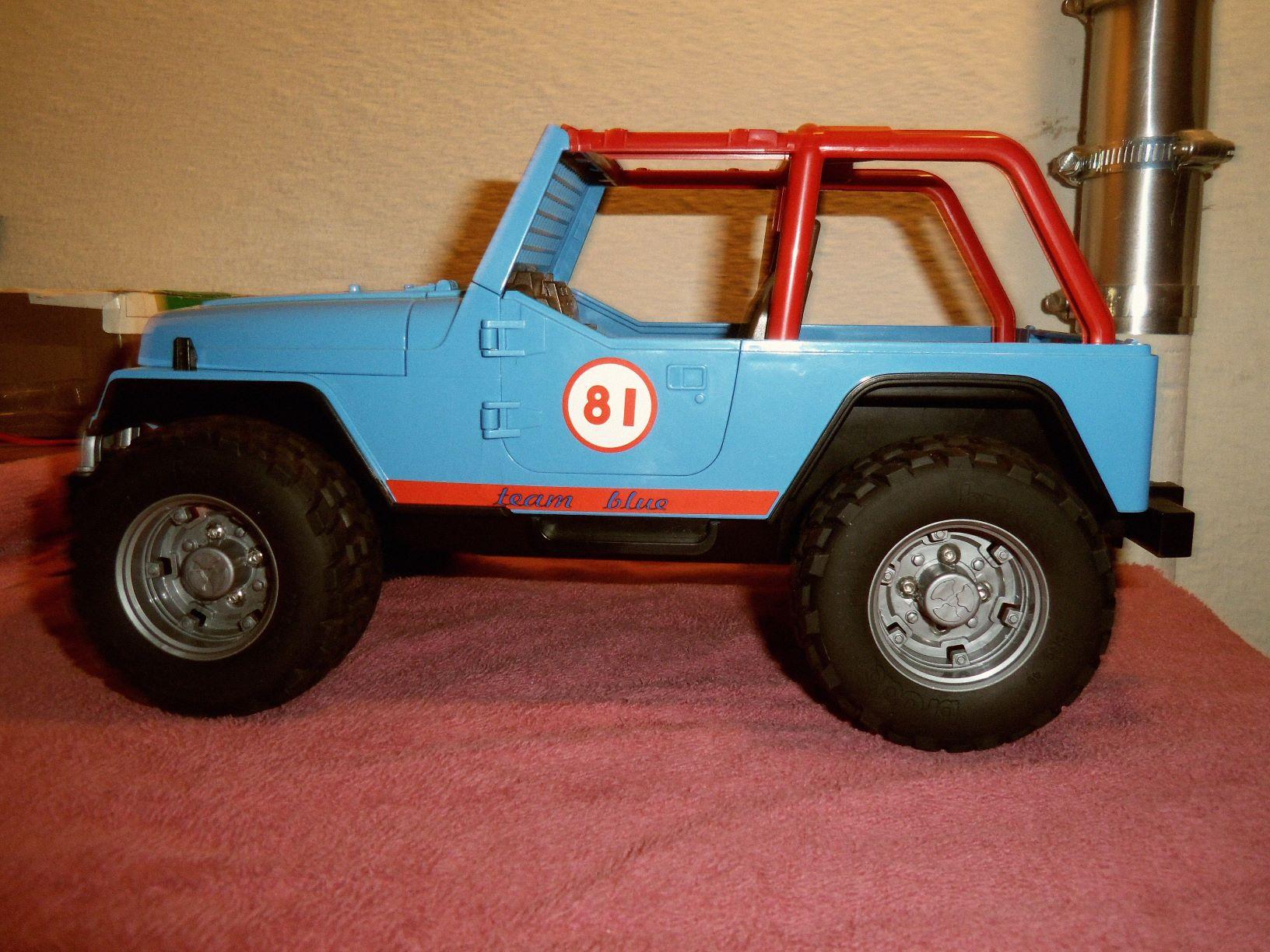

The first attachment is the side view of the Jeep with the body snapped on.  Like I said I couldn't resist once I had a "rolling" chassis.  As you can see it looks almost the same as the standard Bruder Cross-country Jeep.  The only really noticeable difference is that my jeep as 4 M3 button head SS cap screws in each wheel.

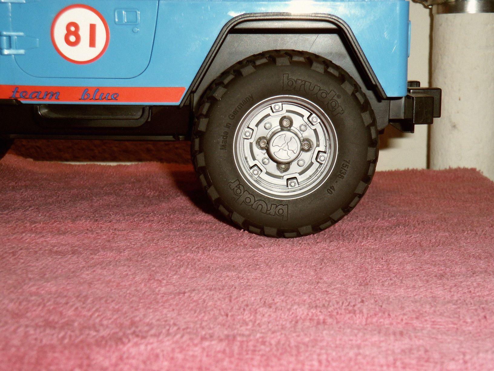

The second attachment is a close up view of the wheel.  The button head cap screws aren't that noticeable, they ALMOST look like lug nuts.  (Well that's my story and I'm sticking to it.)

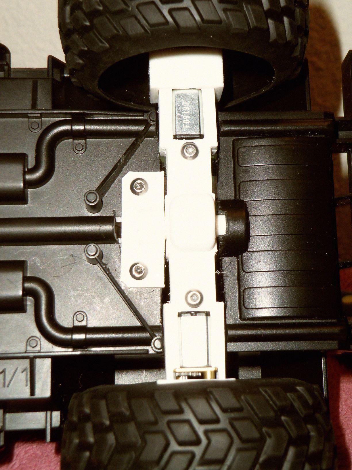

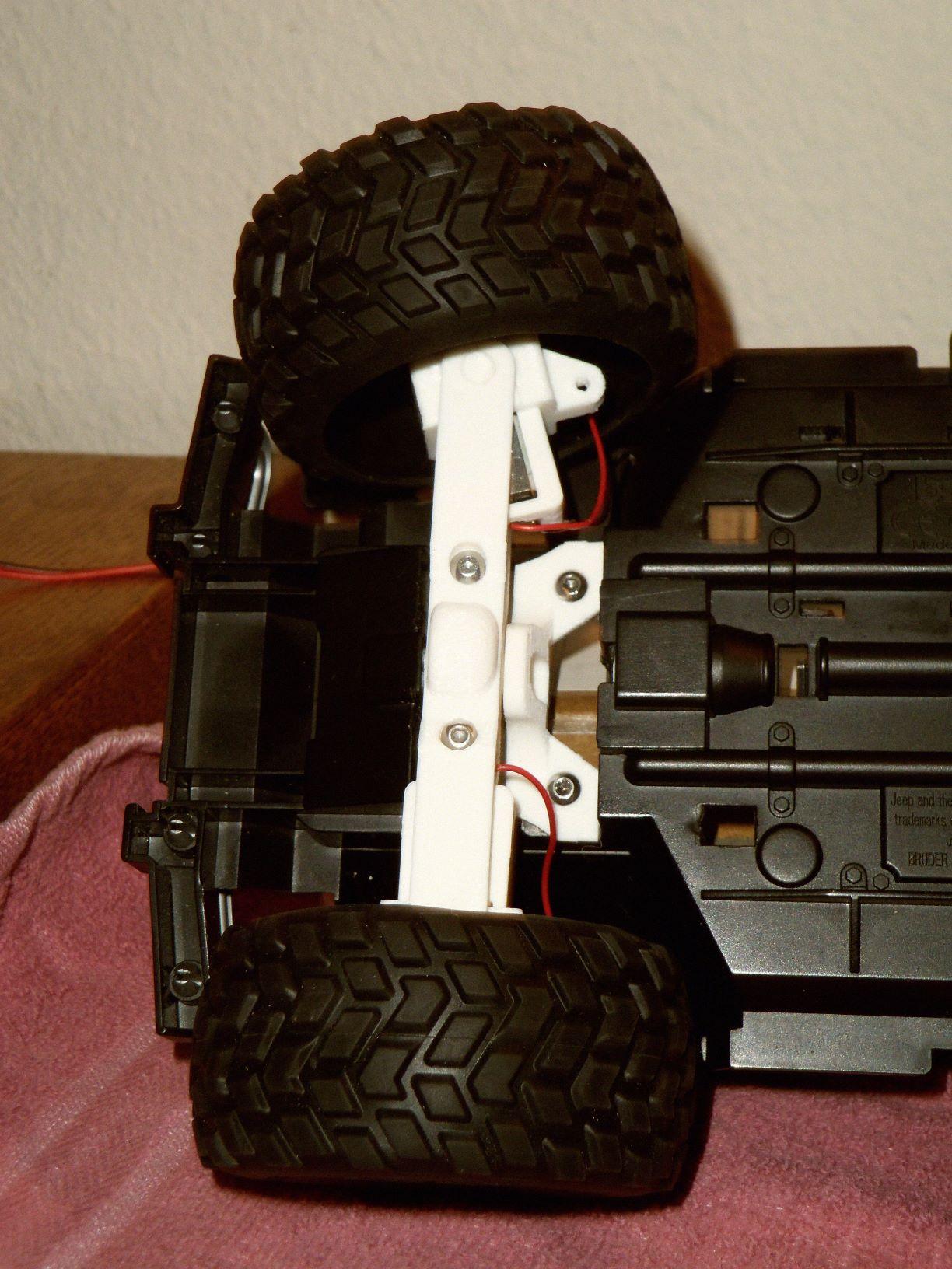

The third attachment is a picture of the underside of the Jeep, showing the front axle and steering arrangement.  I had to move the spring placement inboard from the original location, but the front axle does still articulate.  Everything that's white was 3D printed.  I had a spool of white PLA in the printer and that's good enough for the prototype.  For the Christmas present Jeeps, everything that's 3D printed will be printed in black.  There was a QUITE a bit of surgery required to get room for the 3D printed axle.  The axle isn't much bigger than the original axle, but the original was not designed to allow the wheels to turn, nor to articulate.  It basically just allowed the axle to go up and down a few millimeters.  It didn't really have that much travel either.

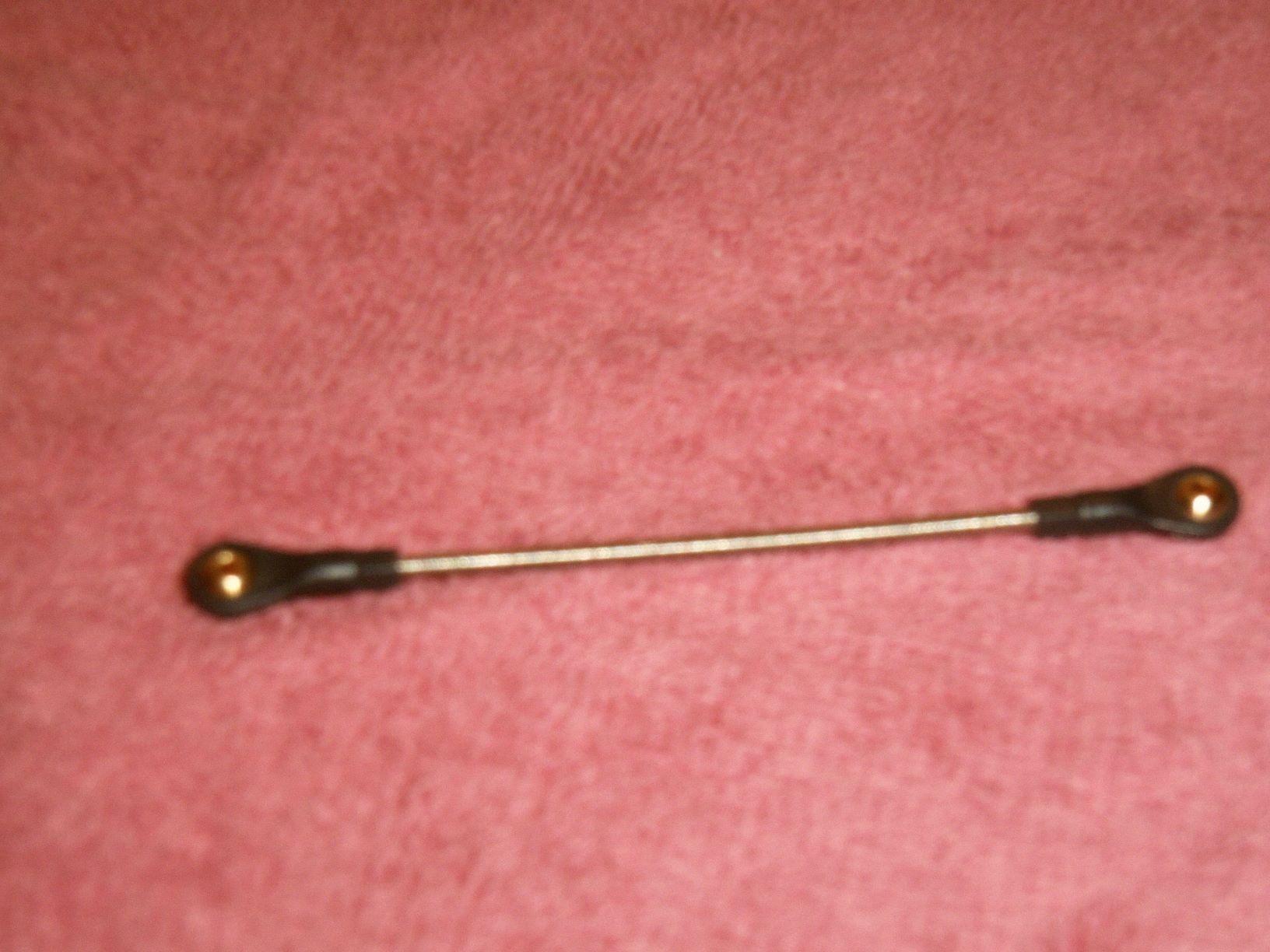

The fourth attachment is a crappy picture of the tie rod.  It turns out it was my ONLY picture of the tie rod so we'll have to live with it.

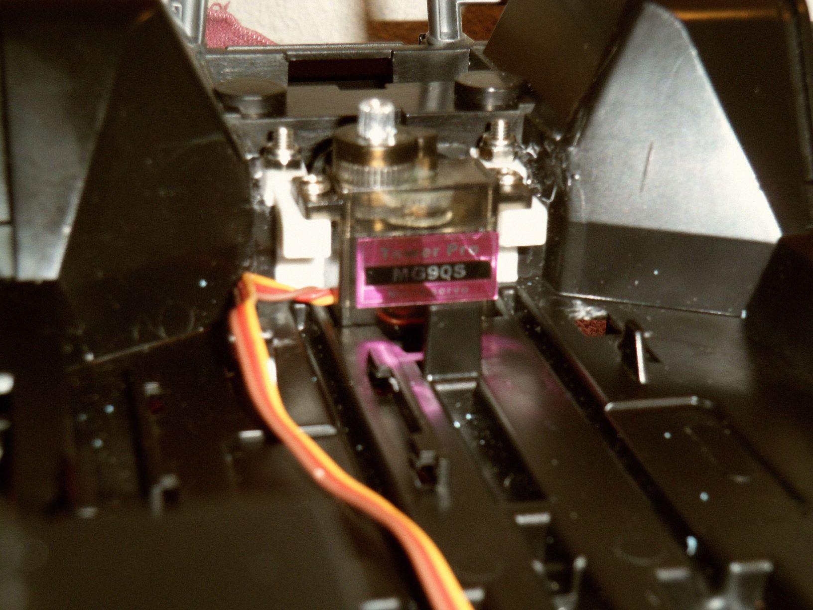

The fifth attachment is another crappy picture, only this time it's of the printed servo mount.
The last attachment is a picture of the rear axle.  Just like the front axle, everything that's white is 3D printed.  Here though I was able to keep the original spring locations.  There was still a fair amount of surgery required to get a decent amount of axle articulation and travel.  Like the front axle the rear axle only moved a couple of millimeters.  I'm not building this to be a rock-crawler, but still, it IS a Jeep!
