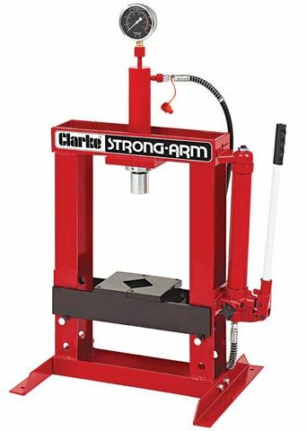

I find myself in need of a hydraulic bench press. Something like this one, from Machine Mart, would do
However, it's £250 and I don't want to spend anything like that much. Plus, I don't have a lot of space, so I'd prefer something a bit more compact.

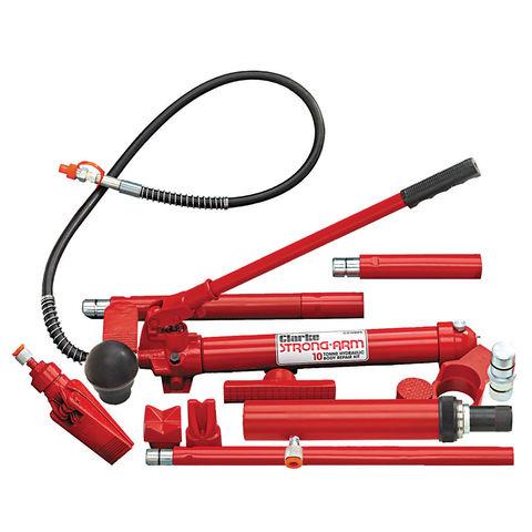

I already have one of their 10 tonne body repair kits:
As far as I can see, the press uses the same ram and pump as the body repair kit, so I have the main bits already, I would just need to fabricate a stand and a means of retaining the ram.

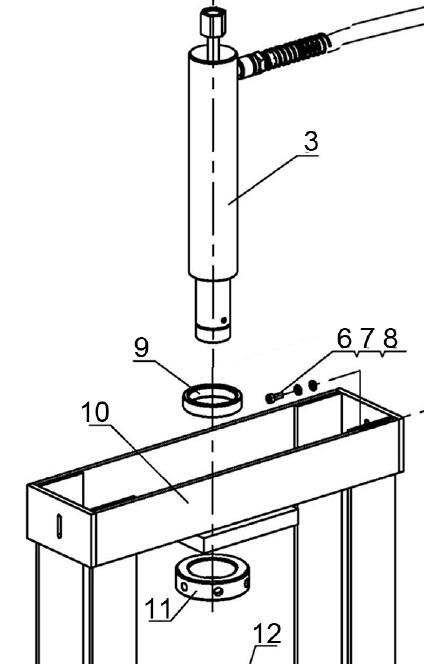

Looking in the Clarke manual for the press, it just has a collar, labelled part 11.
The ram in my body kit has a thread on the cylinder, which I've measured at  2 1/4" diameter with a pitch of 14 TPI
I'm wondering is there's anyone out there who has a Clarke press could measure the thread on the end and let me know it it is indeed the same ram as the one in my kit.
If so, I will just buy part 11 from Clarke's spares department & make the rest myself.

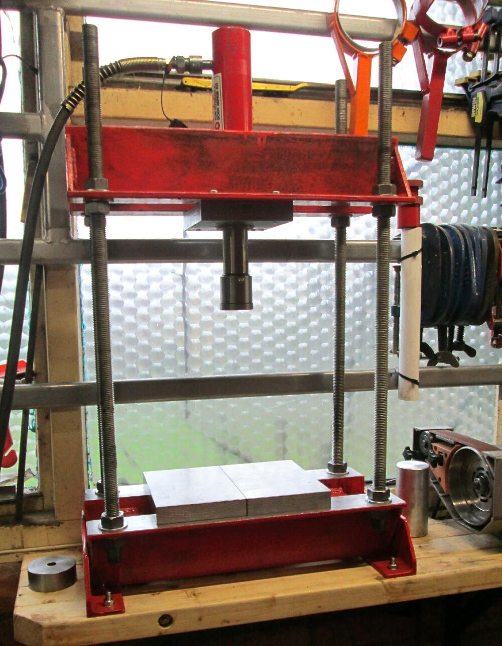

So just to draw this to a conclusion...
Question, can you make a 10 tonne hydraulic press from a cheap porto-power clone ?
Answer,    Yes !
A local engineering firm cut the 2 1/4" x 14TPI thread in the ram mounting plate for me for just £25.
I had to buy the 1" thick blocks of steel, the rest I had lying around.
Total cost £65
(Please overlook the paint, it's still work in progress...)
