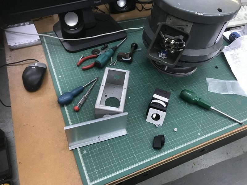

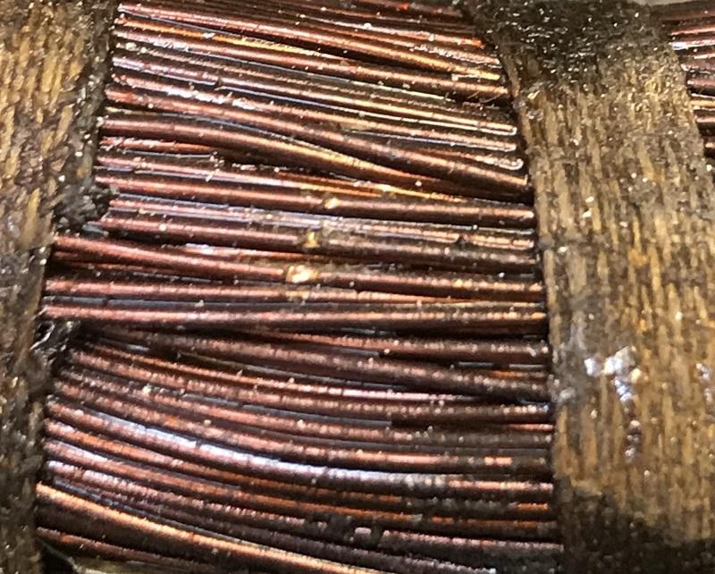

My Bridgeport mill doubles as a drill press, and the other day I was drilling a 10 mm hole in a bit of softwood when there was an almighty bang and flash from the control box  :bugeye:
Oddly the motor will run and not make big bangs in high speed, but gives the same dramatic results in low speed :scratch:
It looks like the control box and contactor have survived but the motor it self is giving me some very odd winding  resistances:
Slow A to B = 55.6 ohms
Slow B to C = 27.8 ohms
Slow C to A = 27.8 ohms
Fast A to B = 13.8 ohms
Fast B to C =  14.3 ohms
Fast C to A - 14.2 ohms

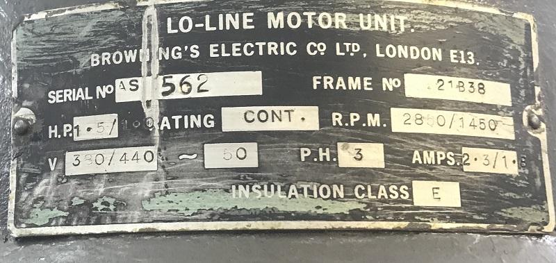

Now as you can gather this is a dual speed motor 2800 / 1450 rpm or there abouts with winding switched by a rotary switch on the side of the motor.
So far I've managed to get it off the machine and onto the bench and opened up the switch cover hoping for loose wires but none to see  :(
When time permits I'll dig deeper into the motor
So if anyone knows where there is a Bridgeport 'Pancake' motor I'm in the market for one !

I make that a switching issue. Going by this thread:
There are six windings in the motor. For low speeds the windings are connected in a series loop with power applied to every other connection. So 440 volts is applied across each pair and the individual windings see 220 volts each. For high speed the windings are connected in parallel pairs. One end of each pair goes to a common point the other end receives power. So each winding sees 220 volts.
You should have four times the resistance in the low speed arrangement as in the high speed. Since only one phase combination has that resistance and the other two are showing half what they should, and given that the high speed readings seem to be appropriate, I'd say that the windings are fine but one winding is shorted when the switch is set to low speed. Can only be within the switch IMO.
Might be completely off-track but that's how it seems to me.

I hope that you are correct Pete, and it was that suspicion that had me take the cover off the switch but I’ve still not got any further into it. String of visitors today as allegedly it my birthday, but I find it hard to believe it’s a year since the last one :bugeye:

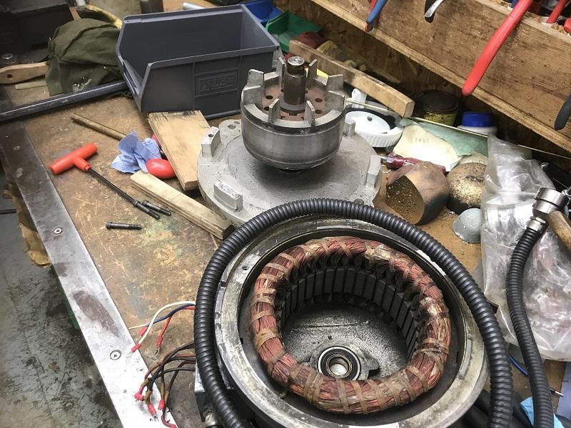

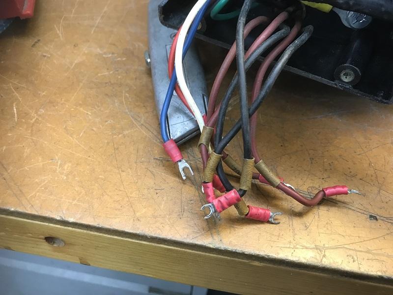

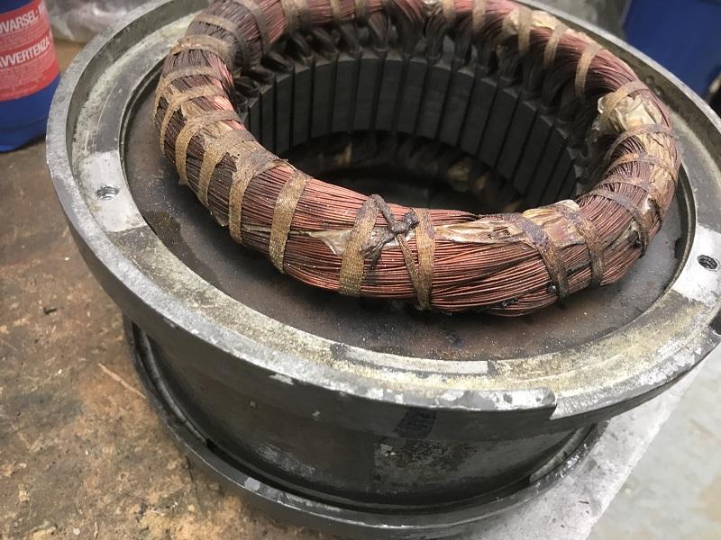

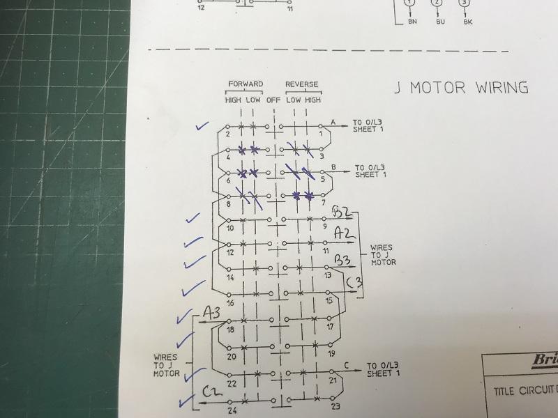

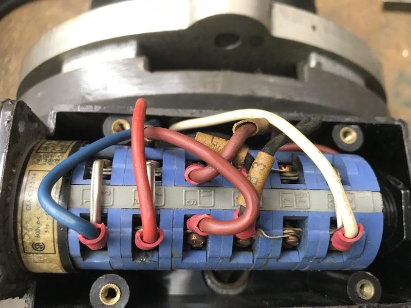

I managed to do a bit more investigation with the motor today. Of course the symptoms changed half way through  :bang:
Six wires on this "Dahlander' pole switching motor that can be switch configured as two pole or four pole with a complicated switch to do the job. I made up a table  matrix of the six wires and wrote down inter-wire resistance values and it soon became obvious that 'C3' was open circuit - it hadn't been.
Then I removed the rotor to closely examine the exposed windings, and found damage to three wires which my ohm meter tells me are connected to C3 - sadly I cannot remove the stator winding to see the other side - it seems to have been pressed into the 'blind' housing and will require something making up to jack it out, and it is on this far side where the wires go to the outside world.
My guess is that something metallic has been ingested shorting those wires which has weakened the  outer connection which has now broken  :(
I have been able to test the complicated switch (5 positions  with 12 poles) against the Bridgeport manual, and it checks out (except it looks as though forward and reverse are exchanged)
Conclusion: I still need a new motor !

If that's the only damage evident I'd repair each of the three wires and meter it. What have you to lose?
  • Posts: 9118
Re: Bridgeport J Head Pancake Motor
« Reply #7 on: September 10, 2020, 04:12:43 PM »
Graham, the three wires are not broken they are still continuous just scalped but C3 is not connected to anything other than these wires - no external connection!
I found a reference on the web to the stator being a light press fit but retained by two grub screws. Seems mine only has one grub screw. (I even chopped off the rivets for the label in case #2 was underneath - but no!)
So by warming the aluminium casing, supporting the windings / stator stampings with my fingers, and using a plastic mallet  tapping the casting I have moved the stator 19 mm in an outwards direction. I had to stop as by this time the stampings had warmed up too much for a temperature differential, but by the morning they should have cooled enough to start again.

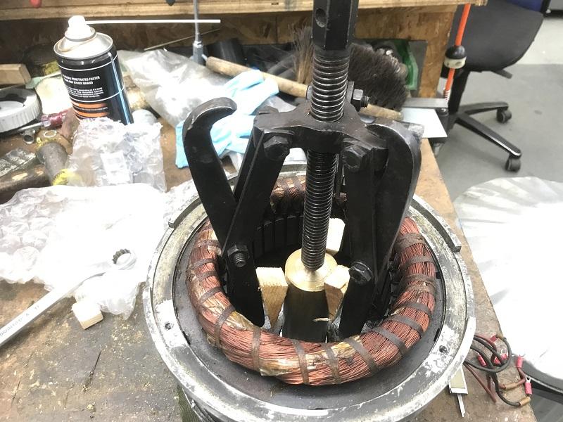

I had another go at trying to remove the motor stator from it's cast blind housing. I'd tried the other day using warming to give differential expansion but it's not easy to not over heat the wiring.
So today I tried with a reverse assembled three leg puller. Now there is VERY little of the stator stampings for the puller to grip, and the claws are awfully close to the windings, so care is needed. Trying to hold the three legs in the correct place AND tighten the puller with my four hands proved impossible, but then I hit on the idea of cutting suitable wooden wedges to hold the legs outwards leaving me a free hand for the spanner.
Eventually I got it in what I considered a safe place and started winding. The result ? Edge of the stampings rounded over and there was NO movement.

Andrew, could you use a hot air gun, or even a torpedo diesel heater with the stator on a weld positioner turntable to keep the heat even, then even heat for say 5 minutes, and then try the extractor again? you will note that I am assuming you have this kit!

Hermetic I can get it evenly warm with a propane torch, but as the stator is in intimate contact it warms also, and rapidly you get to the point where they are much the same temperature!

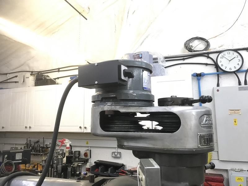

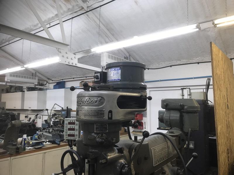

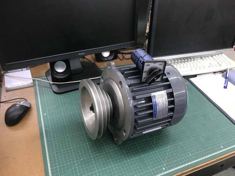

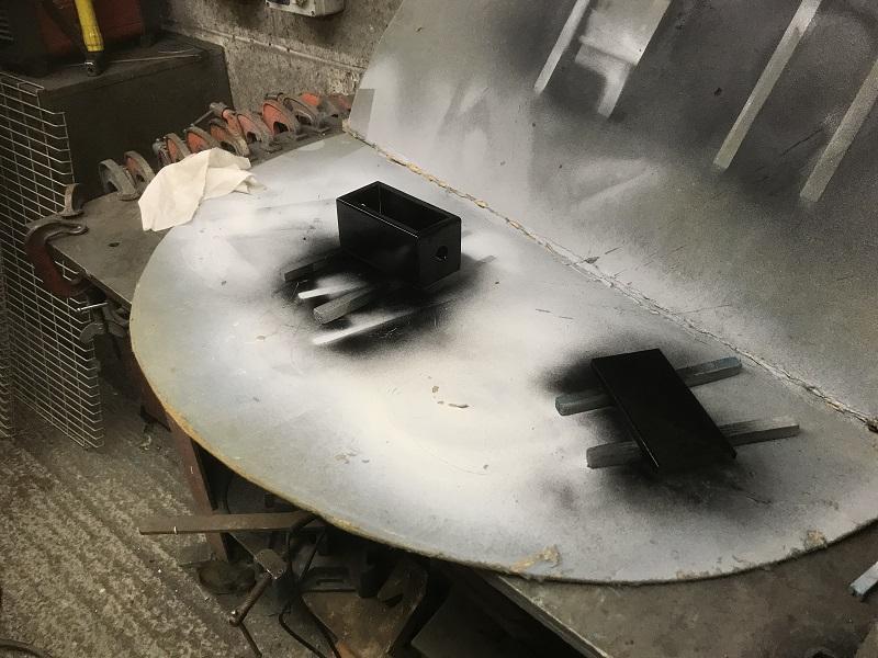

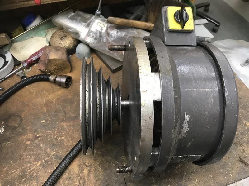

So thanks to Murray I have received a single speed 'Pancake Motor' for my poor old Bridgeport.
It's spindle is 22 mm but my pulley is 19 mm so the first job was to bore it out on the lathe - sorry no pictures.
Then it has a 7 mm key way and my (Imperial) broach set obviously doesn't include 7 mm so the next job was to file up a 7 mm key and grind a shaping cutter to fit in a boring bar to shape a suitable key way in the pulley using the lathe and manual long feed - again sorry no pictures.
Then my Bridgeport mounts the motor on two 1/2" UNC studs, one as a pivot and the second in a slot for belt tightening, so having first offered up the front plate of my original to the mounting holes on Murray's motor (which are plain 10 mm holes) to check absolutely that they have the same mounting centres I drilled and tapped them out to 1/2" UNC to fit my studs - I then placed the motor on the machine to prove all fits - it does!

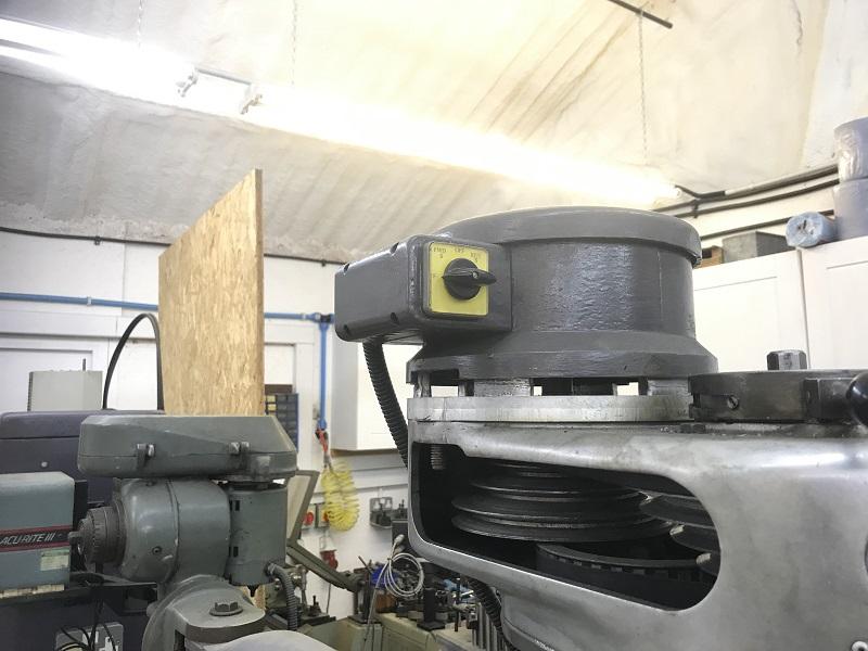

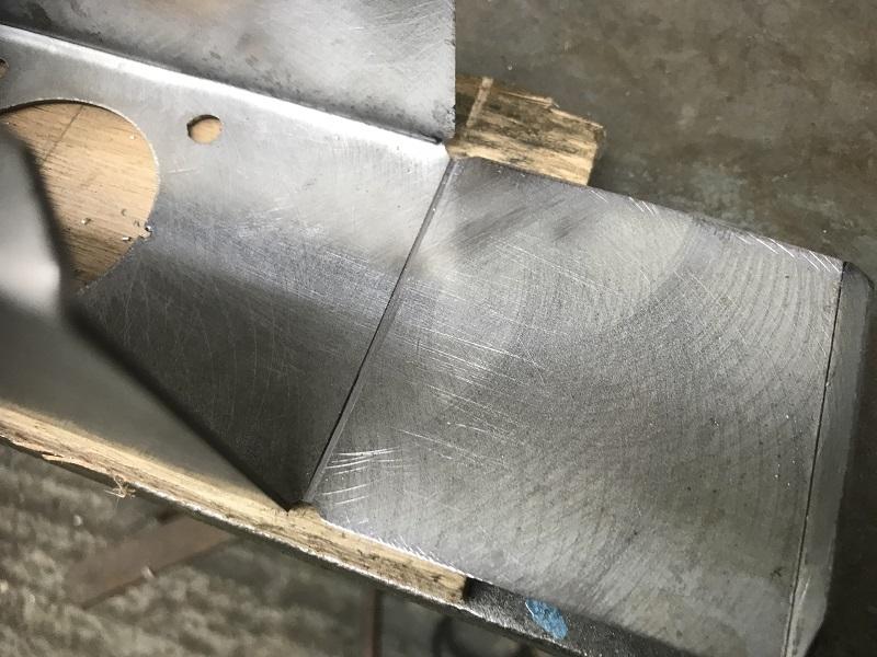

OK now I need to sort out the electrics - my original motor had a housing for a 5 way switch (fast fwd/slow fwd /off slow rev / fast rev) - this one just has a pressed terminal box - the switch must have been elsewhere on the machine and only sadly needs to be three way being single speed.

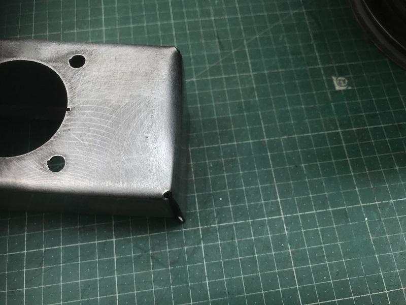

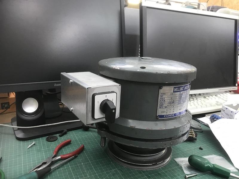

RSComponents provided a suitable three phase reversing switch and I drew up a suitable box to house the new switch and replace the terminal box. Cutting it out on the Plasma Cutter proved a bit of a pain - I've still not got it fully configured since my Windows 7 debacle - but at last I ended up with a 'flat box' just needing bending.

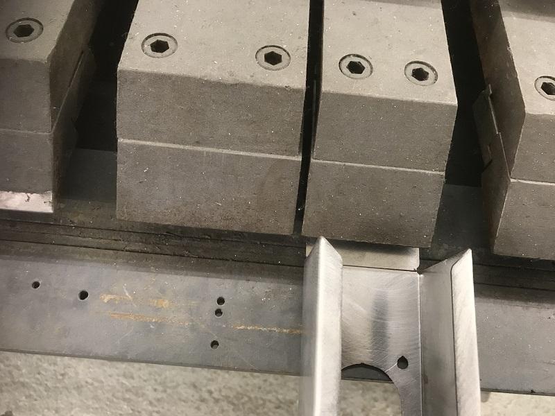

Like a twit I failed to realise that my narrowest finger on my folder was wider than the narrow dimension of my box - no problem if you bend the narrow bit first, but if you don't . . . . .  :bang:
As an attempt to recover the situation I tried sawing a 'bend here' cut but rather as I expected the result wasn't acceptable. Never mind - cut another 'flat box' on the CNC plasma and do it right this time - which I did  :ddb:
OK Box and lid bent up, all the right  holes drilled for mounting it on the motor, and to take the switch and the 20 mm entry grommet - time for a trial assembly. It all fits but the wiring is going to be a bit tight but should work oOK.
I've dis-assembled it for painting - (tasteful shade of satin black) and will try and fit it all together tomorrow.

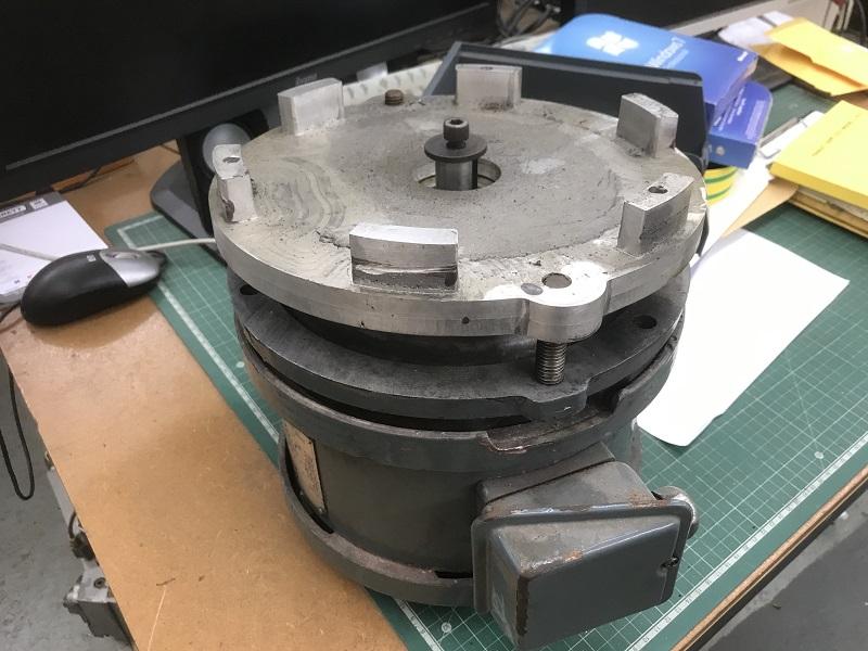

John so far it’s resisted all my efforts to pull the stator from the casting. The fault is probably on this inaccessible side of the stator (upper in use) as apart from those three turns that have scrapes the lower side looks good.
Interestingly the single speed motor has a removable top cover so the stator could be driven out, but the two speed is a single aluminium casting (different makers)

Must say, I like the idea of a CNC plasma cutter. What did you use to create the sheet metal design?
Yes, I assumed yours would also have a removable top cover. Would have made stator removal easier (possible?).

Murray the box was drawn in an old version of Autocad, exported as a .DXF to Sheetcam where the G-Code was generated and the CNC plasma table  runs Mach3 driving the steppers - described here:

Just a thought Andrew, might it be possible to create a top cover?
Perhaps some careful machining would remove enough to enable pressing from the other side and then a fabricated cover to finish the modification.

John, when I have the Bridgeport back running with Murray’s motor I can bore some strategically placed holes to drive the stator out, but I don’t fancy drilling them with a Black and Decker!

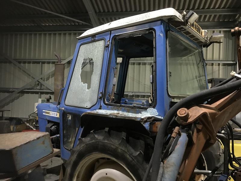

However every cloud has a silver lining they say - I then had time to finish fitting the Bridgeport single speed motor - hooray I have a working mill back - thanks Murray.
I'd just finished putting the tractor away and what should turn up but a dual speed Bridgeport motor complete with pulley and switch - brand new - not free but I hadn't actually expected it to materialise. Seems these motors are like No 11 buses - none for ages then two turn up !
« Last Edit: September 23, 2020, 11:26:19 AM by awemawson »
  • Posts: 858
« Reply #30 on: October 17, 2020, 01:55:17 PM »
Go with the poly carbonate!! read a scary story about a guy who was hit in the chest by a small fragment of rusty fence wire, and didn't know why he had chest pains and went to hospital with a suspected heart attack, and it showed up on an xray. Didnt even know anything had penetrated his body. Problem is there is no easy way to put a guard on them without blocking the view of what yer doin! Be safe out there ppl!
