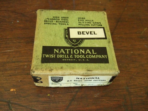

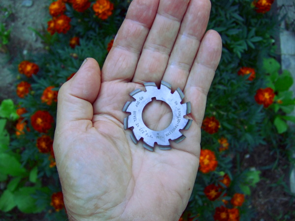

Re: Bevel Gear Mill
« Reply #26 on: August 23, 2020, 02:01:34 PM »
Nope Matt, I haven't. Very interesting, and that must be the Model Engineer/metal tape reference made earlier. I wonder if the same idea could be applied to a fly cutter on a horizontal mill (or on a lathe with boring table)?

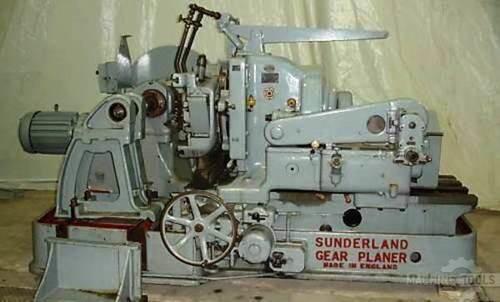

...I wonder if the same idea could be applied to a fly cutter on a horizontal mill (or on a lathe with boring table)?
Yes it can. It is just a means of getting co-ordinated linear and rotational motion. It is no different in concept to using gears from the mill leadscrew to drive a dividing head for helical milling. Does the same thing without the gears.
As to the machine, have a good sniff around the internet archive for gear-cutting books. There are many old ones now online and being in US, you have better access to Google books than we do.
The classic bevel gear people are Gleason and Bilgram. You can find all their patents online and you can probably find operation manuals for some actual machines at vintagemachinery.org .
You can get some good leads if you put 'bevel gear planer' and 'bevel gear shaper' into Google and look at images. E.g.
https://www.homemodelenginemachinist.com/threads/bilgram-bevel-gear-generator.9042/
https://www.practicalmachinist.com/vb/antique-machinery-and-history/bilgram-bevel-gear-attachment-342628/
See also:
http://vintagemachinery.org/mfgindex/detail.aspx?id=2969&tab=7 (mentions Woodbury's  book - well worth reading)
http://blacksmithandmachineshop.com/a-My-Foot-Hand-treadle-powered-Machines-in-My-Shop-Collection.html (Brown & Sharpe #13H extract from American Machinist)

I always fancied a 'Sunderland Gear Planer' but I'd have to reinforce the foundations and widen the farm gate  :clap:

Look what came in the mail today! A brand new, in ancient metal cornered unopened box, still factory taped closed, inside Cosmolined, and anti-rust paper wrapped, National #5 20P bevel gear mill w/7/8" arbor hole.
I believe (not absolutely sure) that this will cut bevel gears in the size range and tooth count I'm interested in. Which is about an inch dia 16 tooth, more or less.
Even if it doesn't, it was way cool to just crack that box open for the first time after who knows how many years since manufactured! The first person to look inside and unwrap that little treasure! Fun.....!  :ddb:

Well don't tease us man - open the box and SHOW us  :clap:

OPEN THE DAM BOX ALREADY!  :D Ebay find?
