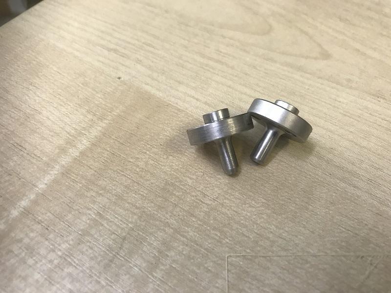

Now while I was rebuilding the machine I'd had the opportunity to rob a Model L as it was being scrapped - a very similar machine but this particular one was equipped with 'Vee Guides' - no holes, just a sharp Vee shape into which the wire falls held by tension - a slightly less accurate method but VASTLY easier to thread !
Why did I never fit them :scratch: Well both machines had been heavily modified over the years and the method of fitting the guides was qite different between them, and the Vee guides were missing all the plumbing for the ionised water electrolyte. Perhaps I should explain, not only does the guide assembly (upper and lower incidentally) have to hold the wire in a precise location, it has  to convey the cutting current to the wire, and direct a jet of water along the wire to stop it melting and flush out cutting debris.
Now the current is applied to the wire by it sliding over a polished tungsten carbide stationary roller - relatively easy to engineer. The water is slightly more complicated as the water guide has to be able to open and close to admit the wire when threading. The original (missing) parts are complicated mouldings - but HEY - I HAVE A 3D PRINTER !
Now having had this thought I then could not find where the heck I'd put the Vee guides - I searched high and low, and it wasn't until someone wanted a TG100 collet from me that I went searching in my container and found a mystery ammunition box - and guess what was inside  :ddb:
So, over the next few weeks I plan to try and come up with a design that allows me to relatively easily swap between the two type of guide, and hopefully get it working.

Well the good news is that it seems that the mechanical mounting for the Upper Vee Guide is identical to the existing Ruby guide.  So it looks like just a bit of re-jigging of the water and electrical connections will sort that when I've 3D printed the rest of the jet.
For the Lower Vee Guide it's a bit more complicated, but I've found one small bit of stainless that forms half of the water jet for the lower head. If you read the rebuild thread you may recall I had to totally re-make the mounting as the original had largely dissolved away in the de-ionised water over the years. Now the good news is that I reused the blue insulating machinable ceramic spacer that it all sits on so hopefully mounting holes will be the same - with a bit of luck I can once more re-make this mount ensuring that it is compatible with the Vee mount, and much of the objective will have been achieved. It will still need the rest of its water system 3D printed but it should be possible.

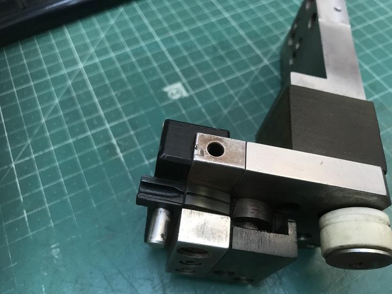

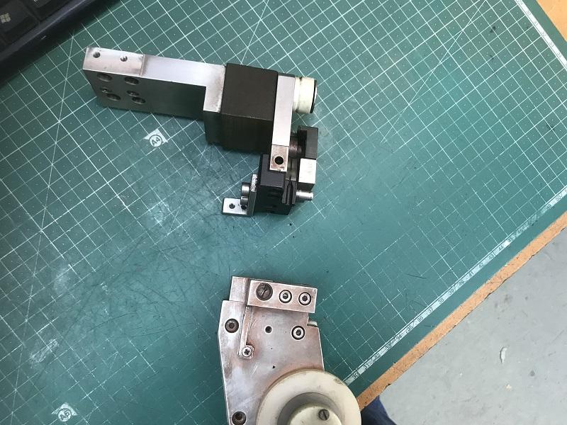

So today's job was (theoretically) unbolt the original diamond guides and bolt on the Vee guides in their place. But as we all know there is always at least one GOTCHA in the way.
Firstly not having previously stripped out the mounting plate for the lower guide, as it's mounting 'looked' the same I had ASSUMED that it was - wrong - different hole spacing. Also to gain the full advantage of the Vee guide over the hole type it needs to project out into free space rather than be mounted on a plate with a hole (or you still have to thread the wire though an (admittedly much bigger) hole. Time for a re-design. Initially I'd thought order up some stainless and start machining but then sense prevailed and I've drawn it up in Fusion 360 with a prototype printing as I speak.

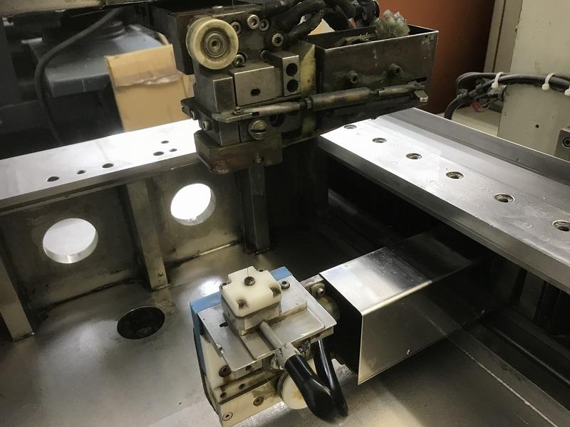

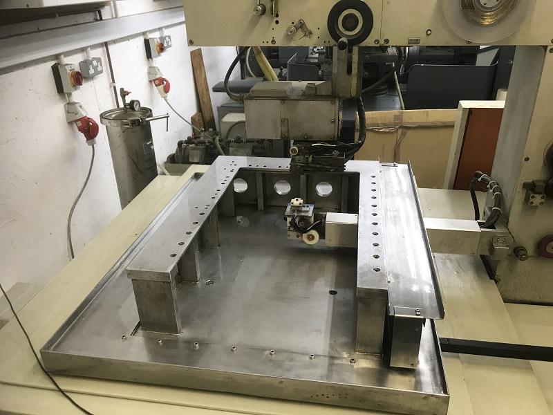

Removing the upper guide assembly was just a case of removing four bolts along with the water feed and electrical connections. It is surrounded by two stainless steel splash guards that keep the upper 'U&V' servo drives dry - they were FILTHY !

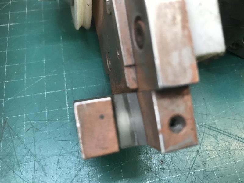

Mounted on this assembly is the redundant 'wire cutter'. When made this machine had automatic threading of the wire (sheer luxury) but it was so unreliable it was removed apart from the cutter.
Had enough today - back tomorrow for more fun.

Today I hot pressed the M4 screw sockets into the 99% solid PetG 3D printed guide mount using a soldering iron, and then went ahead and mounted up the new Vee guide assemblies.
Doing a trial threading of the wire it was very obvious that the wire was not vertical - heart sinking moment  :bang: But  then I thought - hang on the upper mount can be controlled to set the wire to the angle you want - is in the range of movement - yes very easily. I set it vertical to my eye with very minimal movement of the U and V slides (X & Y axis for the top of the wire). So one of my measurements of the lower mounting block is obviously slightly out, but it looks like not worth re-printing as it can be adjusted out.
So once I'd wired up the contact blocks  (upper and lower) and made a couple of plumbing connectors for the de-ionised water I gave it a 'powered up' run and nothing went bang  :ddb:
Now I need to read up on using the verticallity jig to re-set the wire dead nuts on (theoretically simple - the jig has upper and lower neons that light up when the wire touches them - I've done it before but its a good ten years ago.
