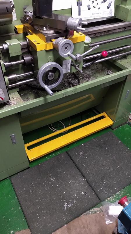

I'm currently painting the floor of my garage....( it just about passes for a workshop :lol: )
Once complete, I think I'll have some form of covering in front of my lathe/mill where I stand when working...,p
So what is the usual stuff to put on the floor?
I'm not expecting to spend like 8 hours a day but would like something that will prevent fatigue..
What do you have on your floor ? Is it comfortable while stood in front of your machine?

OSB3 (the damp proof version) screwed down on 18 " centres, then painted with garage floor paint

Rubber mat with big holes in it works well in my shop.

Recycled crumb rubber matting squares, they can be kicked about between machines or propped up against the wall.  I used to do upto 6hrs straight working on them, even more comfy with a pair of old Doc Martins.

Like Welding Rod I use rubber mats with big holes in it. Swarf goes down the holes so doesn't get embedded in the soles of your shoes. I bought three from Aldi earlier in the year. If they get them in again I'll buy some more. It's made such an improvement over standing on a concrete floor.

Wooden decking tiles, 45cm square. Often, on offer at various diy's.....  :thumbup:

I use cheap interlocking rubber / foam plastic matting meant for kids play area. I got them from a place called Clark Rubber here in OZ. Clark Rubber deal with many different types / forms of foam plastic and rubber. Swimming pool hosing etc which also works to extend the vac hose with easily made couplers to suit.
I find these mats really good plus I can toss em outside and sweep up.    Well, occasionally sweep when the swarf around the edges gets annoying.
Mostly I do a quick run over with the shop vac after I vac the lathe or mill beds before I leave the playpen for the day. Gives me a clear field to create more mess next time.   :mmr:
Incidentally, I use a simple cyclonic separator in the vac hose line and very little swarf actually gets into the vac bag.
