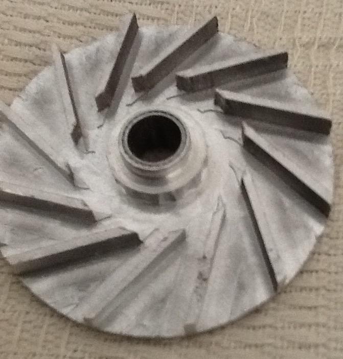

I've probably mentioned before on these pages about Stanley Bridges drills, that I've collected and refurbished over the years...
As part of the process, the cooling fan removal is part of it and they are usually destroyed in the process...
I attempted to make ine out of aluminium bar, but it was too labour/machine intensive....cost me at least two 2mm milling cutters...for one!
So I went to cold molding, a silicone mold cast from an original, to cast, in resin, new fans.I made several but never used them after deciding the hardened resin eas too brittle/fragile...

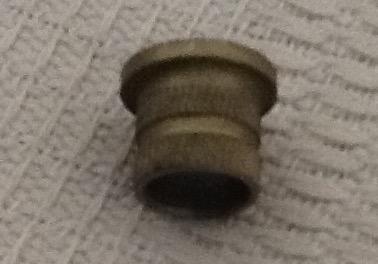

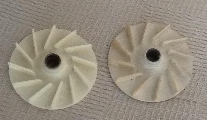

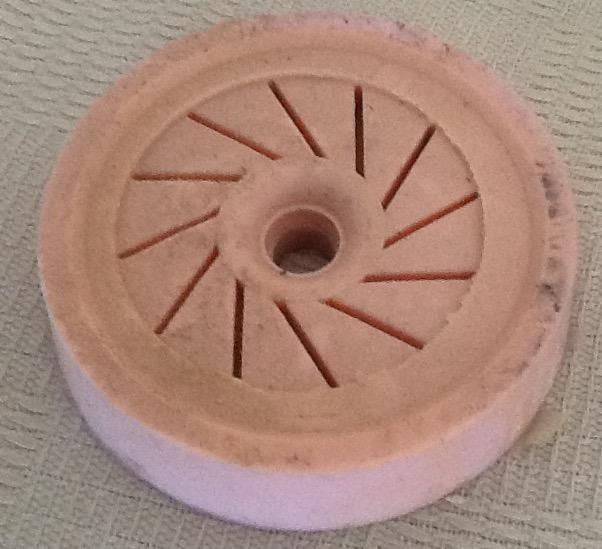

« Reply #13 on: July 31, 2020, 04:38:03 AM »
As requested....
So the first is the silicone mold used to mold the new resin fan, next is the steel bush insert, this sits in the centre of the mold and has the resin cast around it, it then strengthens the centre of the fan.
Next is an aluminium fan machined from solid....finally, two fans, the one on the left is the cast version, the right one is an original

« Reply #16 on: July 31, 2020, 01:46:53 PM »
I would take your master part, smooth some wax into all the blade base corners to get a radius in there, and re-do the mould.  Then cut some small pieces of paper and fold them so that the go to the end of each blade and turn the corner into the disc.  Lay down a fiberglass doughnut and your core.  Pour in low viscosity resin!
Or, with slow resin, dip each paper bit before slotting it in.
The various fiber bits will provide a lot of reinforcement.
You might balance and spin test them in a steel pipe before final installation.
