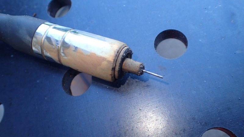

Got MIG/MAG welder, trying to use it for gasless flux-core welding.
The machine I got is Lincoln Speedtec 200C, 200A nominal amp Mig welder with torch Euro-connector.
I am using now 0,8 mm flux core wire with a standard SB-15 Parweld torch.
Main problem is visibility, the standard mig-torch nozzle is pretty restrictive, it comes very close to pudle. Free wire length should be about 12-15 mm and current bit over 100A. The standard mig gas nozzle goes way longer than conductor nozzle (as is customary). I have cut down the standard conical gas nozzle, but it does not quite solve the problem, merely chops of the cone and leaves the large diameter sleeve to block the view. Shortening it furher would lead to better visibility and surprice if you bump the conductor nozzle into metal while trigger is pressed... :zap:
There are nozzle covers that are designed to do just that, some sort of rubber condom looking thingys, but not for my torch or torches here.

As you know innards of the MIG-gun are energized when trigger is pulled (cheap ones are always hot) and you don't want to poke the contact tip into part you are welding.
Therefore there is a gas nozzle in mig welding, it protrudes to cover the contact tip cpmpletely. There is no need to gas nozzle when doing gassless flux core welding (FCAW-S), but it would be really nice to see the small puddle or least the part you are welding (the gun is dragged and fairly perpendicular to work), therefore the flux core nozzle or thread protector would be a nice idea.

One evening I got extra hour of garage time and parted of the cone from standard gas nozzle. Worked fine, but pretty much debris found it's way inside the nozzle cavity. I am thinking of using eventually gas shield and therefore that part must be protected. Bought cheap rubber gas hose one metre. 8mm ID sits perfectly and seals importat parts. I don't think that rubber will last that long, but experimental 15 mm piece has lasted few metres of flux core wire welding.
Works pretty well. I am surpriced.
I was trying to source a some silicone tubing that would fit over nozzle thread and use that only, but local shop had only 5 mm ID tube and threaded part is nearly 12 mm. That might give even better visibility, but at the cost of cooling.
