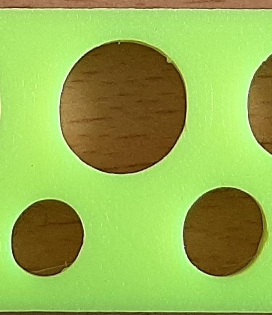

Ender 3 pro oval hole problem
I'm struggling with this. The holes I make are ovalled and diagonally offset  - see picture. Internet help seems pretty useless as the advice boils down to tighten the belts or square the frame - neither of which are applicable. A
The printer frame is square and the xyz dimensions calibrated. If I print a square it comes out square with equal dimensions across the diagonals, and the desired size within 0.1mm.
Yet the holes are all over the place. The test piece has holes 1 to 15mm, is 100mm long and 25mm wide.
The major axis of the oval is around 340 degrees. On the 11mm hole the diameter at approx 340 degrees (top view) is 11.04mm, at 0 degrees (y direction) its 10.89mm, at 90 degrees (X direction) its 10.53mm, which is typical.
I've tried an earlier version Cura slicer, 3.41, which always produced good results on my now defunct Prusa, and the results were the same. I'm beginning to think it might be a mainboard problem. Its a Creality 1.1.4 motherboard, using ATMega 1284P processor.
I have a new SKR V1.3 card on the way with 2209 drivers and a touch screen, so if it is this its not going to be an issue for long.
Any other ideas very much appreciated.

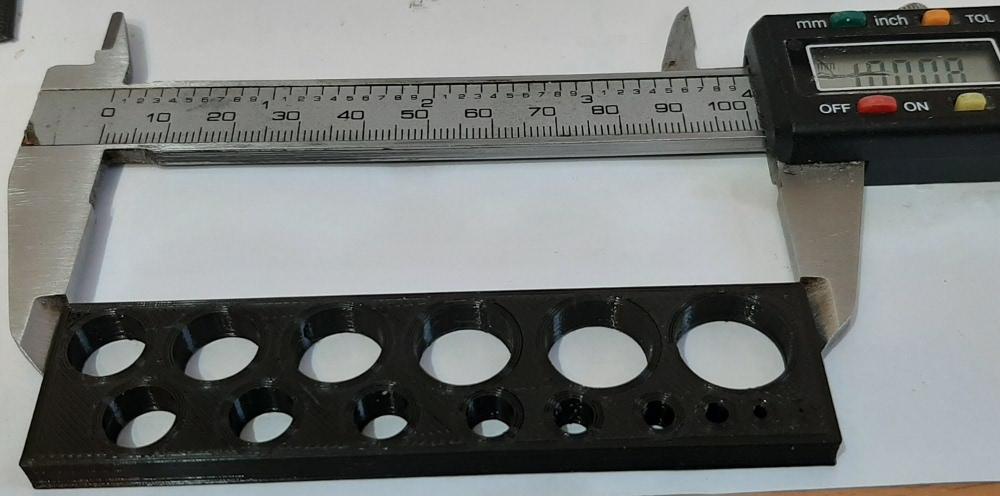

If everything is OK when printing square parts, it looks like your bed is moving on the springs somehow.   It certainly exhibits drag I would associate with belt stretch or binding, or a hotend rocking as the top and bottom of the holes have very similar displacement regardless of size.  Check the hotend assembly is tight and you can’t rock it side to side with your fingers.
  • Posts: 1319
Re: 3D printer Ender 3 pro oval hole problem
« Reply #2 on: April 12, 2020, 08:56:43 AM »
Just try printing some cubes again, but rotate them 45 degree to see if the sides distort.

Thanks for the springs idea, its something I hadn't  thought of. I've just compressed them well up, but now I will have to butcher the Z endstop (microswitch) holder for head adjustment. I'm not too worried about it as I've a 3d touch levelling sensor on order.
I have already checked the head for tightness, although I would imagine this would show up with unsquare prints if there was an issue like this.
I am impressed by the sturdiness of the frame and generally good engineering for a pretty low cost printer.

I am just testing it now, but it looks very much better. I have nearly halved the spring length which gives much improved stability. I would have taken it further but the bed will foul a cable support bracket.
The height of the bed is fixed with the z sensor, and the software is locked to prevent alteration of any offsets. New board will run Marlin 2.0. Amazing price of £11-45 inc del. plus drivers at £14.

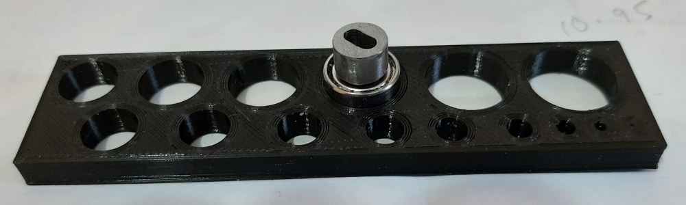

Measurement of 11mm test hole gives 10.95 x 11.07, which for plastic is pretty good. The 13mm hole is spot on, and as seen in the other picture, I can push the bearing into it without any adjustment and its a good firm fit. The hole test was to make up an error correction chart but I don't think I'm going to need it. :thumbup:
Before I bought this printer I noticed lots of people selling or recommending upgraded springs, and I think this must be the reason. The assembly is such that the spring compression relies on a large number of manufacturing tolerances which stack up. If your unlucky enough to get a slack one the wobble is the result. I assume that squares are not affected as the motion is in one direction.
@ Joules PLA, 210, 50mm / sec.

PS the bearing is part of a home made extruder for solder paste used in smt assembly.
My results are in:
The 11mm hole measured 10.70 - 10.74. Now I have noticed this with other holes and female threads  They are all undersized.
As another check I measure X, Y and Z dimensions. I assume you designed it as 100 x 25 x 6
I got 99.81 - 99.84, 25.07 25.10, 5.94 - 5.97

The hole size issue is a tricky one - hence the stl to allow compensation for the small sizes in design.
The bottom layer (possibly 2) is likely to be inaccurate due to the head height adjustment. In order to get it to stick to the build plate these layers are often overextruded, so when measuring size its important to ignore these (see elephants foot).
It could also be that the filament extrusion is set too high. Easy to do a quick check by marking the filament with a pen about 120mm from the extruder, then extruding 100mm, and measure how much over.
The way you measure the hole size is also relevent. Generally I use some telescopic gauges for sizes 6mm and above. For sizes below that some ground rod will give an idea.
FWIW my sizes were good to 5mm, but below that they will all need adjustment. And if you look at the picture you will see the 1mm hole was just a solid.
