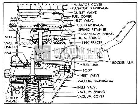

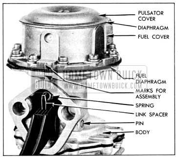

When the working diaphragm is pulled back fuel is forced through the outlet valve to the injector pump.As it returns the inlet valve opens and fuel is admitted to that space from the tank .. I don’t think anything maintains pressure other than by part 10 moving.

My guess, only a guess, is that the air space and the diaphragm damps the pressure pulses from the main diaphragm. And perhaps cushion the main pumping diaphragm as well from extremes of motion. In any case if missing, I wouldn't expect it to show up as an immediate problem. And if the cork and rubber gasket serve as a new damping diaphragm (if I'm correct at all), then function is fully restored, as long as it lasts.
« Reply #652 on: January 24, 2021, 06:45:36 PM »
It's called a pulsator diaphragm. Though I can't find something exactly like yours, here are two similar images that label it:
« Reply #653 on: January 24, 2021, 06:57:42 PM »
And from the mists of time -- 1945 to be exact, a pretty interesting document find:

Wow Steve that's quite a document - and yes I've been through it fully ! Who'd imagine there would have been so many minor variants. Many have the pulsator diaphragm, several don't and some have an 'air dome' presumably for the same function.
What I find odd about the rubbery one that I removed is that the illustration definitely shows it as flat, whereas mine is exactly curved to sit fully against the cover with no air (or fuel) behind it, and it is fixed at the periphery by the cover and the centre by the retaining screw thus greatly reducing any potential movement.

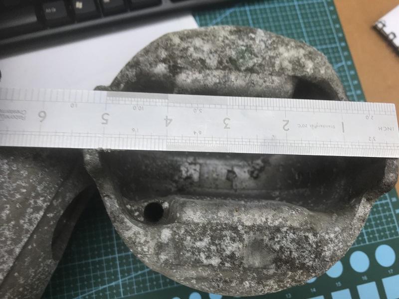

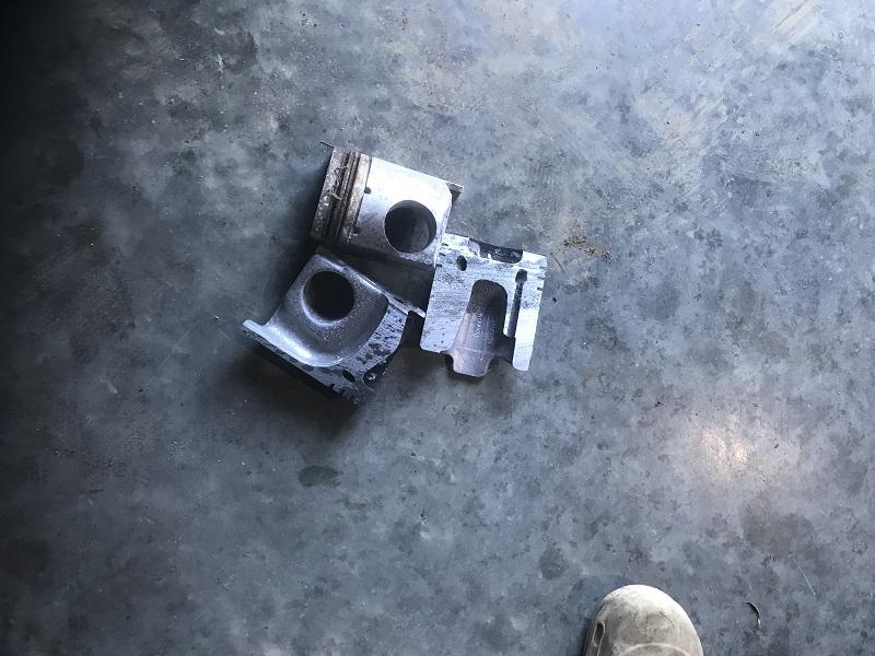

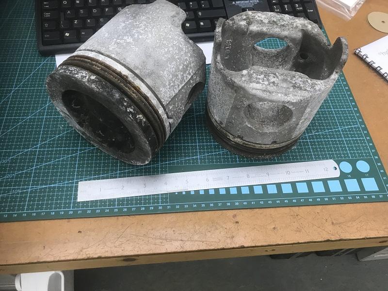

No  weeping over night and I've found the massive pistons that I thought I had so I'll do a melt today and load up the engine  and see what happens. But first I need to work out how to cut up the pistons - at 5.25" they won't quite go in the crucible  :bang:
Weighing in at 3 Kg's each it must have been a big engine that they came from !

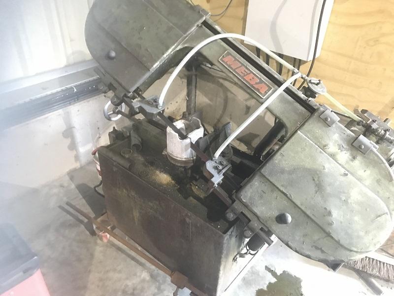

The other day I managed to break my coarse bandsaw blade for my upright Startrite 18V10 bandsaw, and although  it has a blade welder, this particular blade stock  doesn't butt weld very well, so . . .
. . . it had to be the horizontal band saw which gives worse holding issues with a piston shaped object - however two cuts and one piston was reduced to manageable pieces for the pot.
I deliberately hit it with rather more energy than really needed as I wanted to load up the engine to make sure that the lift pump was pumping at a goodly rate. 50 kW and the alloy was jumping out of the pot, but the engine note never missed a beat.
So one piston reduced to ingot and the lift pump is performing apparently OK, however I strongly suspect that with the tank sited where it is at least 12" above the injector pump it would probably run without a lift pump at all!

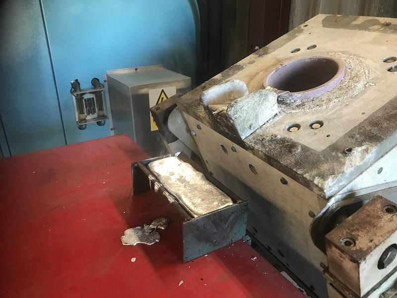

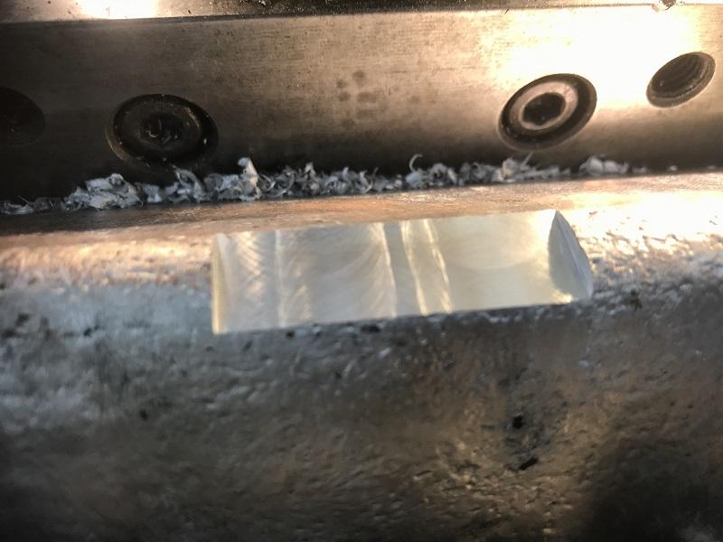

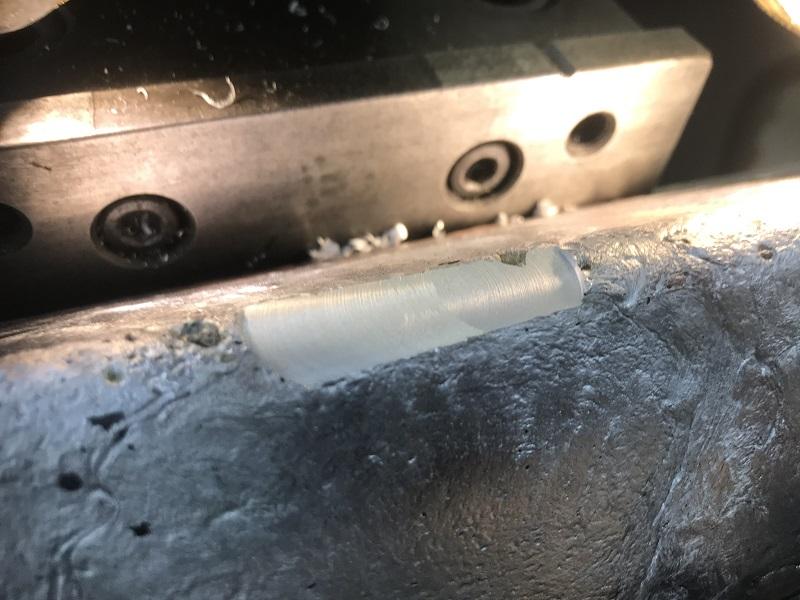

OK Matthew, I've machined both the 'Diecasting Alloy Ingot' and the 'Piston Alloy Ingot'
No signs of porosity / gas bubbles in either and they machined beautifully, despite being a rough and ready hand feeding bit of machining using an end mill out of my 'waiting to be sharpened' box !
Quite pleasing really  :thumbup:
(no saying if there are defects further in, but this is a good indication )

What I find odd about the rubbery one that I removed is that the illustration definitely shows it as flat, whereas mine is exactly curved to sit fully against the cover with no air (or fuel) behind it, and it it fixed at the periphery by the cover and the centre by the retaining screw thus greatly reducing any potential movement.
HI Andrew. My experience recently rebuilding a couple of outboard motor fuel pumps is that plain rubber diaphragms do often retain stretch over time even though they may start out flat. I also think that some of the modern fuel additives (not just ethanol in petrol but also additives in diesel) can soften the rubber and accelerate that kind of aging.
In normal usage, even though the pulsator is pinned down in center, the thinness of the rubber does allow elastic flexing into the space surrounding.
I think you're right that the height of the fuel tank relative to the engine intake probably provides fuel pressure by itself. I think the function of the pulsator diaphragm is not to provide fuel pressure (that's the function of the pump diaphragm) but to smooth the fuel pulses, and reduce the peak loads on the pump diaphragm and fuel line components. I don't think problems if any will show up in the short term.

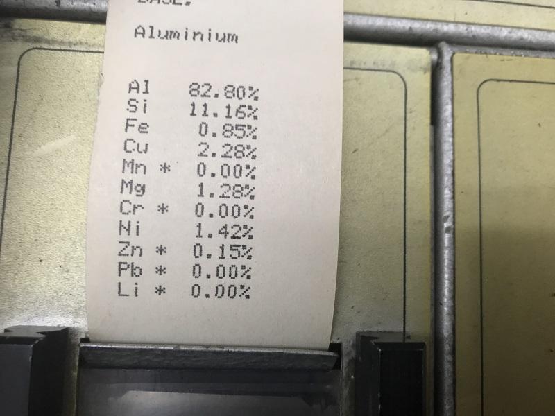

This is the analysis of the 'Piston Alloy'

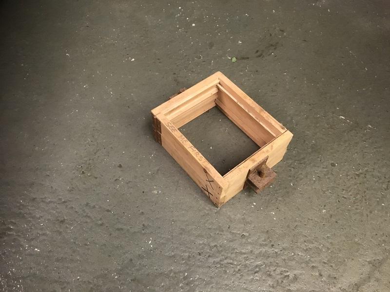

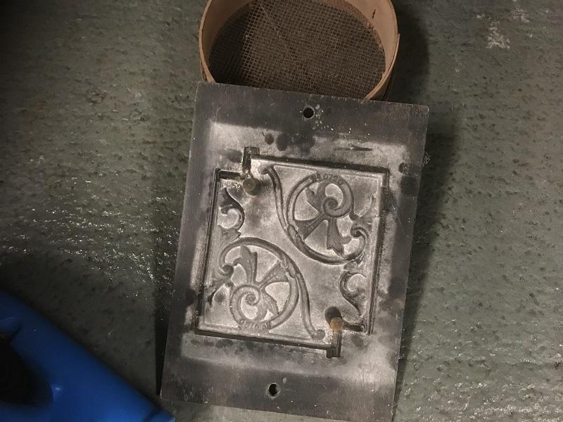

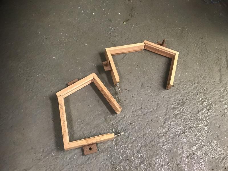

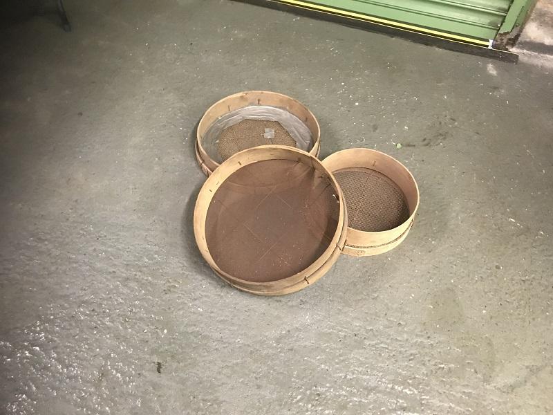

As I thought - the cover flux is long gone, but I did manage to unearth some treasures in my search for it:
A wooden 'snap flask' that I made using sash window catches
Several Sand Sieves in different meshes
Another Plate Pattern for brackets

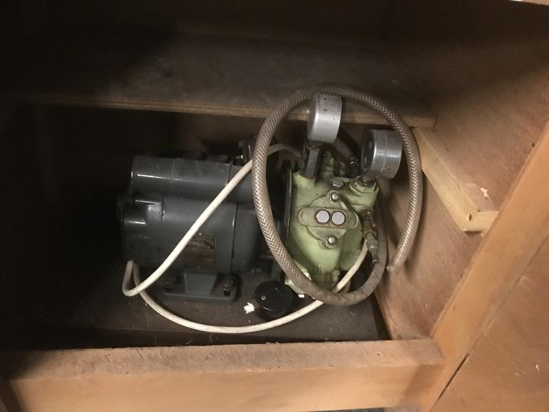

And my Vacuum Pump used for de-gassing lost wax plaster moulds
Along the way I found a cupboard full of all sorts of dangerous chemicals and card board boxes so covered in mould I hate to think what is inside - the cupboard has been against a damp wall for years - must work out a disposal strategy  :bugeye:

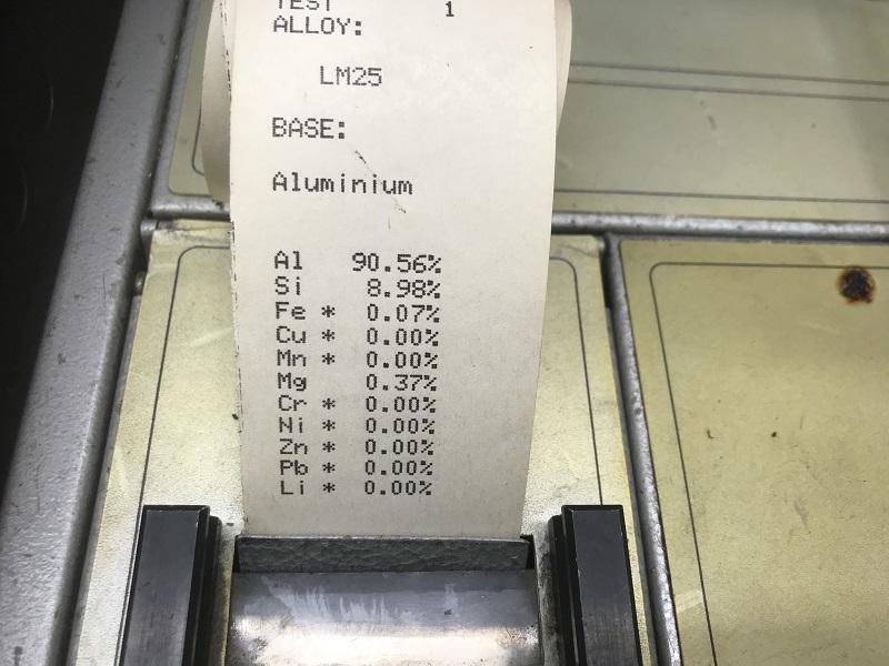

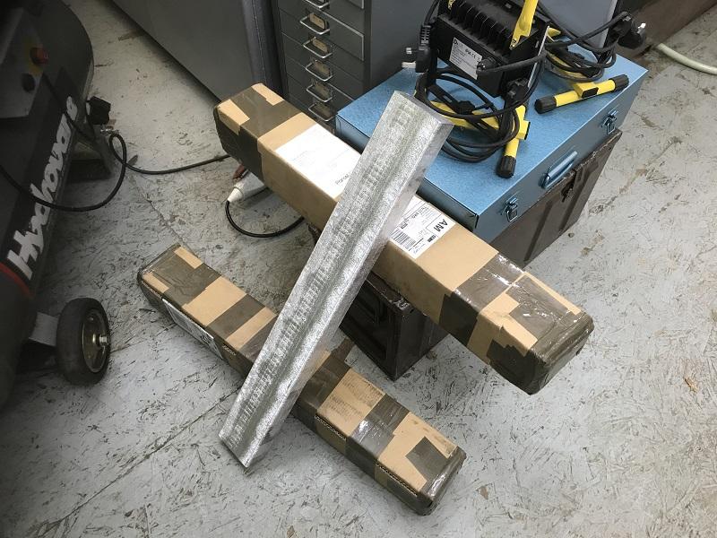

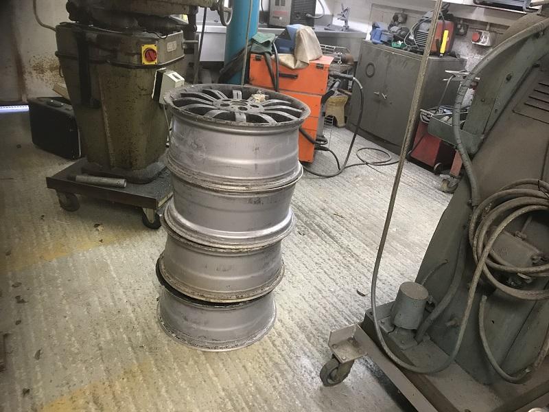

Yesterday I took delivery of five 8.5 kg ingots of pure aluminium from a re-cycler -  the analyser agrees that it's LM0 99 % aluminium, and today I've taken delivery of four Range Rover wheels weighing 80 kg so I'm all right for feed stock for a while once I've worked out how to cut the wheels up.
But what IS the alloy in Range Rover wheels ? The analyser says LM25 or 9% silicon with just a trace (0.37%) of magnesium which is fine - it machines OK but can be tough on tooling - but by adding the pure aluminium and a bit of copper I can get a really useful range of alloys and properties.
« Reply #671 on: January 30, 2021, 06:57:35 AM »
Hi Andrew,
Very interesting to see the analysis of the Wheels! Cutting the wheels is a real problem. The last ones I did were quite small, so I was able to cut them using the Warco mechanical hacksaw, bolted down in place of the vice and for some bits a chop saw fitted with an Al blade. I have one of those RangeRover wheels waiting, they are big! A good method, which is not always very doable, is to heat them in a pit-fire until they are "hot short" you can then tear of bits with tongs. I haven't tried using a press, that way, they might end up a shape that is easy to saw! A bugger to clap down!
Cheers Matthew
« Reply #672 on: January 30, 2021, 08:27:29 AM »
I'm going to see if my Hypertherm 900 plasma cutter will do anything for me. It's specified to sever 7/8" mild steel and do proper cutting on 16 mm aluminium. I've only ever used it on mild steel, but I bought it from a ship yard in Wales many year ago where they used in on aluminium plate on a daily basis.
If I can cut the spokes off then slice the rim into sectors it may be the quickest way.
Alternatives are heat up in kiln until 'hot short' (energy intensive), Squash in 60 ton press (might get interesting as bits fly about). Squash in log splitter on tractor (same issues as the press) or wait for better weather and have a bonfire (metal contamination)

« Reply #673 on: January 30, 2021, 08:42:26 AM »
I have placed alloy wheels on top of a good wood bonfire and as they melt the metal runs out the bottom. I have no idea what it doe to the composition of the alloy but it does reduce the unmanageable wheels down to usable pieces that will fit into a crucible and can be remelted down, skimmed to get rid of the dross, and then cast into nice clean ingots. It's a bit of a faff but at the time my fuel was free.
« Reply #674 on: January 30, 2021, 08:55:05 AM »
Plasma cutter should work nicely, I haven't used mine much for Al seems to cut more ragged! Needles to say mask up and if possible cut out of doors! Vaporised Al is really nasty stuff!
Hot short  and log splitter would be really good!!
