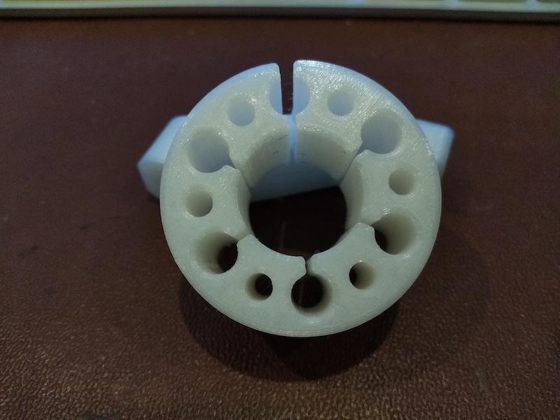

Here's a pic of the original part with all the printed parts.
The parts looked basically OK (they haven't been fully cleaned up in the photos) but I was very disappointed with the holes. Considering I went for 100% fill and a 1mm wall they look decidedly ropey!
Is there a setting in Cura to improve this? There's certainly not a 1mm wall.
On assembling the insert I found the distance between the mounting holes was a few mm out - fortunately it was too long so I could cut 2mm of the ends of the centre sections and slot the holes. If I print any more I'll either compensate for the difference or leave the holes out at one end and drill/csk them to suit.
When I cut the ends off on the mill I was pleased to see that my 100% fill really was 100% and there was no evidence whatsoever of any voids.
Here's the insert in place. It isn't perfect but serviceable.

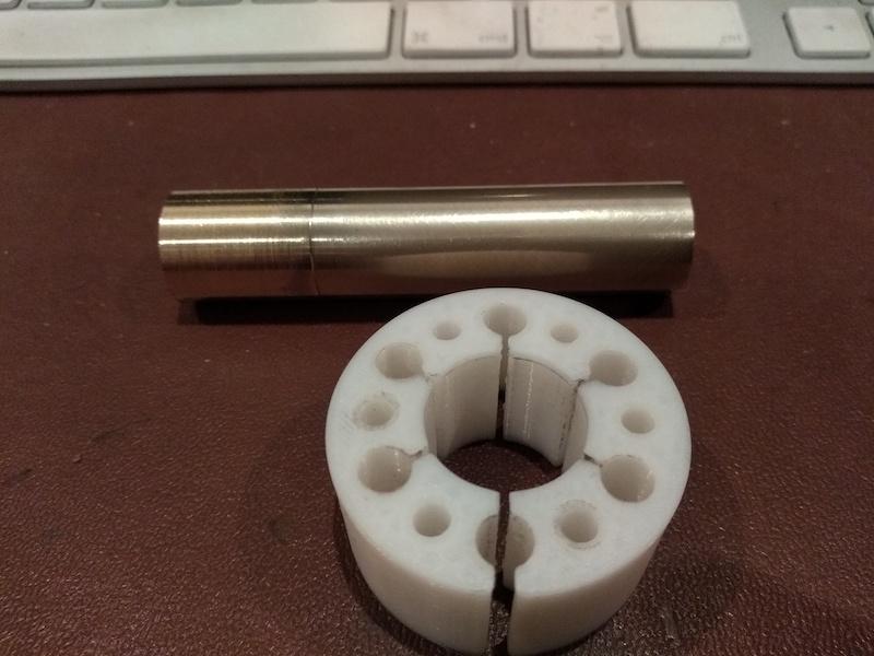

I designed a test piece to try out the effects of printing parameters on holes.
Overlap (25%) made a huge difference and the top of the test piece looks very good. The first layer however wasn't perfect as the filament didn't appear to have stuck properly to the bed. (nozzle to bed distance was 0.1mm with a 0.2mm layer height).
I read up a bit about Cura settings and to get the first layer to stick better it recommends that you use a thicker first layer! This seemed exactly the opposite to what I would have expected and, sure enough, the print was poor. (Hovering over the parameters in Cura gives the same advice!) Someone else recommended using 90% of the layer thickness as a first layer - I've yet to try that.
I ran another print with small chamfers (0.25 & 0.5mm) added to the holes and the results (combined with the overlap) are excellent. Generally if you were machining in metal you'd countersink the edges of holes to remove burrs anyway.
The photo isn't that good - I just took it with my phone with the parts balanced on my laptop.
The top one is with overlap (25%).
The middle one was with 25% overlap and a bottom layer of 0.3.
The bottom one is with 0.2 bottom layer, 25% overlap and a small chamfer added to the holes - I'm happy with this outcome.
Cheers.
