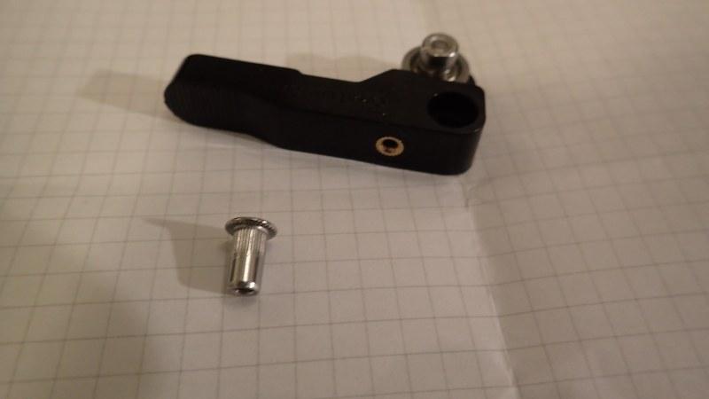

Got new metallic extruder to replace the stock plastic one.
https://youtu.be/k6eDBkc1mDg
It is original item, but it had one extra insert nut that does not show anywhere and really can't figure use, unless it is undocumented arbor inside the spring to hold it in place (in addittion of the screw).
I am not sure if it is improvement, possibly just just ore bling. Suposedly the original tension arm wears where the filament runs, but the eriginal arm I had has an brass insert, which probably is just fine. I have noticed that very many problems are being gradually adressed and often uppgrades address the problen tha does not excist.
I was hoping that this uppgrade would have adressed the enty point problem of the filament, now it runs pretty close to Z-axis trapezoidal screw. Luckily there are mods too.

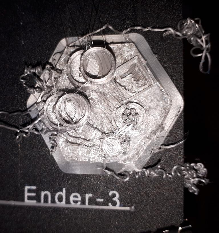

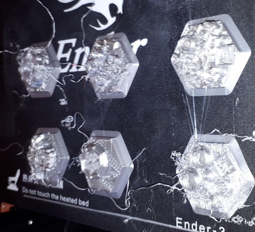

Now we come to the WTF?!? question:
Ran an overnight print after checking the usual things like good brim and bottom layer adhesion. After about 5 mm all looking good so - off to bed.
Came down to this mess:
Looks like the Y axis skipped about 5 mm at a layer change!
How on earth would this happen??

« Reply #20 on: January 20, 2020, 06:49:52 PM »
Could it be auto leveller is lower then the nozzle?
Re: Ender 3 - General discussion
« Reply #21 on: January 21, 2020, 05:11:18 AM »
No Ben,  I don't have an auto leveler. This was not a low nozzle contact as they knock the piece of the bed (how do I know!!).
All 8 pieces showed the same Y axis shift even the ones that are "solid" at that Z height
Will
« Reply #22 on: January 21, 2020, 07:08:57 AM »
Would that skip be in some relation to Y-axis tooth belt pitch? Maybe the belt is a bit loose or pulley/belt got debris in? :scratch:
Offline Peter Cordell
  • Posts: 27
« Reply #23 on: January 21, 2020, 07:37:51 AM »
The only time i have seen movment like that is when the printhead has made contact with the bed or something fixed to it
Seen bulldog clips on glass do it
  • Posts: 2462
« Reply #24 on: January 22, 2020, 04:27:15 AM »
What slicer are you using? Whilst it seems unlikely it'd suddenly introduce a Y-axis shift, it's the only thing other than a hardware glitch that could explain it.
As regards hardware glitching; it would have to be one of two things: Either the belt jumped some teeth on the motor (too loose), or it's wound up so tight a bit of binding happened which stalled the stepper motor.
With the machine switched off (or with the steppers disengaged), can you easily push the bed backwards and forwards through its entire travel? Are there any stiff spots? Is the belt nice and tight (but not murder tight)?
  • Posts: 27
« Reply #25 on: January 22, 2020, 08:51:34 AM »
Second pic bottom right looks like a bulldog clip to me, as the nozzle sits back on the printhead i still feel its very likely the printer head has struck one or more of these clips working so closely to the bed edge
don't give up these are brilliant little machines when you have cracked it

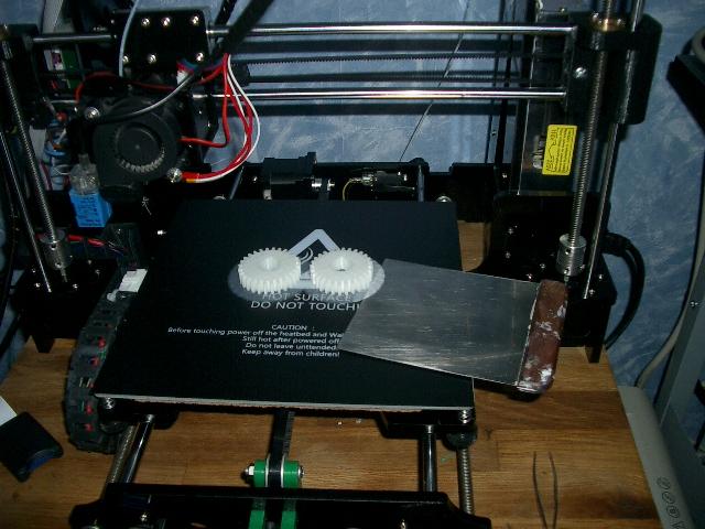

ps the bed should not be touched by human hand if the prints are to stick to it, my prints for today
how i remove them
Hi AdeV,
Thanks for the reply.
I use Cura 4.4.0 and not sure if I am staying with it as recently its started doing weird things which even show up in thre preview.
Both axes move nice a smoothly. In a previous post[#18] I mentioned how I realised the belts had stretch a bit (like 0.1mm) and that I had adjusted them
Hi Ben,
Thanks for the reply. The bed clips will pass under the print head even at Z = 0. This "SHIFT" in Y happened at about Z = 6mm
No way am I giving up. I will mod it to the end of the earth if necessary!

Did you try re-slicing the part?  Did you try printing a different part?  And if you did - did it make any difference?  If it didn't make any difference, then look at your machine for problems.  Otherwise look at the slicing software.
Like I said in my post on the 23rd, this would periodically happen to me when I was using Slic3r, or the Prusa version of Slic3r.  The first time it happened I was also wondering WTF happened to this piece of crap now?  When I couldn't find anything wrong with my printer, I tried re-slicing the part - printed with no problems.  After that, when a part started screwing up the first thing I did was re-slice the part.  If that didn't fix the problem, THEN I started looking at the printer.
I don't remember now which axis was shifted on my machine, and that's not just a "Senior Moment" type of thing, I haven't used Slic3r for close to 2 years.  Don't get me wrong, Slic3r and Cura are both good slicing packages.  But until something better comes along though, I'm going to stick with using Simplify3D.
« Reply #34 on: January 25, 2020, 04:22:36 AM »
I went back to Cura where the 8 models were. Removed all but two (the coolling towers and the big dome).
Moved them to a more frontal position on the bed and re-sliced.
Result:
Perfect Prints.
Latest with Cura is that it managed to put 2, 1 mm support structures ie very skinny thin lattice, across the middle of a Panda bear that certainly didn't need
Re-sliced and no problem!!
See attached photo:
Thanks for every ones help.

I printted some bed leveling wheels and put there nylock nuts as sggested several places. It does not work. The screw braks free from the bed.
Pekka,
What do you mean when you say that screw breaks free from the bed?
This modification made a huge difference to my printer.

I turns free withe the nut. To amke anything usefull, I need to imobilize the screw with a needle nose pliers and then I turn the adjustment wheel (and nylock), not that practical.

Pekka, is there room for a lock nut?

Next to heat plate? I need to check how it is build. They all are pretty loose. I noticed that when I mounted all the the parts. I assumed that the plate screws were held there pretty much by friction only. The screws were somewhat "loose", I though that it was a design feature to allow larger tolerances on heat plate screw location and mount plate hole location.

I made a new mount plate with one tight location hole, one slotted hole and two clearance holes to allow for expansion whilst stopping the heated plate randomly moving about. The screws through the heated plate are tight and don't turn when I adjust the level.

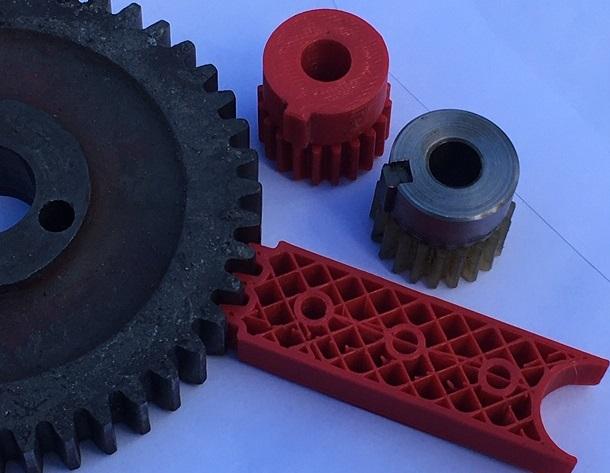

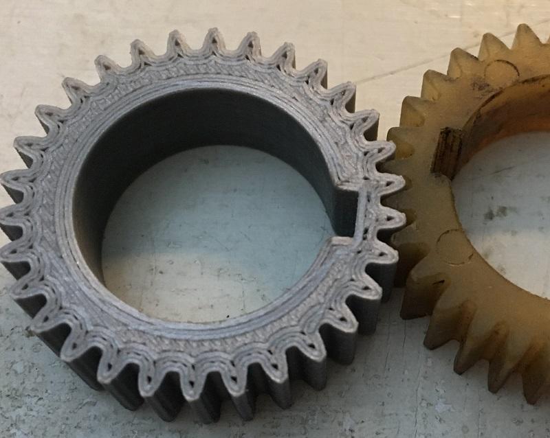

On the ME forum there is a thread about the Ender and printing gears which coincided with us getting an Ultimaker and I managed to get them to print a 1 Module 30 tooth changewheel for me. Then I found it difficult to get access to the printer so I just got my own.
Picture shows original injection moulded Hobbymat change wheel plain colour, Ultimaker print in grey, Ender print in red. The 20mm holes came out about 4 thou undersize easily adjusted with sandpaper to a perfect fit. Tooth form is fine and meshes nicely so to sandpaper the hole I held it on a bar wrapped with sandpaper and held it against a changewheel while the lathe was running (HSE pedants faint).
Bed levelling - as mentioned by Pekka I had loose bed levelling screws so had to apply epoxy + washer + nut.

Wrong picture got in there. However it shows 3 outer layers requested on the grey one and a little void because the 3rd one 'wouldn't fit'.

So the Hobbymat wheels have a 20mm hole to go on a bush to join two gears or on the spindle but the 20 tooth gear is smaller than the bush and has its own reduced size special bush. I printed a 20 with integral bush and even included the key. A touch with a file made the key fit nicely into an original gear. Feels strong enough so I will try printing a 19 joined to a 91 to use for slow feed using primes to spread the wear.
