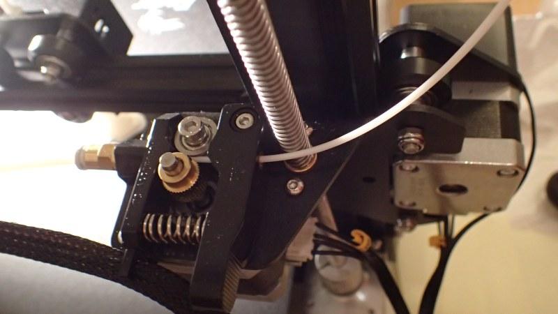

Looks like first thing it needs is a filament guide to rout the filament off the Z-axis screw.

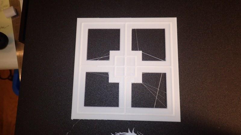

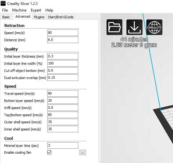

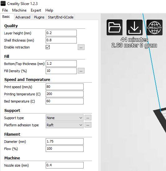

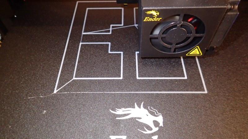

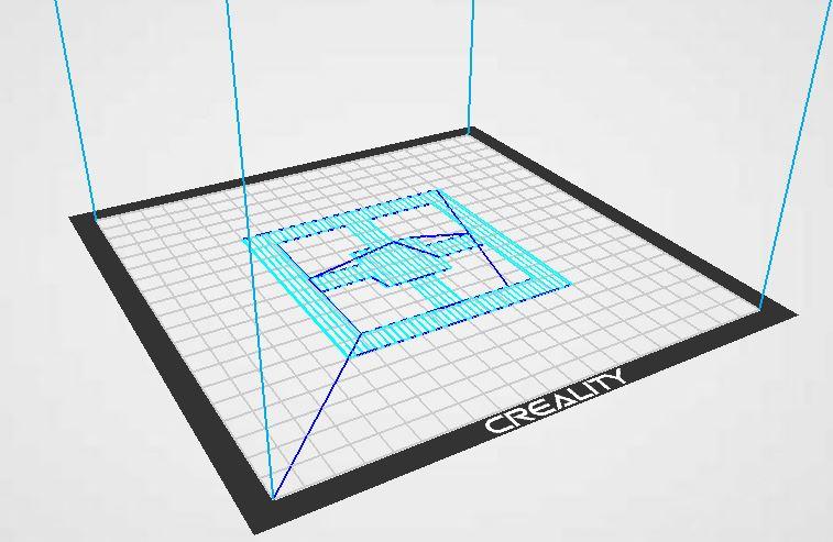

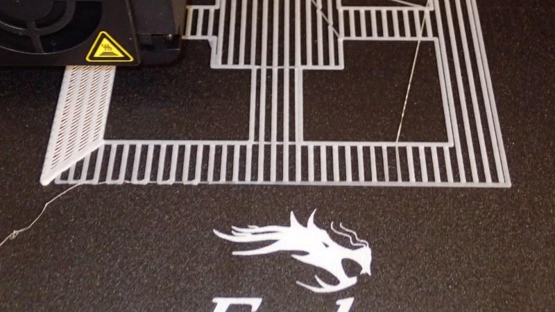

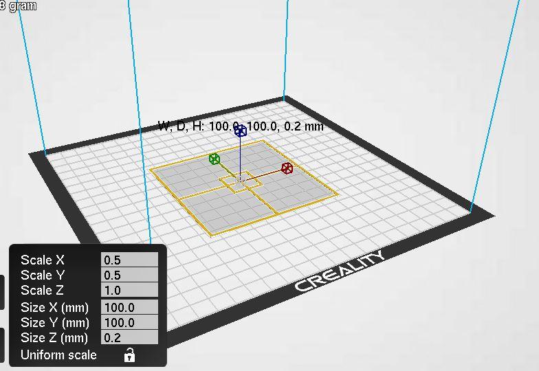

Got Creality slicer workking....it looks like it is based on cura. Downloaded bed level test and scaled it down to more close to bed size in the slicer. First try showed that the bbed was not leveled. Second print came out ok, on bed level but still had some issues. I think I am downloading cura and try that.
Bed is now leveled, but X/Y size is off. 100 mm according to slicer and 110 mm according to mr. Mitutoyo

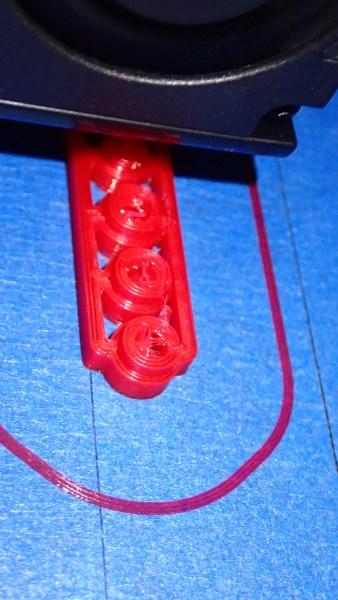

I was checking PETG extruder and bed temperature...
Bed temperature is no problem, but does it stick too hard on the bed? Tried to get some tips, but mostly got harspray or blue masking tape on glas plate ....but Ender 3 has this magnetic mystery plate that works for PLA, but PETG sticks everything like there is no tomorow - I have heard.
Looks like hot end max temperature of the stock Ender 3 Pro printer is bit marginal for PETG. But what is needed?

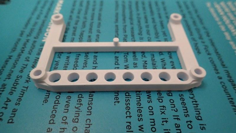

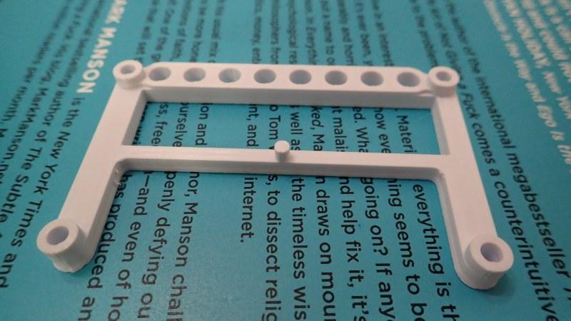

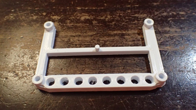

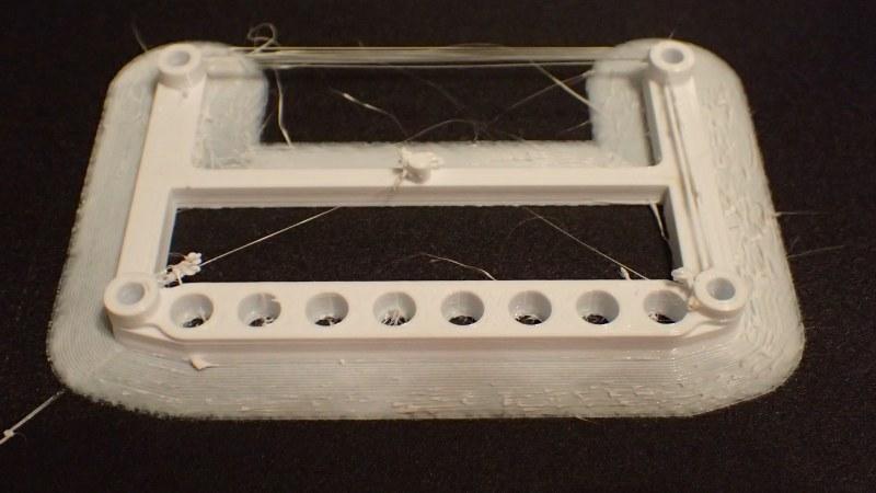

I can confirm that PETG sticks like there is no tomorow. It is also whole lot fussy on every known print setting - compared to PLA.
One PCB holder took three tries, Even first one was usable and stringing was easily cut out - but it was not pretty when printed.

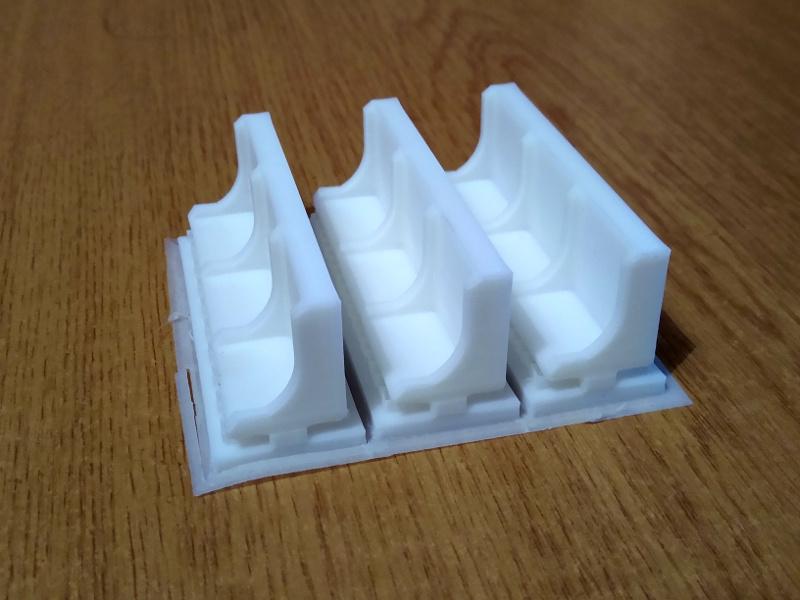

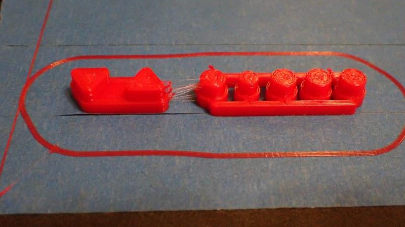

I printed these today. A few years ago we bought a metal shed to keep garden stuff in. The doors hung on plastic sliders which weren't very strong and used to bind when sliding. Eventually they broke up and the remnants are so brittle you can crumble them with your hands.
So these are the replacements, I made them longer so they are less likely to cock and bind. Only 3 shown here because I printed the first to make sure it fits.

That was printed with an Ender 3?
Yes. Ender 3 Pro with new Cura and PETG.

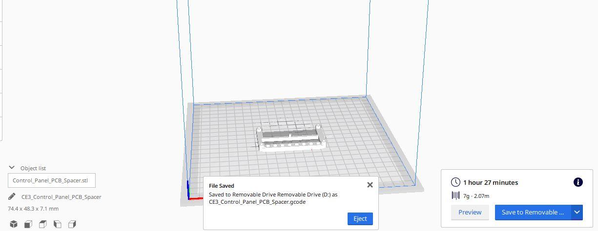

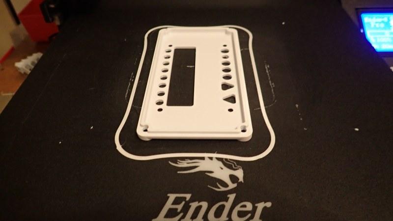

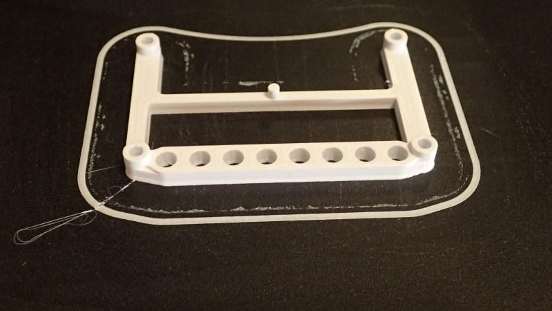

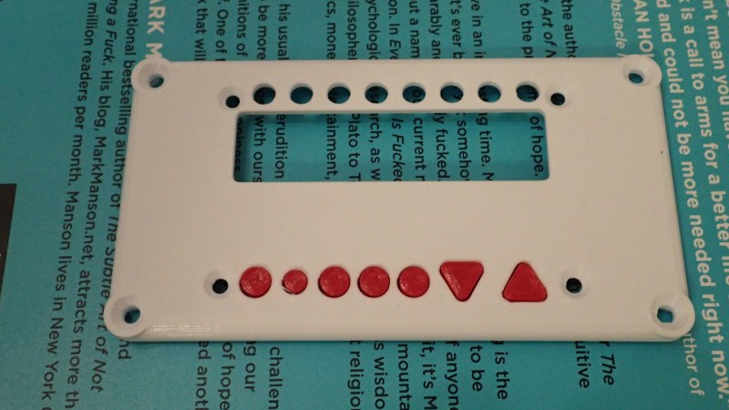

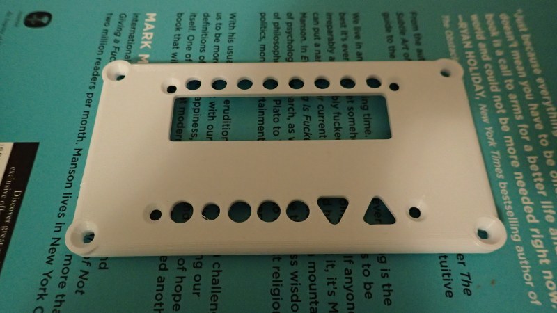

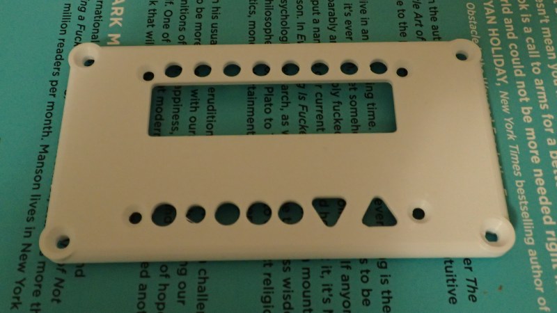

Annother part: Control panel lid for ELS. This was weird experience: First two tries did not stick. Usually everything sticks to ths surface, but last few times PETG stuck really hard to it and I had hard ime removing the remainers, I tried to take them carefully with spatula, but I can feel that I have scraped the surface pretty smooth. I washed the surface with soapy watter and then wiped with isopropyl alcohol, and adjusted the bed level once more.
Then without any clear reason, the third try was a charm. Although I can see some inperfections, most notably some marks from previous prints.
Actual print time of this one was 3 hours, 20 minutes, pretty close to estimate.

That has printed very nicely.

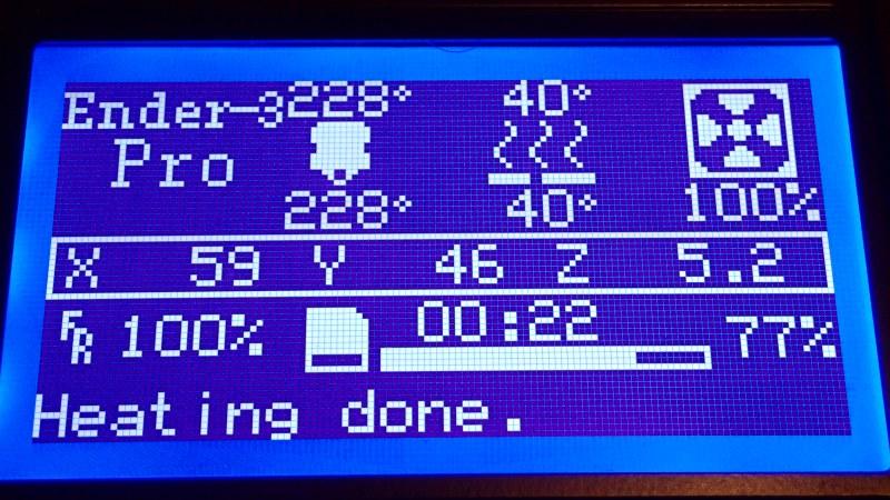

New try Today with flexible material Ninjatek Cheetah TPU 95A. Standard settings, but bed 40C and extruder 228C. 40% infill produced too hard buttons, checked Clough42 videos and dialed accordingdgly down to 20%, which looks pretty funky inside (could be mistaken with stringing).

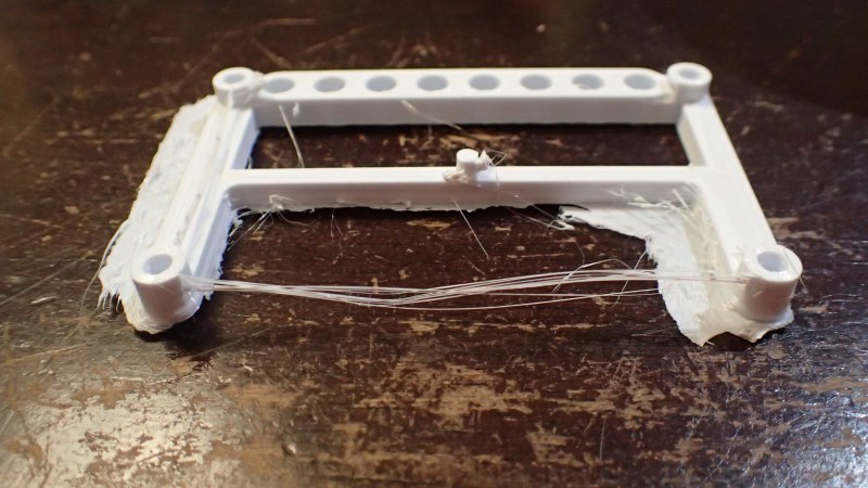

So after a slight delay with North Pole freight deliverys my Ender-3 arrived.
Very impressed with overall construction.
First rule is to watch a good build video as it explains how to check all the mechanical variables that need tweeking.
https://www.youtube.com/watch?v=me8Qrwh907Q
Took best part of the day to get it built. Then half a day to get the bed level!
https://www.youtube.com/watch?v=5eqTmb01cBk
Bed leveling test prints eventually came out spot on.
Now most people complain about poor adhesion to the hot bed, exact opposite for me. Finding it hard to remove these thin test prints.
Its the black textured removable bed not glass
Bed too hot, too cold or what. Should bed be back at room temperature?
