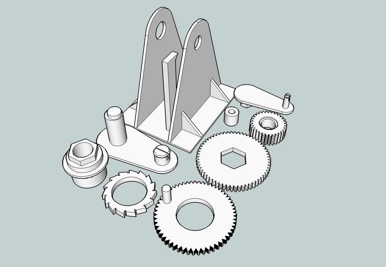

No cutter Jeff this is just a model. The pointy bit on the post below the peg is supposed to signify the cutting tool, but it came out somewhat short of where it should have been. One of the things I have to tweak.

I've finished all the parts now, done a few tweaks and just got a couple of test prints.
Where is the best place to publish this so others can download and print it?

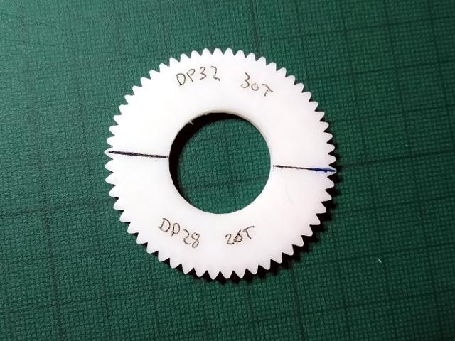

Form relieving is very slow regardless. I had thought a couple of times to build a proper working version but I didn't want to invest the time into making the split-DP gear several times to find a working combination. the printer makes that much easier.
Also this tool will ONLY produce 15-tooth cutters, unless you find some combination of gears that will offer a different advancement to the 60/4 teeth. I'll have a think about that.
Perhaps printed gears with 100% fill would be strong enough for a working machine? I shall investigate that...

« Reply #35 on: December 14, 2019, 06:01:37 AM »
Thanks Matthew.
The secret is in this gear, it has two different tooth pitches on each half. The top half has 30 teeth and the bottom 26. Because the small gear rolls around meshing with both big gears all the time it 'drags' the normal 60-tooth gear forwards 4 teeth each time it does the bottom-half rotation on this special gear.

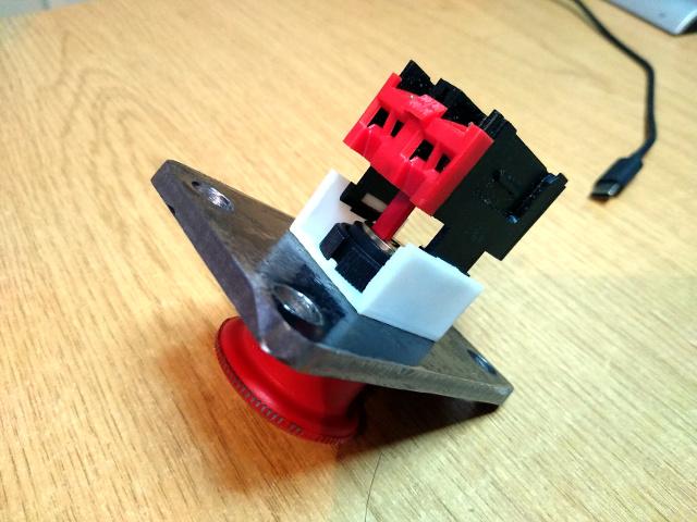

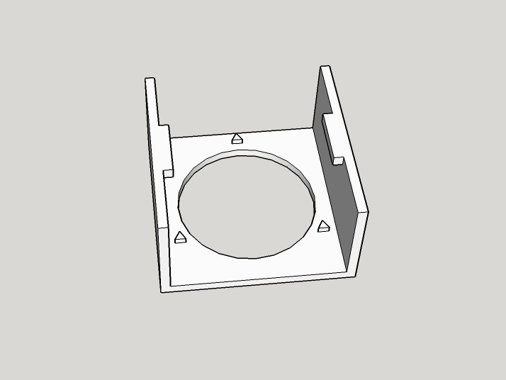

3d printer earning it's keep again. This time I wanted to remove a stop button from it's housing and fit it to a steel plate more in keeping with the machine. Junking the housing meant that I had nothing to fix the switch to, so I knocked upa  quick design and printed one.
I even incorporated 3 tabs so the switch mount could be used as a spanner for the plastic nut.

Re: First 3d printer - Ender 3 pro
« Reply #38 on: December 15, 2019, 01:06:06 PM »
Dead handy aren't they Pete !
« Reply #39 on: December 15, 2019, 07:06:48 PM »
You're not kidding Andrew. I'm printing a cable clamp right now. Handy as a handy thing with 2 pairs of hands.
