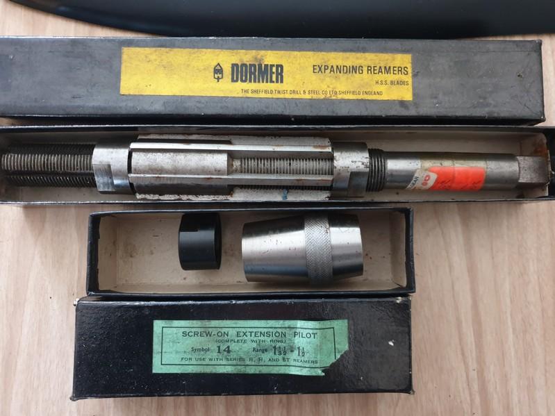

Phil, what's wrong with a standard adjustable piloted reamer? I have one, I used to use it for reaming BSA A65 crank bushes. Unfortunately, despite having the sleeve and collar, the pilot itself is not in the box. It may just be around at my friend's house where my tools lived for a few years.

« Reply #144 on: September 12, 2021, 03:29:57 PM »
Nothing wrong with them at all, if you have got one, just look up the price of a 1.5" piloted adjustable reamer, and you will see what I mean!!
