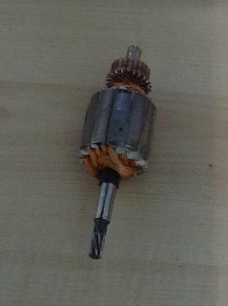

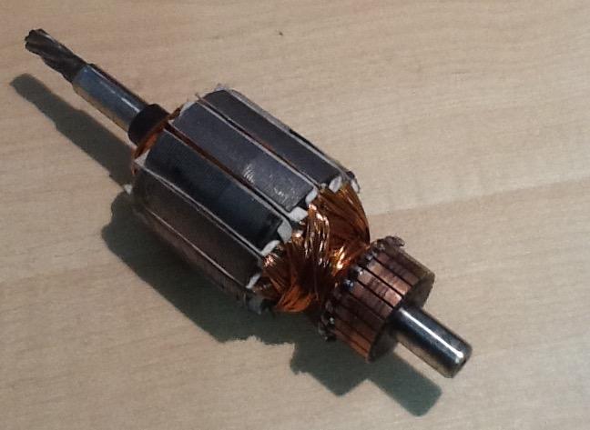

« Reply #15 on: November 26, 2019, 07:11:14 AM »
I can report after much knowledge searching and copper wire.....
I have succeeded in rewinding my armature...
I wound the coils with some 28SWG en copper wire that I had just to prove the practicalities...
Suffice to say when tested on my bench power supply it ran the wrong way!
Armed with the knowledge, I can now proceed to rewind it with the correct gauge of wire and terminate the connections at the comm the right way round...
In true madmodder style, some workshop equipment was pressed into service to aid rewinding...

Re: Armature rewinding
« Reply #18 on: November 26, 2019, 12:41:00 PM »
 :thumbup: Looks excellent, and very neat - be hard pushed to differentiate it from the original factory product.
« Reply #19 on: November 26, 2019, 01:12:38 PM »
Thanks for the compliment... :thumbup:
Suffice to say, its far from factory std.....its a quick lah up to prove that it can be done and to determine rotation direction....
When I 'do it for real' it will be a lot neater...( well thats the plan.... :scratch: )

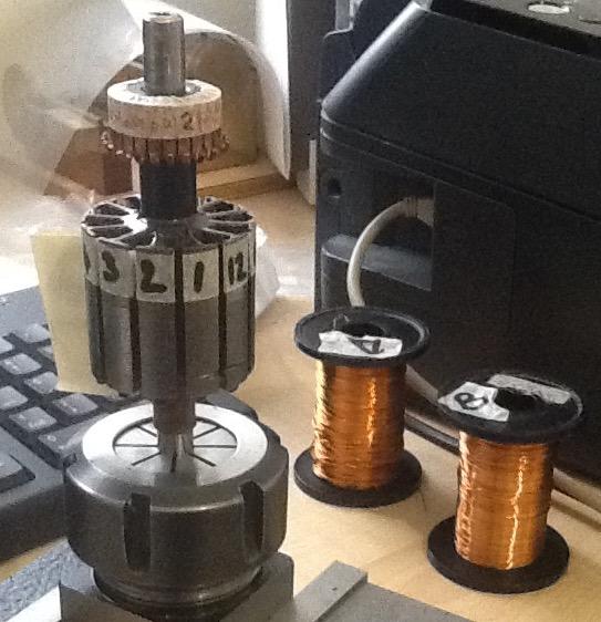

« Reply #21 on: November 26, 2019, 02:35:44 PM »
PekkaNF,
Reverse engineering was difficult but not insurmountable....
First, determine number of slots in armature, count number of segments in commutator....
Then cut off the rounded ends of the windings...punch out the wire in between the slots, put to one side at least 3 sets.....
Clean everything up.
To the wires, count the number of wires in the 'clump'.... Then take an individual wire and carefully measure its diameter....
Now we know how many turns per 'coil' and wire gauge....
If the commutator is removed, ensure its position is noted relative to rhe comm stack....look at the slot and the segment relationship.....
To be honest, I watched various Youtube videos and trawled the internet for bits of information before embarking on the winding..,,,
  • Posts: 819
« Reply #22 on: November 26, 2019, 03:32:35 PM »
Well done that man!! if you need to reverse this type of universal motor, you can do it by swapping the brush connections around. not easy because they are usually just the right length to reach the brush holders. Best of luck with the final rewind!
« Reply #23 on: November 27, 2019, 02:08:22 AM »
Phil,
You are correct, swapping the brush wires over does the trick.....
But, yes they are a fixed  length lead.....
I'd rather not do this as it then means that things are not 'original'... The armature is from a vintage Stanley Bridges drill I'm restoring..
