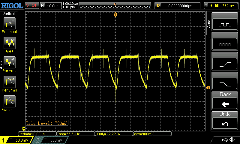

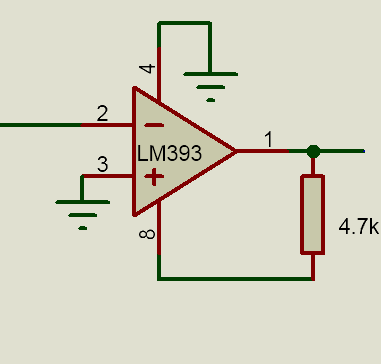

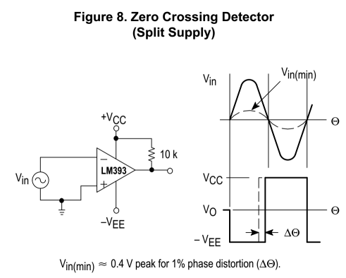

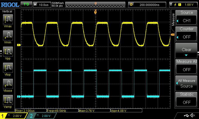

I think I found at least one reason, why the previously mentioned zero crossing detector didn't give any output, even when signal from the receiver was amplified.
The signal exists, but it seems to 'float' about 780mV above the zero volt point. Maybe not the most scientific way to measure that, but the result is there:
Could the reason for the signal floating above(or below) zero be something like a voltage offset?
I have a very shady understanding about how logic level output can be treated with pull-up, or pull-down resistor, to bring the 0's and 1's to the acceptable 0 to 5 volt 'window'.
Does that apply to analog signals at all?
But questions aside. The square wave generator, that I used to feed the IR-led, or sender, was again based on the 555-timer -IC(I should probably have a screen shot of it's output too).
After all, the output is square wave, when compared to the receiver's one.
No matter how many different versions I've tried out, all of them suffer 'duty cycle vs frequency' dependencies. When one is changed, other changes also.
One might guess already, where this leads. Now, that I have a multimeter with a colour screen, I'm obliged to have a proper function generator .
I have looked for something simple, like Velleman's HPG1MK2, which has 1MHz range. But after looking for it's specs, it doesn't seem to have any kind of duty cycle control for the square waves.
I'm aware, that Ebay offers a lot of 'authentic', old hardware, but I'm not so sure about them.

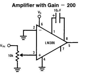

You may need an additional amplification stage before the signal is applied to the detector.
Re: Diy optical pickup for guitar -- is it possible?
« Reply #30 on: November 16, 2019, 08:20:41 AM »
There is always a little buffereing and level adjustment on analog/digital signals. You may want to search logic level on TTL or mathever logic circuits you have. There are some differerences wetween different logic levels voltages and sourcing or output currents. Usually schmit
I have this very generic function generator and it does pretty much what it says. Cheap, not extremely accurate and not the best quality signal (some noise and such) and pretty close to 100% that I need on general simple signals. Only thing is that the buffer does really output great signal to 50 input at more than 5 MHZ or such. Should not be problem for your use.
https://www.ebay.com/itm/24Mhz-Dual-channel-DDS-Function-Arbitrary-Waveform-Signal-Generator-Sine-Square-/181775301443?hash=item2a52a6fb43:g:RxEAAOSw~ZdVfuQg
It does not have the skleekest user interface, but it is easy to use on all normal waveforms, dutu cycle, offset voltages and such basic functions you need. It is not that great on advanced waveforms, but that a little more advertising gimmic, if I ever need that I would buy completely different "box".
There are cheaper ones for square vave dutu cycle, but they are even harder to use effectively. Least the ones I have tried.

Pekka yes I've been looking for different ways for analog to digital conversion. Well not exactly that, but more like simply chopping an analog signal wave to 0 to 5 volt square wave.
Thanks for suggesting the function generator. I checked the link, and that one, or similar should fit for the purpose.

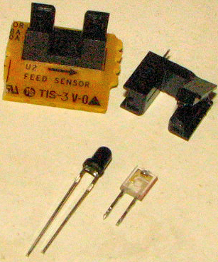

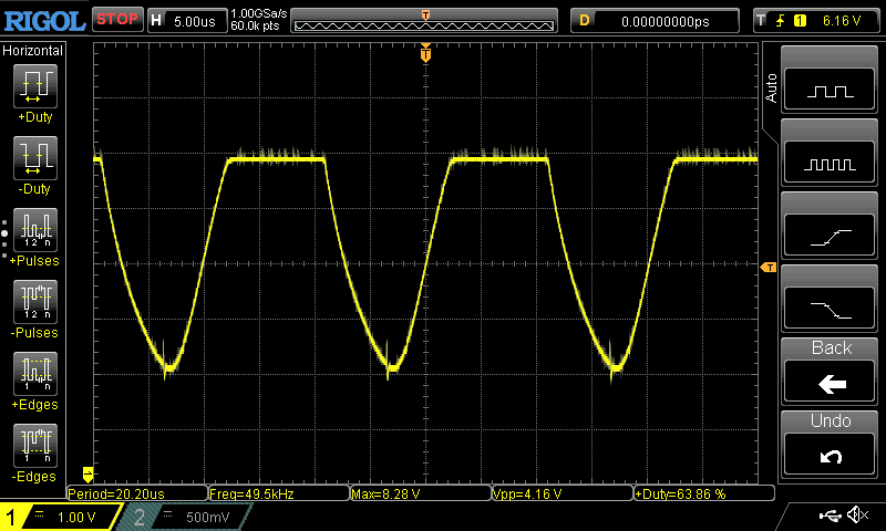

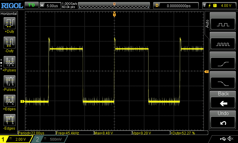

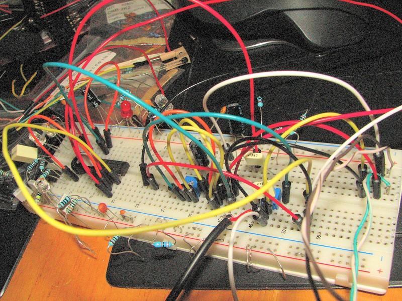

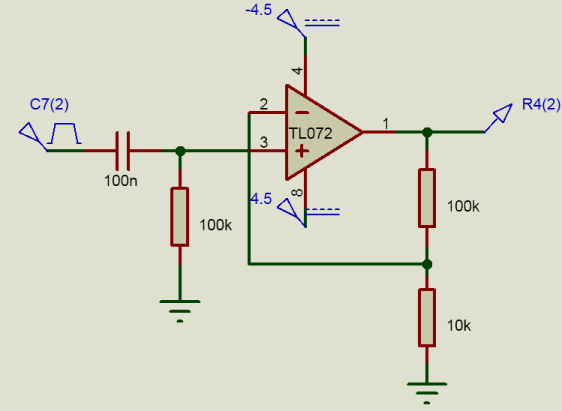

Little bit of hands-on testing: I took one pair of sender/receiver out of the guitar, to see, how the signal(~50khz) transfers through them.
Pulsed output from the 555-based square wave generator:
Then it goes from sender to receiver, whose output is fed to an op-amp like this:
Resulting output, although not symmetrical, sits finally around the zero volt point:
Now, that the signal crosses zero point, it is sent to a very simple zero cross detector, which requires only one resistor to be added, that I found from the LM393's(comparator IC) datasheet.
This version didn't work at all:
This one gave at least some kind of output. Perhaps the right direction, but not quite there yet:
I always like to start with minimum part count, as on project like this, the number of parts are eventually multiplied by six(except the possible dual/quad IC's). But it is to be expected, that the zero crossing detector needs more parts to make it more useable.
I'm sure, that using the zero crossing detector is just one option, but as I have comparator IC's at hand, I'll give it a shot to see where it leads.
Plenty of testing ahead, as the visual results so far exclude the effects of actual, vibrating guitar string in the infrared beam.

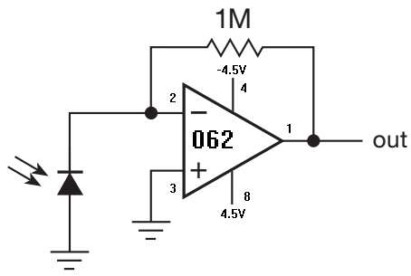

At first, I'll have to admit, that there was a gross mis-reading by me, of the values showed on scope. That dawned to me, when tracking down the reason, why I can't get that zero cross detector to work, as expected.

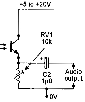

After digging on the net for alternative ways to amplify the signal from the receiver, I found out, that photodiodes and 'transimpedance' amplifiers go rather often hand-in-hand.
Without knowing much about it, or even having an actual transimpedance op-amp chip, I looked for the configuration.

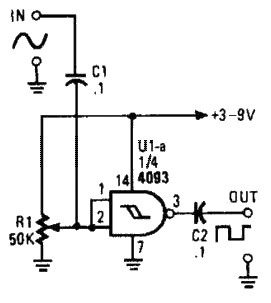

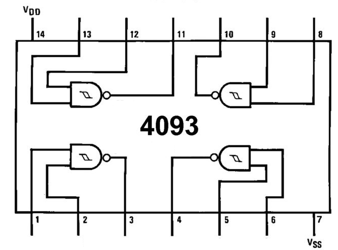

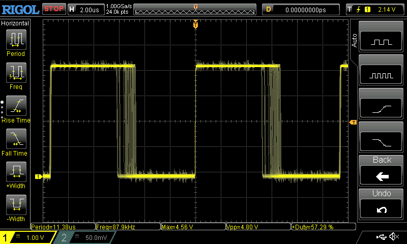

Bit of testing with one half of the very basic TL062 op-amp:
Output was fed to one of 'schmitt triggers', which is 1/4 of the 4093 IC, that I have at hand:
The inputs were simply tied together:
Yellow curve is from the op-amp output, while blue one is from the 4093 chip:
If all goes well, there could be a possibility to move on with the project.

Not much to report, just some testings to confirm the previously noticed thing, that the photodiodes I have, seem to have a very narrow operating range, what comes to the light intensity of the sender(IR-led).
Applying more and more current for the sending ir-led doesn't help, although one could expect, that the receiving photodiode would take all the 'juice' gratefully, burp, and demand more.
But after all, there is at least one solution, that I noticed after testing: by using the transimpedance(ish) configuration:
Replace the 1M resistor with 1M trimmer potentiometer. That way the narrow operating window of the photodiode can be altered to suit the following stage, which is schmitt trigger.

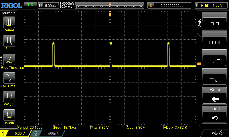

I did some testings to see, how the vibrating string affects the pulsed infrared beam between sender and receiver. Had to use the thickest string on the guitar for that, as the effect is quite subtle, when looked at the scope.
Here the string is plucked, and its vibration appears only at the trailing edge of the pulsed square wave:
The string signal seems to be more audible, than visible. It has some noise also, but not as much, as the earlier used phototransistors had.
I used again laptops mic input as an audio probe. It adds some 'weight' for the signal seen on the scope by altering it. Perhaps it could be better to use them separately, one at a time, to find out the best output ranges, either visibly or audibly.
The ~100kHz 'carrier' frequency should be sifted out at some stage, I guess. Though I'm not sure, what sort of modulation it has with plucked string signal.

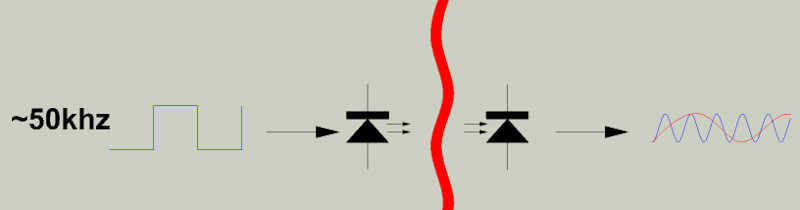

I've been looking for a way to suppress the ~50Khz 'carrier' signal from the string's one, that modulates it. Resistor-capacitor low-pass filter could be one way, as there are calculators for that online.
Another way that comes to mind, could be to somehow extract only the difference between the higher carrier frequency, and again the lower one that modulates it.
But as they are already mixed together, it doesn't look that simple.
Simplified signal chain goes like this, where the red one represents the vibrating/modulating string:
The carrier square wave, when it goes through sender to receiver, has always more arbitrary form, which seems to be very sensitive to any and all kinds of adjustments.

1: Signal to noise ratio looks bad. Is it good enough? Any way to improve with electro-optical or mechanical construction.
2: Modulation...I lost the plot somewhere why this modulation is used? I think that if modulation is need ideal would be sine wave, because it has only one frequency. Square wave needs to be really high compared to information signal and still simple low pass filter will strugle.
3: Modulation/demodulation reminds me of AM-stuff I used to read and even experiment a little when I were a kid....like one transistor mixers:
https://www.engineersgarage.com/circuit_design/circuit-design-how-to-demodulate-am-signal/
4: Still on this demodulation. If you want to get rid of the IR-led carrier signal you have several options. Have you tried to add pick up signal and inverted signal to subtract the unwanted carrier signal out (that effectively should be very close to IR modulation signal) Is't it.
I haven't been fiddling with audio devices much, this "information" may not be relevant.

I'm not sure why you want a square wave o/p (the fundamental frequency only will be a sign wave)  but..
one way is to synchronously sample the o/p with the illuminator's clock i.e. only test the level when the light is on (this should also improve s/n) but , you should really have a sample frequency (anti-alias) filter if you want to remove all sampling artefacts anyway.

I think the reason all your variation is on the trailing side is that you are triggering on the leading edge, which fixes that location on the screen.  If your scope will do it, try triggering on the led drive signal.
Electrically subtracting the led drive signal should be easy, and would take out the bulk of your modulation.

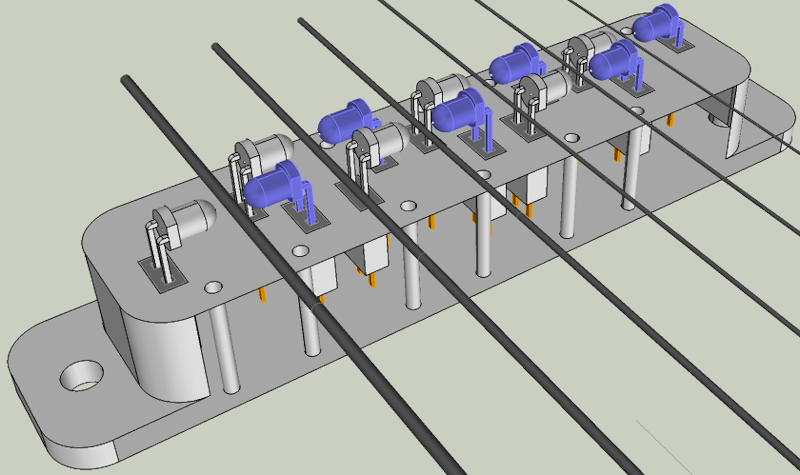

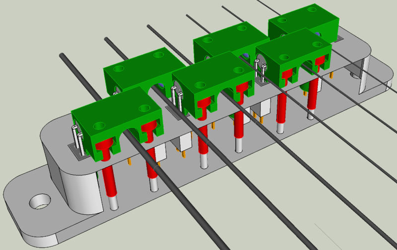

And the mechanical construction.. there is always room for improvement, one of the most important being the accurate height adjustment of the sender/receiver pairs. Likely by grub screws.
The current mechanical setup is too narrow for that, but it's just one of the first practising platforms.

As I'm on the testing phase, there are a lot of wires around to act as an antenna.

Picclock, thanks for the suggestion. I'm not sure, how the string actually changes or modulates the IR-beam. But it produces somewhat responding signal from the receiver's output.
As I've noticed, the axis between sender and receivers should be on the same level with string, to get the most output. But that's just one way that seems to work.
Again, I'm not sure if the string is exactly at the same level with the IR-components axis in that case.
One way to get close to the 'sweet spot', where the output is highest, is to feed strong enough square wave to the sender, so that it can be seen at the receivers output.
Although not necessarily square wave anymore after that, but while adjusting the pickups height up and down, that wave changes also, as the sender/receiver pair passes the string.
What comes to using apertures, I haven't got that far yet. With current mechanical configuration, the space between strings is rather limiting, but we'll see.

After all that, I tested one of the circuits with regulated PSU, and voila, the output was there again.

After testing different photodiode(as receiver) configurations, the overall output still wasn't at the level, that I expected.
I guess it would need a lot of amplification to get it to the level, which could then be usable for cmos(0-5V) devices. I used single op-amp for that, and the output should have been multiplied hundreds of times, but that didn't happen, so there is much more in it, than just adding input and feedback resistors.
Same goes with zero crossing detector(for converting sine to square wave) circuit, whose sensitivity should have been 10mV pp.
I tend to see the circuits that I've found as universal building blocks. But no, if they work for a certain application, that certainly doesn't make them universal.
So I'm heading back to square one, using again phototransistors as receivers. Although noisier, at least they provide more output as they are, even without amplification.

« Reply #43 on: December 01, 2019, 07:39:36 PM »

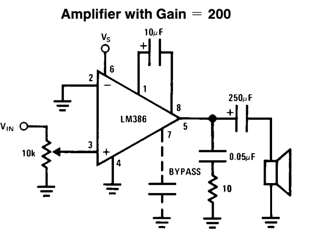

Again, I was looking ways to amplify the receivers output. Can't tell, why the op-amps didn't work for that purpose in any way :scratch:.
Anyways, I remember seeing this project, that uses an audio amplifier instead of op-amp: https://makezine.com/projects/infrared-string-bass/
After a bit of testing, the 386-based amplifier actually seems to provide a lot of output. I skipped the datasheet's x50 gain version, and went for the x200 one:
Not the most sophisticated way, but if it works, the project could go ahead, after weeks of stuck in the rut.

Current setup on breadboard:
Circuits involved:
  [ You are not allowed to view this attachment ]  [ You are not allowed to view this attachment ]  [ You are not allowed to view this attachment ]
At first, I tested with thickest string, and the output was good, but when testing with thinnest string with same settings, there wasn't output at all. I changed the voltage to the sender, and by decreasing it, the output was there.
So all of the senders need to be tuned separately, to suit the string thickness. As they are fed with dc, for that purpose, multiturn trimpots could be a safer option to avoid accidentally burning out the sending ir-leds.
To get rid of the jungle of breadboard wires, maybe the circuits above are worth of perfboarding.

The detector(phototransistor), being a current source with op-amp, I couldn't find working solution.
That's why I moved to an audio amplifier. If one doesn't provide, the next probably will.

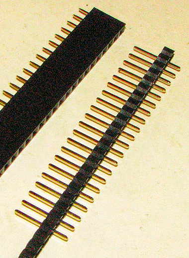

To get bit of a break from electronics stuff, I did draw some sketches of the possible next mechanical setup:
Same with an idea for height adjustment for the individual sender/receiver pairs, using M2 screws:
Contacting elements could be made of the header on the left:
It has room for ~3mm height adjustment, which I'm not sure is enough, though. The screw operated height adjustment seems to be plausible, as I have tested it with a few printed pieces.
To get ahead of myself, here is one possible newcomer. Left one is 3mm optotransistor for comparison:
The one on the right side was carefully removed from the optoswitch housing, which unfortunately doesn't have any model number in it.
While in one piece, I tested it in the breadboard, and the output wasn't strictly on-off type. Even a hair caused deviations in the output waveform.
Those components (sender/receiver) seem to be identical in size. Being that small, when compared to 3mm ones, there should be a lot more room for placing them between the strings.
