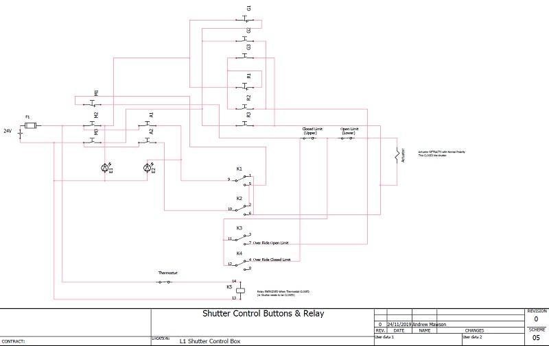

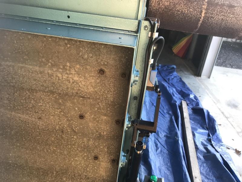

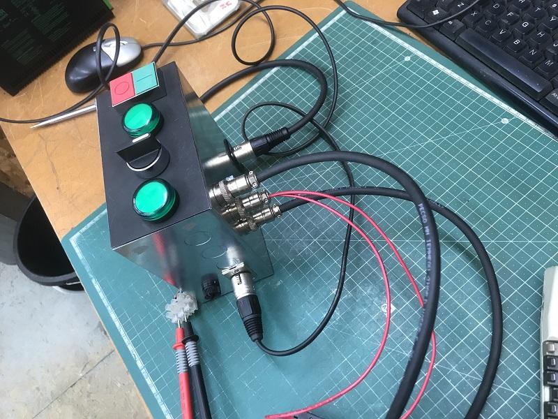

The other thing I need to sort out before I nail the lid on is arc suppression on the relay contacts. As the  actuator is reversed by reversing it's polarity I cannot just put a quenching diode across it. So I suppose either a capacitor / resistor network across each contact pair (a pain physically) or maybe an MOV or varistor across the actuator itself
As usual, all suggestions welcome !

Are R/C type suppresor?
Re: Puma / Dorman 6LE / MacFarlane B46B / 110 kVA Generator Resurrection
« Reply #227 on: November 28, 2019, 05:39:57 PM »
For a coil that is driven in only one polarity usually it suffices to put a (flywheel) diode across it in the reverse (ie non conducting) direction, so that as the relay contact opens the back emf of the coil is shorted.
In this situation, this simple solution is not applicable as the coil can be driven in both polarities.
Back to back zener diodes, an MOV or Varistor, or a simple capacitor in series with a low value resistor are possibilities.
I think an MOV is the simplest but without robbing other equipment, I have non to experiment with !
« Reply #228 on: November 29, 2019, 12:36:34 PM »
You prpbably know that MOV:s will take only limited amout of hit and then fail and short. You need a some sort of fuse on feeding line or limit the current safe way - unless it is intrinsically safe.
Then again RC surpressor will fail eventually too. But I have used to see them in industry often on AC solenoid valves.
This sort of thing is found to operate well. I think that since this is AC/DC this sot of stuff would work in switched polarity and would be a standard item.
https://www.productsforautomation.com/murr-din-43650-formb-24V-mov-11021-p/7000-11021-2260150.htm
Do you like that sort of component?
Alternatively:
If I had to build one, I would resort to ovekill it: I would put RC-snubber and the higher voltage MOV with series PTC-fuse tied to MOV.
https://m.littelfuse.com/~/media/electronics/application_notes/reed_switches/littelfuse_magnetic_sensors_and_reed_switches_inductive_load_arc_suppression_application_note.pdf.pdf
You know the standard rouge: MOV+PTC in series, but mechanically tied together with hitemp shrink tube or in same encapsulation (2-4 lead models).
https://www.automotive-fuses.com/sale-11081692-thermal-protection-surge-suppressor-metal-voltage-dependent-resistor-mov-tmov25s-series.html

What about a couple Zener diodes in series back to back?
However, I probably wouldn't be that concerned about arc suppression. I'm guessing most of those components will be rated for a good few amps at 240VAC, in which case a couple amps at 24VDC shouldn't be a major concern.
If it was, I'd design the circuit so a couple pluggable relays were doing the actuator switching, so you could just change the relays if it did become an issue, however you're then into the possible area of the switch contacts oxidising due to lack of switching current.
« Reply #230 on: November 29, 2019, 05:36:20 PM »
Morray, the switching (of 3.5 amps @ 24v DC) is done by a single four pole change over plug in relay, and as it happens I have about thirty spares in hand as they are the style that the original generator controller used, so that is one approach that I seriously considered.
But seeing the not inconsiderable arc leads me to want to tame it !
(The back to back zener method is one of the  options I cited a couple of postings above)
At the moment getting 'all the bits' into that box and connecting them is proving quite a challenge despite having installed pre-wired sockets and plugs for all external connections.

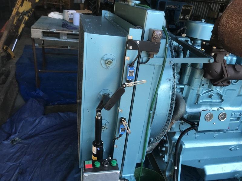

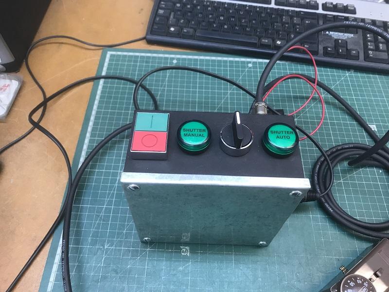

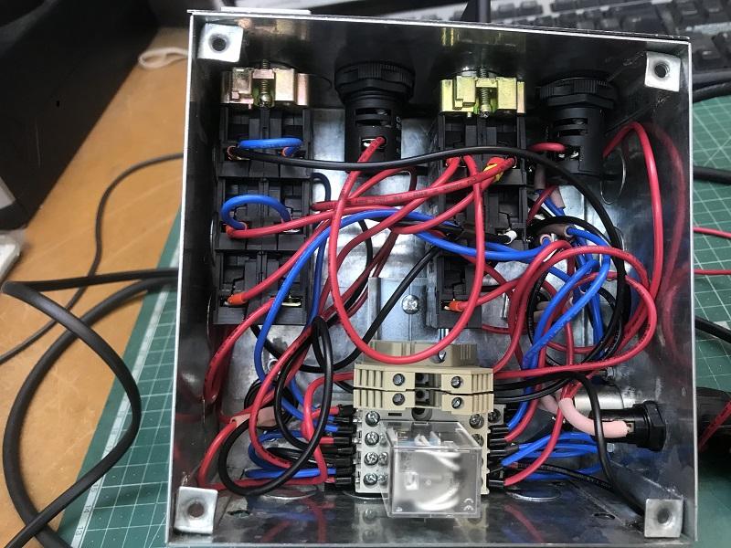

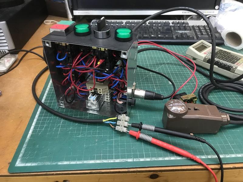

This control box for the shutter automation has taken far too long for such a simple device, and it's driven me up the wall!
The real problem is I've been too ambitious getting it into a small box, with the result that virtually none of the switch or relay contact screws are accessible with the components in the box. This means that wiring has had to be done as a 3D jumble on the bench, and the bits then returned to the box - this necessitates wires that are long enough to manoeuvre the  items as they are re-fitted. Not too bad if the circuit was finalised and I only had to do it once, but that wasn't the case !
However, a mile stone today, all is assembled in the box, and now the box has plugs and sockets for all it's external connections so fitting to the generator 'should' be trivial (famous last words!)
I was extremely fortunate that the holes that I'd bored for cable glands exactly matched the sockets that I then decided to use, so that was a bonus.
I've made up cable forms to run to the thermostat and limit switches and hope tomorrow to get it actually in operation.
(Attached is the final version of the circuit)
« Reply #232 on: December 02, 2019, 10:34:53 AM »
So as I'd hoped, I managed to fit the control box this morning. I need to finalise the cable runs, and also where I source the 24 volts from. Ideally it would be via the key switch on the Deep Sea 3110 control panel, but that doesn't have the current capacity.
Anyway it's is at last fundamentally working as intened - just awaiting titivation.

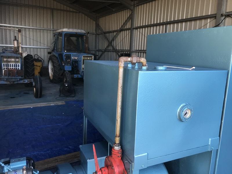

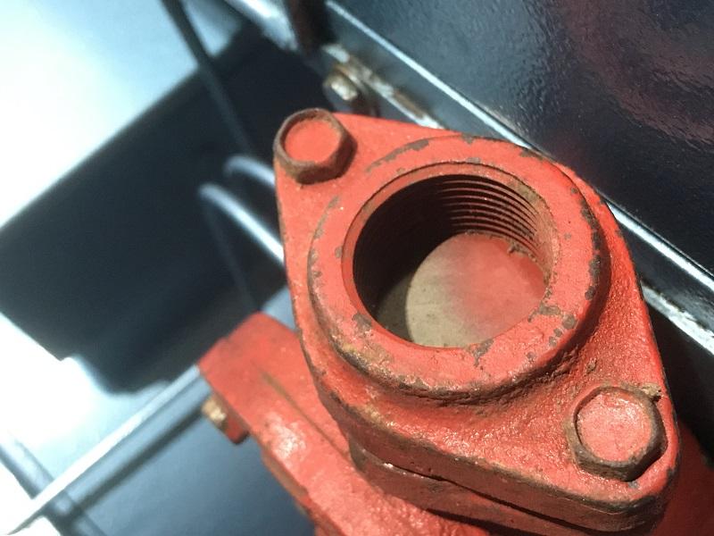

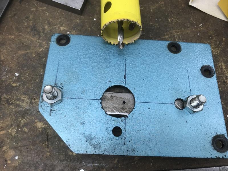

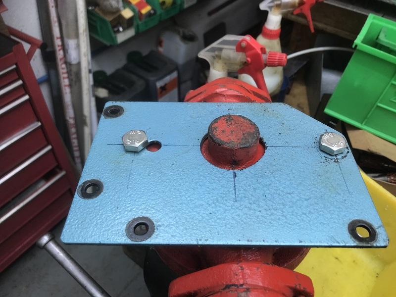

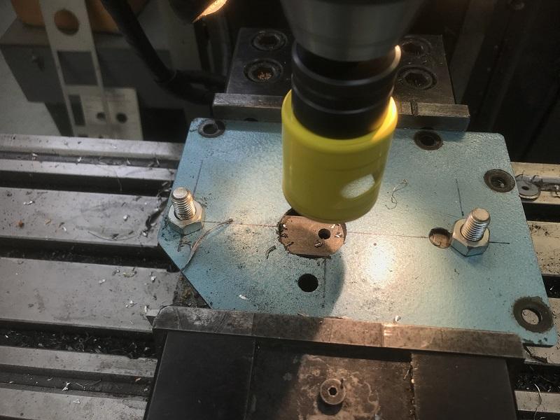

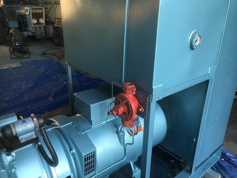

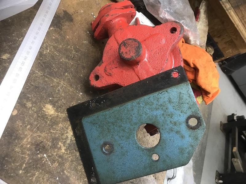

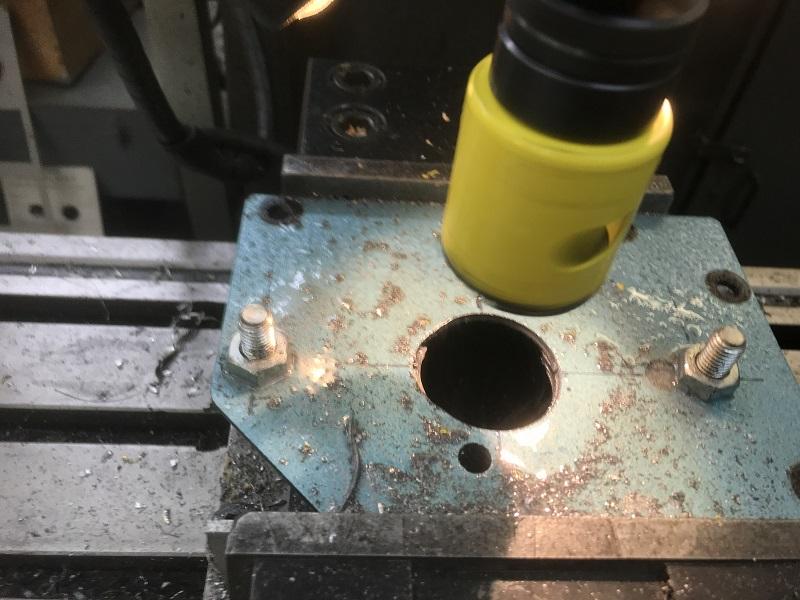

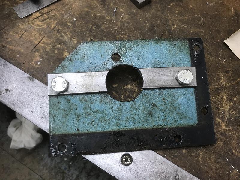

So now I need to sort out how to get fuel into the tank. There is a filler but it's rather high up to pour into.
Originally there was a semi-rotary hand pump fixed to the tank support framework, but it's 'gone missing' over time. Mounting holes measured at five inches spacing but I couldn't for the life of me find one that size either new or used.
Several of varying sizes appeared on ebay while I was looking and eventually I bought the nearest to five inches that I could (measuring and scaling pictures!) for the princely sum of £12. This turned out (I think!) to be a bargain - it's mounting holes are 5 1/2" apart but looking at the pipe mounts they have original over spray paint, and there is still a membrane across the opening, so I presume that it must be 'new old stock'
I'd intended to CNC plasma cut a new mounting plate, but removing the old one for measurement realised that it could be adapted if I could manage to mount a 'false centre' in the old spigot hole and bore it out larger and offset 1/4" .To this end I bolted a strip of steel across the old hole, drilled a centre in the new location and cut it out with a hole saw - all went well with no dramas  :thumbup:
I still need to make a wooden handle for it and sort out it's plumbing - input and output are both 1" BSP, the tank input orifice is 1/2" BSP, and I think I'll put a ball valve below the pump to try and minimise drips after use - but that's for another day - at least the pump is now off my bench  :thumbup:

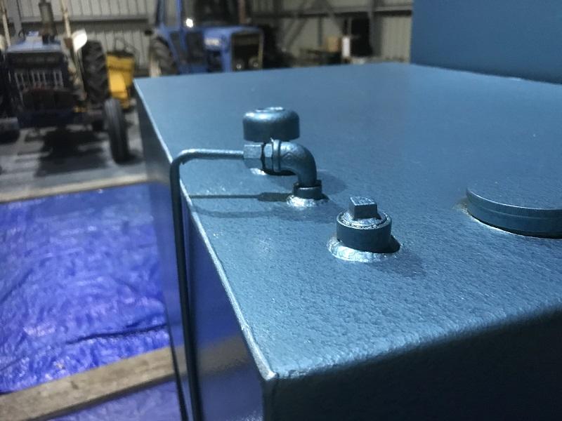

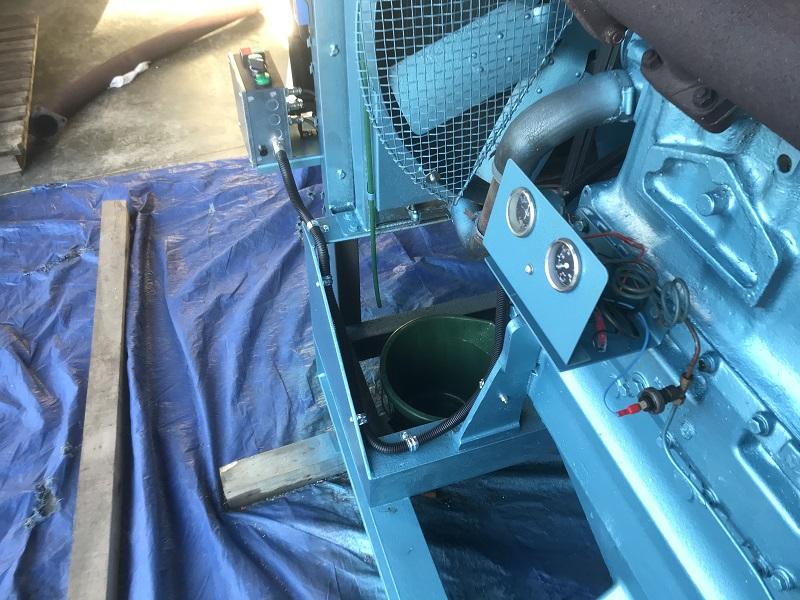

This morning I managed to fit the upper diesel plumbing from the pump to the tank using what I had to hand. Time was when I had loads of gas barrel, but that vertical bit (which needed extending two inches) was what was originally on the machine when it came, and despite searching high and low I couldn't find a longer bit. The plumbing 'odds and sods' box provided the solution.
The original pump must have been an odd (taller) shape, and of course this one is 'side stepped' half an inch being wider.
Of course I don't actually know if this one works, nor for certain which way up it's supposed to mount - I put it with the cast in model number letters upright so it's probably right  :scratch:
Bushing and ball valve on order for the lower pipe that will go to a Jerry Can.

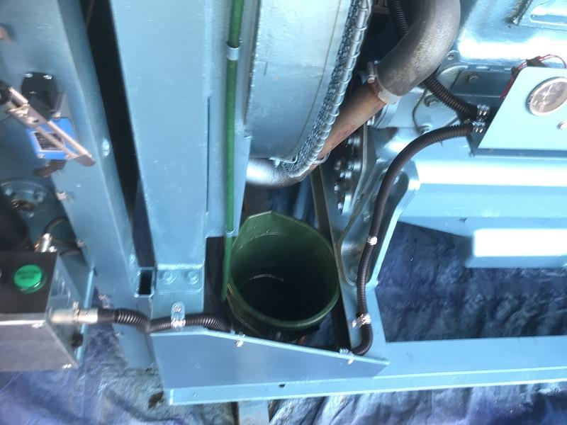

So I braved the minus 3 degrees Centigrade this morning and finished off the shutter controller wiring. Amazingly I was able to pull a 0V return cable through the existing convoluted conduit that snakes from the alternator, across the front of the engine and up to the ammeter panel - surprising as it already has quite a bit in it - I used a nylon conduit pull cable  which managed to traverse the not inconsiderable bends.
This allowed me to source the 24 volt feed to the controller from the ammeter panel, for which I ran another length of 20 mm convoluted conduit.
