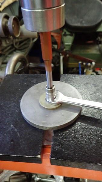

I supported the chuck and pressed the shaft with an proper drift punch and shop press with moderate force. It did not move. motor shaft is 8 mm and drift was slightly less. I did expect it to pop out with a very little force. No sign of glue, but there could be some.

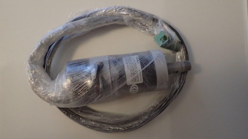

The screws will have scored the shaft and pretty much locked it in place.  You could try bagging the motor and put it in the freezer overnight.  Then hit the chuck with some heat and see if it will budge.  That would also sort out any Loctite if present.

Maybe I wrap it into cling film and chuck into freezer overnight and hit it with a hot air gun when it is in shop pres and give it one more try before resorting into anything more destructive.

Overnight in the freezer, little heating with hot air gun, moderate power with press and it come out.
*interesting thing is that the shaft and chuck hole are bit more under 8,00 than I expected. Luckilly I had a hunch and turned the drift diameter to 7,95 mm. Drift got stuc to chuck while pressed out the chuck from the shaft. I though there were debris, but looks like the chck ID is prety coles to that.

Glad it worked, the plastic bag is more to keep moisture out of the motor once removed from the freezer.

Exactly, kept the wrap on until the temperature was equalized. Still the front flange sweated.
