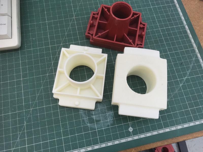

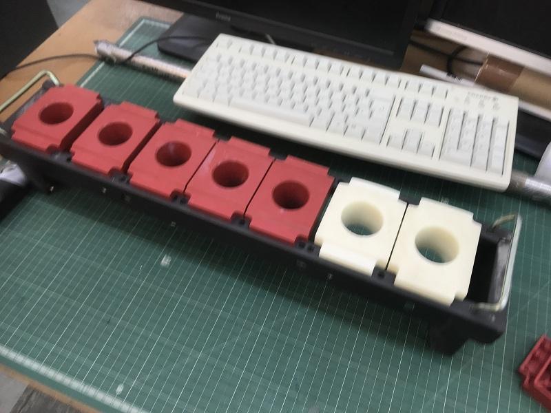

I rarely get stuff off Tingyverse - I tend to draw what I want in Fusion 360
Here is an example that's been printing over night - a rack insert module for VDI 40 tooling. I have had a pair of racks for year that had Morse Taper 4 inserts, so it was a relatively easy job to copy the inserts in Fusion but slightly modified!
 . . .only another eight to go at 5 hours each  :bugeye:
