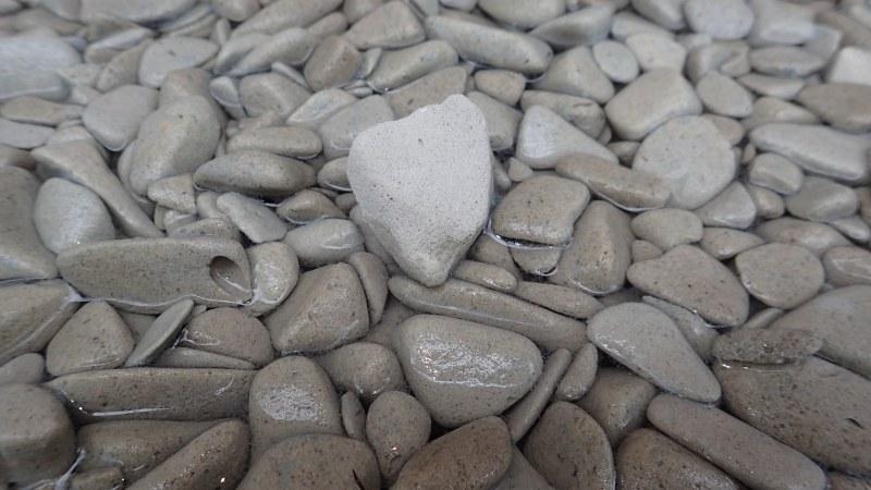

I made few enquiries about crushed glass, for some reason very fine as a blasting media is really easy to get, but real granules are unoptainable, next step is decoration size.
How ever local hardware store had "foam glas" for insulation, I really don't know what that is in English 50 litre bad weights about 20 kg and costs 14 Euros. Since it is actually a usefull medium temp insulation material it probably has more use as a . insulation.
It is pretty friable and floats atop of water. I put some parts for about 40-60 minutes cycle to it, checkking every 10 minutes and a tool steel shank come out really nice. Other parts were interesting. This media knoks off finest burr, and matts the surface if it of decent quality, but really strugles with pitting/rust etc. Good news it that matte-finish ir really shallow, hardly any dimenssional change, dis nothing to internal holes or threads.
Looks consumbale, the media rounded off fast and a 30% of it was reduced to sludge. I washed them to start with. Sludge/dust is easily rinsed off, it is really fine and hard so see how it would have any enviromental hazard.
It would be pretty good if it were a whole lot harder/heavier. Maybe good for plastic or other soft material.
I have a problem with "stone", think there is danger of leaving hard particles behind. But might need to try that one next.

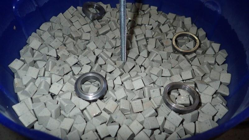

I ordered a 2x5kg set of differetn abrassive pyramids and for polishing ceramic cylinders + little polishing liquid that has antirust properties. All from Germany from a small comppany that is specialized on this sort of products, they don't normally deal with private customers, shiping was 40 EUR, but they definantely seem to know their stuf.
Re: Burr and matting media for vibratory tumbler to nicefy steel
« Reply #21 on: August 18, 2019, 05:47:31 AM »

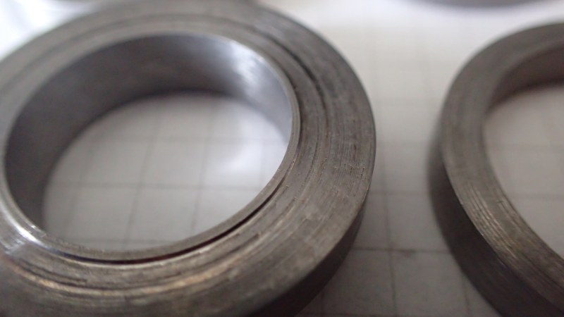

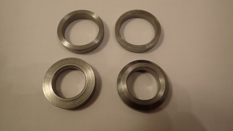

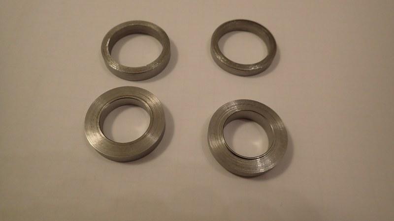

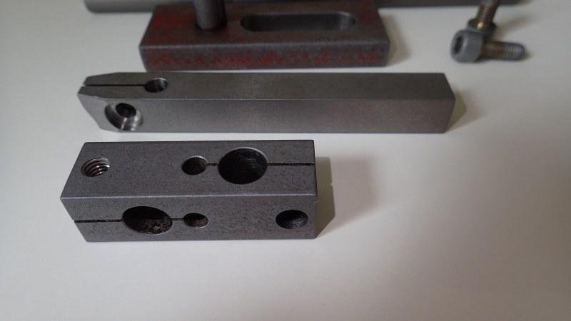

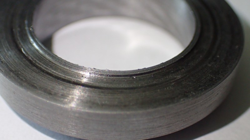

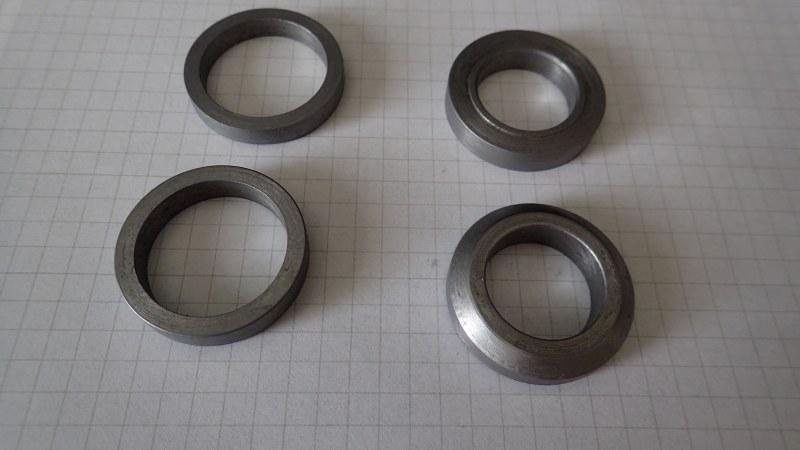

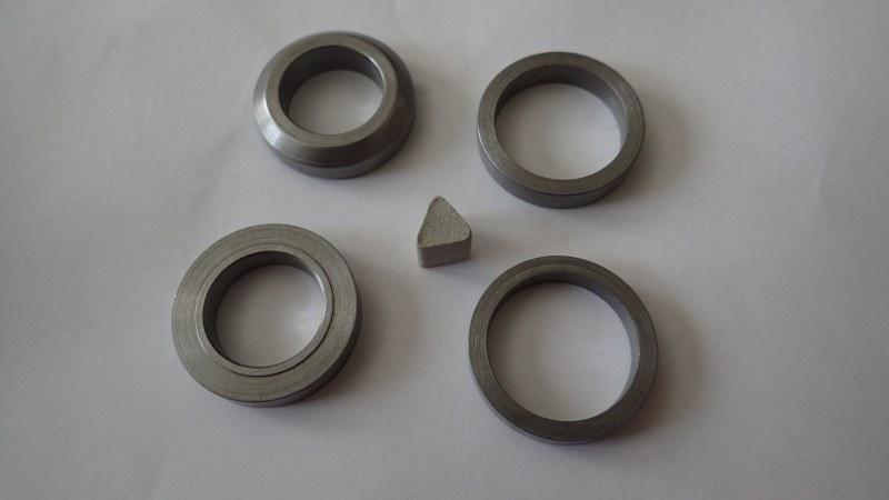

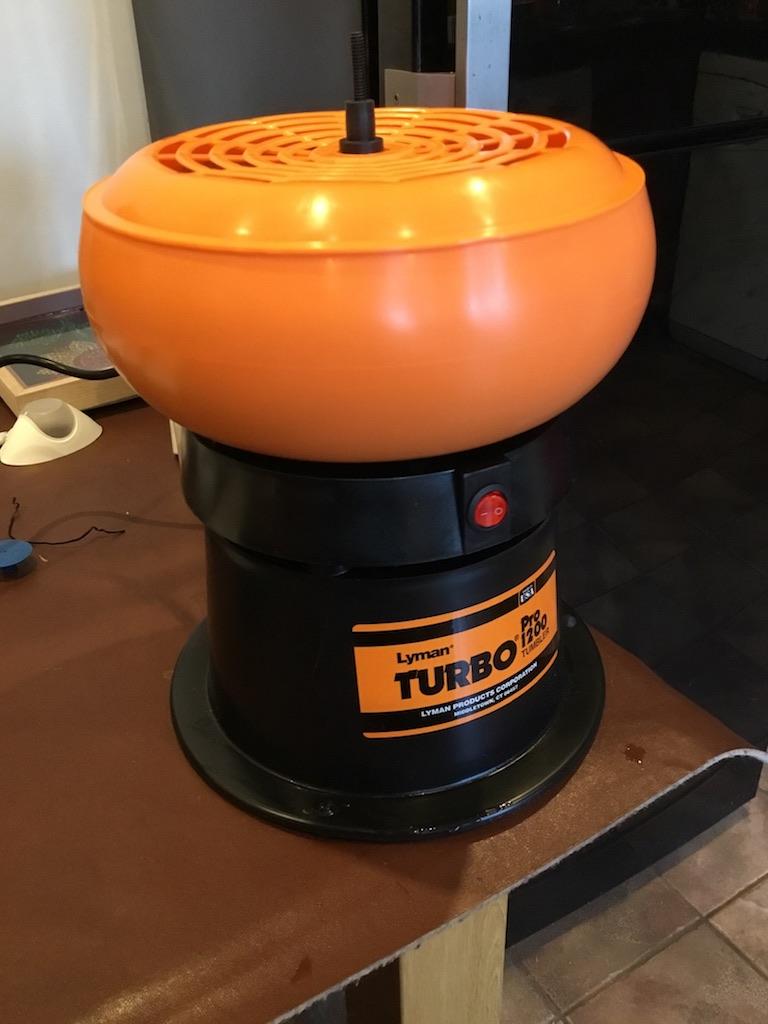

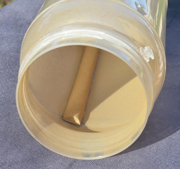

Forgot yo update. Some results here.
First 45 mins and then one hour more tumbling. It does remove burr, but does not change dimenssions any measurable way.
Cut "lip" somewhat smaller and left burr untouched after turning: P8181780c
Same part after one hour of "tumbling": P8181789c
El cheapo small tumbler is ok for mostly small parts I bougt it for. Would be nice, if the bowl would be more donugh shape (it would rotate the parts more and it would be faster to pick them up when they surface). Also would be nice to have quick connect bowls for easy change (different media or material).
One thing I don't know is how much to use this "cutting oil" that bought with it.

Great. Some peer support :wave: What metal and use you have for it?
I found fairly easy information about case polishing and rock rumbling, but really could not find any HMS level information.
When I used the foam glass, I came to conclusion that it was way too light weight for solid metal objects - looking at tumbler working it would appear that there is a benefit if the parts and aggregate are somewhat of same density.

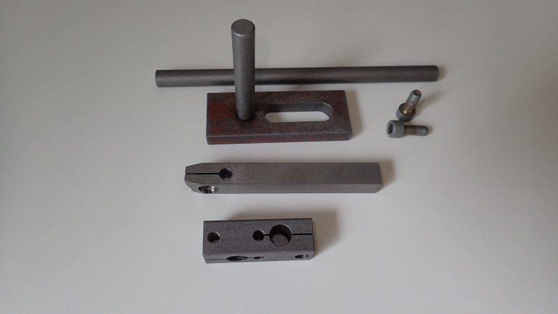

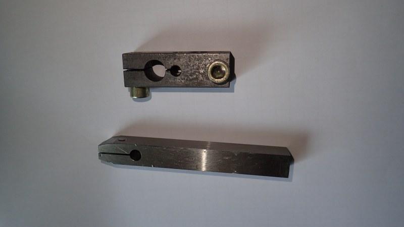

I bought these:
1: Deburing:
https://www.avatec.de/en/verfahrensmittel/ceramic-media/triangle/ke-d-46-6-10-10-in-5-kg-bags2
2: Satining:
https://www.avatec.de/en/verfahrensmittel/ceramic-media/cylinder-angle-cut/ke-zs-22-4-3-10-in-5-kg-bags1
3: liquid for color metals, testing with steel:
https://www.avatec.de/en/verfahrensmittel/compound/compound-vf-109-in-5-kg-kanister
Where I am at now is deburing of steel. Not really done any good experiments with the cutting/polishing/protective liquid part. I hear it has an effect and I can see that debris does not stick to abrasive media when I use is, but amount, dilution, etc. are a big question mark. I am not sure how subtle the effect is.
Half of the reason for shelling out money, was to see if "satining" could be used in lieu of media blasting. I haven't tried it yet.

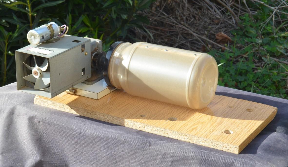

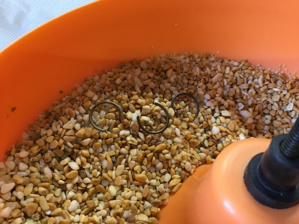

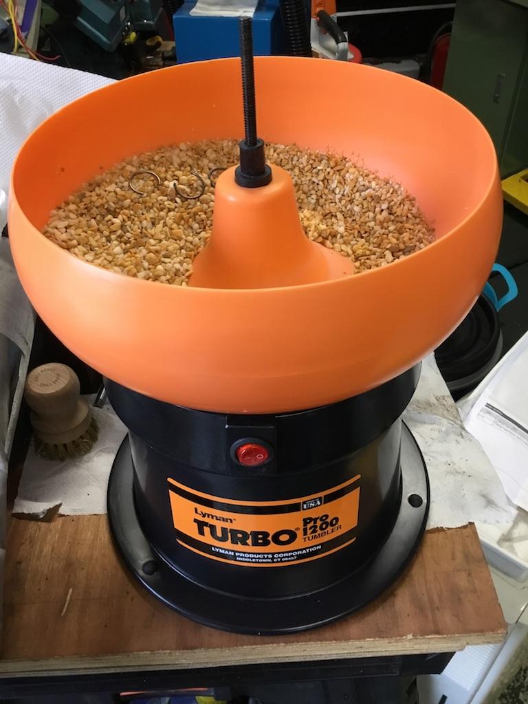

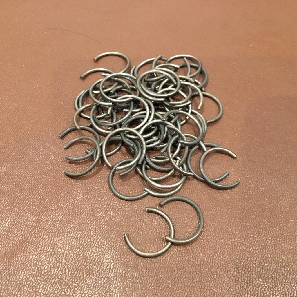

I got my tumbler the other day and started doing some tests.  I wasn't keen on buying some of the tumbling media as it can get a bit pricey.  A friend who's Mum lives in France has vast quantities of walnuts, so it looks like I will be getting a sack of shells to play with at some point...
 :lol:
Hmmmm, crusher is going to be on the ever increasing list of projects.   I went to the local pet shop and picked up two bags of Aquarium gravel, not really knowing how much I would need, one bag would have done twice over.  Hey only wimps read the manual first !!!  I did surprisingly read the packet for the gravel and washed the first 2kg as instructed.  Then couldn't wait for it to dry, thinking it will self lubricate wet.   Tumbling was not a success with twice the amount of wet media it rolled about in clumps.   Open the second bag, dry the drum and try that...   Much better and started thinking about different grades of media and getting some spares bowls so I didn't contaminate the media.  That was when I found out you add upto 2lbs (about 1kg) of dry media.  Soooooooo, weighing out the correct amount I went on my way with a few more tests.  Finally doing some serious work with snap rings I make here.  These are stainless steel, heat treated and sized in a die.  Previously they have gone into the ultrasonic tank for cleaning, but this time into the tumbler.  It did a similar job on removing the scale, however the ring ends had the sharp edges knocked off from shearing the wire, and they work hardened a little better after 2hrs in the tumbler.   This isn't conclusive proof your old fish tank gravel will work wonders, but it was cheap per kg.  I did try tumbling some plastic parts, and they didn't float about as I thought they might, but the fine gravel didn't really have much mass to rub down the PLA.  I think heavier media and possibly sharper media would work better.
With more experience I am sure this will become a valuable tool for the workshop and provide surface finishes, deburr of small metal components I make here.  This model of tumbler runs about 60w, so a few hours tumbling won't really impact my parts electric cost.   Tumbling isn't fast, but it's a lot less hassle than deburring by hand and you can be getting on with other work.   My only caution would be using gravel, lay some paper towel over the tumbler to stop gravel dust getting into the shop/lungs.   I sift the gravel after use and discard the material that falls through the sieve as it does get broken up during use.  Plug any holes or gaps you don't want jamming with media in items for tumbling.
« Reply #29 on: August 21, 2019, 02:41:12 PM »
Interesting test. How did that gravel deburr the ends? Just knocked off the burr or actually round the edge?
I raise thin, but pretty sharp burr when parting off (lathe). Think that lathe burrs are thin but pretty high.
I imagine that those snap rings have relatively large burr.

Hi Pekka, it knocked the edges off rather than debur, but my shear doesn't really leave a burr on these.  It cleaned the scale off from heat treating.
For anyone after a 3D printed solution I came across this.
https://www.thingiverse.com/thing:3666116

I recently had to make a trip to the US. Usually on my way back to an airport I stop off at a Horror Fright store and top up my luggage allowance.  However, past trips had pretty much exhausted my needs of stuff small enough for luggage and so I bought one of these
https://www.harborfreight.com/5-lb-metal-vibrator-tumbler-67617.html
and https://www.harborfreight.com/540-lb-Medium-Ceramic-Abrasive-Polishing-Tumbler-Media-63673.html
and https://www.harborfreight.com/520-lb-Rust-Cutting-Resin-Abrasive-Tumbler-Media-63672.html
I also tried some sharp sand and some glass beads.
I feel that I had wasted my money.  It is useless.  Against the wisdom of the instructions I tried the bought media with water.  That worked a little better but still very poorly.
I will try it with some of the media suggestions from this topic.
PS.  A while back I built a very Q&D rotating tumbler using a 75 rpm motor and gearbox from an old photocopier and that works so much better.
« Reply #35 on: January 10, 2020, 06:03:47 PM »
The OP video is not mine, I don't speak German,  Stefan Gotteswinter does!
I bought these:
1: Deburing:
2: Satining:
More on #25:
https://madmodder.net/index.php/topic,12940.msg155256.html#msg155256
Mine tumbler is cheaper and the movement is a little different. There is that circulation that turns media/parts up to bottom, but the media also "walks" inside the tumbler in clockwise direction.  I noticed that polishing works better when media density is close to part density. I am not sure if this is a general thing or just experience. Also the "cutting oil" seems to help and prevent post polishing rust, but it is hard to put number on it.

Not sure if this is any help
The uk aquarium gravel is most lilky pea shingle that helps keep the white hard water line around the top of your aquarium tank also helps to kill your plants by rasing the water hardness and ph not so good for all the fish
However some peple use german quartz gravel as its inert

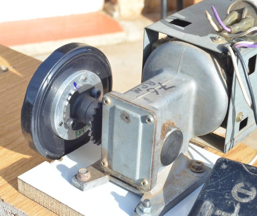

An update on my HF tumbler.
In original form the out of balance weight is at the bottom of the motor.  I considered this as incompetent design, totally sub-optimal, and thought that it should be raised to fit between the top of the motor and below the bowl.  I removed the motor and weight and offered it up to the bowl upside down.  It looked like with minimal mods it would fit.
The original weight was from round bar and to get working clearance I would have to space the downward more than I wanted so I made a replacement weight from some scrap 1/2" steel plate.  The original was also mounted far out on the motor spindle so I cut the spindle shorter and mounted the new weight as close to the motor as possible. with these mods I only had to space the motor downwards by the width of a washer.  Quite acceptable to me.  All that remained was to drill a hole in the base to reroute the motor cable to the switch and power supply.
The first was with an empty bowl and it was immediately obvious that the bowl was vibrating quite a bit more.  Loaded with about 1.5 kg of the plastic abrasive media the flow pattern of the media was very different and much more active.  My assessment of the original design was proved correct but the really annoying thing is that i added no additional parts and the manufacturing cost would not have changed to make it properly.
I'll post some photos of the mods and video of the agitation in the next few days.
