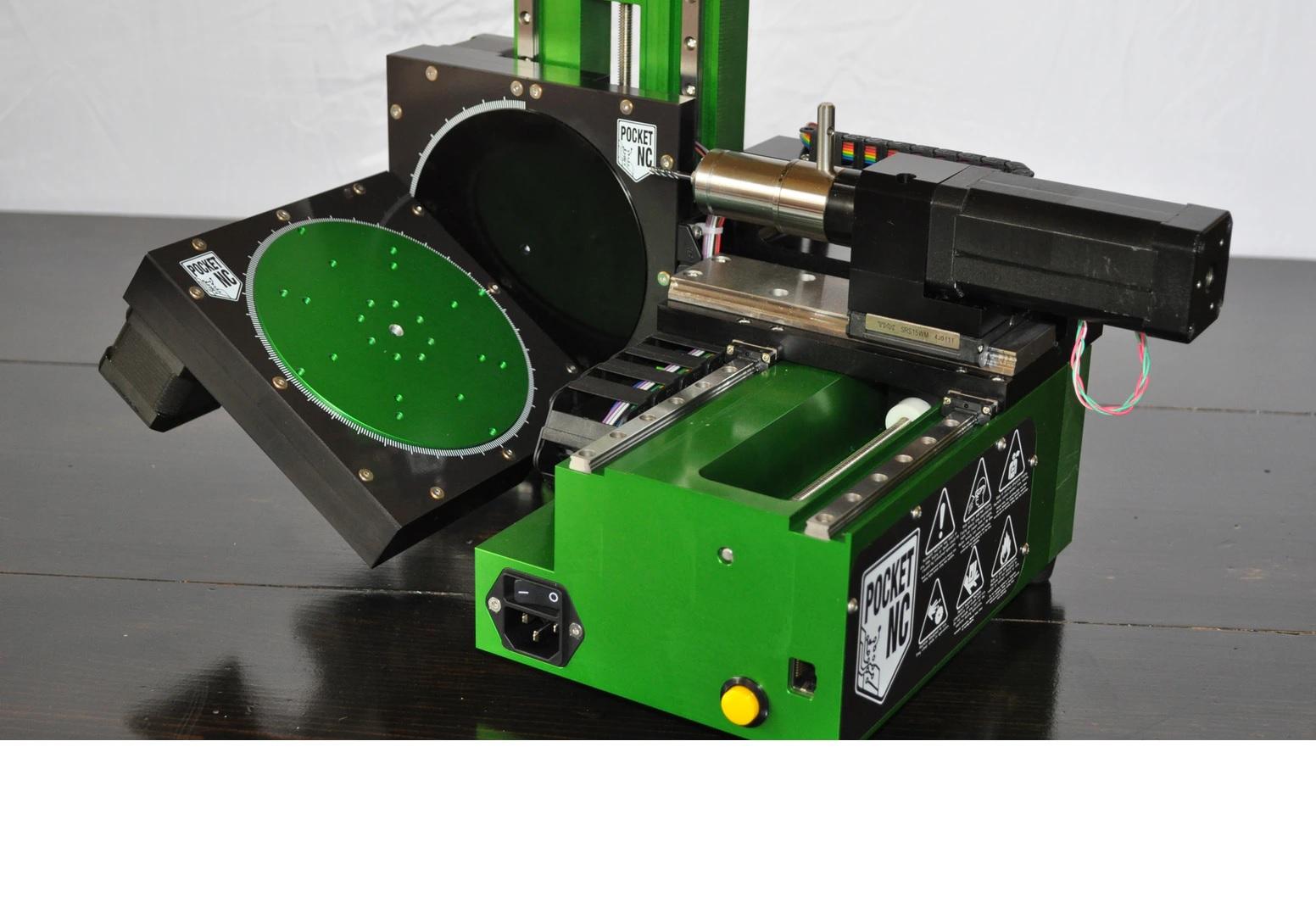

How about a 'Pocket NC  5 axis CNC machine for your desk top
https://www.kickstarter.com/projects/1090944145/pocket-nc-the-first-5-axis-cnc-mill-for-your-deskt?ref=nav_search&result=project&term=CNC 5
I believe this did make it into production   And at least you can use it as a starting point.
