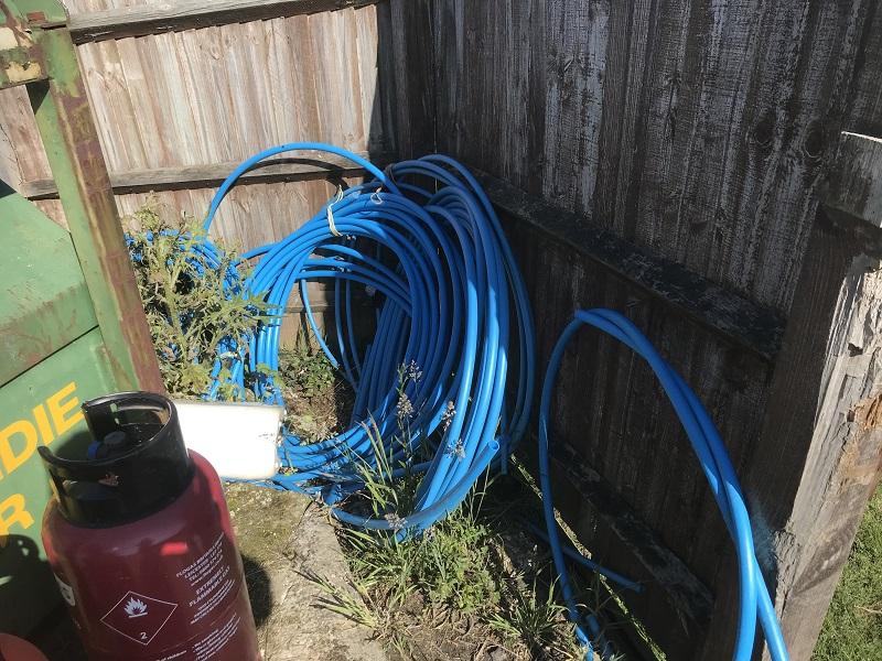

My air is distributed between several building underground using 25 mm blue MDPE water pipe, and also round the inside of those five buildings as a main with drops to the service points. There is far more storage in the pipework than in the tank !

Do not use plastic drain pipe. It's usually a hard plastic and relatively thin wall.
The pipe that I'm using is 25 mm MDPE usually used as the incoming water service pipe in houses in the UK. It is service rated at 10 BAR or about 150 psi . I distribute at 100 psi and all my  air goes through a desiccant silica gel drier of my own construction (described on this forum) which has completely eliminated moisture problems.
I have been using MDPE water pipe for over twenty years and have had no problems with deterioration..I have in all that time only had one problem. I had a Tee joint one branch of which wasn't used and was blanked with a blanking plug in a slightly harder plastic. It blew off once when I was experimenting increasing the compressor pressure and I concluded that the retaining gripper hadn't bitten into the plug enough as it was harder than pipe, and that I hadn't tightened it fully. The same joint and blanking plug have now been in service after refitting for several years with no problem.

No way would I run 25 mm water pipe at 1500 psi as quoted above. 150 yes no problem
This is the stuff I use (I keep a stash of spare!)
Re: New compressor?
« Reply #14 on: June 17, 2019, 08:03:21 AM »
Andrew,
You really ought to keep caps on the ends of your stash of pipe - you don't want to give any sheltering spiders the bends when you cut off a length to put into service!!
Re: New compressor?
« Reply #15 on: June 17, 2019, 08:23:26 AM »
There are never enough caps - a 50 metre roll comes with two caps, and of course you end up with far more lengths than you started with, all be it totalling the same length !
