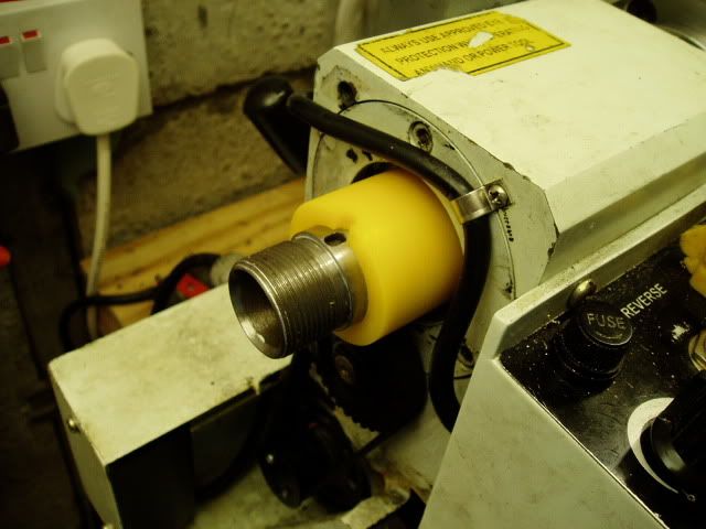

I decided it was time I fitted taper roller bearings to my Mini Lathe......
I had read several stories of needing another lathe to machine spacers, but gained confidence reading the later part of David, Twinsquirrel`s posting.  :clap:
http://madmodder.net/index.php?topic=899.15
NO Problem!
No special tools needed....... Anyone who has changed a car wheel bearing need have no worries!  :thumbup:
http://i110.photobucket.com/albums/n95/Dayjo/p5310002.jpgMini Lathe Roller Bearings.

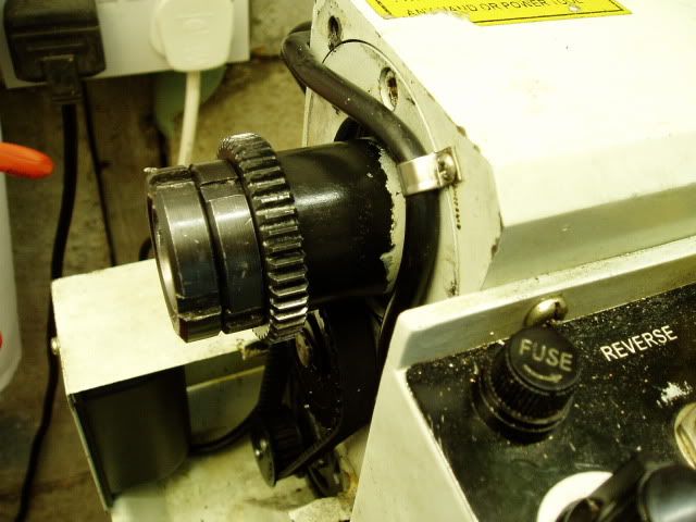

.....BUT!
Why does the bearing spacer/ tumbler gear/ locknut assembly wiggle like a swashplate???  :bugeye:
http://i110.photobucket.com/albums/n95/Dayjo/p6010002.jpgMini Lathe Roller Bearings.
I had noticed this occasionally, over the years. But it was bought new, so must be ok (& out of sight under the cover)......
The spacer bore has 2mm clearance on the spindle.
The 2 locknuts are threaded very wobbly to their faces!!!!
What`s all that about?  :bang:
And now what to do?  ::)
Turn up a new larger dia spacer, a sliding fit onto the spindle.
http://i110.photobucket.com/albums/n95/Dayjo/p6010003.jpgMini Lathe Roller Bearings.
This correctly aligned the tumbler gear, for the first time in it`s life.
But not the nuts.......
http://i110.photobucket.com/albums/n95/Dayjo/p6010004.jpgMini Lathe Roller Bearings.
Soooo....... I screwed a piece of bronze to a tight fit in the nut`s threads.
http://i110.photobucket.com/albums/n95/Dayjo/p6020004.jpgMini Lathe Roller Bearings.
This allowed me to face up square with the thread.
Had to remove approx .035" per side from touch on, to leaving a witness.....
http://i110.photobucket.com/albums/n95/Dayjo/p6020009.jpgMini Lathe Roller Bearings.
Super job...... Now!  :thumbup:
http://i110.photobucket.com/albums/n95/Dayjo/p6030003.jpgMini Lathe Roller Bearings.
Still rather puzzled over the apparent April Fool bodge........
WHAT was all that about?  :scratch: :scratch:
More to follow, when I`ve taken some more pics.......

« Reply #8 on: June 04, 2009, 12:35:26 PM »
Nick,
I`ve not done much with the mod, as yet.
Spent some time getting as little bearing drag as possible allied with no chuck movement.
The rythmic squark has now gone!  :ddb:
The rear bearing must have been really tortured, with it`s inner race held only at one point of the tilted spacer.  :borg:
I have given it some (comparative) welly, using a 45dgr tool into a piece of 7/8" steel bed iron......
It performed just like I remember grown up lathes working....... No squealing, no chatter, just got on with it!  :thumbup:
