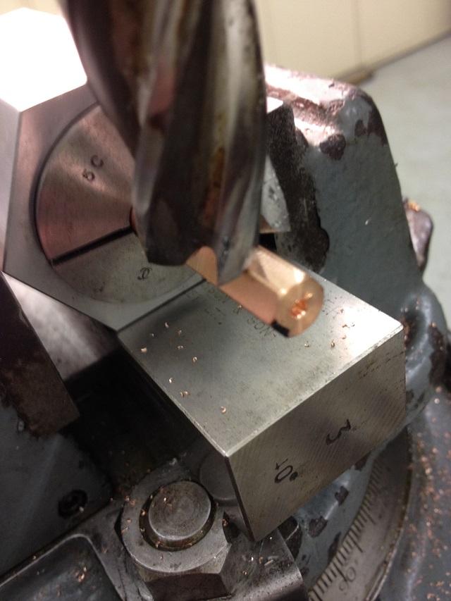

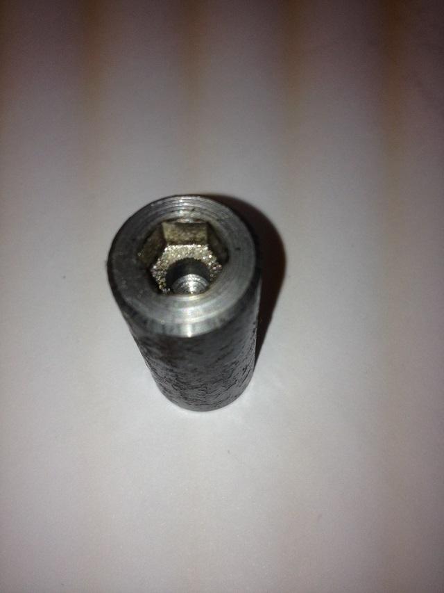

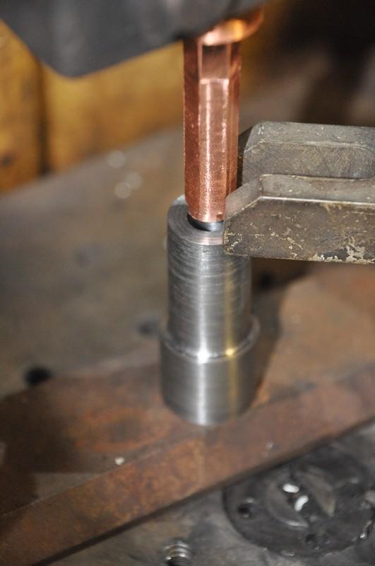

Another weekend plagued with visitors means not as much achieved as I'd hoped... but at least I made a start on some of the repairs and new parts.
So... now I'm wishing I hadn't used quite as much superglue on the headstock as I did  :palm: That stuff does NOT react well to being welded through... I managed to get a few tacks to hold, though... before blowing the top out completely  :bang:  So I left that for another weekend, and moved on to the new belt tensioner parts. The shaft should be relatively straightforward, but I wanted to make the front piece (the one that takes the handle) first, then I can make the hex end of the shaft to fit that part.

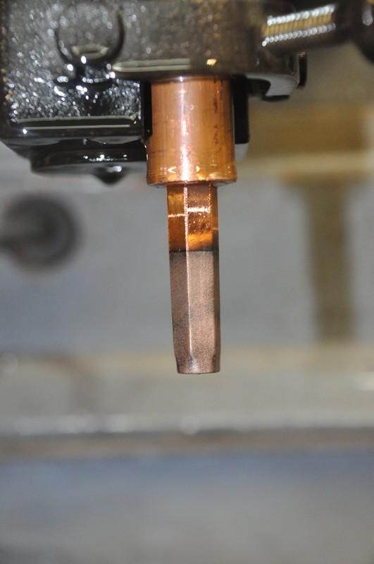

1st effort got abandoned due to me making some dumb mistakes with my measurements, the second effort was much better. It's made of some mystery steel which hasn't got a nice finish on it, but I'm hoping it'll polish up OK. The turning was straightforward and not worthy of pictures; where it gets interesting is cutting the hex hole.... so finally, I get to use my spark eroder on a real project (well... for certain values of real anyway  :lol:).

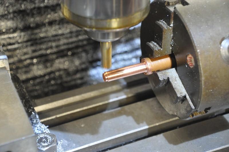

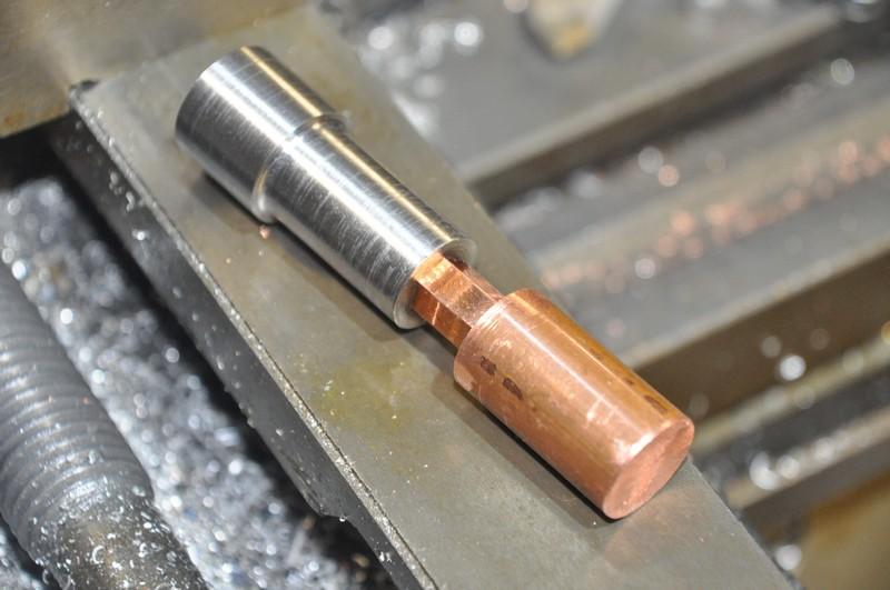

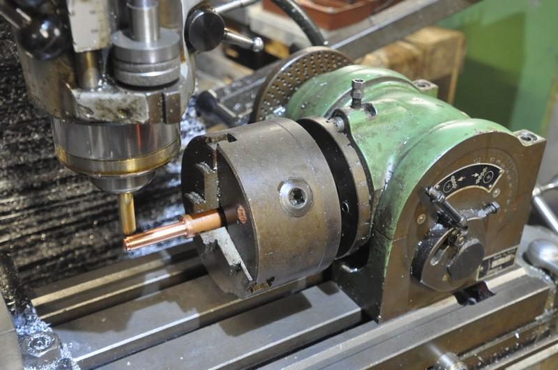

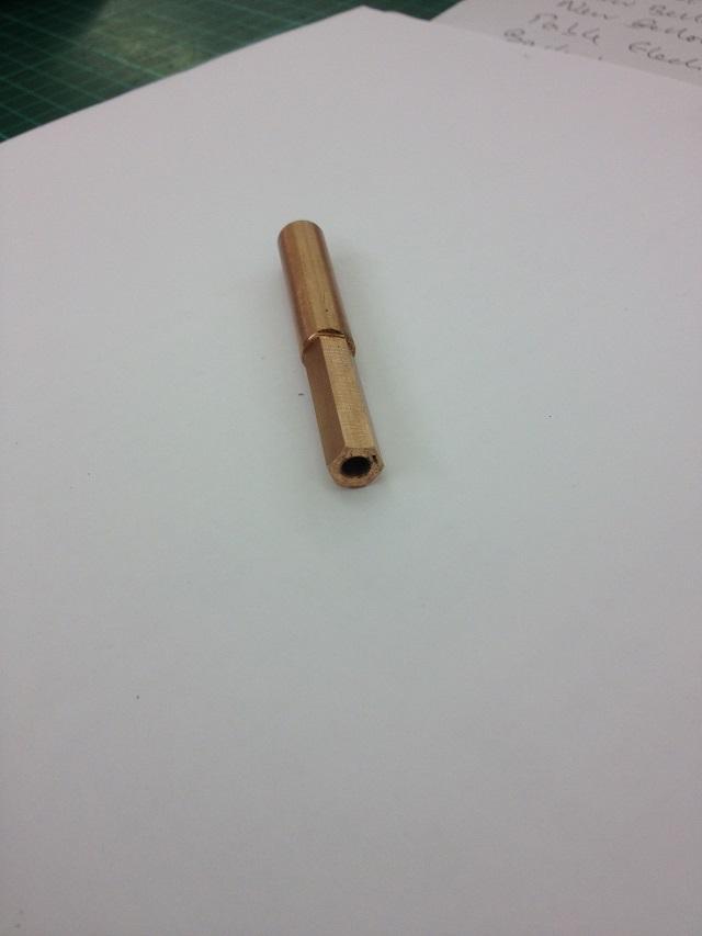

First job, after finishing the steel blank, was to turn a piece of copper bar down to the appropriate diameter (pic 71 & 72 - the poor dividing head mentioned earlier, still just cutting hexes!). The slightly smaller diameter on the end is a registration diameter, and just fits in the hole drilled in the steel. This will allow me to line everything up on the spark eroder, which doesn't have graduated handwheels.
Pics 73 & 74 show the copper electrode with the hex cut finished to a high-ish polish (ahem).

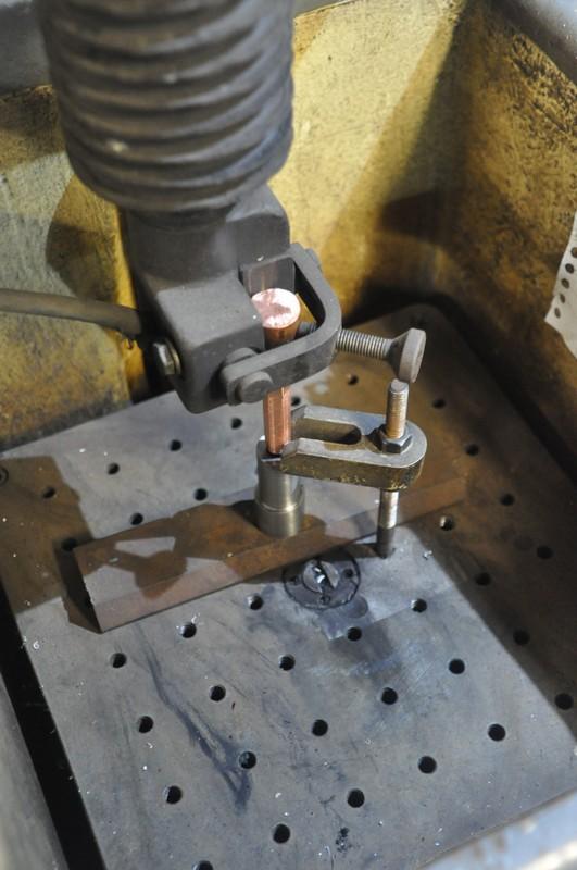

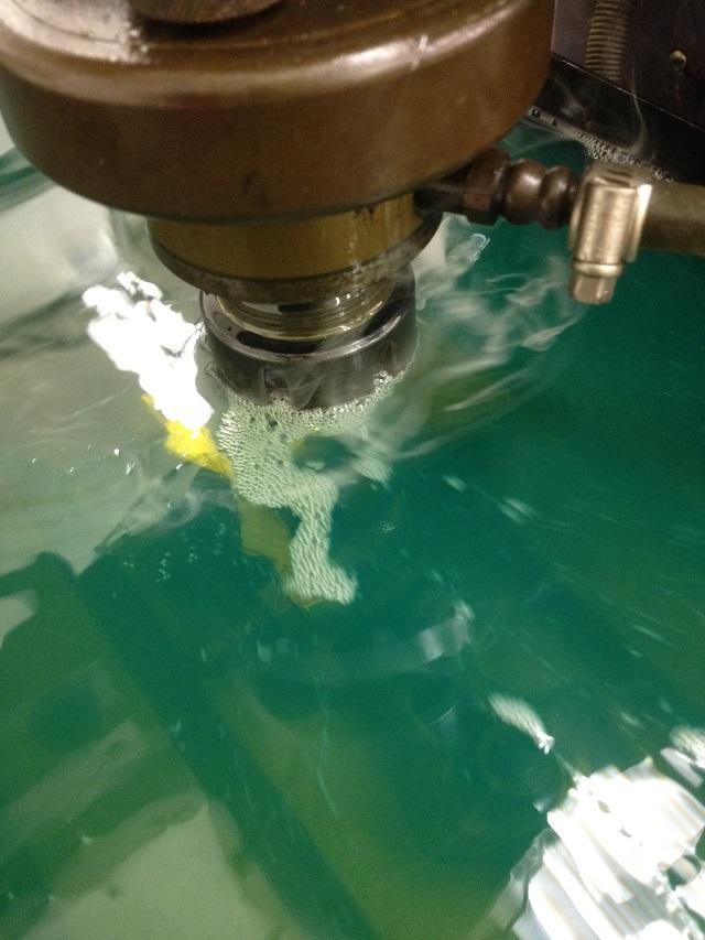

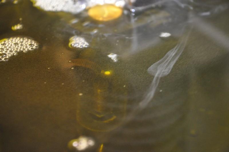

Next, the steel blank is clamped into the spark eroder, the electrode tightened into its holder, and the whole lot lined up (pics 75, 76), then the tank is filled and the eroding begins (pic 77 - which is about the best shot I could get. Photographing spark erosion from above the fluid is really tricky! I just remembered, as I write this, that I have a GoPro-like camera with a waterproof housing.... so maybe I'll try for a submerged shot from that next time. Watch this space!)
Re: Boxford back from the dead
« Reply #87 on: June 23, 2019, 07:26:21 PM »

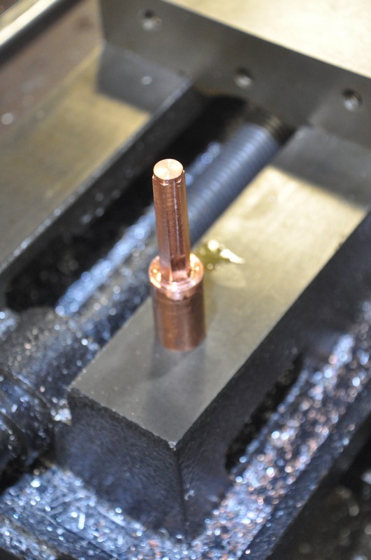

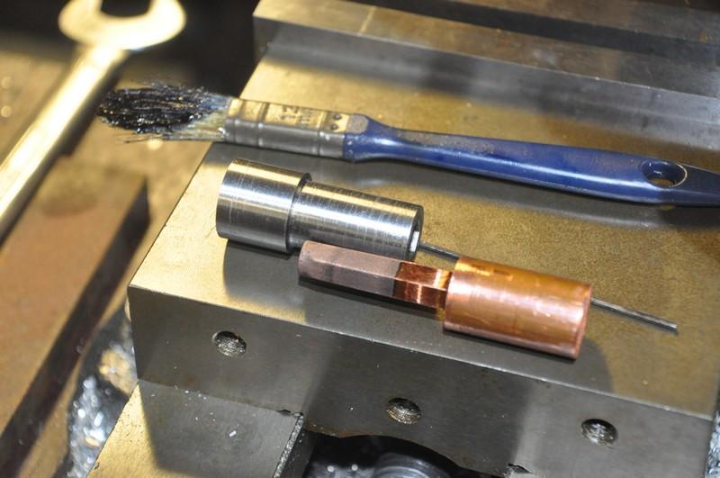

After a couple of hours, I checked on progress, which was really good - about 0.8" done. At this point, I discovered that the adjusting nut for the electrode was interfering with the clamp screw. One issue with a spark erosion machine... it'll cheerfully eat itself, without giving you any warning signs! Another issue, the electrode also wears, as well as the workpiece; so having to re-arrange everything inside, I also took the opportunity to lop the worn bottom off the electrode. I no longer needed the registration round, as I could use the hex itself. After this, another couple of hours of fizzing and popping, I called it done.

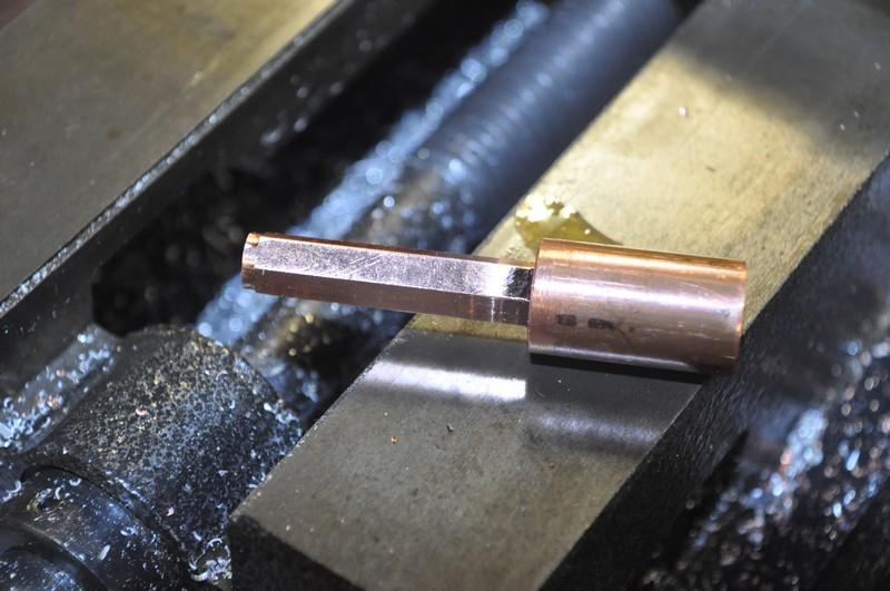

The remains of the electrode (pic 78) show clearly how far in it got; also, if you look at the bottom, you can see it's worked its way back to being round... However, there's still about 800 thou of decent hex left, which is plenty deep enough for my purposes. If push absolutely comes to shove, I can always chop the bottom off it again, and use the as-yet unused bit to push the hex deeper. Pic 79 gives you some idea of how deep into the part it's gone. That's at least 3 diameters...

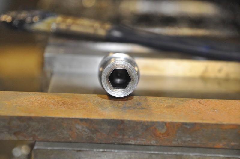

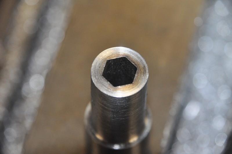

Pics 80,81 are the money shots  :lol: I reckon broaching is the only way to get a better hex, and I'm pretty sure you can't broach into a blind hole and get all the way to the bottom of it without some really fancy-pants way of getting rid of the chips....
Finally, pic 82, just to show the bleedin' obvious; the electrode fits perfectly in the hole  :bow: There's probably about 3-4 thou clearance all around, which makes sense; it also means I'm not exactly sure how big it is, except that it's a smidge bigger than the drawing calls for... this is why I wanted this part made first; I'll cut the hex into the end of the actual adjustment shaft next, and will sneak up on the final dimension so it's a nice wobble-free sliding fit. At least... that's the plan!  :coffee:

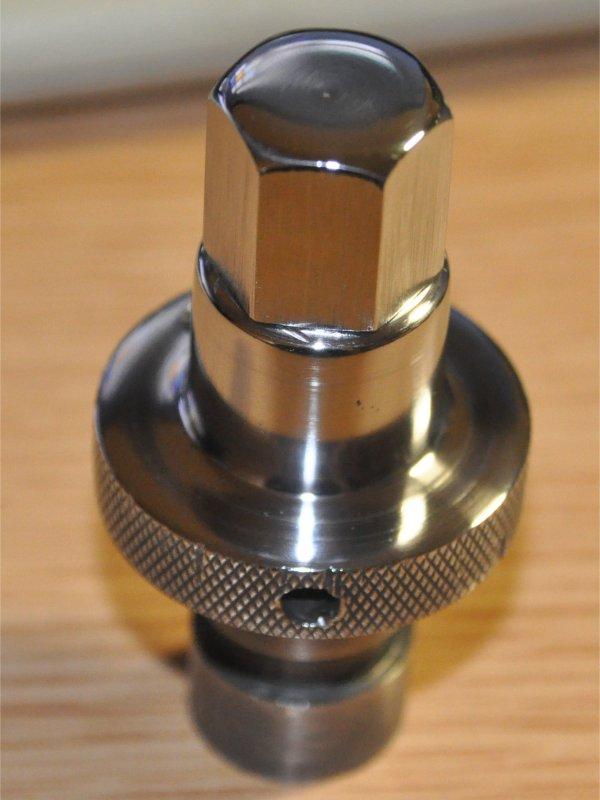

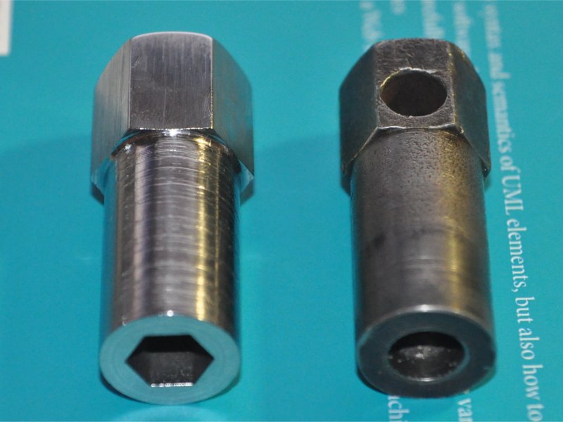

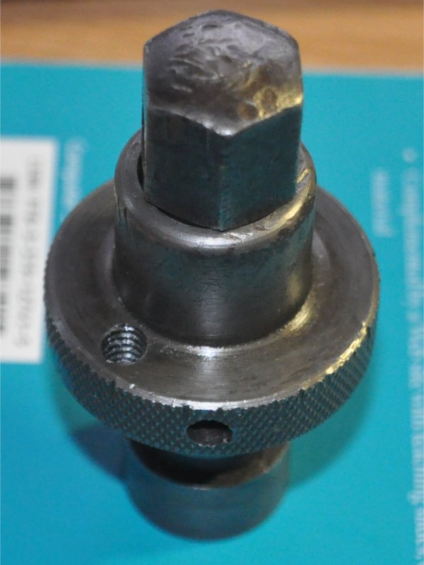

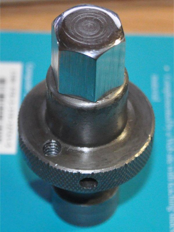

I snuck down to the workshop today for half an hour (have car, will travel... but my knee is basically better now, so I won't have an excuse to drive to the railway station for much longer), so I cut the hex into the end piece, and using a fairly coarse file, cut a bit of a dome in the end. The belt sander tidied up the worst of the machine marks on the faces, so I brought it home and had a go at polishing it  :D OK... I need to do more work on getting rid of the cutting marks, this was just playing around really. It still came out nice and shiny, which is what I'm looking for. Mmmmm. Shiny.
Now.... do I gold plate it for the "black and gold" colour theme.....?  :lol:
« Reply #96 on: June 25, 2019, 05:40:42 PM »
 :doh: I just realised I'd got the old bit here too, and the part it fits in. And as we know:
 :worthless:
So may I present: Old vs. new; old in the mating part; new in the mating part  :thumbup:
I still need to drill the handle hole (should be straightforward enough), and the hole for the grub screw. The latter will wait until I've got the shaft finished, so I can be sure the end of the grub screw fits perfectly. Also note, I've made the hex a bit bigger - 3/4" instead of 11/16". I can never find my 11/16" spanner... but 3/4" = 19mm = loads of them kicking around the place  :lol:

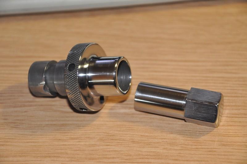

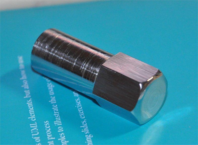

Things have been a bit quiet on the Boxford front the last few days; I found myself short of tooling... After several abortive attempts to cut a thread using a brazed carbide tool (chipped the end off), an insert (wouldn't go deep enough, and I'm 99.9% sure it was a 60 degree bit anyway), I did finally get some success with a ready-cut HSS tool I found buried at the back of a box of HSS bits somewhere. I think it's 55 degree, but it's hard to be certain. There's not a lot in it, and my eyes aren't what they used to be. If anyone has an easy way to determine a 55 degree vs. 60 degree cutting tool, speak now... So... more on the threading tomorrow, when I hopefully finish off the belt adjustment shaft.
Meanwhile, a set of polishing wheels/polish had showed up, and yesterday a fine selection of wet & dry paper in various grits (all the way up to 3000!) appeared; so tonight I called in at the workshop for a bit of messing about. Basically, I wasn't happy with the finish on the adjuster collet thingy, so I chucked it up in the lathe, and filed away the worst of the indentations. Then I used progressively less aggressive emery cloth - 80 to start, then 120, then 240, followed by some 400 grit W&D, finishing off with 1000 grit. I did the same with the adjuster nut/handle holder thingy, although I've not yet done the flats (I'll drill it first).
Finally, when I got back home, I gave it a 2 stage polish on the hard cloth wheel & then the soft floppy wheel, with the two grades of polish which came in the kit.
I think they came out rather nice. If you look really closely, there's still a few scratches left from the sanding (they may not be that visible in the photos)... but they'll do for me, for now  :thumbup:
