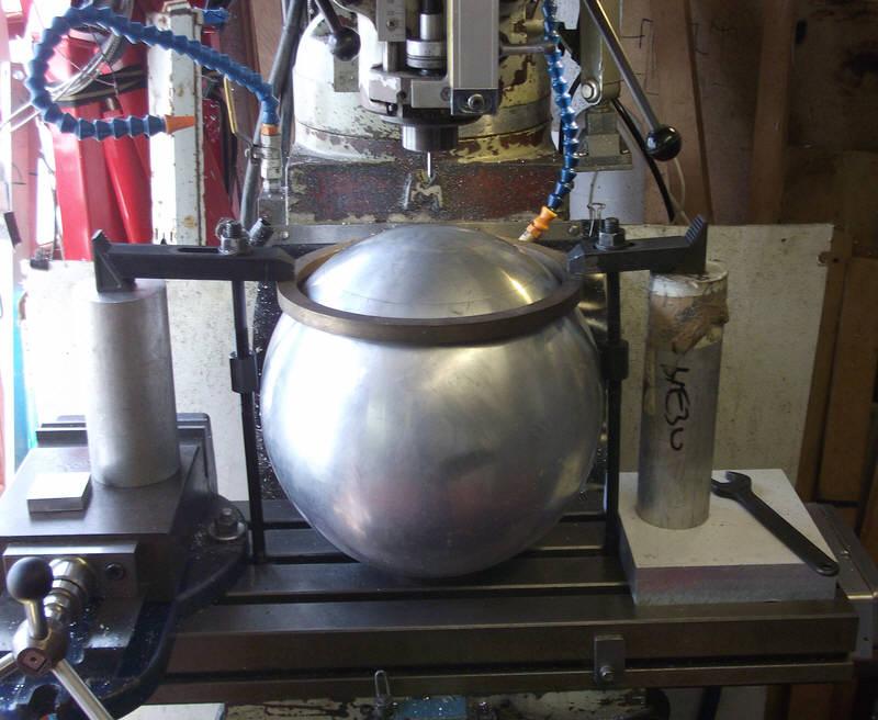

50 years ago... a human stood on the moon.
Now, I'm building a garden ornament to celebrate   :)
The Earth :  here represented as a 300.00mm aluminium oceanographic target ball (scrapped after a minor telephone related cockup )  It'll stand on another piece of 350 x 180mm Diameter bar and one of the many 500mm x 13mm discs of invaluable scrap we seem to generate at work every day.

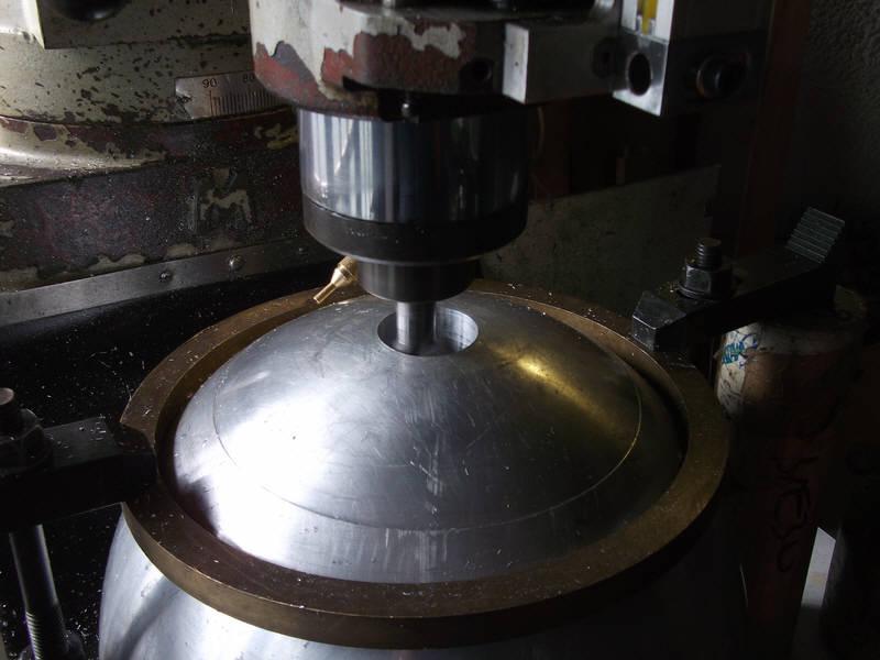

Work holding proved to be tricky (the set up worked but wasn't the most secure) First task was to bore a 1100 mile diameter bearing pocket into the south pole - the problem here is that I didn't have head-room for a boring bar so had to rely on the cnc interpretation of a circle which ,due to backlash, was rather elliptical , a second pass in the opposite direction got it close enough for a minor planet ;-)
The bearings drop onto a 25mm stainless bar fixed into a convenient hole in the middle of the scrap bar (it was too big for my lathe and too tall to bore in the mill (just managed to pilot a hole circle in the bottom ).
Next...
The Moon :  To be a 81.75mm aluminium ball (just a tad too big to use my ball turner  :scratch:). Not sure how to mount this yet

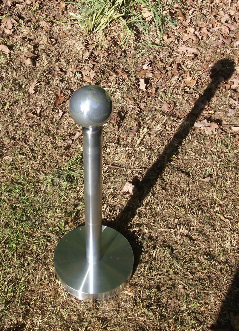

« Reply #1 on: May 07, 2019, 06:30:40 AM »
Unfortunately the pics of making the stand didn't develop (damn this digital chemistry).
so here's a pic of the thing so far (I may mill some flats or flutes on to the column - looks a bit plain ATM).

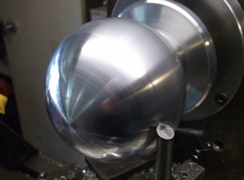

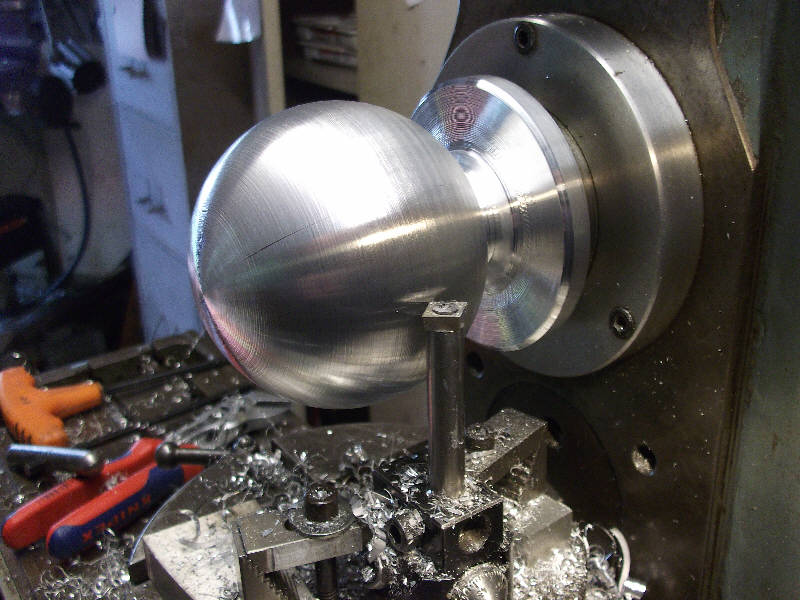

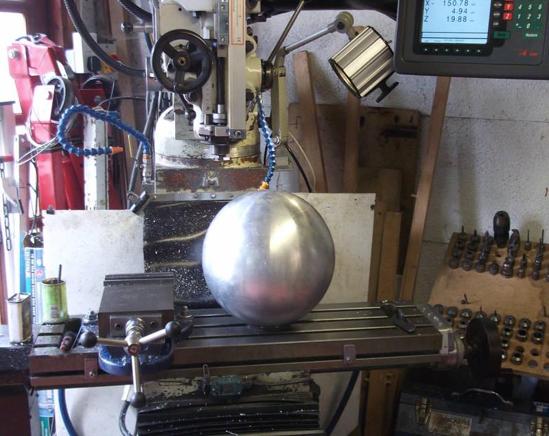

« Reply #7 on: May 11, 2019, 02:43:46 PM »

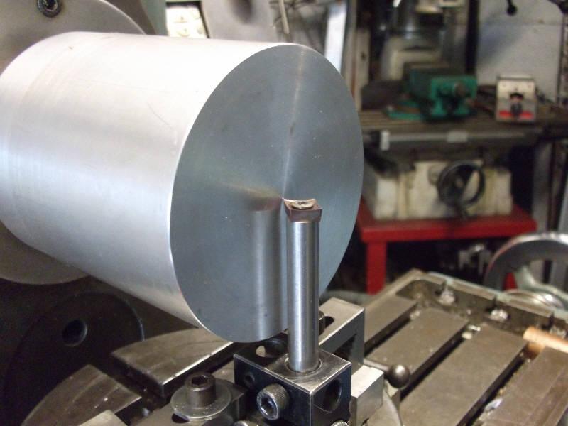

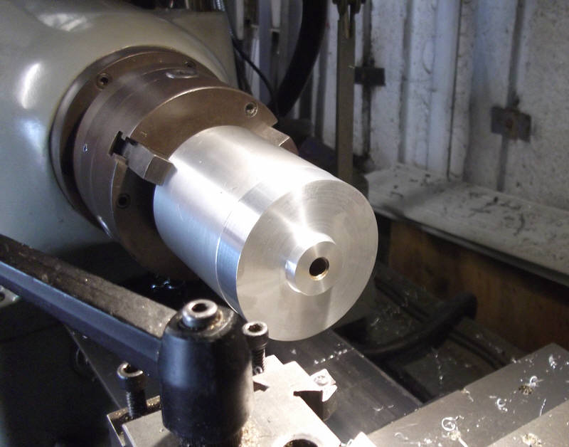

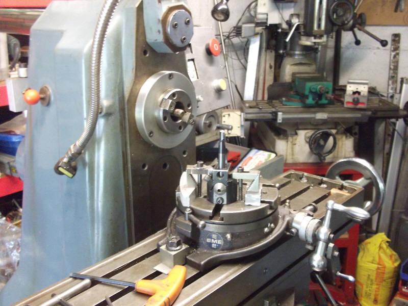

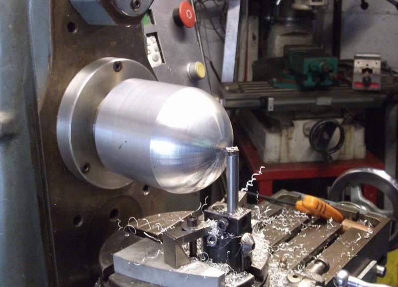

I thought of a couple of ways to machine the moon sphere :
First thought was using a boring bar in vertical mill with part at an angle in a dividing head  - but my boring heads are too small to swing the 80 - 100 mm necessary for the trick to work.
In the end I decided to adapt the horizontal mill into a ball turner using a rotary table and a cheap Soba boring head.
Holding the work was a puzzle,  but simply turning  short int30 register on one end and holding the part directly onto the spindle with a 12mm draw bar worked out perfectly.
I'm having fun and games with chatter ATM (it's not the best rotary table ever made) but I've still cot a couple of mm to remove from the diameter so I'll play some more tomorrow.
  • Posts: 1205
Over the Moon

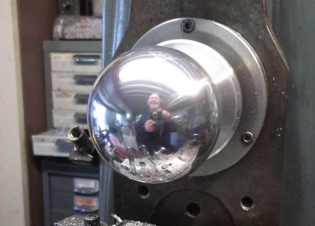

« Reply #8 on: May 12, 2019, 09:38:54 AM »
Solved the chatter problem with a piece of ground and honed high speed steel . Then lashed-up a 'power feed' for the rotary table 'cos it was difficult to turn slow and consistently.
The result was better than expected, so i couldn't resist applying some grey scotchbrite, elbow grease and T-Cut ...
I'll leave it on the machine for the moment while i work out how to mount it and what to do with the south-pole.

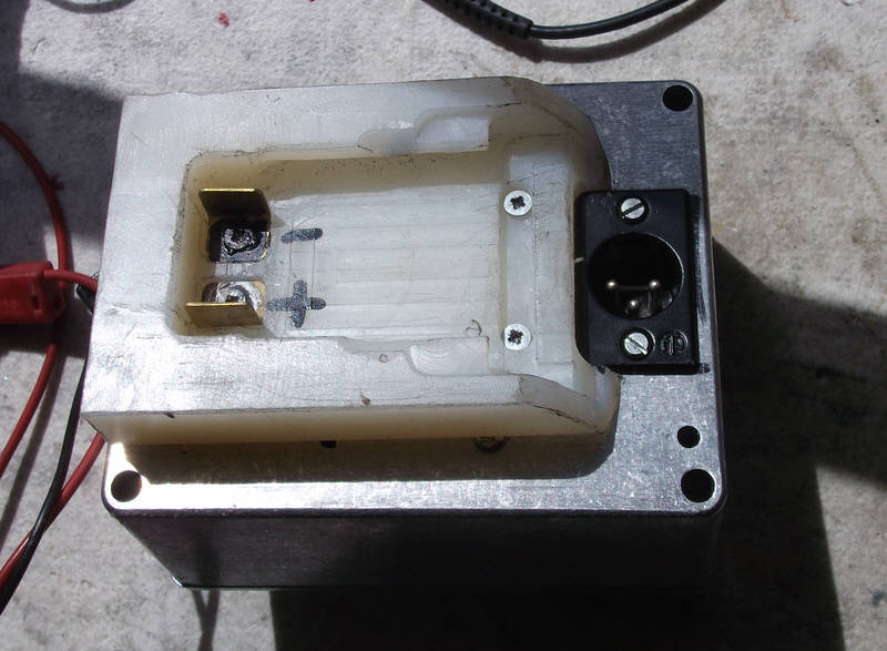

Ta  :)

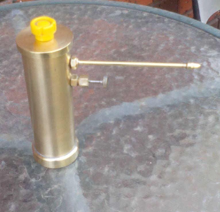

It's a useful little battery powered supply  made from a 'Ruiden' (? - search ebay for 50v 5A psu) Chinese made power supply module (cheap and very good) in a di-cast box. Inside is a  step-up converter (250 Chinese watts!) so 18v from the battery will give up to 50v out if required. On the back, is a home-made  DeWalt 18v battery adapter  (carved from a piece of nylon)  and a XLR plug for and external psu (old laptop supply).

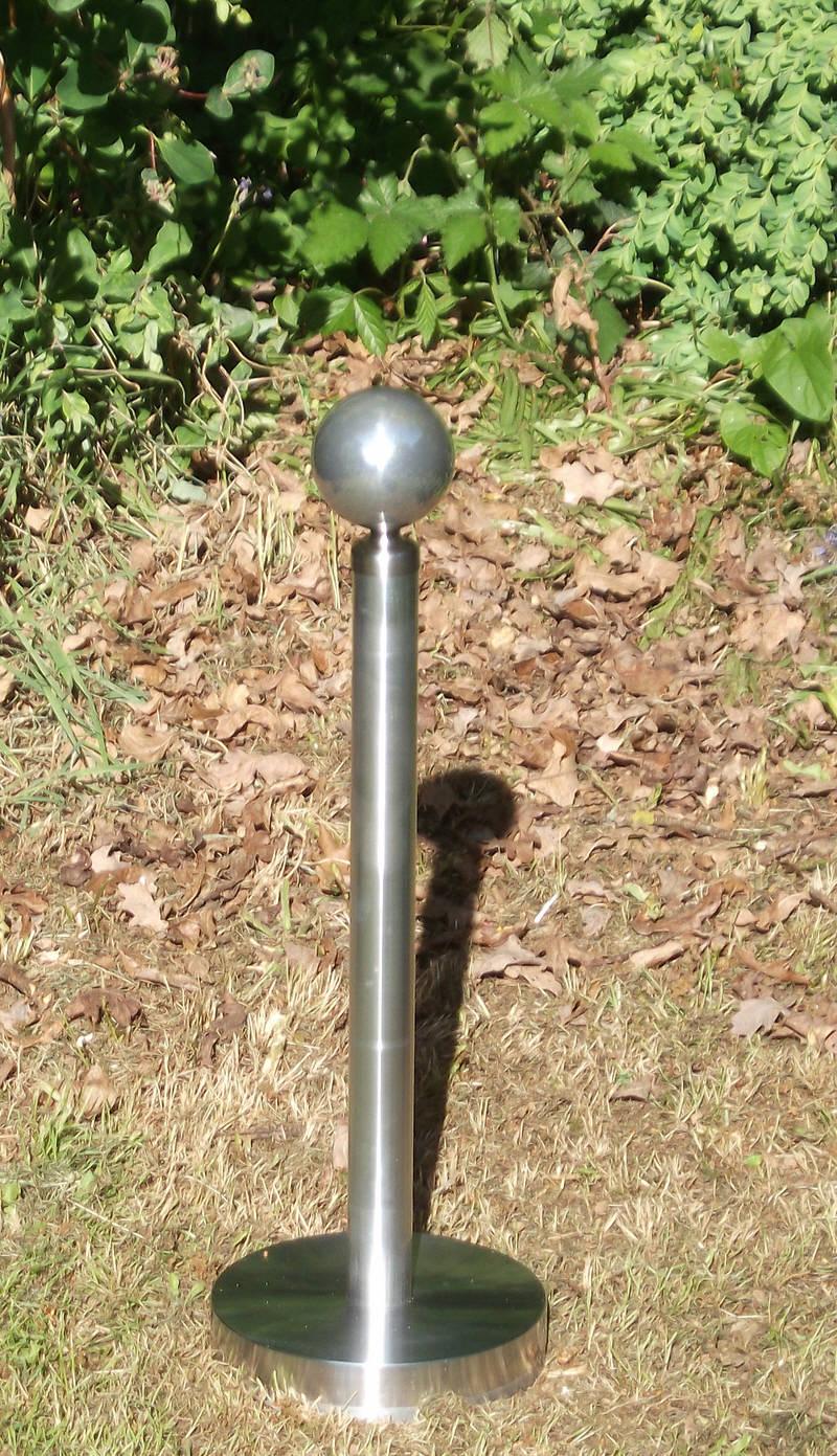

Knocked up a quick stand - or would have been quick had it not been too long for the lathe
Looks all nice and shiny, much better than the earth , so might have to take a power mop to the globe .

« Reply #20 on: May 22, 2019, 08:55:58 AM »

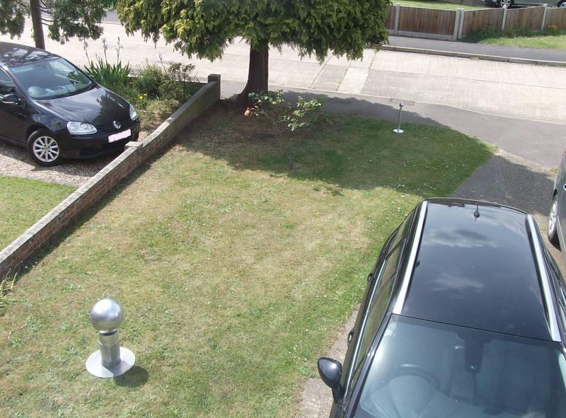

I've placed to moon and earth on the front garden (it amused the neighbour :-)) .
I've skewered the moon base into the real earth to make it a bit less 'portable' (we don't get too many light-fingered types around here but...) and set a camera up to catch reactions (if any) .
incidently my , overgrown , tree is about the same size as one of Saturn V's  F1 rocket engine .
